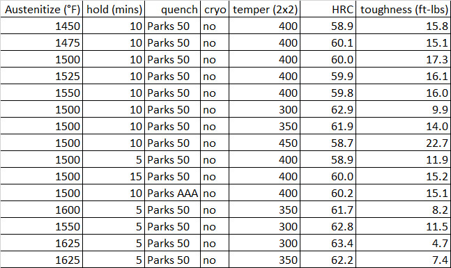

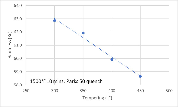

Pop’s Knife Supply contacted me about doing a set of experiments on their 8670 steel. We talked about different heat treating variables we might test and Joey Berry of Pop’s heat treated and ground the coupons. I measured the hardness and toughness of each condition and I am providing the analysis of the results below. We used my standard 1/4 size unnotched charpy impact specimen you can read about here. Below you can see the different heat treatments that were tested:

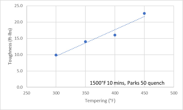

Tempering Temperature
As expected, as the tempering temperature increases, the hardness goes down while toughness goes up. However, in certain cases we have seen a steep drop in toughness below certain tempering temperatures, such as with 5160. Some steels also start to see tempered martensite embrittlement at 450°F but this was not seen with 8670. In this case as long as the tempering temperature is between 300 and 450°F, there is a linear trend with hardness and toughness. So choose the tempering temperature according to what the desired combination of toughness and hardness is.

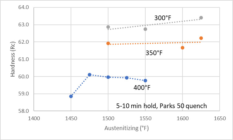

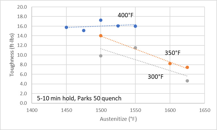

Austenitizing Temperature
We looked at a range of austenitizing temperatures from 1450 to 1625°F. Different datasheets can have a pretty wide range of recommendations on the best hardening temperature for this steel. In this case 1450°F led to reduced hardness and toughness when compared with 1475-1550°F. Using 1600-1625°F led to reduced toughness without an improvement in hardness. The consistent results over the relatively wide range of 1475-1550°F is what makes this steel easy to heat treat. The sweet spot seems to be about 1500°F.
Austenitizing Time and Quench Oil
Some knifemakers are overly afraid of excessive hold time during austenitizing because they think it will lead to grain growth. If the austenitizing temperature is selected appropriately then holding longer than necessary does not lead to deleterious results. However, holding for too short a time can lead to insufficient hardness and even toughness in some cases. Using a time that is a bit longer than strictly necessary also means you can count on consistent results even for different size knives that may need a bit different hold times. In this case we see an improvement in toughness and hardness by austenitizing for 10 minutes rather than only 5 at 1500°F. Using an even longer hold time of 15 minutes results in the same properties.
Another concern that some knifemakers have is quenching too rapidly, worried it will lead to microscopic quench cracks or other bogeyman. And while I would be cautious when quenching anything in water, every steel that we have heat treated with Parks 50 has resulted in excellent toughness regardless of the hardenability of the steel. The benefit of a high hardenability steel is that you can use a slower quench oil and therefore reduce the chance of warping. 8670 has sufficient hardenability to use Parks AAA or even somewhat slower oils as AAA straddles the line between a fast and medium oil. But using Parks 50 results in toughness just as good as AAA. In fact in this case the toughness was better with Parks 50 but that is likely just statistical chance, especially since the 15 minute hold time with Parks 50 resulted in the same toughness as the Parks AAA for 10 minutes.

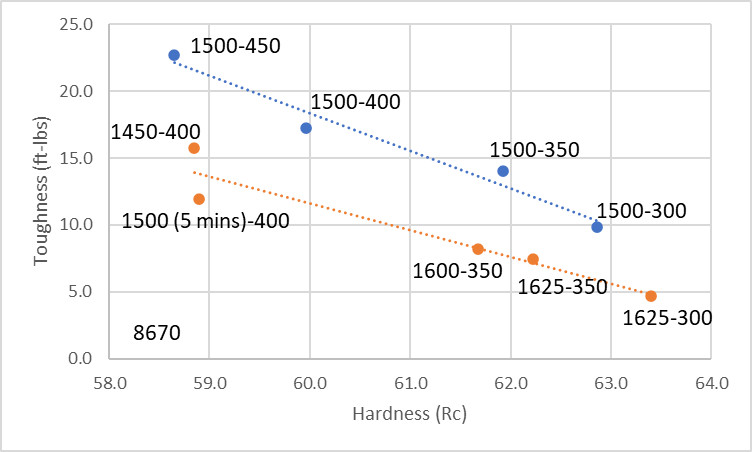

Hardness vs Toughness and Final Recommendations
Below I have a chart summarizing the best and worst hardness-toughness combinations from the studied heat treatments. Using 1500°F for 10-15 minutes followed by an oil quench and tempering between 300-450°F led to the best properties. Using either Parks 50 or AAA led to similar results. Select the tempering temperature based on the desired hardness-toughness combination. Underaustenitizing by using 1450°F for 10 minutes or 1500°F for 5 minutes both resulted in reduced hardness and toughness. Overaustenitizing at 1600°F or above led to reduced toughness for a given hardness.

8670 is very easy to work with and it is forgiving in heat treatment. It has very good toughness as well. My recommended heat treatment is 1500°F for 10 minutes, quench in fast or medium oil, and temper between 300 and 450°F depending on the desired hardness. This article also has recommended forging, annealing, and normalizing temperatures and some guidance on heat treatments to avoid such as underaustenitizing or overaustenitizing.

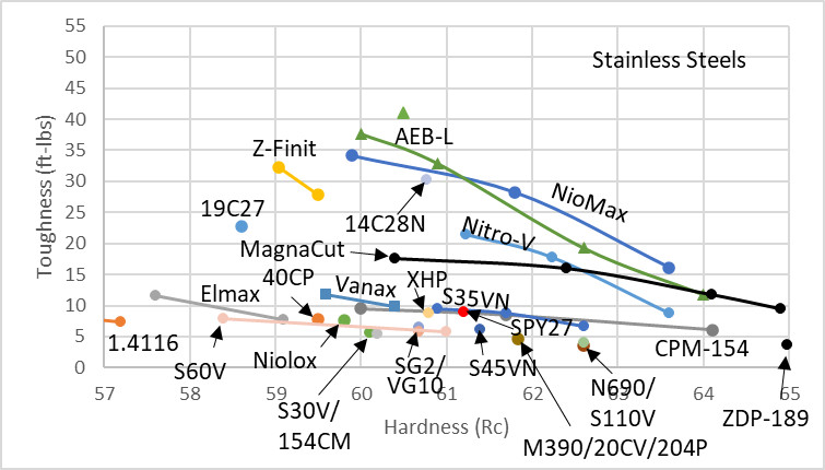

  5. Thanks for the thorough testing of 8670, I have some of this myself about to heat treat and this guide is invaluable. But I wonder why you did extensive testing then failed to include any of the results in the final graph of 8670 vs other steels? Seems your results show 8670 averaging around 15 toughness, but instead you show only a single point result of some other 8670 test showing over 3 times that value of ~50? Seems a little suspect. Maybe the different suppliers do vary this much, but you’ve chosen to show only the best results which seems deceiving.
    1. The summary chart indeed only shows the best results. If I showed every result of every steel the chart would be a giant blob. All of the information is shown in the article; nothing is hidden.
      1. It’s still a huge difference and I am quite interested to know why that happend. Was it really the same 8670 in the tests or did a charge get quite a different composition? Was it the HT? Did some testing parameters change? With the toughness values from this test, 8670 would be in the range of normal carbon steels and be nothing special anymore.
        1. As the article stated it was two different sources/manufacturers of 8670. I never said it was the same exact steel, just the same composition.
