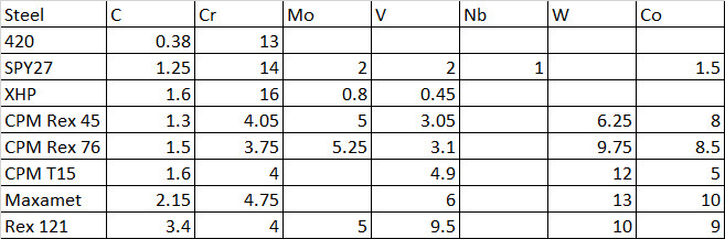

The selection is a bit random here though there are some themes. Maxamet, CPM Rex 45, CPM Rex 76, CPM Rex 121, and CPM T15 are all powder metallurgy high speed steels. 420, XHP, and SPY27 are all stainless knife steels. XHP and SPY27 are both powder metallurgy steels while 420 is produced conventionally. 420 has better corrosion resistance than the other two.

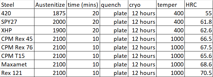

The steels were heat treated as shown in the following table. In general we tried to use pretty standard heat treatments for each steel, though cryo was used for each which is used by some knife manufacturers but not others. In the previous round of testing we compared cryo with no cryo in D2 steel and found no difference. Low end 420 knives can be as low as 50-52 Rc so this 420 will be better than those, of course. Not all 420 knives are so low, however.

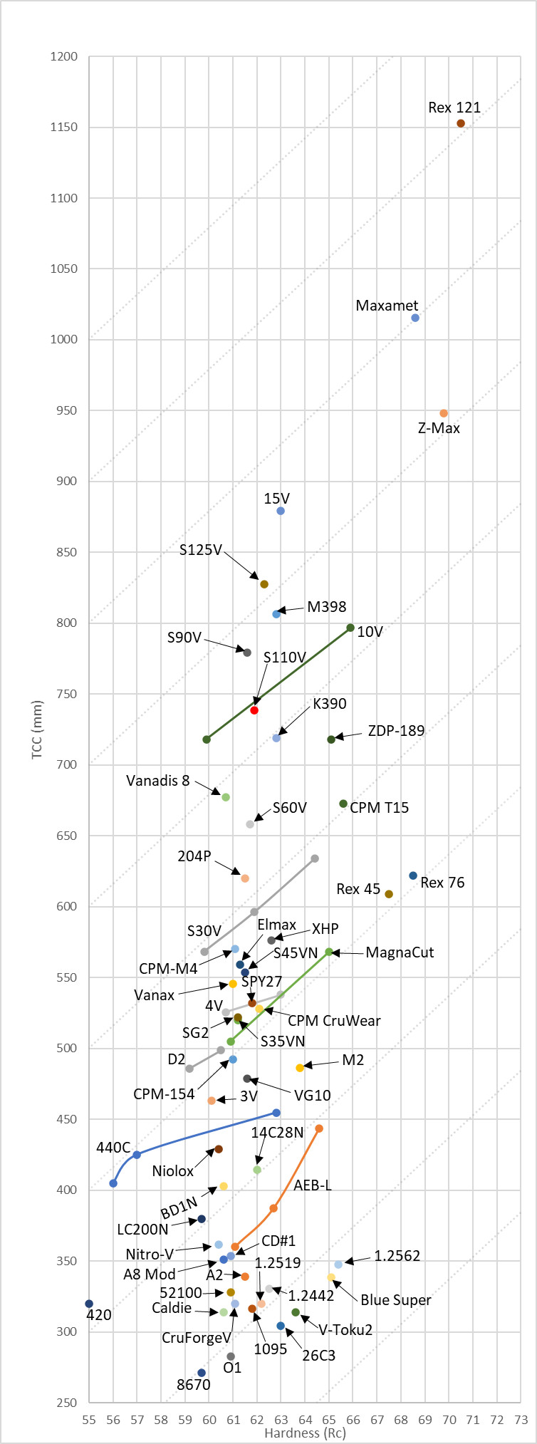

You can see the results of our testing in the chart below. Note that the dotted lines represent the approximate effect of hardness. So the edge retention of steels at different hardness levels can be estimated by the slope of those lines.
Commentary
420
Despite being at the bottom of the chart, 420 did somewhat better than expected. It did as well as many low alloy knife steels at higher hardness, such as 1095. The small amount of chromium carbide must be enough to give it some wear resistance to improve its performance. The edge retention is still not much to get excited about, of course. As noted previously in the article, my 420 being of the 0.38% carbon variety makes it better than some of the very low carbon stuff. And the 55 Rc I heat treated to is higher than some cheap knives.
XHP
XHP did relatively well, a bit higher than Elmax, S45VN, and S35VN, but a bit below S30V. This is about where it was predicted to fall with its 22% chromium carbide based on the following charts that were shown in the original article:
SPY27
I originally predicted that SPY27 would be a bit below S35VN because SPY27 has 2% V and 1% Nb while S35VN has 3% V and 0.5% Nb, which should give S35VN more of the high hardness vanadium/niobium carbides. However, in this testing SPY27 was roughly equal to S35VN when compensated for hardness. This is the second surprise I have had with SPY27 testing, as I originally expected it to have slightly superior toughness to S35VN but instead it also ended up being about the same. SPY27 behaves surprisingly similarly to S35VN despite the somewhat different composition.
Rex 45
I get asked relatively frequently whether CPM Rex 45 or CPM M4 has better edge retention. M4 has somewhat more wear resistance but they are close enough that it greatly depends on the hardness of the two knives. CPM M4 is heat treated to a relatively wide range of hardness, all the way from 60 Rc up to 64+ Rc. We chose ~61 Rc for our initial study because a fair number of knives are produced around the value, and gives a more 1:1 comparison in terms of wear resistance with other knife steels that are typically around that hardness. With Rex 45 we decided to do a standard heat treatment which results in higher hardness because the Spyderco knives produced in the steel are in the upper end of hardness. Otherwise I will be dealing with emails questioning our heat treating for the next several months. With the higher hardness, Rex 45 had superior edge retention to our CPM M4. However, if compensated for hardness the M4 appears to have better wear resistance.
Rex 76
Somewhat surprisingly Rex 76 was only about 1 Rc harder than Rex 45 despite the higher carbon and cobalt content. And the edge retention is only higher due to the increased hardness and does not seem to have benefitted from the higher carbide content that would result from the higher carbon content. So Rex 76 would primarily be useful for applications where very high hardness is desired.
CPM T15
The higher vanadium content of T15 gives it higher edge retention than either Rex 45 or M4. In combination with the relatively high hardness (~65.5 Rc), T15 has excellent edge retention. Unfortunately CPM T15 has never really caught on as a knife steel, though I don’t see why not. It has an interesting set of properties.
Maxamet
Maxamet is a notch higher in edge retention over Z-Max/Rex 86 with its higher vanadium (6 vs 5%). This is about where we expected the steel to be based on the position of Z-Max. It has very high edge retention of course.
Rex 121
With the new Rex 121 knife with a superior heat treatment it retains its edge retention crown due to better sharpening and therefore better initial sharpness.

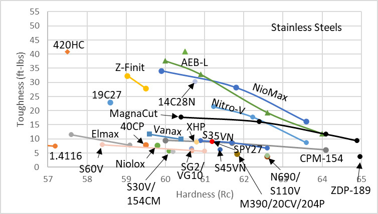

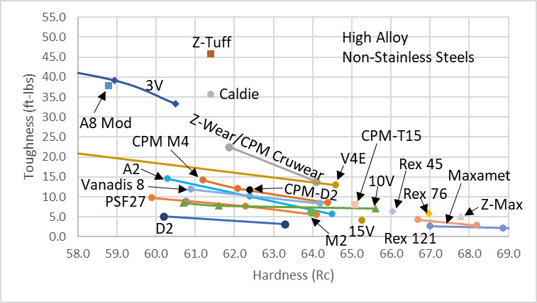

For these comparisons I also did toughness experiments on CPM-T15, Rex 45, Rex 76, and Z-Max/Rex 86. Somewhat surprisingly all of these CPM high speed steels had relatively similar toughness if compensated for hardness. If you draw a line from the CPM-M4 hardness trend those other steels all fall along it. Even with the 5% vanadium steel CPM-T15 and Z-Max. And Z-Max has somewhat better toughness than Maxamet at comparable hardness which is also impressive. The toughness differences between steels do become smaller at higher hardness, however.
Our measured toughness of Maxamet is rather good considering how high in wear resistance and hardness it can be, however. At 66.7 Rc it had toughness equal to 15V at 65.3 Rc. At 68+ Rc the toughness becomes somewhat less impressive, however.
XHP has similar toughness to S35VN, SPY27, and CPM-154 but with better wear resistance. It is a bit surprising how good the toughness was with all of the carbide that is in XHP. Sometimes I wonder if an “intermediate” carbide size such as with chromium carbide powder metallurgy steels can provide better results in an impact test than the absolute smallest carbides possible. Crack initiation is more difficult with smaller carbides, but crack growth takes more energy if the distance between carbides is greater (as is seen with larger carbides). The unnotched charpy test that I use requires both crack initiation and crack growth to occur so it is a combination of both factors. Another possibility is that the softer chromium carbides are less detrimental to toughness than the harder vanadium carbides. Typically the hardness of the carbides doesn’t matter much for toughness, with carbide volume and size drowning out the effect of carbide hardness. But perhaps with specific comparisons you start to see the effect. If you compare CPM-D2 and Vanadis 8 you see something similar; those two steels have a similar amount of carbide but the carbides in CPM-D2 are larger because they are chromium carbides as opposed to the vanadium carbides in Vanadis 8. The toughness was actually slightly better in the CPM-D2. If the carbides are larger than CPM-D2 the toughness is reduced, as is seen when looking at PSF27 (sprayform D2) or conventional D2, which both have lower toughness than the PM version. Whether the toughness differences come from carbide spacing or the softer carbides I’m not sure. Comparisons with three-point or four-point bending tests (crack initiation and strength) and fracture toughness (crack growth) might be revealing in this regard but I don’t have an easy/inexpensive way to do those comparisons. You can compare the microstructure of these different steels I discussed in this article.
SPY27 has a very similar edge retention-toughness balance to S35VN. As I noted before, the two steels behave surprisingly similarly both in terms of toughness and edge retention despite relatively significant composition differences.
420 stainless likely has very high toughness. I have tested the toughness of Buck 420HC before and it did very well but I have never added it to the chart before since it was done as part of a consulting job. However, I recently talked to them and they are fine with the result being public. The 420HC does excellent, as expected, due to the small carbides and low carbide volume that is found in the steel. 420 has even less carbon, and is at lower hardness, so it would also have very good toughness. The strength would be low, of course.

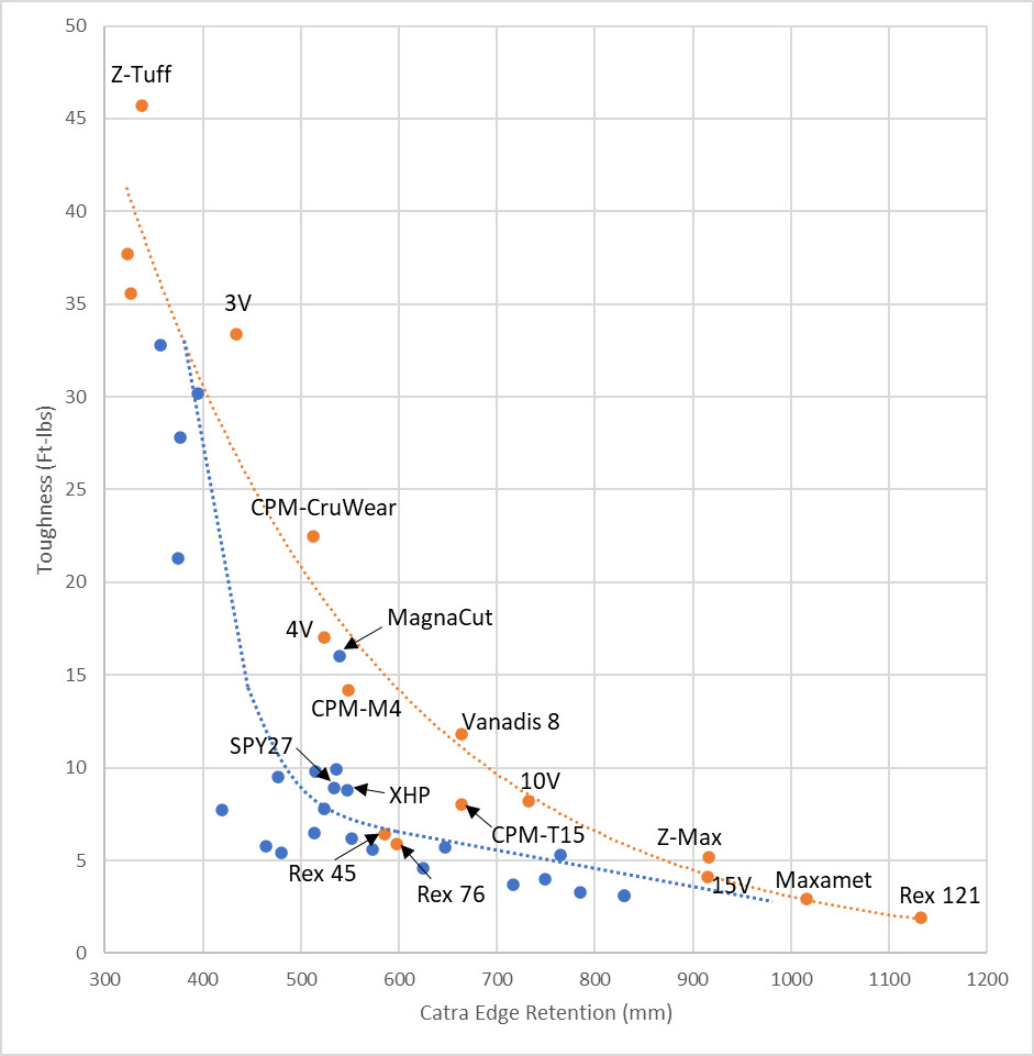

Toughness vs Edge Retention
The holy grail is to have both toughness and edge retention, of course. Normally these two properties are opposed to each other. So the best steels are those that have the highest edge retention for a given level of toughness, or vice versa. The best balance of properties are typically found in the non-stainless PM steels such as 3V, 4V, Vanadis 8, 10V, etc. The values below are normalized to the hardness of the nearest-hardness toughness specimen that was tested. The effect of hardness on edge retention is more predictable than on toughness. Orange dots indicate non-stainless and blue dots are stainless.
Rex 45 and Rex 76 are somewhat low on the chart, being close to stainless PM steels in a similar edge retention range. This is because of the high hardness which limits the maximum possible toughness. There may be certain applications where the higher strength is a benefit for thin edges in cutting tasks that are more limited by deformation than by chipping. If they were heat treated to lower hardness they would still be similar to other stainless steels, they would just be closer to steels like SPY27, XHP, and S35VN. CPM-T15 shows a better property balance with its higher toughness at the somewhat lower hardness along with superior edge retention. Vanadis 8 and 10V in the 60-64 Rc range offer a bit more balanced properties than high speed steels at high hardness. Z-Max and Maxamet fit the trendline better with others of the best non-stainless steels though of course at the higher end of edge retention. Somewhat surprisingly Z-Max has better toughness than 15V for similar edge retention, all while being at a higher hardness for better strength and resistance to deformation. It is hard to say what a reasonable cutoff is for “too much” wear resistance or too little toughness, and it obviously depends on the knife and the end customer. Maybe Maxamet is a good choice for some customers that want wear resistance over all else. Rex 121 might be too extreme for me.
SPY27 and XHP end up in a similar place on the chart, especially because the toughness coupon for XHP was somewhat lower hardness (60.8 Rc) than the CATRA knife (62.6 Rc). They are competitive with S35VN and Vanax in terms of property balance, other than the fact that XHP has poorer corrosion resistance than the others in that list.
I am not that confident in my ability to predict exactly where 420 would end up, but it would certainly be 40+ ft-lbs (see 420HC) along with its ~330 mm in the CATRA test. So it would be much higher and further to the left than the other steels that were tested in this batch. The property balance wouldn’t look too bad in comparison to other grades, really. And its corrosion resistance is also excellent. Again, it is primarily the low strength that holds it back. Choices like 12C27, AEB-L, or 14C28N would be better for the superior hardness potential at the cost of some corrosion resistance. 12C27 and AEB-L are essentially very high carbon 420 steels, and 14C28N is a modification with higher chromium and nitrogen.

    Regarding composition, shouldn’t a lot of these steels have about 1.0% silicon? There’s none in your table. thyssenkrupp reports their 420 as having 1.0% Si, but maybe they mean max. I haven’t seen you discuss silicon’s role before – doesn’t it improve toughness?
  6. The article says that I tested the edge retention of 420 but not its toughness. I then compared it to 420HC which I did have a toughness value for. Buck 420HC is 420HC so I don’t know why I would differentiate between those two.
    Si and Mn are found in most every tool steel but the amount is not always reported. I typically skip it in the composition tables to keep it simpler unless there is an addition to the steel for a specific reason. Silicon can improve toughness in specific situations, like tempering at 500F with low alloy steels. It doesn’t necessarily improve toughness in other scenarios. The 1.0% Si of 420 is indeed a maximum so it doesn’t tell you how much they are actually adding.

  12. Why do certain steels gain less edge retention as hrc increases? 440c has a steep increase in the lower hrcs but tapers off and 4v is rather flat between the two points. Aeb-l has a steep rise where as the others match the chart scale lines. I thought it might have something to do with the lower carbide steels gaining edge retention from the matrix hardness. I know your working with limited sample size so is this something that always happens?
    1. The average change in edge retention with hardness is shown by the dotted lines but as you noted there are some cases that deviate from this. With 440C a much higher austenitizing temperature was used for the high hardness point vs the other two which means a significant drop in carbide volume. The 4V test was comparing low and high temper so it could be that the high temper did indeed lead to a small improvement in wear resistance but overall with such a small difference it’s hard to say it is statistically significant. AEB-L I don’t know why it seemed to rise beyond the average trend at the higher hardness value. Maybe it means something or maybe it was a fluke.
      1. Thanks for taking the time to reply. It will be interesting to see this chart in a few years if you continue at the pace you’re going.
