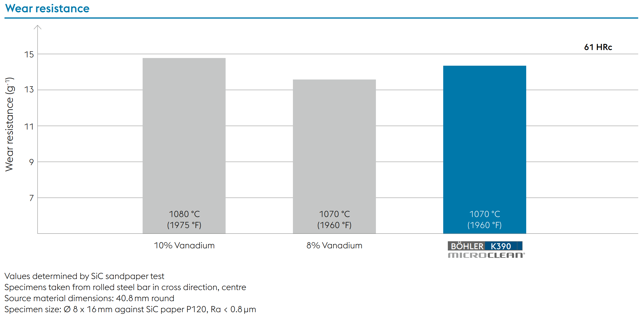

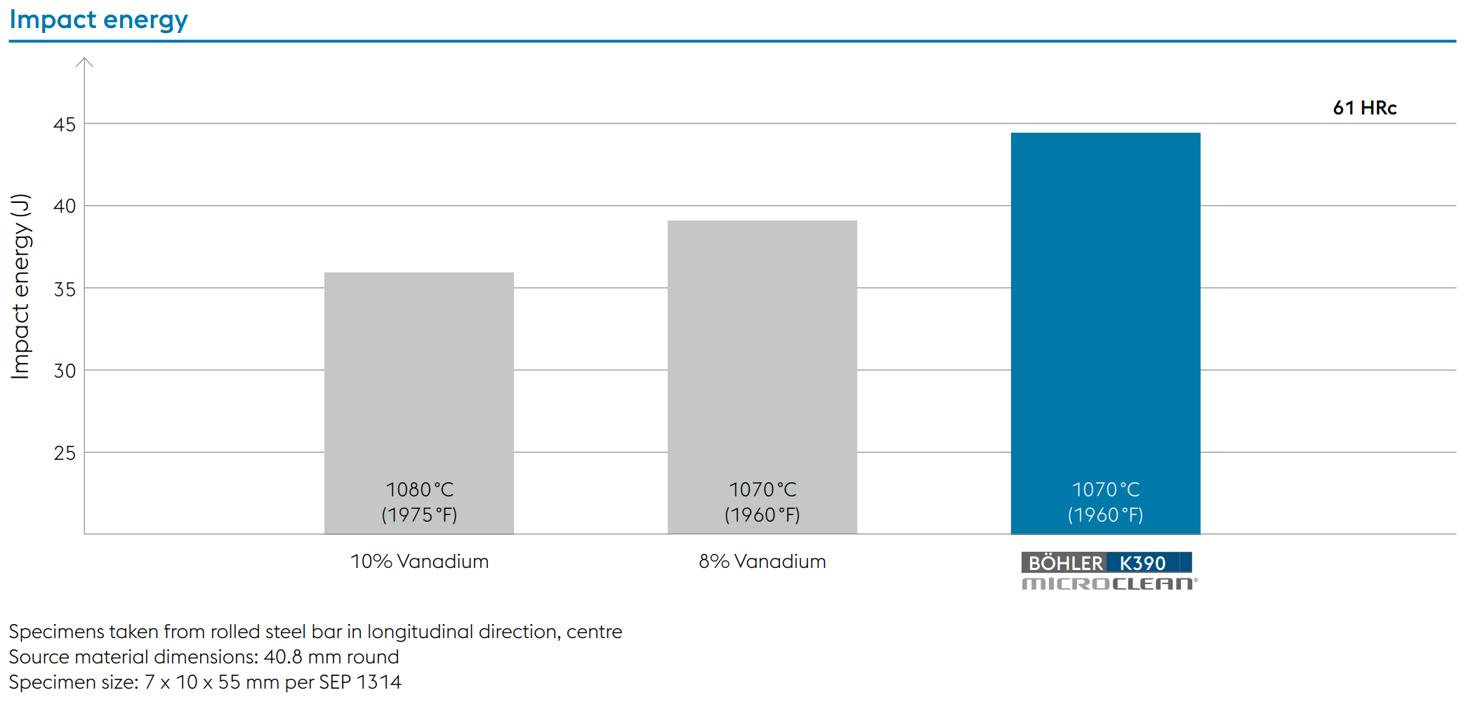

K390 was developed as an alternative to Crucible’s CPM-10V, which has had success since the late 1970s as a steel with very high wear resistance yet also moderate toughness. CPM-10V achieved these properties by having a relatively high volume of vanadium carbides, very hard carbides that contribute greatly to wear resistance. Because the carbides are so hard, it requires less of them for a certain level of wear resistance. Carbides are brittle, so having a lower volume of carbide for the same wear resistance means greater toughness. The patent application for K390 was submitted in Austria by Bohler in 2002 [1], and the steel was announced in 2004 [2]. The main modifications to CPM-10V were increased Mo, W, and Co. This gives K390 better “secondary hardening” and therefore “hot hardness” so that it can maintain its hardness at high temperatures. The higher Mo also gives it greater “hardenability” so that large dies can still harden all the way through.
Another comparison is Vanadis 8, which wasn’t released until 2017, which I have previously tested and written about. It is similar to K390 but with even lower vanadium (8%) and a simpler overall design without W and Co. With K390 having vanadium in between 10V and Vanadis 8 we would expect its wear resistance and toughness to also be between those two steels. However, the extra alloying elements could potentially throw some curveballs in there. In Bohler’s literature [3], they have charts showing K390 to have slightly worse wear resistance than CPM-10V but a substantial improvement in toughness, we will be testing that.
Bohler data on K390 vs CPM-10V (listed as 10% Vanadium) [3]

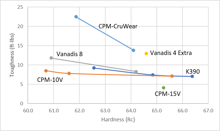

The new testing I did for this article was for toughness. I had previously tested the edge retention of K390 but the material I used was just a bit too thin for using for my standard toughness coupons. Pavlo, who is currently serving in the Ukranian military, sent me some thicker K390 for testing. After a few months he emailed me asking if I had a chance to test it yet which made me start to feel some guilt about not getting to it sooner for him but better late than never.
My “High alloy non-stainless” toughness chart has gotten crazy so I have shown a reduced chart for clarity. The rest of the steel toughness charts can be seen in the chart below for comparison. K390 is again quite close to Vanadis 8. It appears there might be a bit more separation at lower hardness but I didn’t have a coupon any lower than 62.6 Rc so we can’t see that for sure. Both do have an advantage over CPM-10V, which lines up approximately with the claimed properties from Bohler. So kudos to Bohler for having accurate values in their datasheet. Once above about 65 Rc, however, CPM-10V and K390 have similar toughness. This gives CPM-10V the advantage at high hardness because it has an advantage in slicing edge retention while having the same toughness. Comparing with some common PM stainless steels, K390 is similar in toughness to S35VN, CPM-154, Vanax, and XHP. This is significant because K390 has much higher wear resistance than those steels, so if the toughness of one of those steel is sufficient for the task, you can get much greater edge retention if sacrificing corrosion resistance is acceptable. K390 does have a significant advantage in toughness over the popular M390/20CV/204P stainless steel, so K390 has both better toughness and edge retention, though of course with much worse corrosion resistance. There aren’t any stainless knife steels available that can match the combination of toughness and wear resistance that K390, Vanadis 8, and CPM-10V offer.

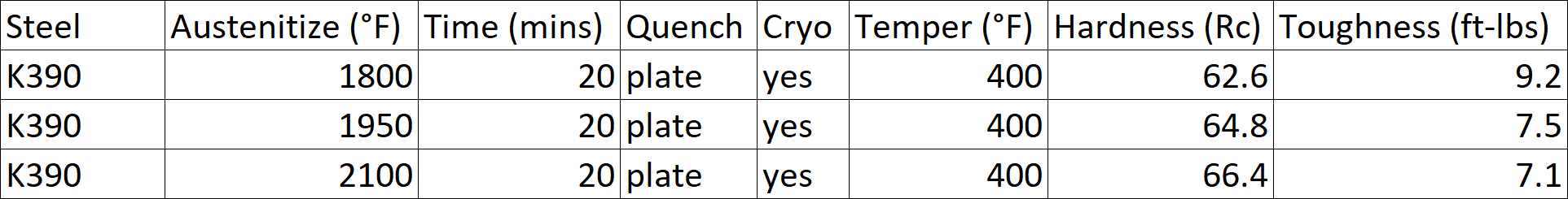

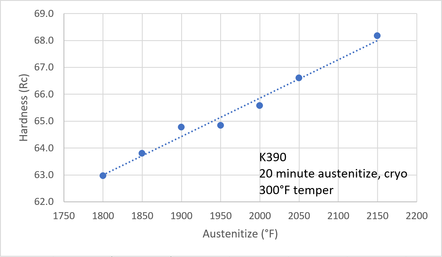

For knifemakers working with K390 I also have recommendations for how to heat treat the steel. The K390 datasheet recommends the “high temper” regime around 1025°F. However, in steels I have tested with low vs high temper I have found superior toughness with the low temper options. You can read two examples with CPM-CruWear and CPM-10V. Below shows prior coupons I tested with a range of austenitizing temperatures along with a tempering temperature of 300°F:
Surprisingly, the toughness coupons I tested, which had a 400°F temper, were only about 0.5 Rc lower than the 300°F temper shown above. I would anticipate 1-2 Rc lower by tempering at 400°F instead, so perhaps the K390 I used for the toughness tests was higher in carbon or some other composition difference. Given that the steel was still 62.5 Rc with 1800°F and 300°F, it may be possible to austenitize even lower than 1800°F for applications that work better in the 60 Rc range. When using cryo you can austenitize up to 2150°F or so for very high hardness. I did not measure coupons without cryo, so the top end austenitizing temperature is probably lower than 2150°F without it. Use a dry ice or a freezer if liquid nitrogen is not available. You would want to make your own “austenitize vs hardness” chart to ensure that the chosen austenitizing temperature isn’t too high. So to summarize the recommended heat treatment:
Austenitize 1800-2150°F for 20 minutes (thicker steel may need longer, the top end is likely too high without cryo)
Quench – I prefer a plate quench but the steel has pretty high hardenability so many different quenches would work
Cryo – Liquid nitrogen is best, dry ice is second best and freezer last
Temper – 400°F gives a good balance of hardness and toughness. Temper twice for two hours each time
