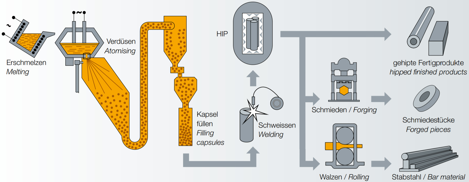

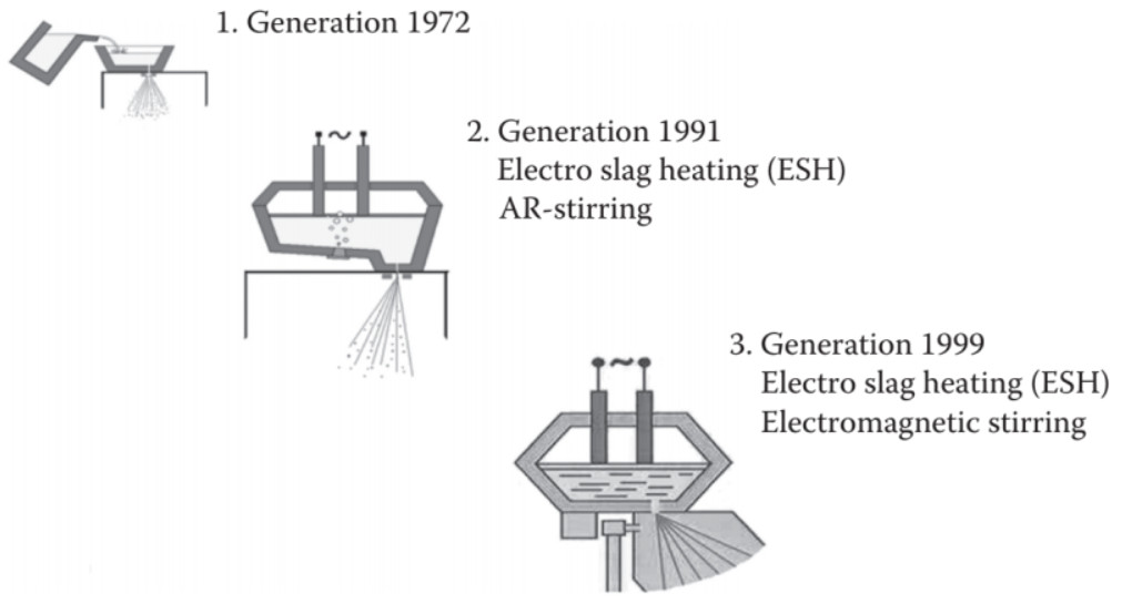

3rd Generation Powder Metallurgy Technology
Bohler-Uddeholm (now voestalpine High Performance Metals) have advertised their shared powder metallurgy technology as being a “3rd generation” version of powder metallurgy with an even finer powder size and fewer inclusions in the steel [1]. The powder size is about half of the size of the “1st gen” process which is claimed to lead to a decrease in carbide size even relative to the original powder metallurgy process performed by Crucible.
The difference in technology has to do with the “tundish” that the liquid steel is poured into prior to atomization. In the original process, the steel is poured into the tundish several times to make a whole batch of powder. On top of the liquid steel is where a layer of “slag” is formed of various oxides and other impurities, and we would like to avoid any slag getting into the final solidified product. However, during the re-pours it is possible for the slag to be pushed down into the liquid steel and through the atomization nozzle resulting in excess oxides in the final product.
Erasteel, maker of powder metallurgy ASP-series of steels and RWL34, produced a new powder metallurgy facility in the early 1990s which was developed to have a larger tundish. A large tundish alone does not solve all of the problems because the steel can solidify while it sits in the tundish waiting to be atomized into powder. So they also added graphite electrodes that keep the steel heated. A layer of conductive slag on the liquid steel surface allows the electrodes to heat the steel and offers some protection from the atmosphere. They also use argon gas stirring to maintain a consistent temperature. Erasteel’s process is called “2nd generation” by Bohler-Uddeholm. Erasteel around 2006 began advertising a further reduction in inclusion content through a process called “Dvalin” but very unhelpfully they never say what that process is, just that it exists and makes the steel better. Below shows their values for inclusions with 1st gen “PM”, 2nd gen “ESH” and whatever Dvalin is:
Image from [3]
When Bohler-Uddeholm built their plant around 1999 they used a very similar process but instead of argon gas stirring they used electromagnetic stirring which is somewhat superior to argon stirring. The B-U process also directly encapsulates the powder for the HIP process to avoid effects of handling powder, since sand and other impurities can end up in the powder, and the high surface area powder is prone to oxidation. The finer powder size results from a reduced nozzle size for a slower atomization process which provides fine powder without requiring sieving. The heating of the tundish with electrodes allows the longer process to take place for the finer powder.

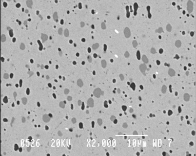

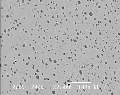

Effect of Composition and Carbide Type
You may notice that the carbide size is more different between M390 and Vanadis 4 Extra than between 4V and Vanadis 4 Extra. In other words, the steel composition is more important for carbide size than the production process. One major difference between M390 and Vanadis 4 Extra is that M390 has a large volume of chromium carbides while Vanadis 4 Extra is exclusively vanadium carbide after heat treatment. After atomization, the two carbide types (vanadium and chromium) are similar in size, but during the HIP and forging processes the chromium carbides coarsen more rapidly than vanadium carbides. Therefore it is the resistance to coarsening of the carbides that primarily controls the final size of the carbides. For a given carbide type, the greater the volume of the carbides the larger they are as well. You can read about different carbide types in this article. Chromium carbides (M7C3 and M23C6) and molybdenum/tungsten carbides (M6C) coarsen the fastest, and vanadium carbides (MC) coarsen much more slowly. Nitrides [6] and niobium carbides [7] coarsen even slower than vanadium carbides.
Uddeholm has redeveloped several of their steels over the past couple decades to reduce or eliminate the Cr and Mo/W carbides so that the overall carbide size is reduced. One example is Vanadis 4 Extra which was a redesigned Vanadis 4 with reduced chromium content to eliminate chromium carbides. Vanadis 8 is a replacement of Vanadis 6 and Vanadis 10, again with reduced chromium content. And Vancron Superclean is a replacement of Vancron 40 with reduced Mo to eliminate Mo carbides. Below shows micrographs of Vanadis 4 Extra and Vanadis 4 where you can see the carbide size difference. The chromium carbides are grey and the black carbides are MC (vanadium); the chromium carbides are larger than than the vanadium carbides.
Original Vanadis 4 with larger chromium carbides (grey)
Vanadis 4 Extra with a more uniform carbide size lacking in chromium carbides
There are many older powder metallurgy steels which were designed with this fact in mind, however. 10V was one of the earliest powder metallurgy steels, being patented in the 1970s, which is lacking in chromium carbides after heat treatment. The difficulty in eliminating chromium carbides in stainless steels is part of the reason why the non-stainless tool steels like 3V, 4V, Vanadis 4 Extra, 10V, etc. have  better toughness for a given level of wear resistance.

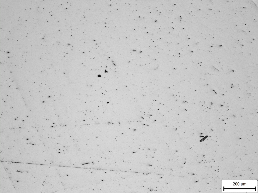

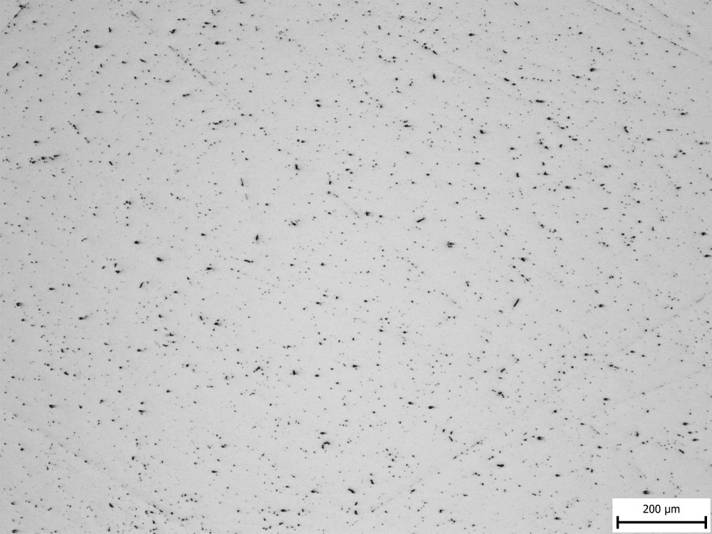

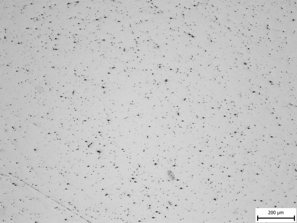

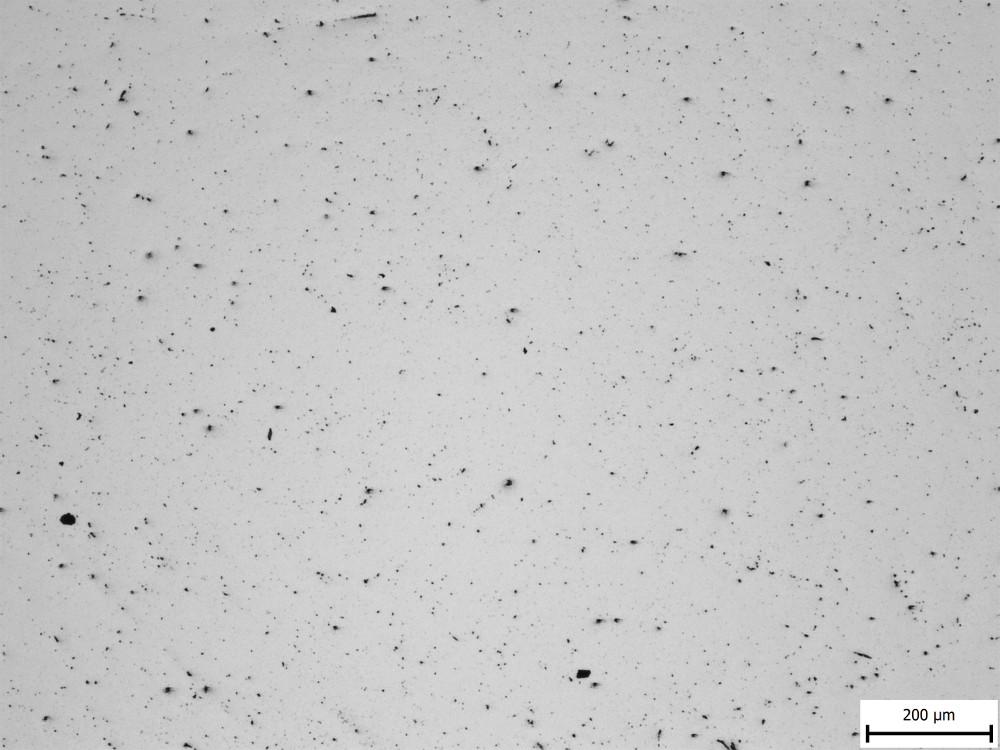

Micrographs

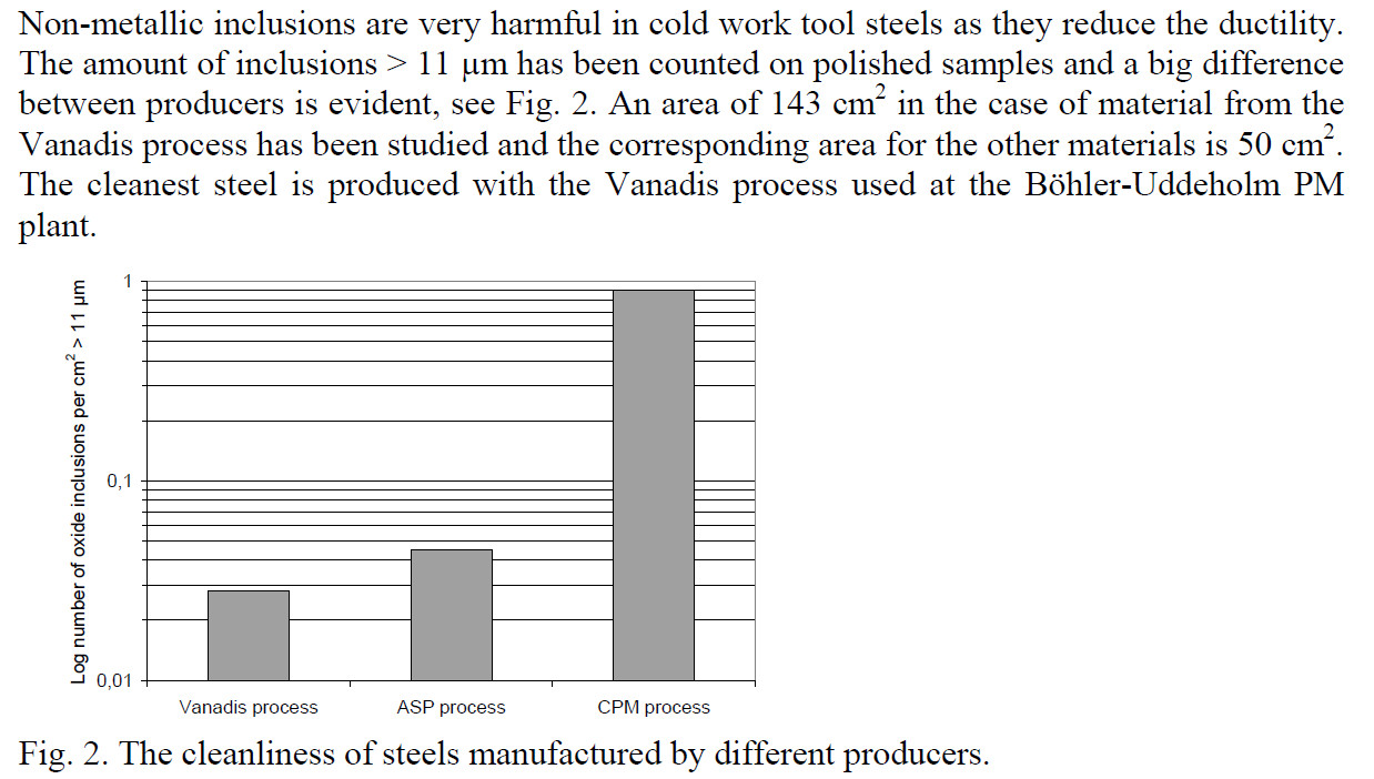

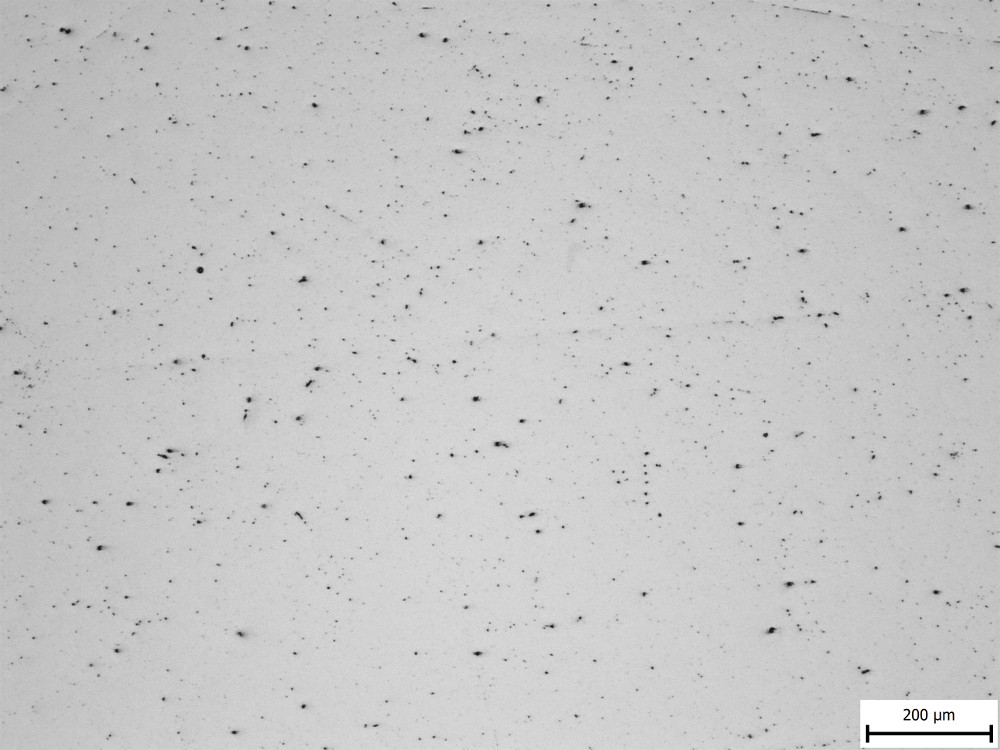

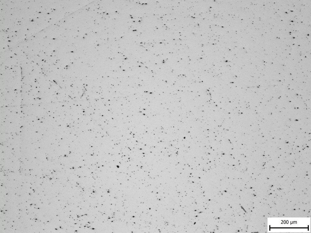

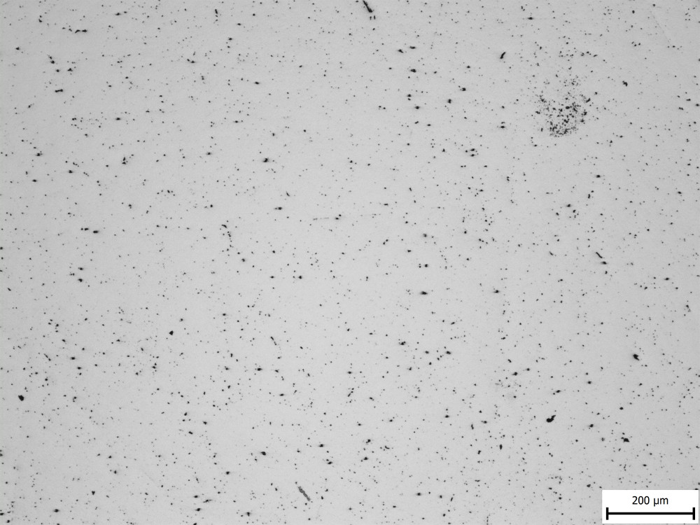

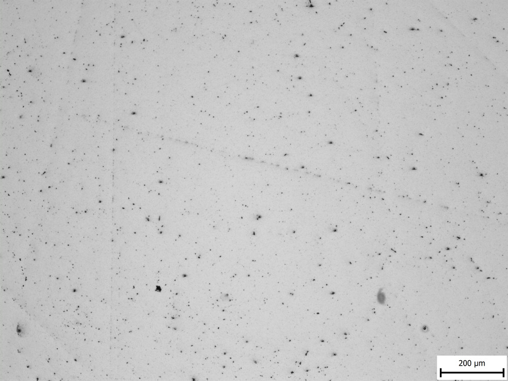

I also took micrographs for each of these four steels. When steel is polished (without etching) and imaged with microscopy, the inclusions show up as black features. This allows the observation of the size and distribution of the inclusions in each of the steels. Showing representative images is somewhat difficult because there is a statistical distribution of inclusions. For example, see this data on oxide inclusions from Bohler-Uddeholm intended to demonstrate the superiority of their product:
Image from [1]
They counted inclusions that were larger than 11 microns, and even in the “bad” example of Crucible steel they still measured less than one inclusion of such a size per square centimeter, which is a relatively large area in microstructure terms. So I am showing two images from each steel to get a slightly better feel of the inclusions, at the lowest magnification the microscope had:
Crucible 20CV
Carpenter 204P
Bohler M390
Uddeholm Elmax
Interestingly I did not see any MnS elongated in the rolling direction, perhaps the powder metallurgy process makes them small enough that they are not as noticeable as in conventional steels. The overall “volume” of inclusions appears very similar, probably because the sulfide content is similar between them. There appears to be a greater density of inclusions in the Bohler-Uddeholm steels, however, which makes sense given the previous diagram where they emphasized the number of relatively large oxides. None of the steels looks especially “clean” when observed in this way, however. It may be that the occasional larger inclusions show up more frequently in the Crucible and Carpenter steels though I did not look at such a large area as what B-U reportedly observed. The size of the inclusions may be significant, because the larger the inclusion the easier crack initiation is at the oxide. When the oxides are larger than the carbides then the easiest point for crack initiation is the oxide rather than the carbides.

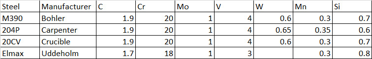

Other Elements
I also made a comparison between a few of the “extra” elements in the steel which are not listed in the datasheet. There are also unintentional “impurity” levels of many elements, and some may be higher because of the use of recycled steel, such as nickel which is usually present around 0.2% in recycled steel.
One interesting difference is nitrogen, where it appears that Bohler and Carpenter are making an intentional addition of about 0.2% while Crucible with 0.07% is probably an incidental level from the atmosphere and the nitrogen gas used in atomization. A nitrogen measurement of M390 from 1995 reported 0.11% in one heat and 0.15% in another [10]. So I wonder if the nitrogen level has been intentionally raised since then or if there is simply wide variation in nitrogen levels with M390. The 0.11% in Elmax may also be the result of a small intentional addition. The small increase in nitrogen with M390 and 204P helps some with achieving higher hardness, it may also lead to a small increase in corrosion resistance and wear resistance.
Another interesting difference is the higher Co content in the Bohler-Uddeholm steels, and the relatively high tungsten content in Elmax which is not an intentional addition according to the datasheet. Typically recycled steels have less than 0.1% tungsten. This higher Co and W content may mean than Bohler-Uddeholm is using some percentage of recycled high speed steels that Carpenter and Crucible are avoiding. High speed steels are more likely to be alloyed with Co and W. However, the amount of those elements probably has little effect on the final properties.

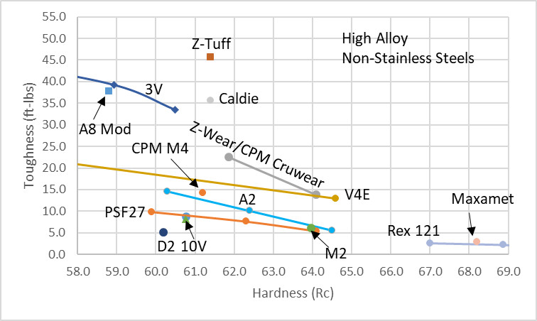

Resulting Properties
Does any of this matter then? The impurity and inclusion content is not going to affect edge retention, after all. However, as mentioned above, the inclusion content may affect the resulting toughness. We have done a couple comparisons between the toughness of similar steels from different manufacturers, such as Bohler M390 and Crucible 20CV. In that case the toughness was essentially identical, the small difference is probably just due to experimental variability. Each was given the same heat treatment of 2140°F austenitize, plate quench, cryo, and 365°F temper. The small difference in hardness may be the result of the nitrogen difference or possibly just variation between heat treatments or composition between heats of steel.
We also have some comparisons between Uddeholm Vanadis 4 Extra and Crucible 4V but have only condition that is identical between the two, because we had some specimens that ended up being undersized and could not be machined for testing. We tested both longitudinal and transverse specimens because transverse specimens are typically lower in toughness and may reveal superiority in carbide size, inclusions, or processing. For transverse specimens that were heat treated with a 1975°F austenitize, plate quench, cryo, and 400°F temper, the 4V had significantly better toughness (12 vs 9 ft-lbs), though at slightly lower hardness, and the toughness was only slightly less than the longitudinal Vanadis 4 Extra (13 ft-lbs). On an unrelated note, the 1000°F temper of 4V led to lower toughness than the 400°F temper, which was also found with CPM CruWear/Z-Wear.
I think the superior toughness of 4V is due to the minor differences in composition leading to lower “carbon in solution” rather than superior processing technology by either company. However, this comparison illustrates that B-U steels do not necessarily have superior toughness.
Therefore in our testing we did not find better toughness of Bohler-Uddeholm steels than Crucible steels. This may be because of the very low number of larger oxide inclusions, even in the Crucible steel. When there is only roughly 1 medium or large oxide in a square centimeter, that oxide is unlikely to be in the volume of steel being tested for toughness. Or it could be that the carbides are the limiting factor for toughness rather than the oxide inclusions simply because there is such a significant volume of carbides. The highest toughness powder metallurgy steel we have tested was Z-Tuff/CD1 which is produced by Carpenter. Carpenter had the highest oxygen we tested, at least in the case of 204P. Crucible-produced 3V also had excellent toughness. Both of those steels gain their high toughness through low carbide content rather than differences in oxides.

  3. Your discussion of trace tungsten content contradicts the values in the table:
    “the relatively high tungsten content in Elmax which is not an intentional addition according to the datasheet. Typically recycled steels have less than 0.1% tungsten. This higher Co and W content may mean than Bohler-Uddeholm is using some percentage of recycled high speed steels that Carpenter and Crucible are avoiding.”
    Elmax had the *lowest* tungsten content according to the table, at 0.20%. Crucible had the highest level, at 0.49%. Carpenter was also high at 0.41%. So it can’t be the case that Carpenter and Crucible are avoiding recycled high-speed steels if those steels are supposed to be high in tungsten, since their steels here are also high in tungsten (high for “trace” levels – roughly 0.5% is surprisingly high to me, given how expensive tungsten is…)
    1. Hi Joe. 20CV/M390/204P have an intentional tungsten addition according to each steel’s datasheet while Elmax does not. Other Crucible steels have much lower tungsten.
