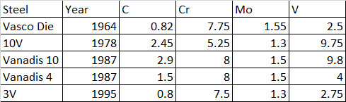

But Vanadis 8 was not Uddeholm’s first attempt at a competitor for CPM-10V. The first was Vanadis 10, which appears to have existed from the late 80s or perhaps the early 90s. I have not found a patent for Vanadis 10 but the composition of the steel was shown in a patent for Vanadis 4 which was filed in 1987 [1]. Vanadis 4 was not the same as the current Vanadis 4 Extra. Both Vanadis 4 and Vanadis 10 used a base composition of 8% Cr and 1.5% Mo plus vanadium and carbon for hard vanadium carbides. This 8% Cr-Mo basis started with Vasco Die in 1964, which led to other steels like CPM-3V, CPM-CruWear, Sleipner, and Z-Tuff/CD#1. CPM-3V is a powder metallurgy version of Vasco Die, which is why CPM-3V, Vanadis 4 (original), and Vanadis 10 all look like they are from the same series of steels, just with different levels of vanadium to control the balance of wear resistance and toughness.
Vanadis 4 Extra
The problem with Vanadis 4 and Vanadis 10 is the high chromium content led to a significant amount of chromium carbides. Chromium carbides grow to larger sizes than vanadium carbides in powder metallurgy steels which reduces toughness. Because chromium carbides are softer than vanadium carbides, they also provide less of an increase in wear resistance for a given amount of carbide. So a microstructure of only vanadium carbides is best for the highest combination of toughness and wear resistance. CPM-10V had only vanadium carbide and less overall carbide than Vanadis 10 so it had significantly better toughness than Vanadis 10. This put Uddeholm at a disadvantage with the prior product.
Uddeholm first redesigned their Vanadis 4, however, with the patent being filed around 2002 [2] and the first articles about the steel around 2004 [3]. Vanadis 4 had about 6% each of vanadium and chromium carbide for a total of 12%, while Vanadis 4 Extra has about 8% vanadium carbide. The overall carbide size was reduced by eliminating the chromium carbides. The toughness was improved by a decrease in the total carbide and a reduction in carbide size. The abrasive wear resistance was only slightly reduced compared with Vanadis 4 by the reduction in carbide volume, because the Extra version is entirely made up of the harder vanadium carbides.

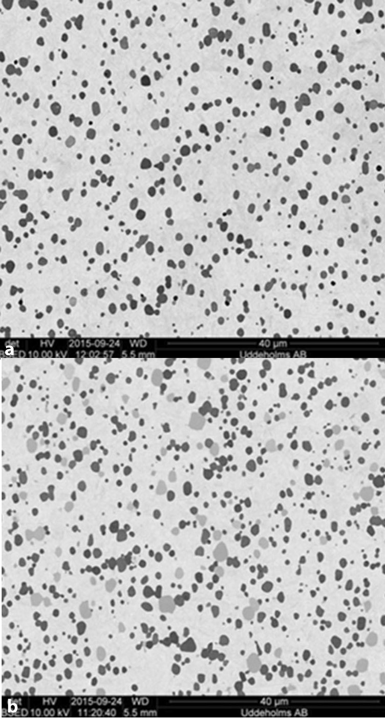

The new composition avoids chromium carbides which means that toughness is improved compared with the earlier Vanadis 10 as shown in the micrographs below where Vanadis 8 is top and Vanadis 10 is bottom. In Vanadis 10 many chromium carbides are visible (light grey) which are somewhat larger than the vanadium carbides. Vanadis 8 was calculated to have about 15.8% vanadium carbide by Uddeholm, and 17.2% vanadium carbide in CPM-10V. Therefore we would expect Vanadis 8 to have a bit better toughness than 10V at the cost of a little wear resistance.
Micrographs are from [5]

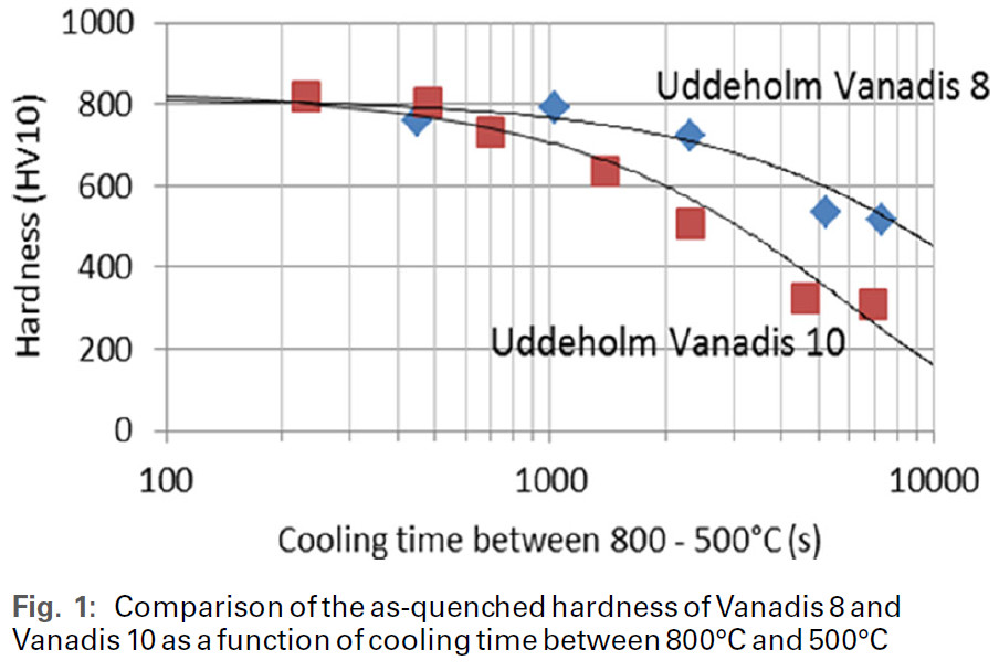

Their article on Vanadis 8 also pointed out the hardenability improvement in Vanadis 8 over the earlier 10 due to the increased Mo. And this would also be true in comparison with 10V which has only 1.3% Mo. So the steel can be cooled more slowly and still achieve full hardness.

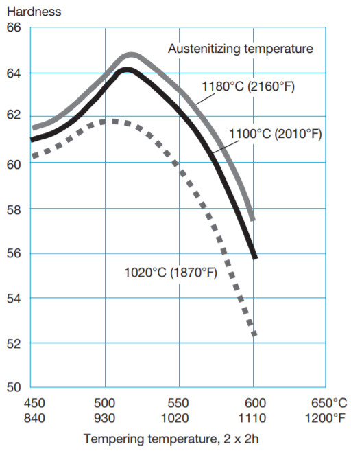

Heat Treatment of Vanadis 8

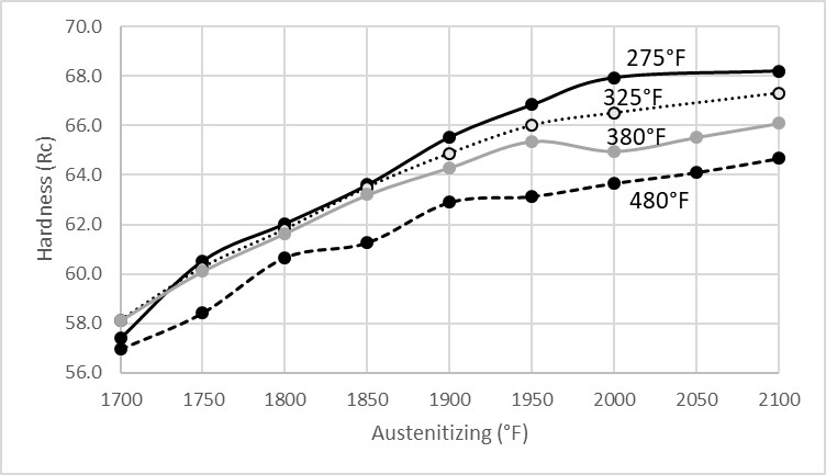

The Vanadis 8 datasheet recommends austenitizing between 1870 and 2150°F (1020-1180°C) and tempering at 1000°F or higher, though it also notes that you can get a little higher hardness at 970°F but says not to go lower than that.
Those are recommendations for the secondary hardening range, however. That range is preferred by steel companies because of it reduces retained austenite without cryo, and improves hot hardness to help prevent softening when grinding or applying high temperature coatings. I prefer tempering in the low temperature range (<750°F) because it has resulted in higher toughness for several steels including CPM-CruWear and CPM-10V. I did a range of hardness coupons with Vanadis 8 to characterize its hardness with low temperature tempering because it is not available in the datasheet, the results are below. I austenitized each piece for 30 minutes, plate quenched, then liquid nitrogen, followed by two tempers 2 hours each.
The steel is capable of very high hardness, as expected, easily exceeding 64 Rc even when tempering at 400°F. So the steel can be heat treated to a range of hardness values depending on the desired properties.The low temper plus cryo also leads to higher potential hardness than the upper temper shown in the datasheet.

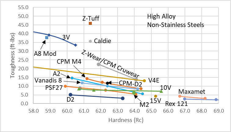

I also tested the toughness of Vanadis 8 using our standard subsize unnotched charpy specimens. Using 1850-500 resulted in 60.9 Rc and 1950-400 resulted in 64.2 Rc. Those hardness values are consistent with the hardness curves I generated. The toughness results are shown in the following section.

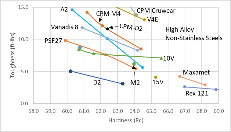

The toughness of Vanadis 8 compared with other high alloy tool steels is shown in the following charts, one chart showing all steels and the other cutoff at 15 ft-lbs to show the comparison better with other steels in a similar toughness range. The toughness of Vanadis 8 is confirmed to be superior to CPM-10V. At ~61 Rc the Vanadis 8 is an impressive 39% better than 10V, though this is much less than the 3.7x increase claimed in the patent.

Because of its very good toughness for its wear resistance class, Vanadis 8 looks very good for toughness-edge retention balance. It has better toughness than any PM stainless steel (blue circles), including S35VN, Vanax, or CPM-154, but with significantly better edge retention than those steels. And better toughness and edge retention than popular steels M390 and S30V. So if stainless levels of corrosion resistance are not required it offers an attractive combination of properties. For higher levels of toughness, a steel like CPM-M4, Vanadis 4 Extra, CPM-CruWear, or CPM-3V would be better choices. In my book Knife Engineering, and in my previous article on recommended steel choices, I put CPM-10V as the recommendation for high alloy non-stainless with high edge retention. However, that was before I had completed toughness experiments with Vanadis 8. Because of its superior toughness with only a small decrease in edge retention, Vanadis 8 probably takes that spot for me now. The main downside for Vanadis 8 is availability; it is not widely available from knife steel suppliers currently. The two suppliers I know of are USA Knifemaker and Eurotechni, but even at those it is only available in a single thickness. So I would still recommend CPM-10V, it is still a good steel, but if Vanadis 8 becomes more available I say buy it.
