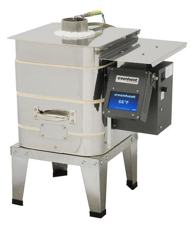

Salt Pots and What I Used
“Salt bath” or “salt pot” heat treating refers to the use of molten salts for heating steel. Specific salts are used for different temperature ranges, so that they melt under the necessary temperature without certain bad things happening by overheating them. For these experiments I used “Neutral Salt B” by Hubbard-Hall which I purchased from High Temp Tools: https://hightemptools.com/products/high-temperature-salt  They list the working range as 1300-1700°F but also says 1700 can only be used for short periods of time. I have also used low temperature salts for austempering which is a totally different use of salt pots; you can read those experiments here. Of course I used a different low temperature salt for those austempering experiments, which you can also buy from High Temp Tools. If you are using molten salts to heat treat stainless or high speed steels you will also need different salts as that would need higher temperatures. These salts are certainly available; salt pot heat treating of high speed steel is actually pretty common, but I don’t know where to buy small amounts of them. If you know a good source let us all know in the comments.
The furnace I used was the EvenHeat Salt Bath 709 which accomodates a 9″ long pot (plus extra that sticks out), though they are also available in larger sizes. There is a control thermocouple within the furnace as well as within the pot itself. So when operating the furnace you heat to the target temperature using the furnace thermocouple first and wait for the salt to melt. Then you insert the second thermocouple into the molten salt and tell the controller to switch modes to the second thermocouple.

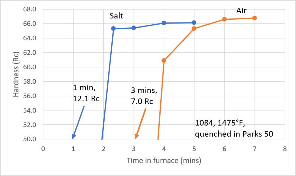

Time to Heat Steel in Molten Salt vs Air

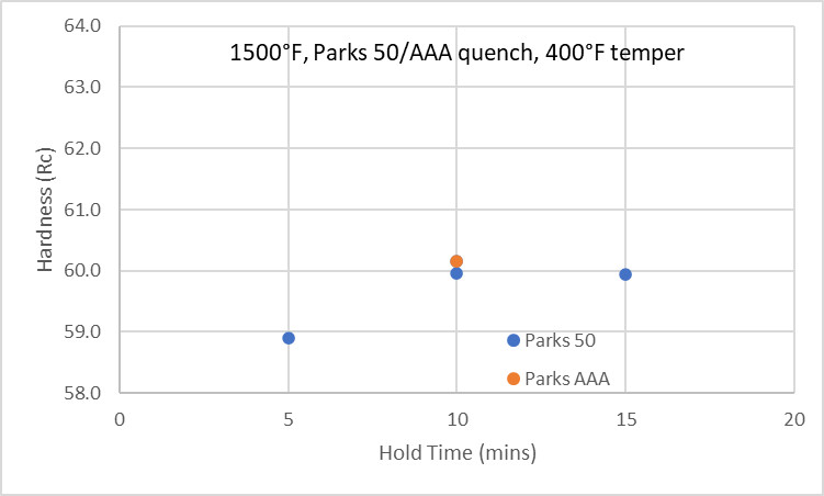

As I mentioned, one of the big benefits of salt pots is the shorter time required for heating the steel. To test this I used 1/8 x 1-1/2 x 2-1/4 inch (3.3 x 40 x 55 mm) coupons of 1084 and used 1 minute increments (separate coupons for the different hold times). This is total time in the furnace, not soak time at temperature. Of course, larger coupons would take longer to heat up. I then did the same experiments by using my normal furnace where the coupon was heated in air:
Unfortunately I was a bit late on the 2 minute coupon and it was actually 2 minutes and 20 seconds, so we can’t see exactly how long it took to heat up the steel with the salt pot. But certainly by 3 minutes the steel had reached the target temperature. There was then a small increase in hardness up to 4-5 minutes in the salt as more carbide dissolved. With a 3 minute hold in the conventional furnace the hardness didn’t change at all, meaning it still hadn’t formed any austenite (somewhere under 1335°F/723°C or so). It wasn’t until 5-6 minutes that the steel reached the target temperature. So you can save a few minutes of heat treating time when using salt instead of air. How much this matters will depend on the individual, of course.
The required time to dissolve carbides also depends on the temperature. Below shows published micrographs of 1080 steel [1] with different hold times at only 730°C (1346°F) where it took 5 minutes just to transform the steel to austenite (g), and then another ten minutes to dissolve most of the carbide (h). You can also see how the transformation happened, as the white ferrite was replaced by dark martensite (austenite at high temperature before quenching) with increasing hold time. Then more carbide (white particles) were dissolved with further hold time. You can read more about how this happens in this article on austenitizing.

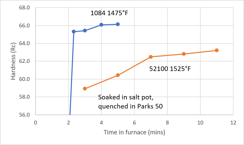

Time to Heat vs Time to Soak

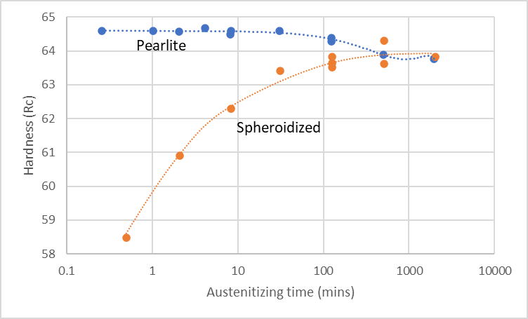

1084 is a simple steel with only carbon, manganese, and silicon added to it. The main element that needs to diffuse for transforming the steel to austenite is carbon. Carbon is a very small element and therefore it diffuses very fast. However, when other alloying elements are added it can lead to significantly longer times required for austenitizing. I used 52100 with the factory-annealed condition to illustrate this. 52100 has 1.5% chromium which significantly slows down the time for carbides to dissolve, even at a higher temperature of 1525°F (830°C):
While the 1084 was nearly 66 Rc after only 3 minutes, 52100 with the same hold time at 50°F higher temperature was only 59 Rc. This isn’t because the steel didn’t heat up as fast but because the carbides in the steel did not dissolve as quickly from the chromium addition. The hardness didn’t “level off” until 7+ minutes in the molten salt, and was still climbing after 11 minutes. This is partly why I recommend having a sufficiently long soak time to ensure that you reach a steady state before quenching. Sometimes knifemakers in my comments will ask why I am soaking for so long (10-30 minutes) and say that they only use 5 minutes or even shorter. That results in poor consistency because the hardness can change significantly with a small change in soak time. This also means that the heat treatment becomes very sensitive to the size of the piece as well. Maintaining the same time but with different sized knives would yield very different results.
Another thing to note is that this was with the factory-annealed condition, with relatively coarse spheroidized (round) carbides. The austenitizing time could be shorter with a different starting microstructure. I wrote about this difference and how to use it with forge heat treating here: How to Thermal Cycle Knife Steel. Below shows the difference between pearlite and spheroidized carbides for austenitizing 52100:

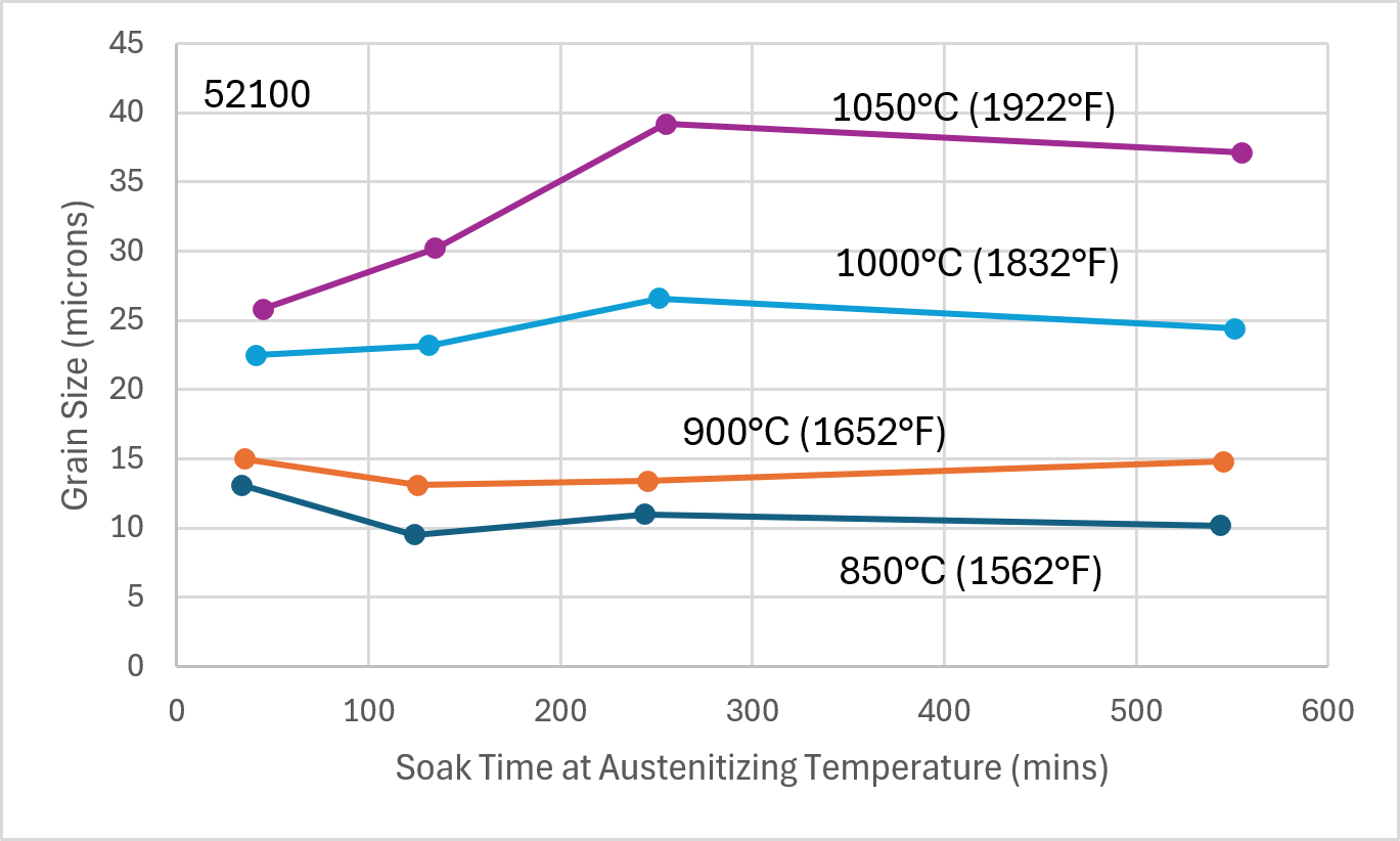

Temperature matters much more than soak time for grain size, and in general you don’t need to be afraid of grain growth with a longer soak. Here is a study on 52100 [3] that illustrates this:
Data adapted from [3]

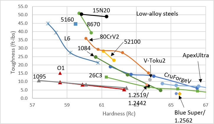

The big surprise was the triple quench which resulted in much lower toughness than the other two heat treatments. The ~11 ft-lbs of the triple quench makes the steel much closer to 1095 and O1, significantly higher carbon steels (~0.95% carbon), which were around 8 ft-lbs at the same hardness:
The older 1084 datapoints on this chart are slightly lower than these new values. That 1084 was from a different steel manufacturer.

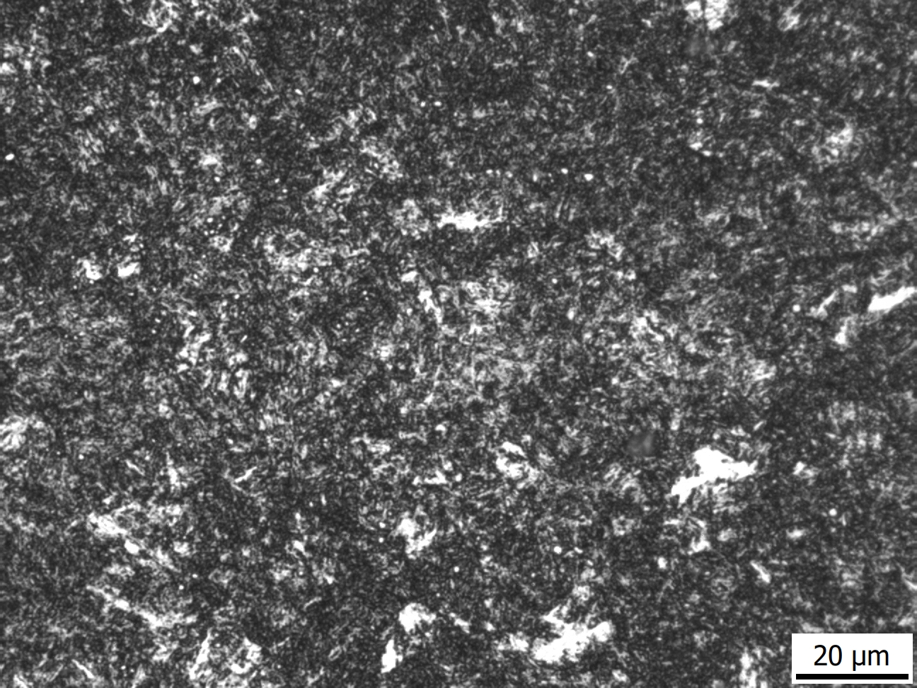

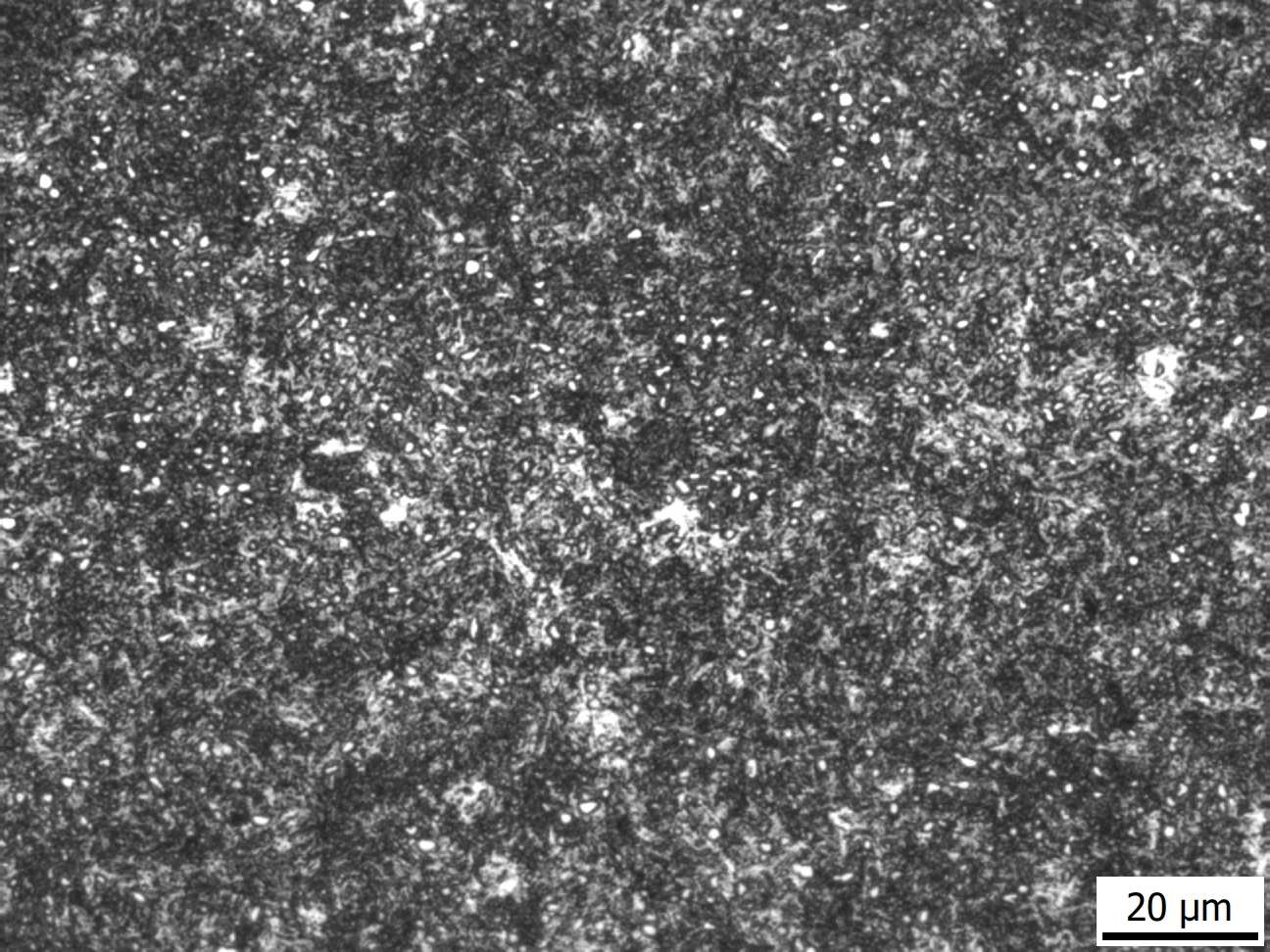

The fracture grain of the single and triple quenched 1084 was very fine, so I knew the drop in toughness was not from significant grain growth. So I decided to look at the microstructure of the two conditions:
Single Quench 1084 (3 minutes in 1475°F salt)
“Triple Quenched” 1084 (3 minutes in 1475°F and quenched, repeated)
The main thing I noticed is that there was much more carbide in the single quench version. This makes some sense given that it had 1/3 the total soak time. However, the ten minute in air condition had a similar soak time and did not have a significant drop in toughness. It appears that performing the austenitize and soak repeatedly led to more rapid carbide dissolution than a single soak. Heat treating from a martensitic condition (after quenching the first time) is known to lead to more rapid austenite formation, so I believe this is what happened with the multiple quench. With more carbide dissolved, this put more carbon in solution which also reduces toughness for a given hardness. This is the same reason why O1 and 1095 have lower toughness, because they had high carbon in solution with the same 1475°F ten minute soak. You can read more about this (and some things that can be done to improve toughness with high carbon steels), in this article about austempering.

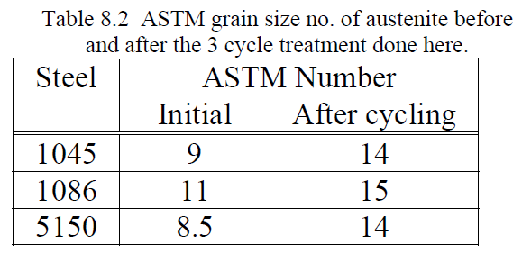

There is an experiment reported by Dr. John Verhoeven in his book Steel Metallurgy for the Non-Metallurgist [4] that he wrote for knifemakers and bladesmiths. He tried it with 1045, 1086, and 5150 low alloy steels. First he heated the steels to 1650°F for 15 minutes and quenched in oil. This was the starting condition where he measured the grain size. Then he heated each steel to 1450°F for 4 minutes in a salt pot and quenched in oil, repeating the procedure two more times (triple quench). He found a decrease in grain size relative to the initial condition after the 1650°F and quench (larger ASTM number means finer grain size):
In this case his results make sense given that the 1650°F austenitize would definitely result in a larger grain size. The repeated cycles at 1450°F were beneficial in refining the grain size, though the result from one or two cycles was not tested. So I think it makes sense for this particular experiment to show a finer grain size from a rapid salt pot “triple quench” while my toughness experiments did not show an improvement. It is also possible that my triple quench actually did improve the grain size but the higher carbon in solution was a more important factor. Measuring very fine grain sizes is difficult.
