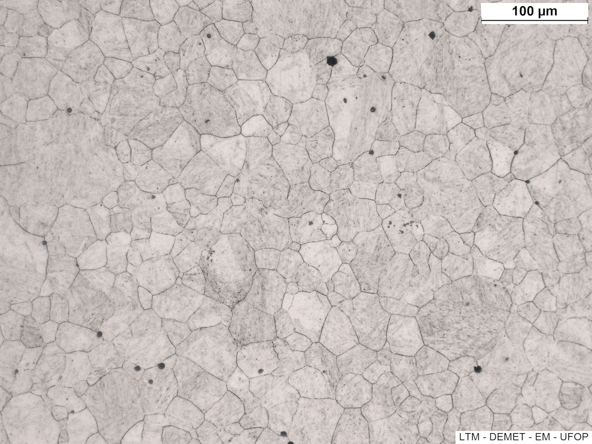

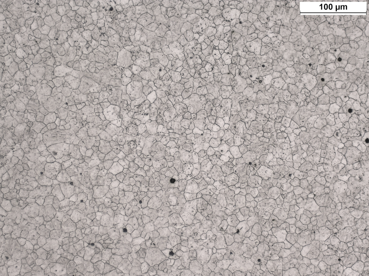

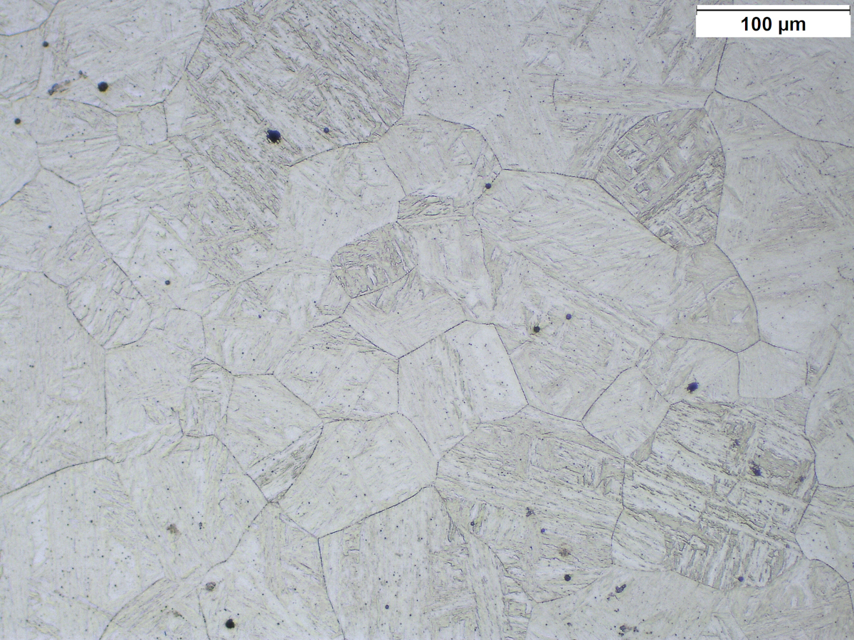

Grain Size after Forging

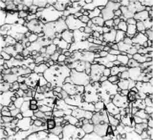

One change that occurs during forging is grain growth. Forging is typically done from very high temperature and with low alloy steels grain growth is very rapid in that temperature range. The amount (and speed) of deformation during forging a knife is not typically great enough to compensate for the effects of temperature. So after forging the grain size is typically relatively large. Here are example micrographs of a low carbon steel after being heated to different temperatures [1]. This steel actually has some micro-alloy added to it to help prevent grain growth so these grains are probably smaller than would be found in steels like 1095 after heating to the same temperatures.
920°C (1685°F) [1]
1000°C (1830°F) [1]
1150°C (2100°F) [1]
1300°C (2370°F) [1]

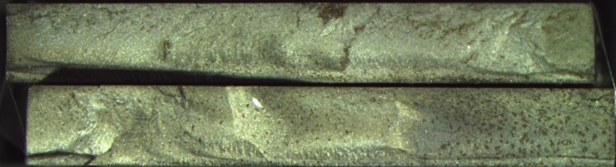

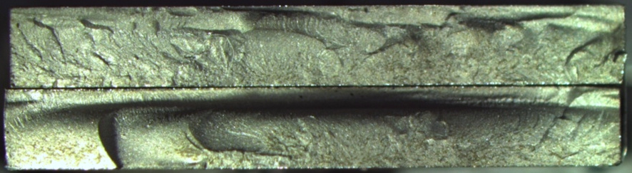

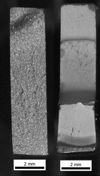

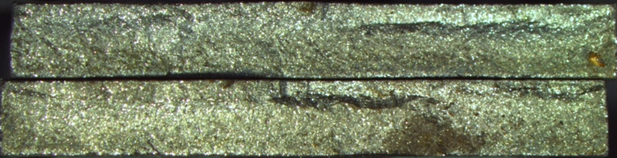

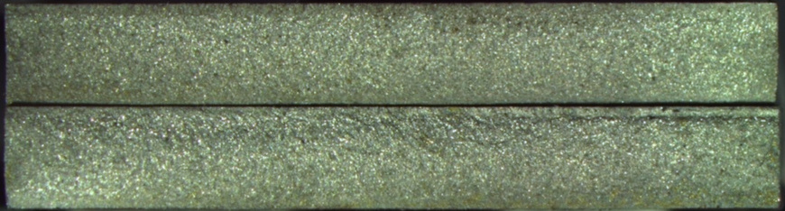

Another method for estimating grain size is looking at the “fracture grain.” If you break a piece of steel in a brittle condition the appearance of the fracture will correlate with its grain size. The steel must be brittle. Tempered steel and especially soft/annealed/normalized steel will break in a ductile fashion and the fracture will not correlate with the grain size. Below are example fractures from 1084 which were heated to different temperatures for 10 minutes, quenched, and then broken.
1475°F (800°C)
1700°F (925°C)
2000°F (1095°C)
A completely smooth specimen is given a fracture grain size rating of 10 and the coarsest possible appearance is given a rating of 1. This also correlates with ASTM grain sizes. A fracture rating of 10 is approximately equivalent to an ASTM grain size of 10. The ASTM grain size can be converted to an average grain diameter using charts that are available everywhere or by using the conversion equation. Below shows fracture grain size vs temperature for a range of different tool steels. The simple carbon steel W1 sees grain growth at relatively low temperature as you can see. Adding some alloy such as in O7 which has W, V, and Cr leads to less grain growth. A high alloy steel like D2 or T1 sees grain growth at much higher temperatures.

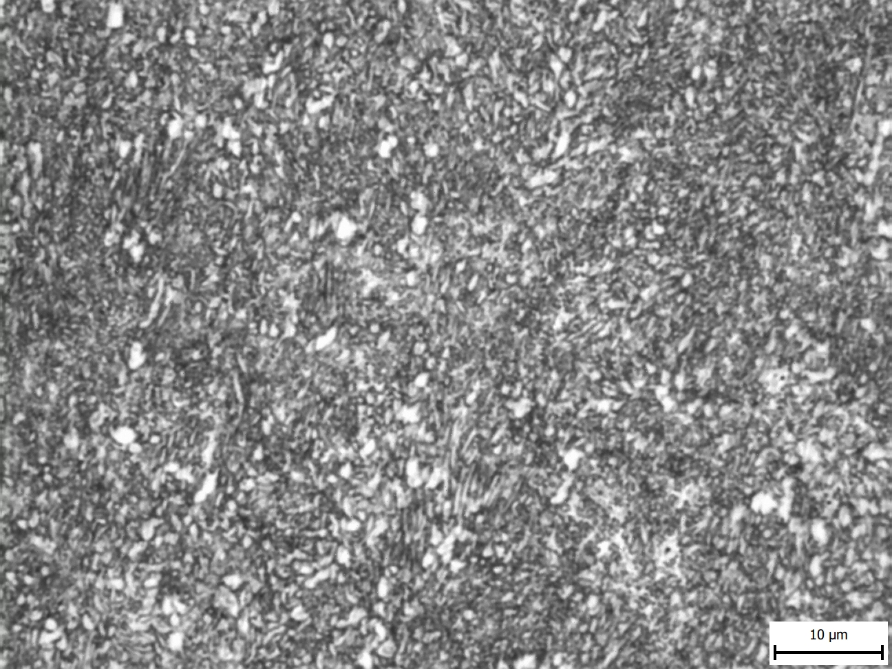

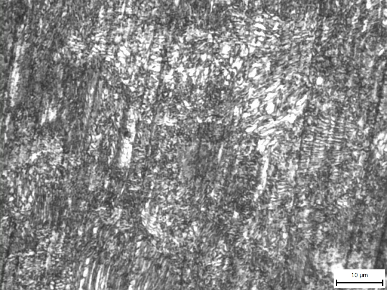

Microstructure After Forging

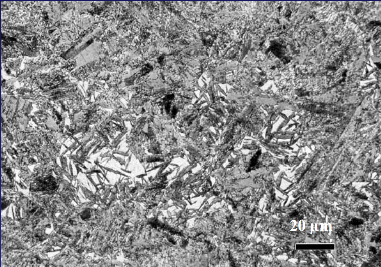

The microstructure in terms of what phases are present can vary quite a bit after forging. Mixtures of pearlite, ferrite, austenite, martensite, and carbide can be found with different distributions depending on the forging process, steel, and how fast it was cooled after forging. Below shows the inconsistent microstructure found in O1 and L6 steels after forging.
O1 after forging [3]
L6 after forging [3]

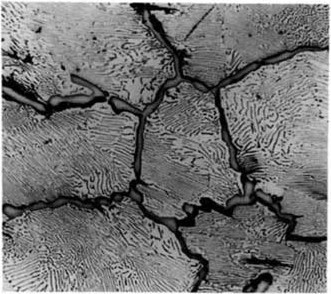

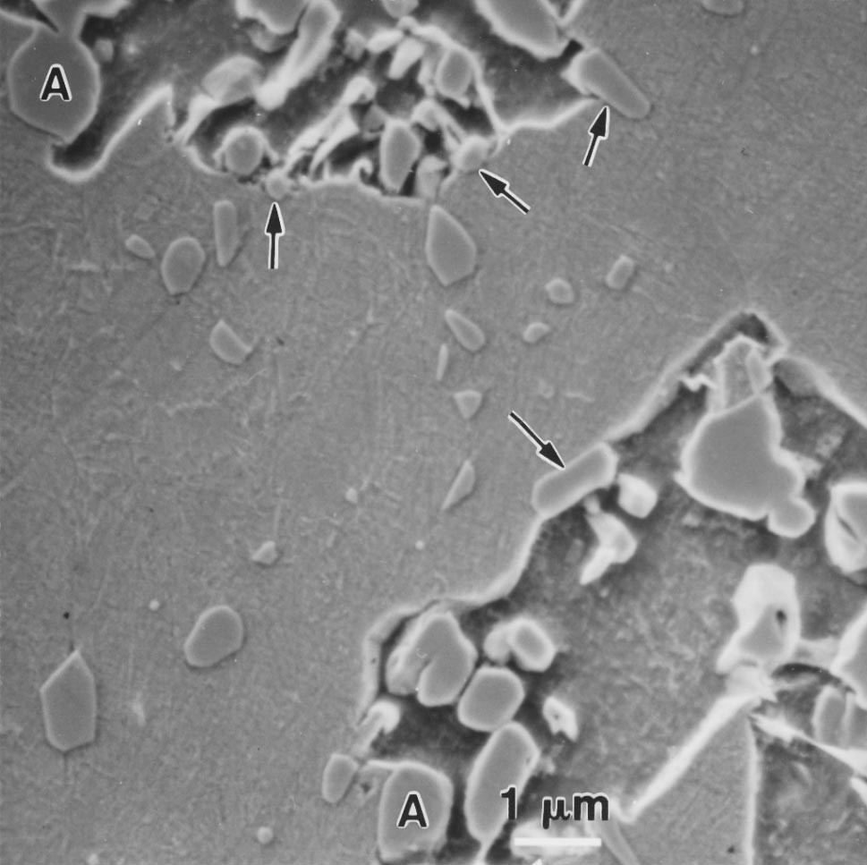

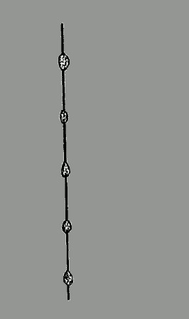

Grain Boundary Carbides
Another issue that can happen with steels during forging is the formation of carbides along the grain boundaries. These are detrimental to toughness and we definitely want to eliminate them.
Carbides on grain boundaries [4]

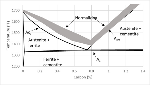

So in normalizing we want to reduce the grain size from forging, achieve a consistent microstructure, and eliminate grain boundary carbide. While using low temperatures is best for fine grains, the most important thing we need to do is dissolve everything so we can eliminate the inconsistent microstructure and grain boundary carbide. The higher the carbon content, beyond 0.75% carbon, the higher the temperature required for dissolving all of the carbide.
Those are temperatures shown on top of the “equilibrium” phase diagram, meaning very long hold times. Since we will hold for 60 minutes or less for normalizing the actual temperatures we use will be higher to ensure the carbide is dissolved. While carbon is the most important element for dictating the normalizing temperature, other alloying elements can also affect the required temperature. One common one is chromium, which shifts up the required temperatures. This is why 52100 requires higher normalizing temperatures than other simple steels with similar carbon content.

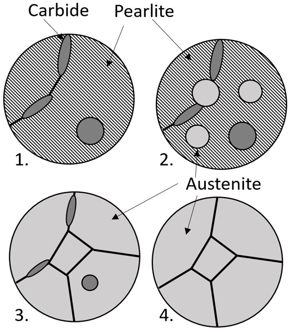

Below shows schematic diagrams for what occurs during heating for normalizing, where first the ferrite/pearlite is dissolved and replaced with austenite, and then with higher temperature the last lingering carbides are dissolved.

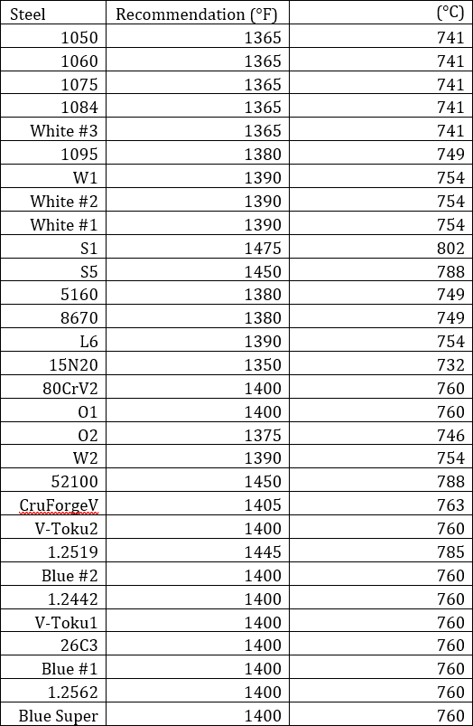

Normalizing Temperatures

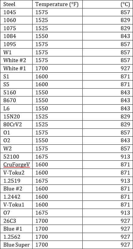

Below shows recommended temperatures for normalizing from my book Knife Engineering. For many of these you can actually normalize up to 100°F higher than this temperature to ensure everything is dissolved. Heat for 10-15 minutes and then air cool to normalize.

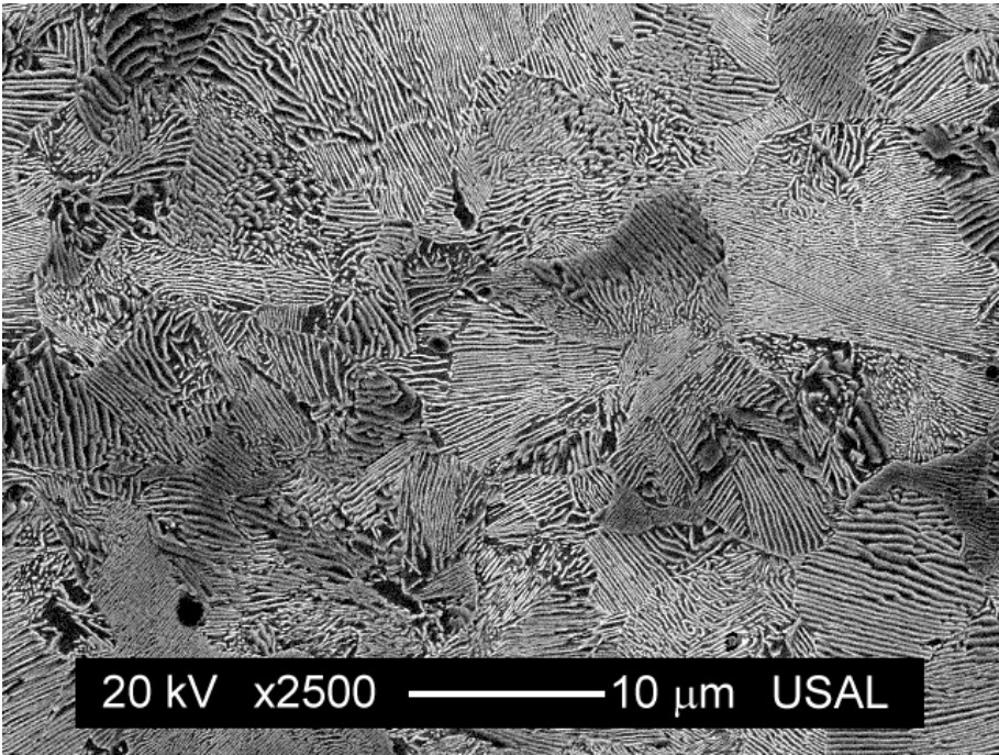

Cooling Down During Normalizing

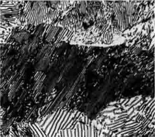

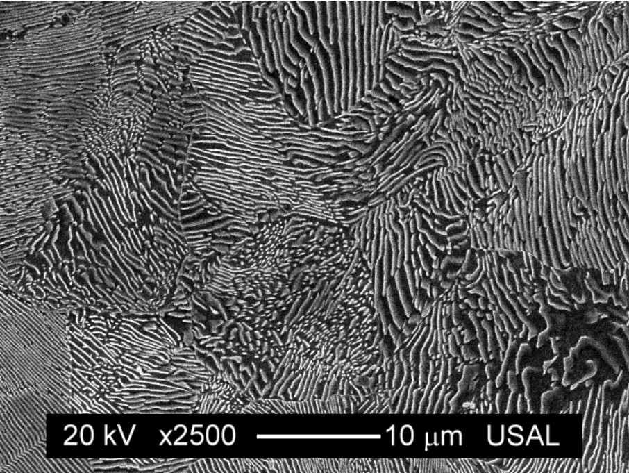

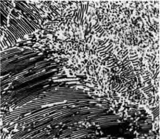

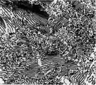

After we have a microstructure of austenite we want to cool in air to form pearlite. This will leave us with a consistent microstructure going in to our next steps. Carbide and ferrite forms simultaneously on the austenite grain boundaries. Ferrite can accommodate almost no carbon, so the carbon leaves austenite by forming carbides. This creates carbon-lean regions where the ferrite can form. Therefore alternating bands of ferrite/carbide form which is a structure called pearlite.
Adapted from [5]
This same process occurs throughout the steel, with new pearlite grains nucleating at grain boundaries and growing to consume the austenite and replace it with pearlite.
Adapted from [6]

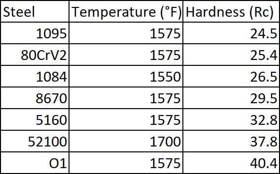

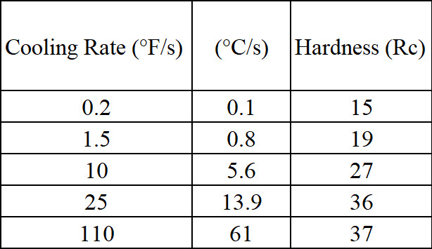

Different cooling rates lead to different hardness. A fast cooling rate leads to finer pearlite and higher hardness. A slow cooling rate leads to coarser pearlite and lower hardness. When air cooling you don’t necessarily have control over the cooling rate, but with thicker or thinner knives this will affect the cooling rate and the resulting microstructure and hardness.
Hardness of 1095 after normalizing with different cooling rates (generated from CCT curves)
1080 steel air cooled [7]
1080 steel furnace cooled [7]
With different steels the hardness of the pearlitic structure is also different depending on the hardenability of the steel. High hardenability steel like O1 will have a relatively high hardness and very fine pearlite. Low hardenability steel like 1095 is lower in hardness. If the O1 is very thin then some martensite may form. If the hardenability is very high like L6 or an air hardening steel then even more martensite forms. We prefer pearlite if possible with normalizing. Below are hardness measurements I made after air cooling 1/8″ stock knife steels:

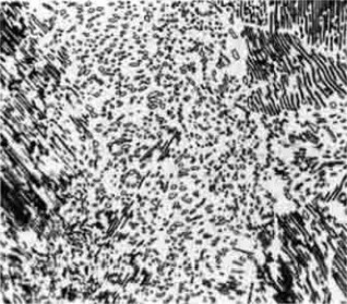

Subcritical Anneal
If you heat the normalized steel and heat it to high temperature below austenite transformation and hold, it will spontaneously spheroidize. Below are images of 1080 steel being held at 1200°F (650°C) for different times [4].
Normalized [4]
4 hours [4]
16 hours [4]
64 hours [4]
240 hours [4]
360 hours (double magnification) [4]

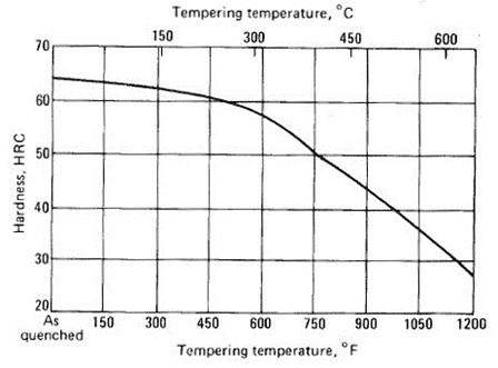

A temper anneal is similar to a subcritical anneal in that you hold the steel just below the critical temperature to reduce hardness. The difference is that you heat the steel above critical and quench first. So it becomes a very high temperature temper to lead to low hardness steel and a carbide plus ferrite microstructure. Carbon precipitates out of the martensite and coarsens. Coarser carbide and less carbon in the martensite means lower hardness.
1084 tempering curve (ASM heat treater’s guide)

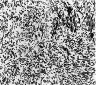

Transformation Anneal (Divorced Eutectoid Transformation)
The most common anneal is called a transformation anneal also called a divorced eutectoid transformation (DET) anneal. You heat above critical but not so high that you dissolve all of the carbides. And then during slow cooling the steel transforms to ferrite while growing the carbides by diffusing carbon to the carbides.
Image from [8]

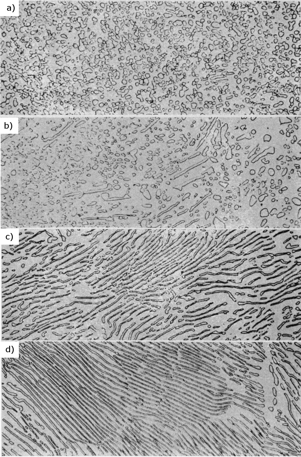

The temperature of annealing is very important because if you heat to too high a temperature then too much carbide is dissolved. Without carbide it is more favorable for the steel to form pearlite. Below shows 1080 steel annealed from different temperatures.
1080 steel annealed from 1385°F (a), 1450°F (b), 1600°F (c), 1750°F (d). Image from [9].

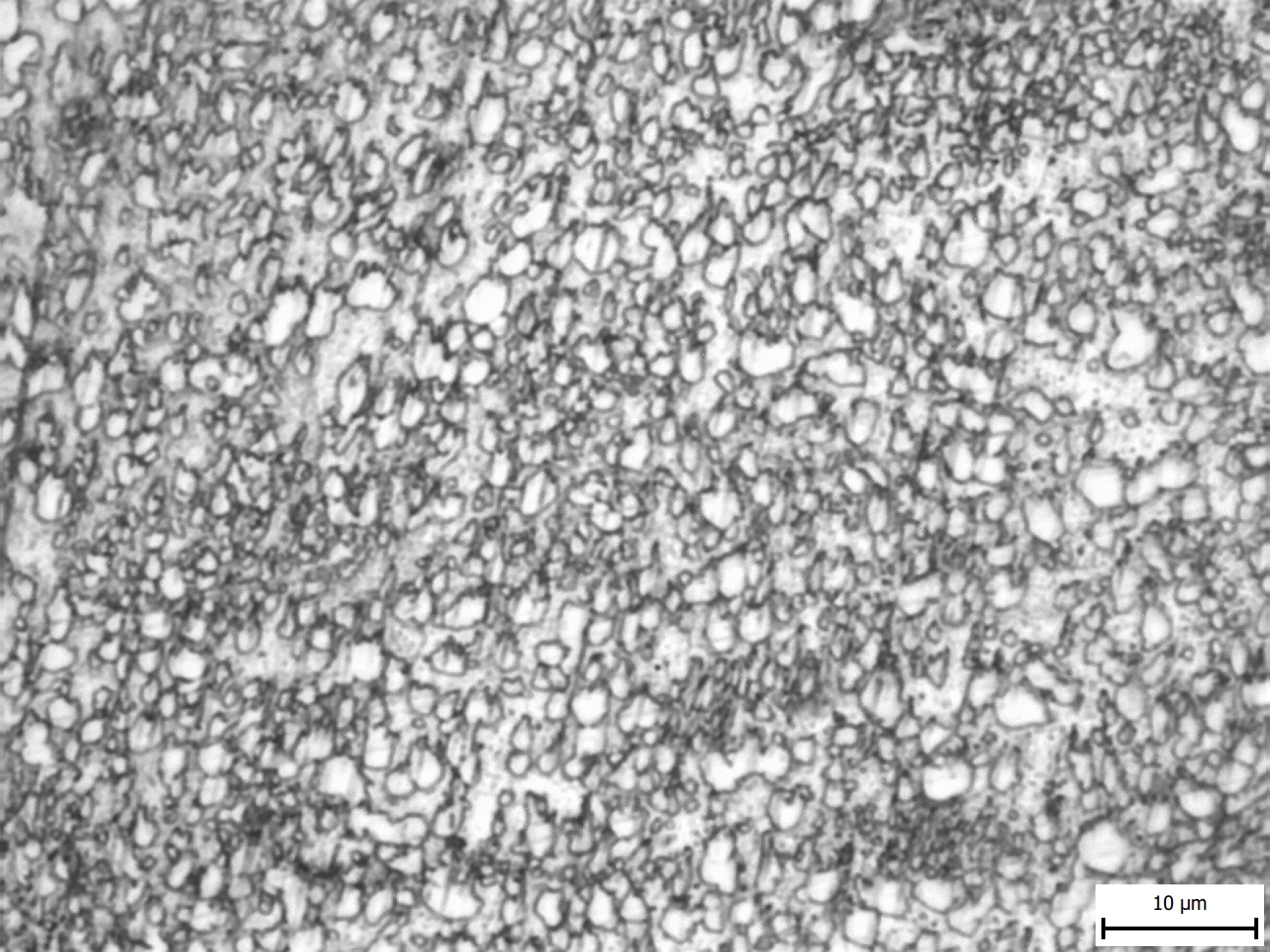

Here are recommended annealing temperatures from Knife Engineering for a good DET anneal.

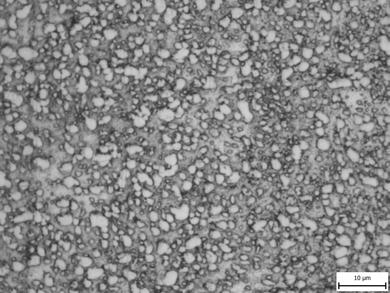

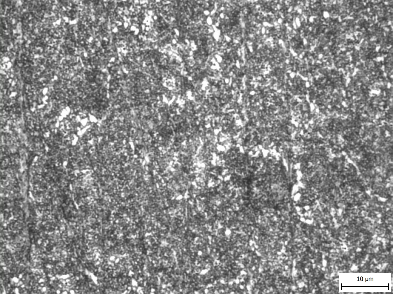

The cooling rate of the anneal is important to the final hardness and microstructure. Datasheets and steel manufacturers use very slow cooling rates that lead to a relatively coarse structure. This is the lowest hardness and most machinable structure. However, with a faster cooling rate the structure is finer which can have certain benefits. Below shows 52100 as-received compared with 52100 that I annealed by placing in vermiculite. You can use cooling rates at about 600°F/hr (300°C/hr) for most low alloy steels.
52100 steel as-received from the steel manufacturer (“slow” DET anneal)
52100 with “fast” DET anneal

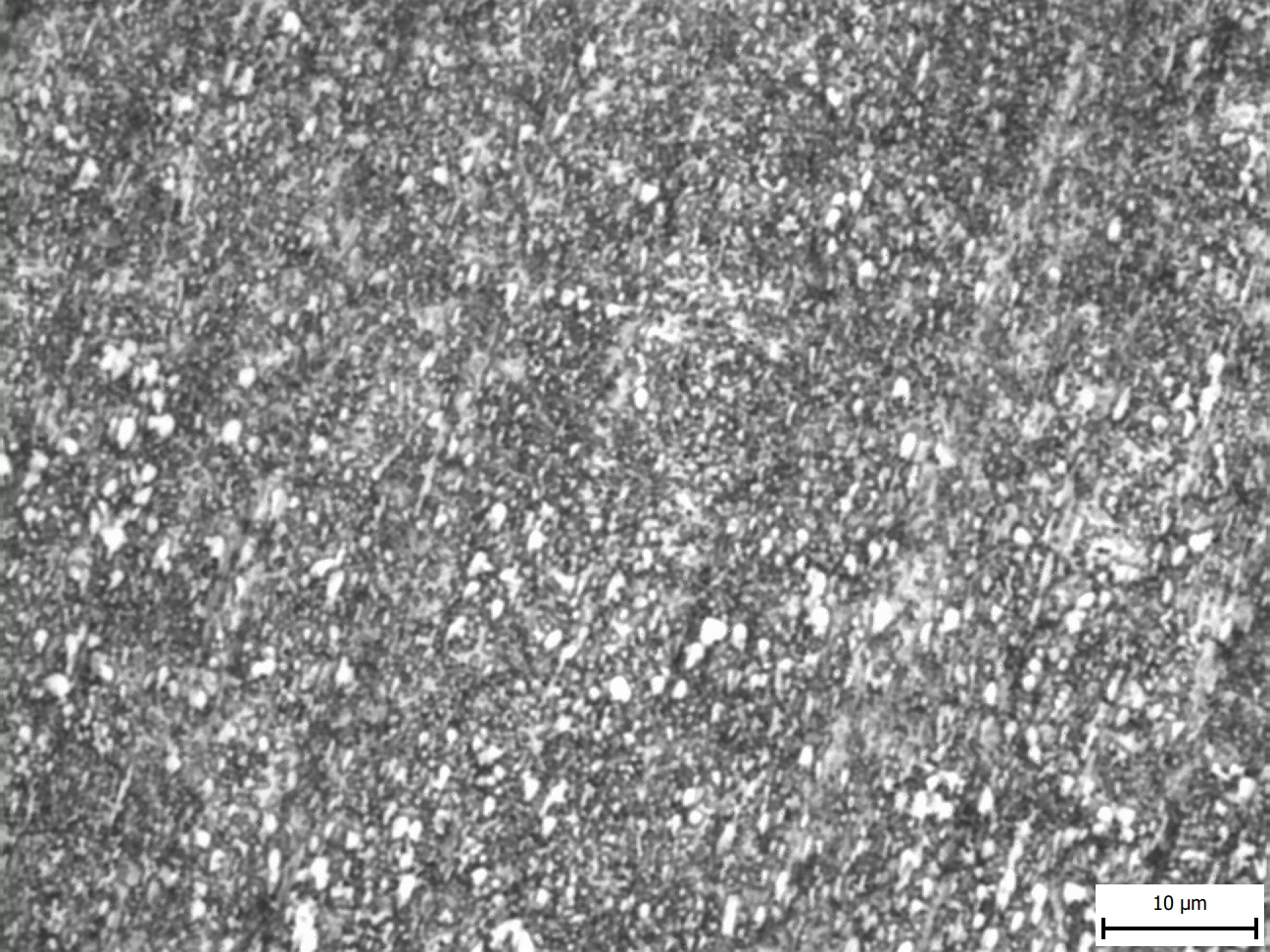

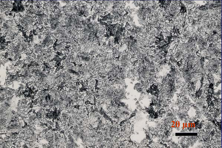

With both steels I overheated them at 2100°F (1150°C) for one hour and air cooled. Both were normalized, the 52100 at 1700°F (925°C) and the 1084 at 1550°F (845°C) for 15 minutes and air cooled. That is the normalized condition that I tested. I also tested them with a “fast DET” anneal where they were cooled at 600°F/hr (300°C/hr) after holding at 1450°F for 52100 and 1385°F for 1084, both for 15 minutes. Those temperatures are right about at non-magnetic. These were also compared to the as-received condition from the steel company which has a coarser microstructure as I originally stated.
1084 steel as-received (slow DET anneal). Coarse spheroidized carbides.
1084 normalized. Pearlite microstructure. The diagonal streaks are scratches because I struggled to get a good polish on these soft specimens.

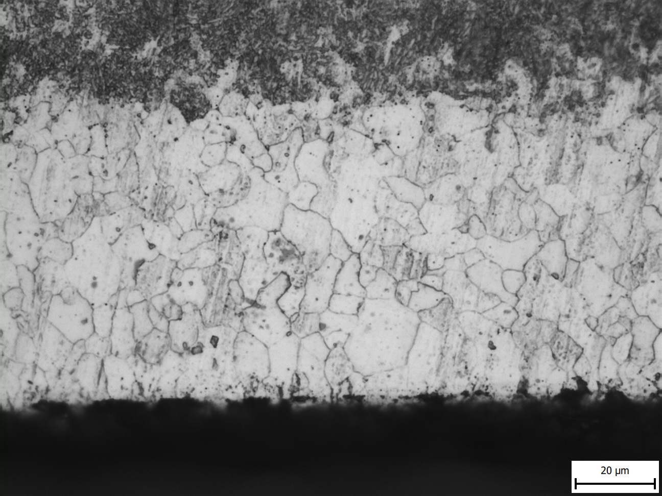

1084 with fast DET anneal. There is some evidence of pearlite so it is probably good that the recommended annealing chart from Knife Engineering is at a slightly lower temperature of 1365°F.
Annealed 1084 showing the decarb layer where grains are visible. This isn’t exactly the same grain size as the rest of the structure because the transformations between carbide/pearlite and austenite also affect the grain size. However, it can provide some indication of the grain size of the bulk material. This is around a 9 ASTM grain size which is very fine. So the normalize and anneal was effective in refining the grain size after the high temperature grain growth treatment.

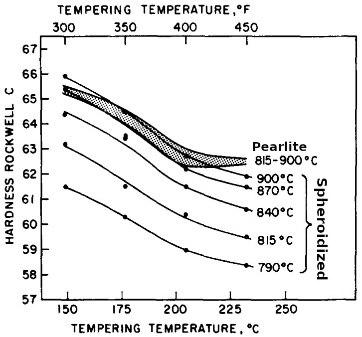

52100, however, showed relatively significant differences between different prior microstructures. From the normalized condition it was a full 67 Rc after quenching. With the as-received microstructure it was only 60.6 Rc. The fast DET was in the middle though closer to the as-received than to the normalized condition. The chromium addition to 52100 delays the “kinetics” (speed) of the transformation.
52100 hardness after quenching from just above non-magnetic:

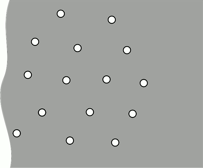

The coarse spheroidized structure leads to a relatively long distance that diffusion has to occur. Pearlite is a finer structure where transformation can occur more rapidly. Martensite (quenched steel) essentially has perfectly evenly distributed carbon. If you temper high enough and long enough you do get a structure that starts to look more like a fast DET anneal, however.
Spheroidized carbide schematic
Schematic of pearlite
Schematic of quenched martensite

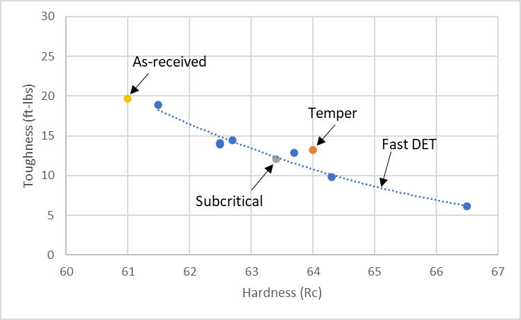

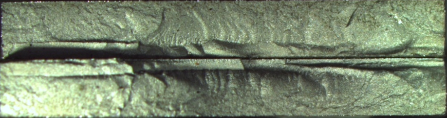

Effect of Prior Microstructure on 52100 Toughness
In a previous experiment with 52100 steel we found a significant difference in toughness between steel heat treated from the as-received condition and the “fast DET” annealed condition. The finer resulting microstructure apparently increased toughness. However, the hardness of the steel from the as-received condition is 1-2 Rc lower than I would expect. Perhaps the steel was particularly coarse from the manufacturer. Read more about these experiments in this article on heat treating 52100.

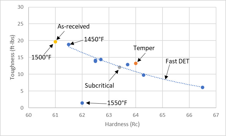

Effect of Prior Microstructure on CruForgeV Toughness
We also did a series of experiments on a few years ago with CruForgeV which you can read about in this article. To that set of experiments I added a toughness test from the as-received condition to go with it in the past couple weeks for this article. In the original experiment the steel was forged between 1550°F/845°C and 2000°F/1100°C (the effect of forging temperature was one of the tests performed). Each was normalized from 1600°F/870°C. Then they were given three different anneals:
Subcritical anneal: 1250°F/675°C for 2.5 hours. I don’t think this was long enough for significant spheroidization so it was probably mostly pearlite.
Temper anneal: 1450°F (785°C) for 10 minutes, quench, then 1250°F for 2.5 hours.
Fast DET anneal: 1460°F for 30 minutes followed by 670°F/hr (375°C/hr).

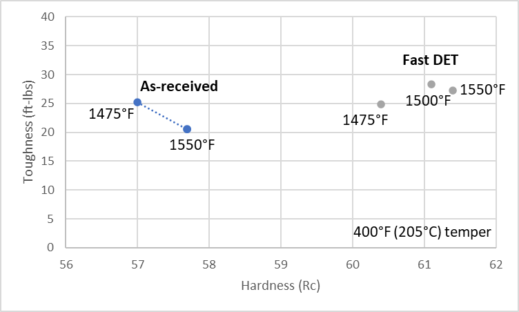

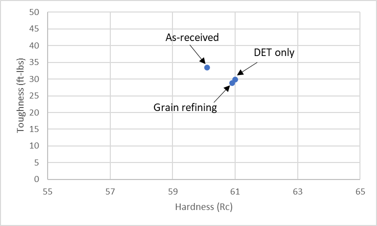

The hardness after 1500°F for 10 minutes, Parks 50 quench, and temper at 400°F is shown below:
Then below is the resulting toughness for the different conditions. This also includes other heat treatments with the fast DET condition to show the overall trends of hardness vs toughness:
So the overall toughness-hardness balance was not really affected by the different prior processing but the finer microstructure anneals did lead to higher hardness as expected. However, the prior microstructure does change the optimal austenitizing temperature range. The datasheet for CruForgeV recommends 1500-1550°F. However, using 1450°F with the fast DET led to similar hardness-toughness to using 1500°F with the as-received condition. And using 1550°F with the fast DET prior microstructure led to terrible toughness. So having the finer microstructure of the fast DET led to a drop of about 50°F in the optimal austenitizing temperature range.

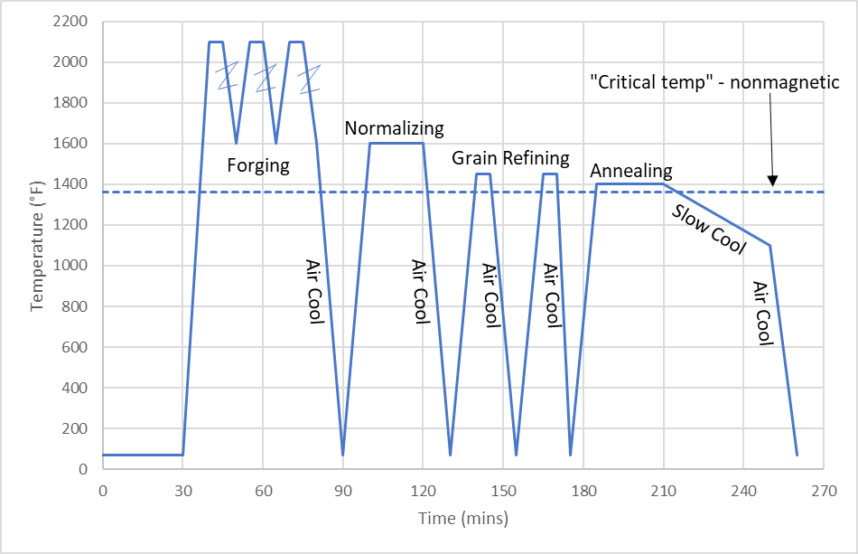

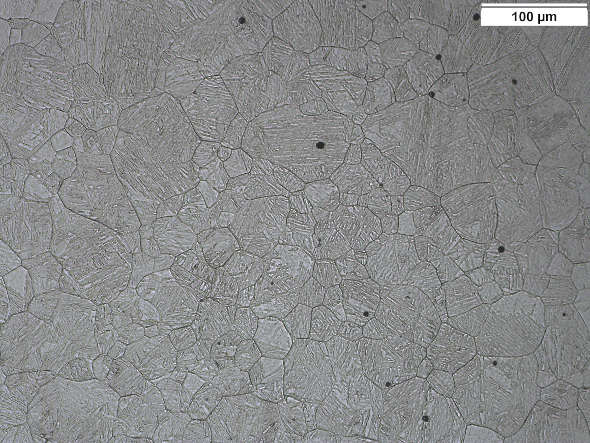

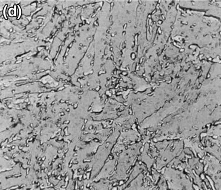

Cycling for Grain Refinement
As discussed previously in this article, grain refining cycles can be performed in between normalizing and annealing. This is like a normalizing cycle but is done from a lower temperature, such as 1400-1450°F. Cycling from low temperature has been shown to lead to finer grain size such as in the 1060 steel below which was cycled from 1490°F (810°C) [11]:
Overheated at 2000°F/1100°C (a), 1-cycle (b), 3-cycles (c), 5 cycles (d), 8 cycles (e). Image from [11].

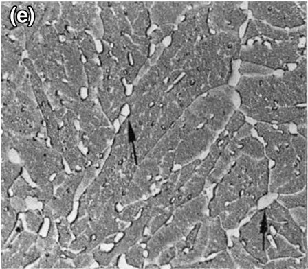

Effect of Cycling on Carbide Structure

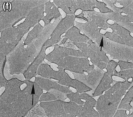

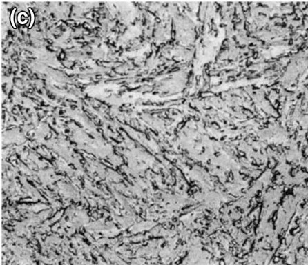

However, grain refinement is not the only change to the microstructure. This cycling treatment with the 1060 also led to spheroidization of the carbide. After several cycles the microstructure looked pretty close to a fast DET structure.
One cycle (top), 5 cycles (middle), 8 cycles (bottom). Images from [11].

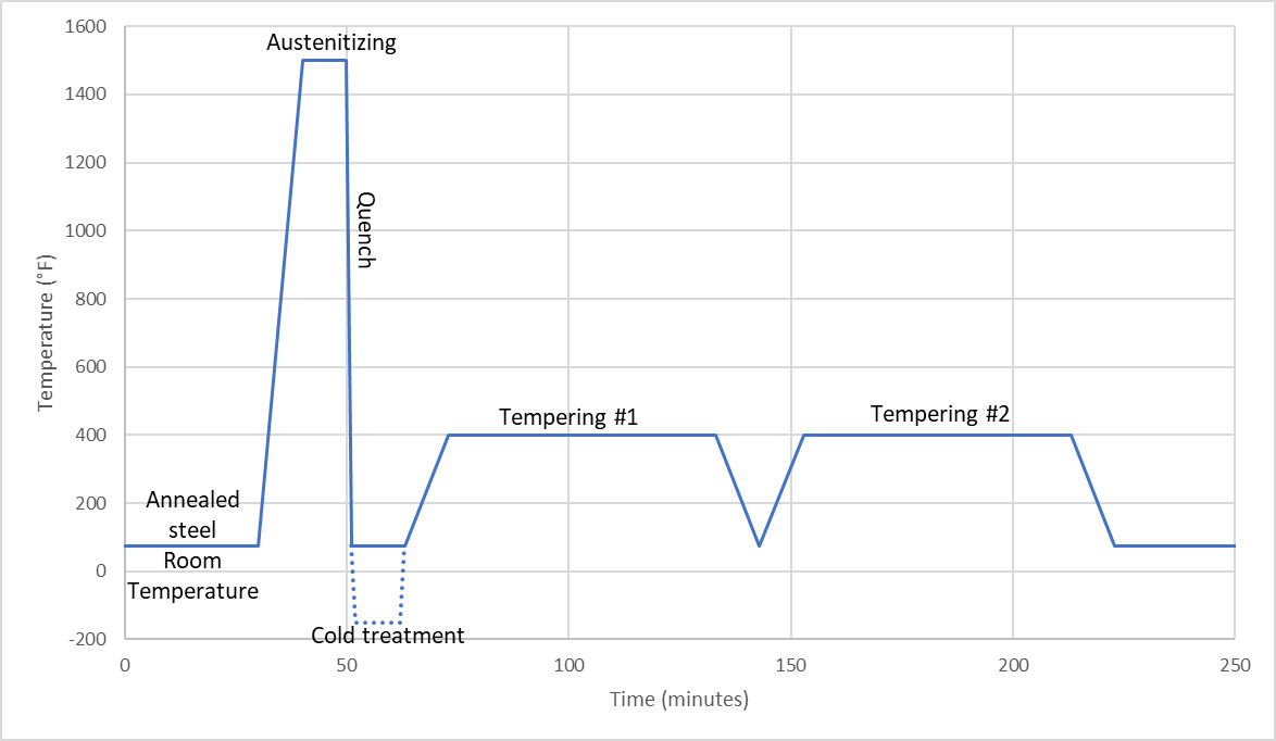

Stress Relieving
Another type of heat treatment that can be performed prior to the final austenitize is a “stress relief” treatment. This one is commonly done because of stresses induced in the steel during grinding the annealed steel. If the steel is significantly heated in different portions from grinding this can lead to increased chances of warping or cracking during austenitizing and quenching. A stress relief is typically done from 1200°F/650°C for 2 hours.

How to “Thermal Cycle” Low Alloy Steels in a Forge
1) Normalize by heating to the approximate recommended temperature and air cool.
Determining the exact temperature can be done by color or maybe with a laser thermometer. My cheap laser thermometer is always way off so I don’t know if more expensive ones can do better. Fortunately normalizing can be done from a relatively wide range of temperature. When the steel is fully magnetic again during air cooling it is done transforming. If heat treating in a forge this is the best microstructure going in to austenitizing because no soak is required.
2) Heat to non-magnetic (and no higher) and then place in vermiculite. This step is recommended if your final austenitize and quench will be done in a furnace.
While it might sound funny to do normalizing and annealing with a forge if you have a furnace, the cycles can be done very rapidly in the forge so it can be more convenient.
How to “Thermal Cycle” in a Furnace
1) Normalize by heating to the recommended temperature for 10-15 minutes and air cool.
2) Anneal by heating to the recommended temperature for 15-30 minutes, cool at 600°F/hr (300°C/hr) to 1100°F. After 1100°F the steel can be furnace cooled or air cooled it doesn’t matter.

I see now, the temp was not chosen because it is, by chance, the same as from the DET table, but simply because the 52100 becomes non-magnetic at it. I should have listened/read more carefully.
Thinking about it, if the method dictates lower than ideal aust temp, why not use brine instead of oil to compensate?
Table salt melts at 800C/1470F so it could also be used as a reference point.

During normalizing one of the goals is to dissolve all of the carbide. A high carbon and chromium content means the carbides don’t dissolve without melting the steel so that goal can’t be accomplished.
So the high chromium prevents carbide from dissolving does it just body block it like it’s in the way when the carbide is on the side of the crystal structure so it can’t get in it or the chromium is in the crystal structure but it breaks up the stratus because it’s larger then the ferrite or carbide
More carbon and more chromium means the carbide is more difficult to dissolve, it will form at a higher temperature, etc.
