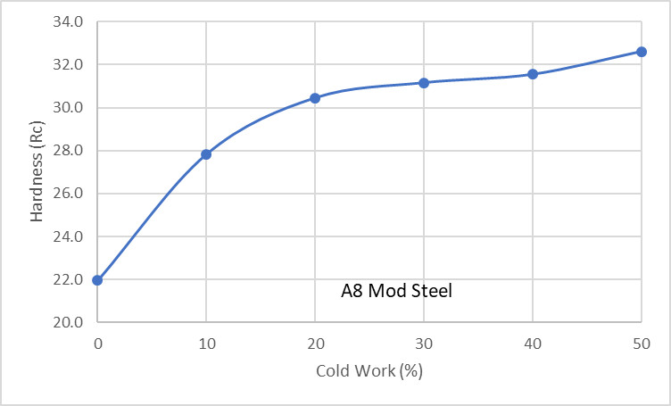

The annealed hardness is somewhat higher with the fast anneal. However the finer microstructure from this anneal leads to a better hardness-toughness balance after the final heat treatment as you will see. However, somewhat surprisingly the hardness after cold reduction was very close for the two different prior conditions. The increase in hardness was roughly similar to a study I cited in the cold forging article with A8 Mod tool steel [1]:

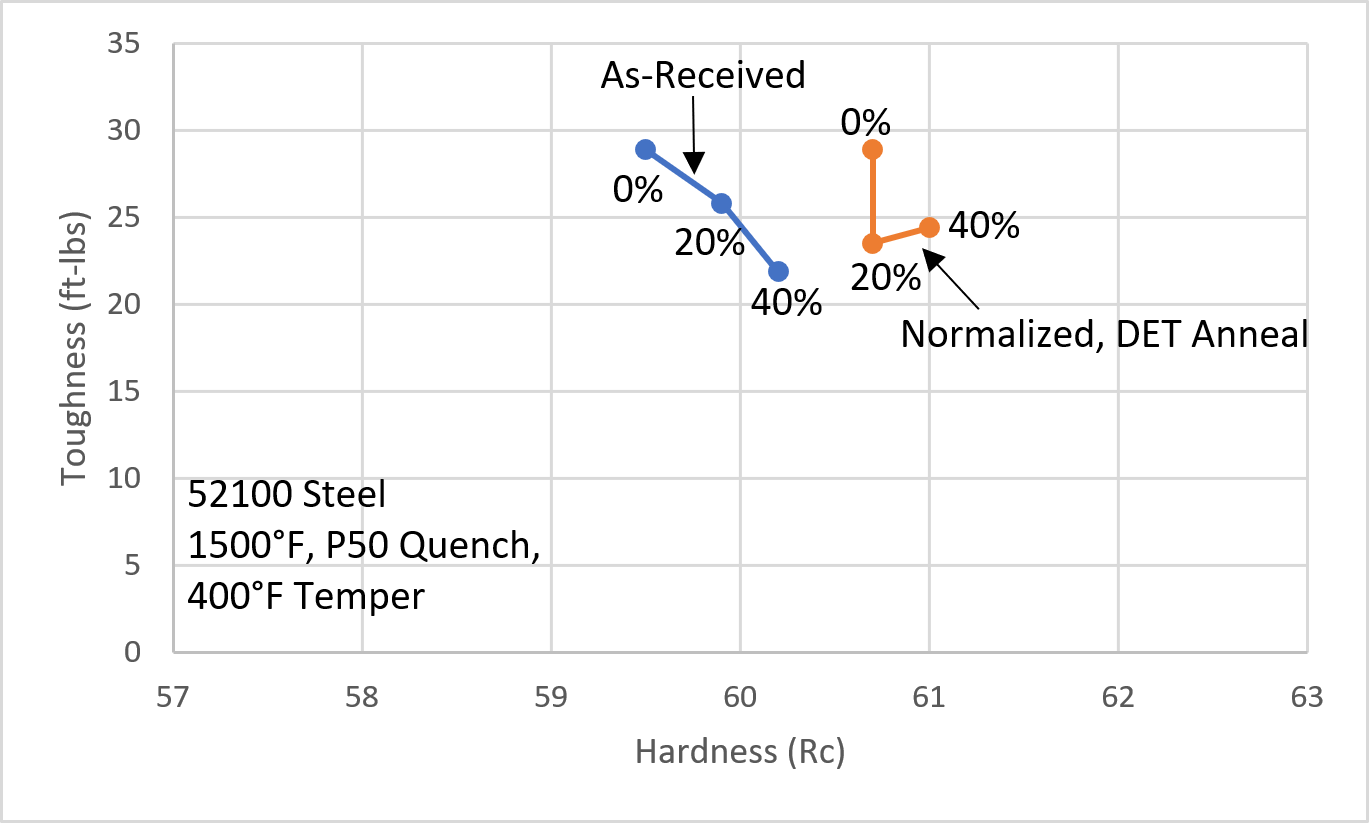

After the quench and temper, you can see that the cold reduction led to higher hardness. The difference was relatively small, however, even with 40% cold reduction, 0.7 Rc for the as-received and 0.3 Rc for the normalized and annealed. Cold reduction leads to faster dissolution of carbides putting more carbon in solution and therefore higher hardness after heat treating. In this case the finer microstructure achieved through our modified annealing procedure led to a bigger difference in hardness than cold rolling.

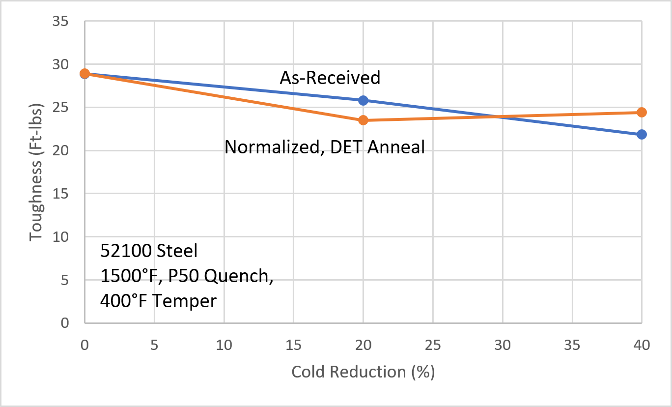

The cold reduction led to lower impact toughness for either the as-received or thermal cycled conditions. This is perhaps expected based on the increase in hardness though we had hoped that there would be a reduction in grain size to help improve toughness despite the small increase in hardness. The two different conditions, as-received or thermal cycled, had similar toughness despite the thermal cycled condition leading to higher heat treated hardness.

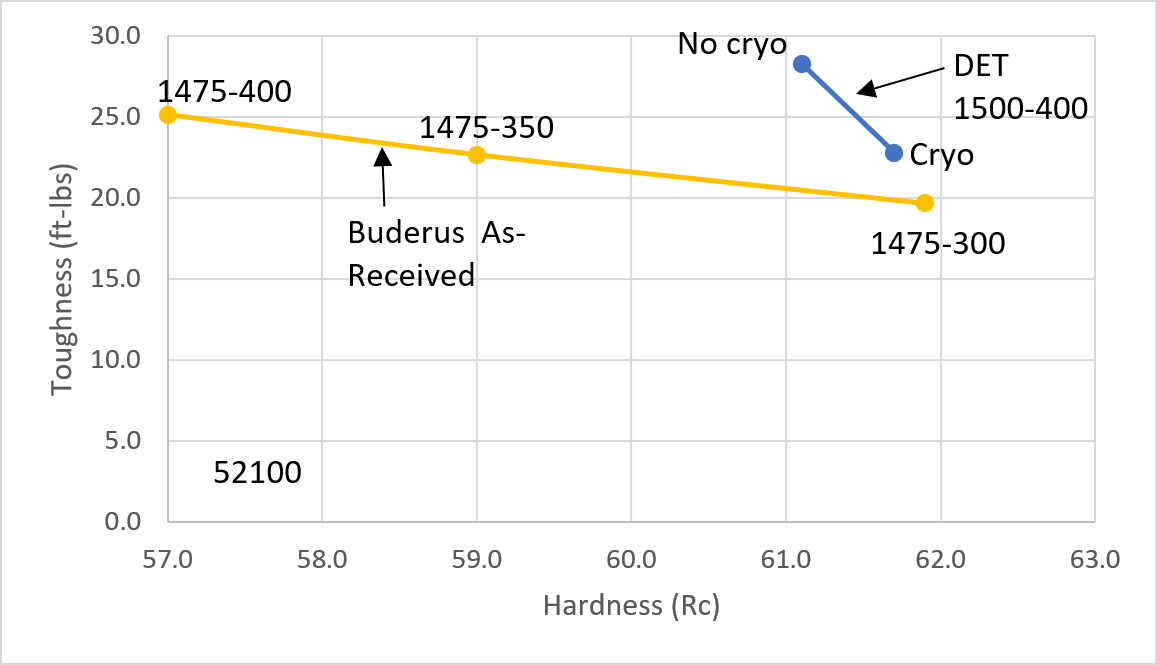

The thermal cycled condition (Normalized, Fast DET anneal) had ~1 Rc higher hardness but similar toughness to the as-received condition. Thus the hardness-toughness balance was significantly better in the thermal cycled condition. However, the cold reduction did not improve hardness-toughness to the same extent as an improved initial carbide structure did.
The effects of cold reduction look more similar to a typical reduction in toughness (with higher hardness) from a lower tempering temperature or adding a cryo step as shown below. You can see where the following numbers came from in the earlier article about heat treating 52100.
