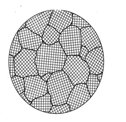

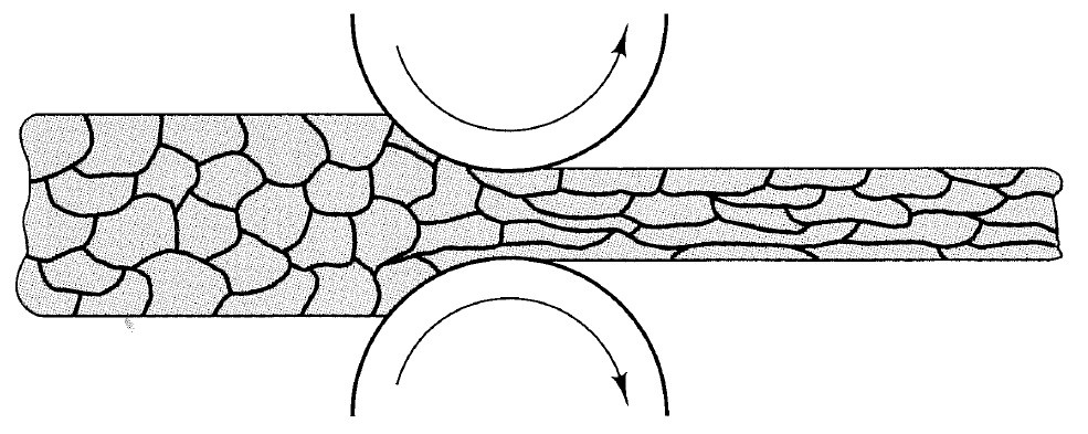

However, there are many grains inside steel, and the boundaries between these grains are where the planes of atoms meet each other. Each grain has a different “orientation” relative to the others, which is represented by the grid lines in the grains in the schematic below:
During cold rolling we are pancaking those grains and elongating them. When forging a piece of steel the deformation is not quite as uniform, of course, but the principles are essentially the same.

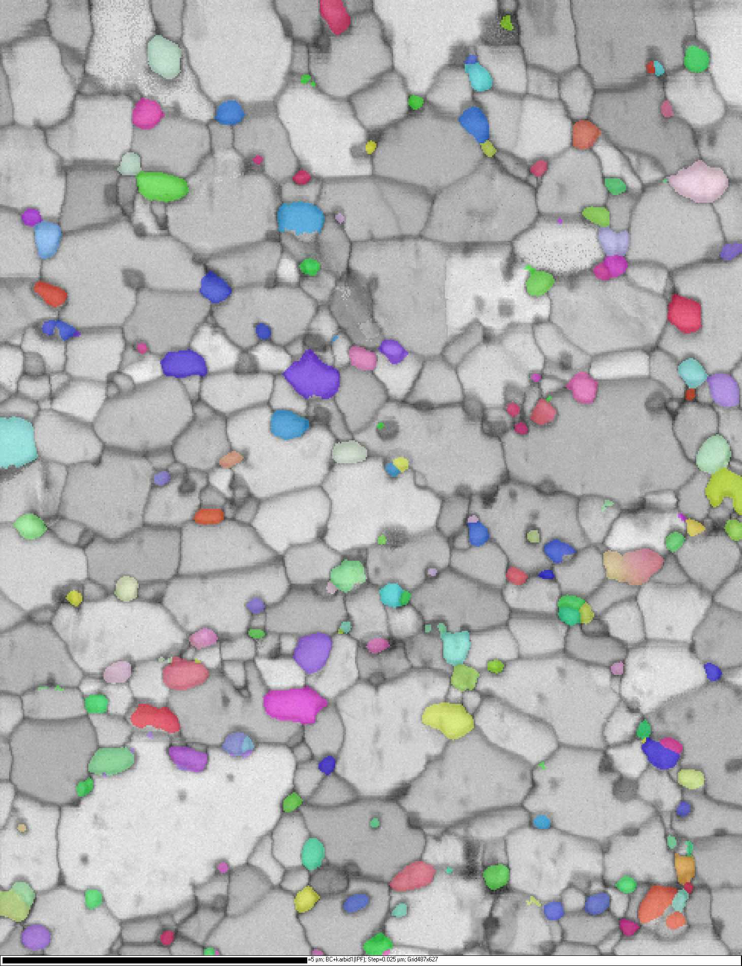

When we start with annealed steel with soft ferrite and carbides, the structure looks something like below, with relatively round ferrite grains along with the smaller carbides (carbides in different colors to differentiate):
Annealed 13C26 stainless steel [2], the black bar is 5 microns
The above image was captured with “Electron Backscattered Diffraction” (EBSD) which is able to differentiate between different phases (austenite, ferrite, carbides) and grain orientations. Also the relative dislocation density is seen because grains with low density are “clean” and grains with high dislocation density are rougher and darker.

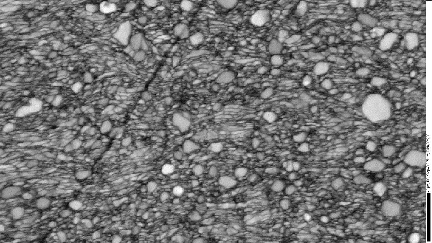

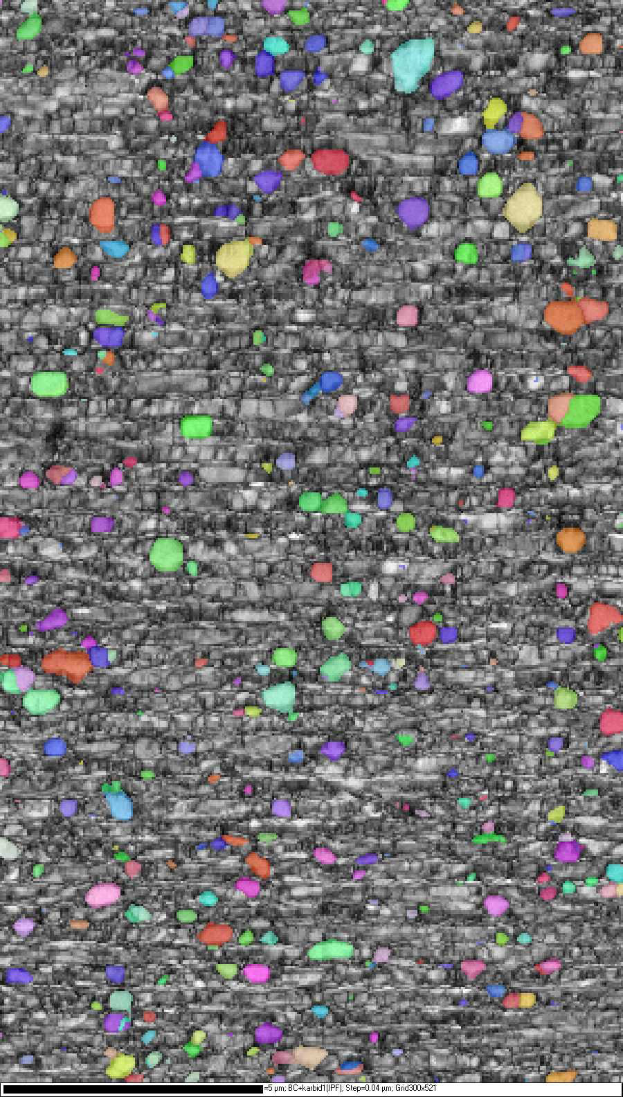

When the steel is cold rolled the carbides are more or less unaffected, but the grains are elongated and the dislocation density is increased, which can be seen in the image below because the “image quality” of the grains is poorer:
13C26 after a small amount of cold reduction [2], the carbides are not colored in this image, the black bar is 2 microns
13C26 after a large cold reduction [2], the black bar is 5 microns

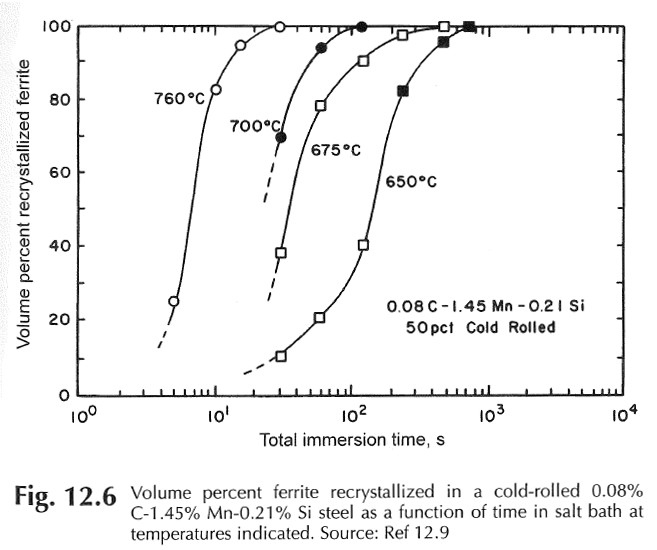

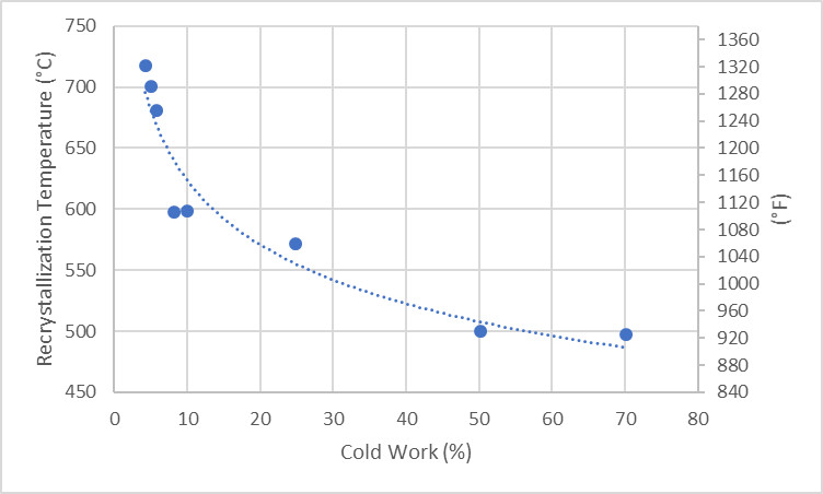

Recrystallization occurs through the diffusion of iron atoms so a certain amount of temperature is required so that sufficient diffusion can take place. This is why cold work has the effect that it does, because the temperature is so low that the steel cannot “fix” itself with diffusion. However, the temperature at which recrystallization starts is also controlled by the degree of cold work. The greater the degree of cold work, the lower the temperature is that recyrstallization starts [3]:
With a few percent cold work in the steel shown above, a full 700°C (1300°F) is needed to start recrystallization, while with 50-70% cold reduction only 500°C (930°F) is necessary for recrystallization to occur. The more cold work there is the more energy has been put in the steel in the form of dislocations, and that energy increases the “driving force” for recrystallization. The rate of recrystallization is affected by temperature as well, where at higher temperatures diffusion is faster so the rate of recrystallization is also increased [4]:
You can see that for the steel above, recrystallization is completed within 20 seconds at 760°C, while at 650°C it takes over 500 seconds. Again, this rate at different temperatures is dependent on the composition, carbides, and degree of cold work, but the above example provides some visual understanding of the difference with temperature.

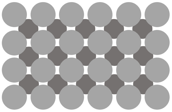

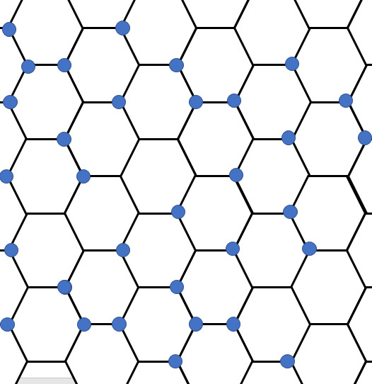

After all of these effects to the steel during cold working and recrystallizing, how does this affect the final heat treatment of austenitizing and quenching, and then the resulting hardness and toughness? The process of cold forging and and recrystallizing can lead to a smaller grain size which can improve the hardness-toughness balance. You can read about why in this article on grain refinement. That’s now the third time I have linked to that article and I really hope you have read it. The refinement in the ferrite grain size increases the nucleation sites for austenite formation so that the final prior austenite grain size is also smaller.

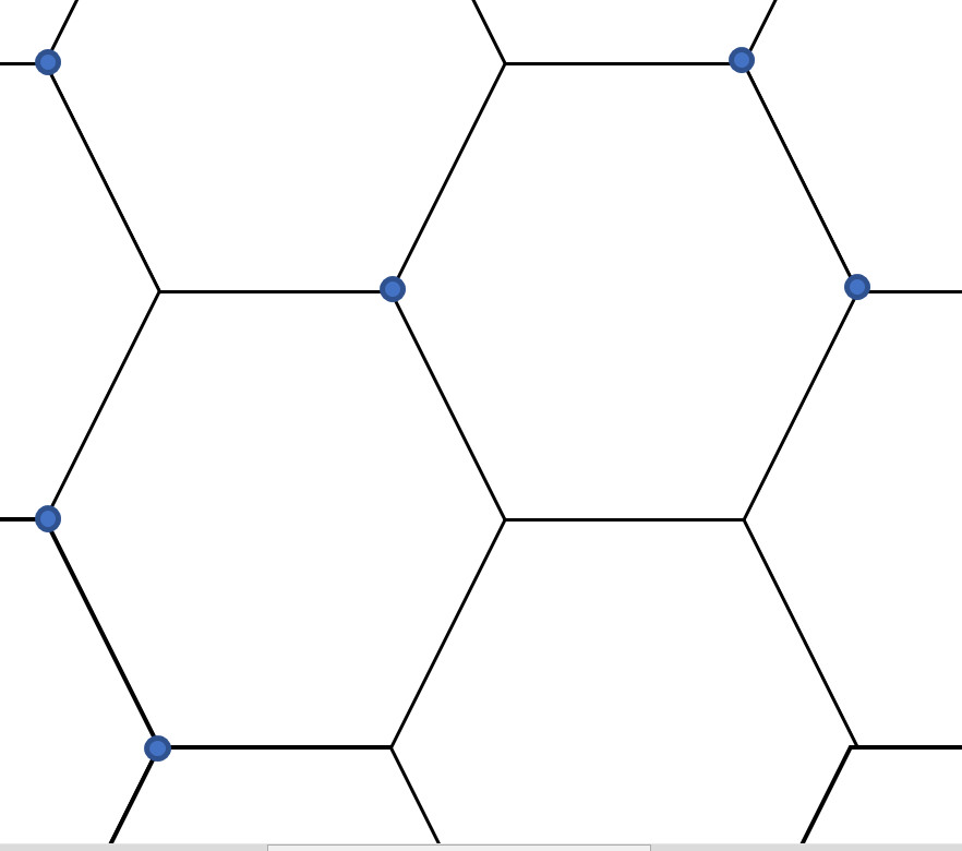

Smaller ferrite grain size leads to more austenite nuclei (blue circles) so when the austenite grows and replaces the ferrite the grain size is smaller

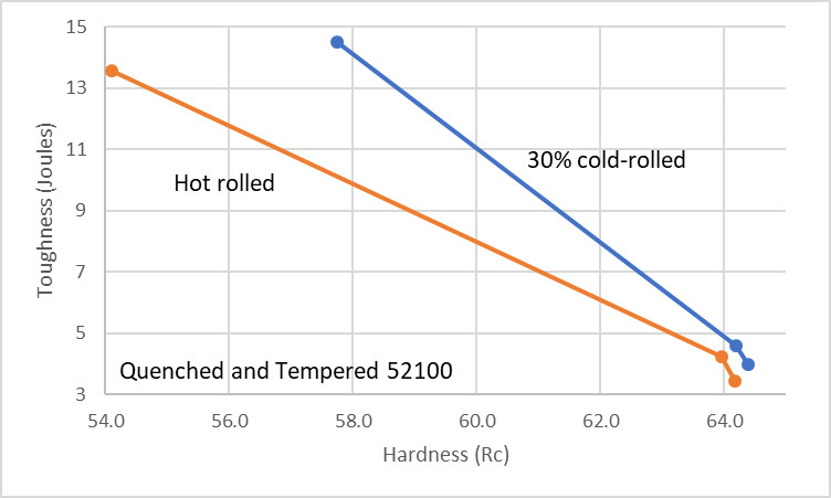

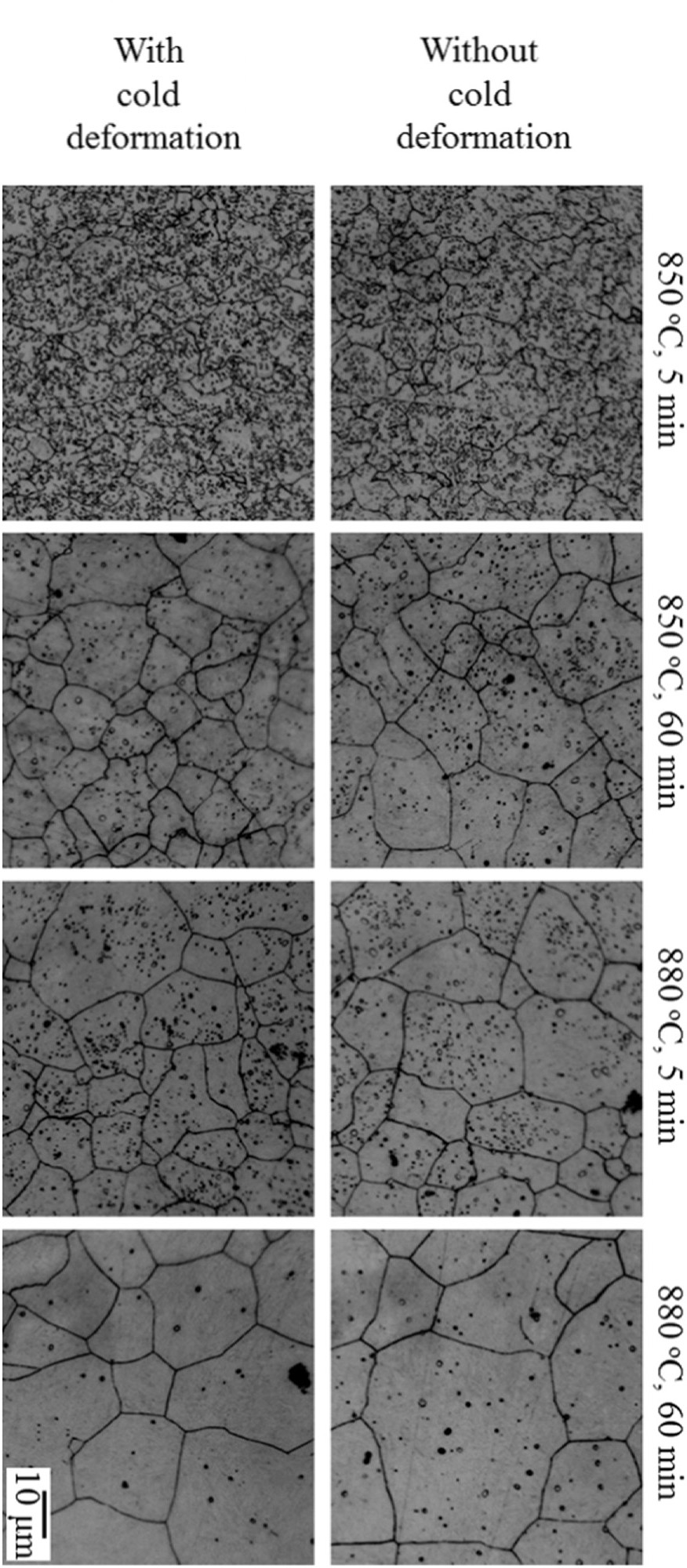

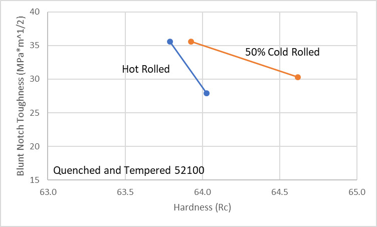

In one study on 52100 steel [5], they found that a 50% cold reduction led to a decrease in grain size from ~11 microns to 6 microns, which gave a corresponding increase in toughness:

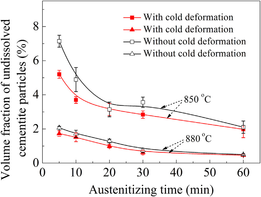

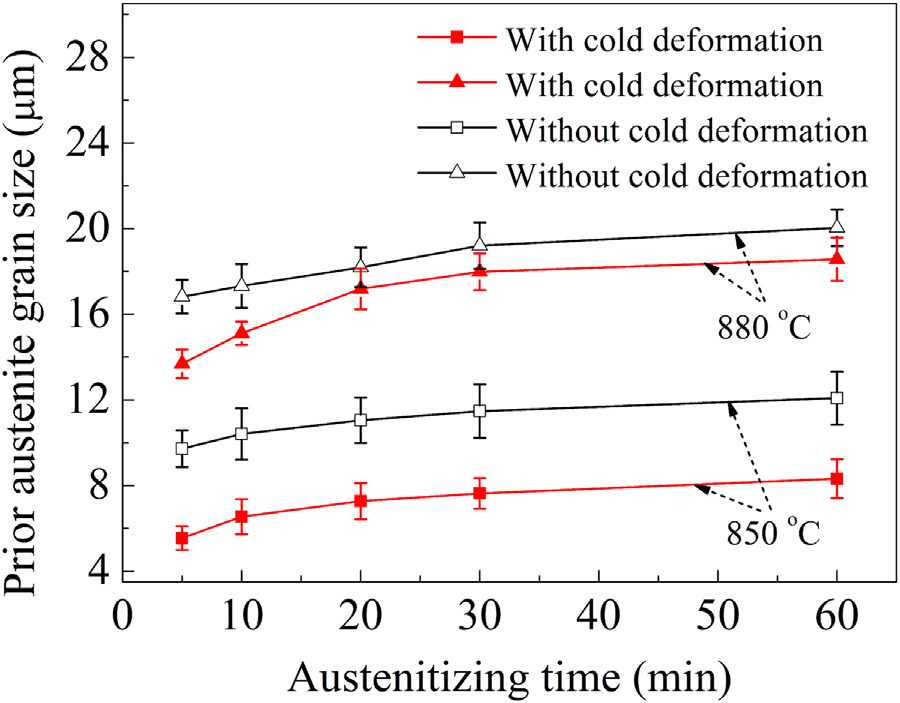

In another study on 52100 [6], they found that cold rolling decreased the final grain size, and also that the energy of cold working accelerated the dissolution of carbides:
The increase in carbide dissolution at high temperature means there is more carbon in solution. More carbon in solution prior to quenching leads to higher hardness and lower toughness (read more in Austenitizing Part 1 and Part 2). However, since the grain size was also reduced there was an improvement in both hardness and toughness by cold reduction of the 52100 prior to heat treatment:
To get a better idea for the change in grain size from cold rolling prior to heat treatment, here are the images of the grain boundaries from the experiments above:

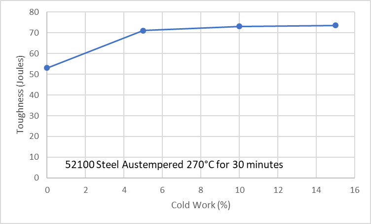

Another study on austempering of 52100 [7] for a bainitic microstructure found that cold reduction prior to heat treatment led to an improvement in toughness:

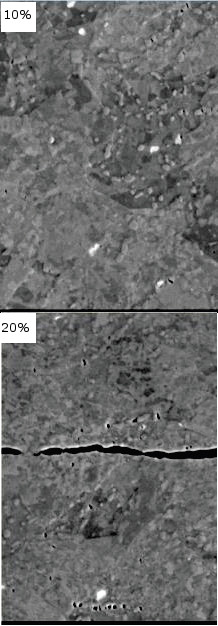

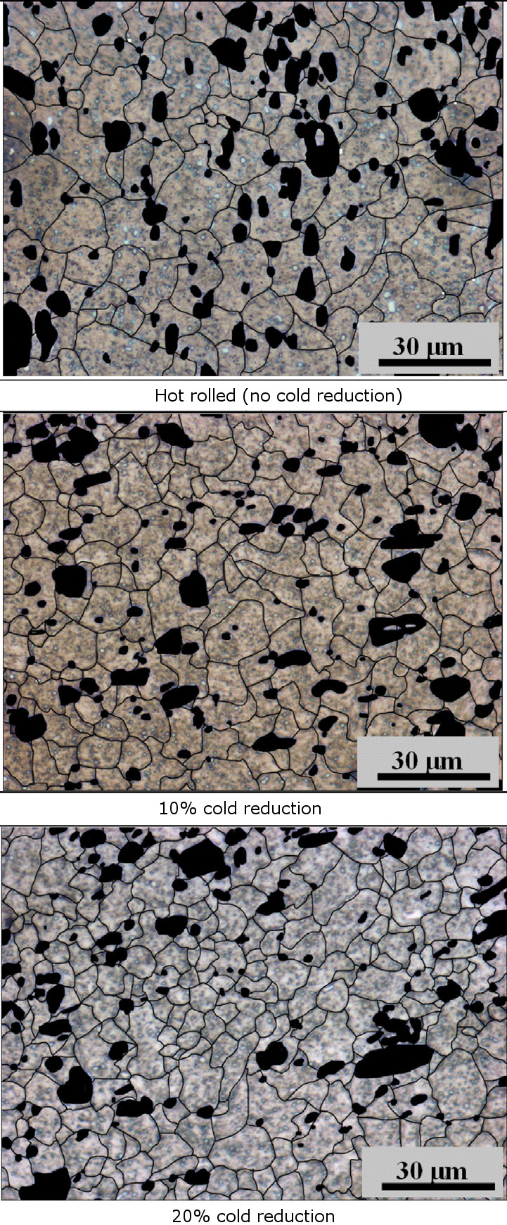

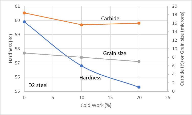

In a study on D2 steel [8], they tested hot rolled steel as well as 10% and 20% cold reduction prior to heat treating. They austenitized at 1030°C (1885°F) for 20 minutes prior to quenching and afterward measured the hardness and observed the microstructure. They found that cold work accelerated carbide dissolution and refined the grain size similar to the 52100 study. However, the hardness was reduced because more retained austenite was formed. More carbon and alloy in solution from dissolving carbide can increase retained austenite, you can find out why in this article. A reduction in grain size also decreases the martensite start temperature and therefore increases the final retained austenite [9]. Therefore, the use of cold rolling may require a reduction in the chosen austenitizing temperature to ensure that there isn’t excessive retained austenite after heat treatment.
No toughness testing was included but you can see the reduction in grain size in these micrographs:

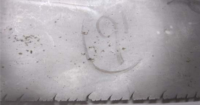

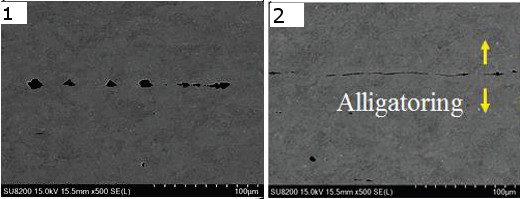

With the increase in hardness and corresponding decrease in toughness and ductility, there is a chance of cracking with cold rolling. This frequently occurs through cracking of the edges and in some circumstances “alligatoring” where the steel splits from the center:
This image from [9]
Alligatoring starts by the formation of voids near the center of the steel, and these eventually link up until the steel splits:
These images from [9]
Tool steels with their high fraction of carbides can lead to the promotion of these voids so that alligatoring is more likely to occur. The high fraction of carbides also means that ductility in general of annealed steel is low. Therefore the degree of cold reduction that a tool steel can withstand is relatively low. In the case of A8 mod, the formation of centerline cracks were observed with reductions as low as 20% [9]:
