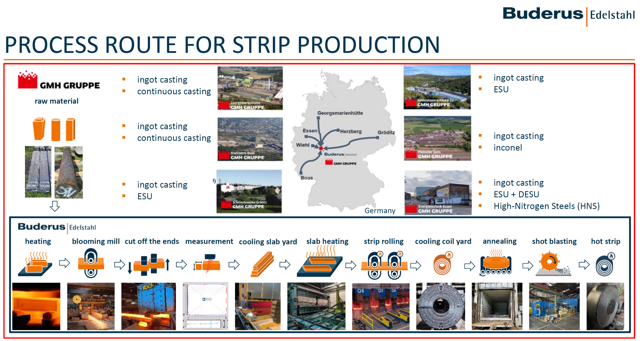

GMH Gruppe is also a steel company, so they announced [6] that the acquisition of the Buderus hot mill “closes an existing production gap … expanding product range to dimensions of up to 300 mm square. This enables access to new markets – including those beyond the traditional passenger-car combustion-engine segment.” With the steelworks shut down Buderus can continue to make steel but they will be sourcing ingots from other facilities within GMH Gruppe – these include Georgsmarienhütte GmbH, Stahlwerk Bous, Schmiedewerke Gröditz, and Pleissner Guss [6].

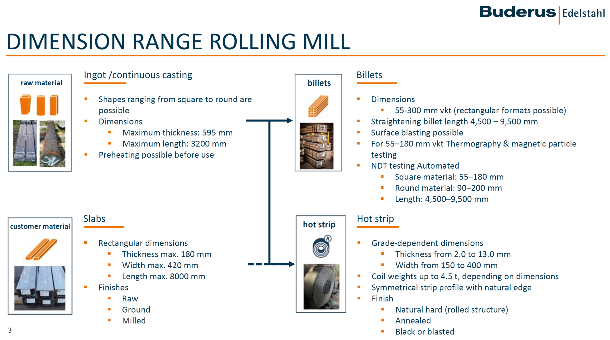

In other words, no longer available as cold rolled strip, but hot rolled steel will be available. Buderus metallurgist Clemens Trinks sent me a document about their new production route which confirmed that they will be offering steel as thin as 2 mm (0.079″) which is likely thin enough for the majority of applications. Though Clemens also mentioned potential limits for width depending on the grade and that is likely even more so for the very thinnest sizes. The annealing available has also changed due the restructuring, and they have now moved to open air annealing box furnaces. To remove scale they are using shot blasting.
