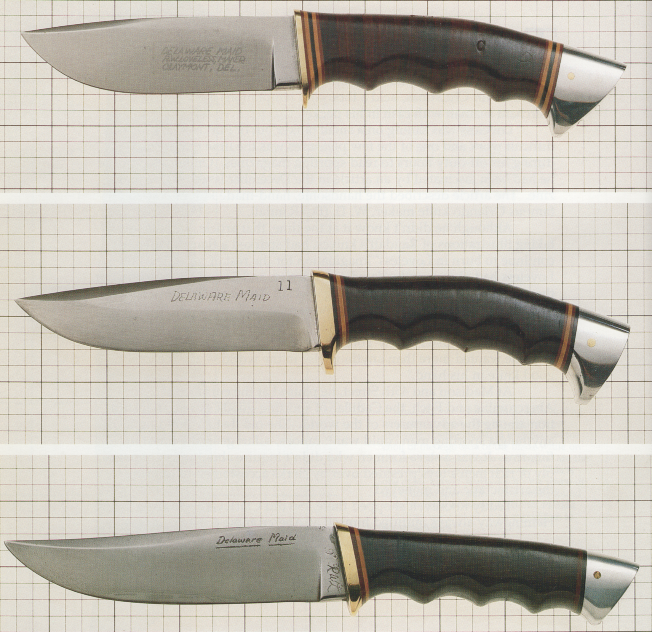

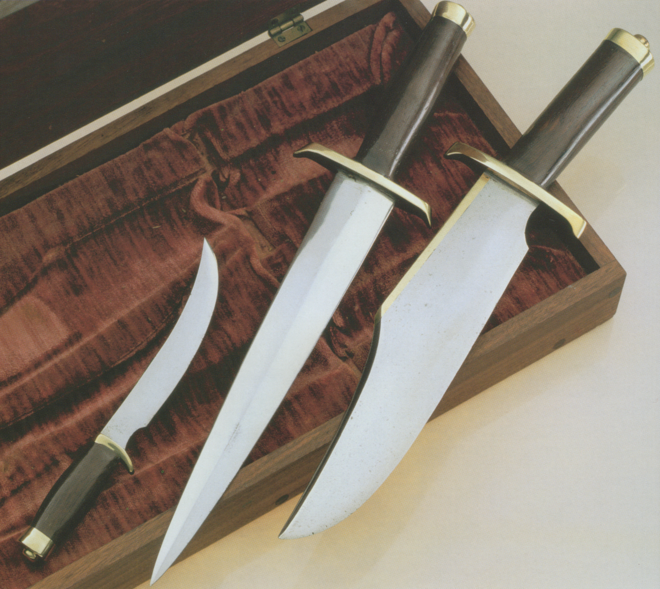

Moran was splitting time between a dairy farm and knifemaking from the 1940s. Moran found the book Bowie Knife, published by Raymond Thorp in 1948. Moran recalled [2]: “I must have read that book at least fifty times, and it certainly had a tremendous impact on me. It was during this same period that I began to attend gun shows in the Baltimore area. I was the only knifemaker who exhibited at these shows… People would stop at my table at a gun show back in the 50s and they would like my work, but when they discovered that I wanted $15 or so for a knife, they’d almost run away!” He sold the farm in 1960 and built a new shop, going full time as a knifemaker. Moran emphasized in his 1960 catalog how the study of ancient blades was key to his methods [2]:
I am the only maker of classical ancient blades… I do not make any wild claims that these knives can be used for cutting bolts or metal as a test of the knife’s quality. Moran Knives have long been acclaimed by many leading authorities as being the finest made today. They are probably the most expensive knives made because of the painstaking craftsmanship that goes into them. However, this results in a superior quality that one is unable to obtain in any other way. These knives will be collector items of future years… To my knowledge these knives are the only ones made today that are completely hand forged, hand tempered, and handmade in every respect… An immense amount of research and study of blades and forging techniques from ancient times until today has been required… The tempering process alone can only be learned by many years’ experience. This technique is the same as that used by the blade smiths of the seventeenth century. It was this tempering that enabled those blades to withstand such severe strain in combat.
Moran believed that ancient blades were better than modern knives, which is why he attempted to learn from them, as he said in his 1975 catalog [2]:
We must remember that the finest blades which have ever been made were developed at a time when one’s life depended on his blade. Anyone who does not believe this is true should make a study of ancient blades. It soon would be apparent to them that these were the finest ever made. I have tried to follow the methods and techniques used by the ancient smiths. These methods have worked out quite well for me. In all the years I have been making knives I have never had one returned with a broken blade.
Early Moran Knives. Weyer photo.

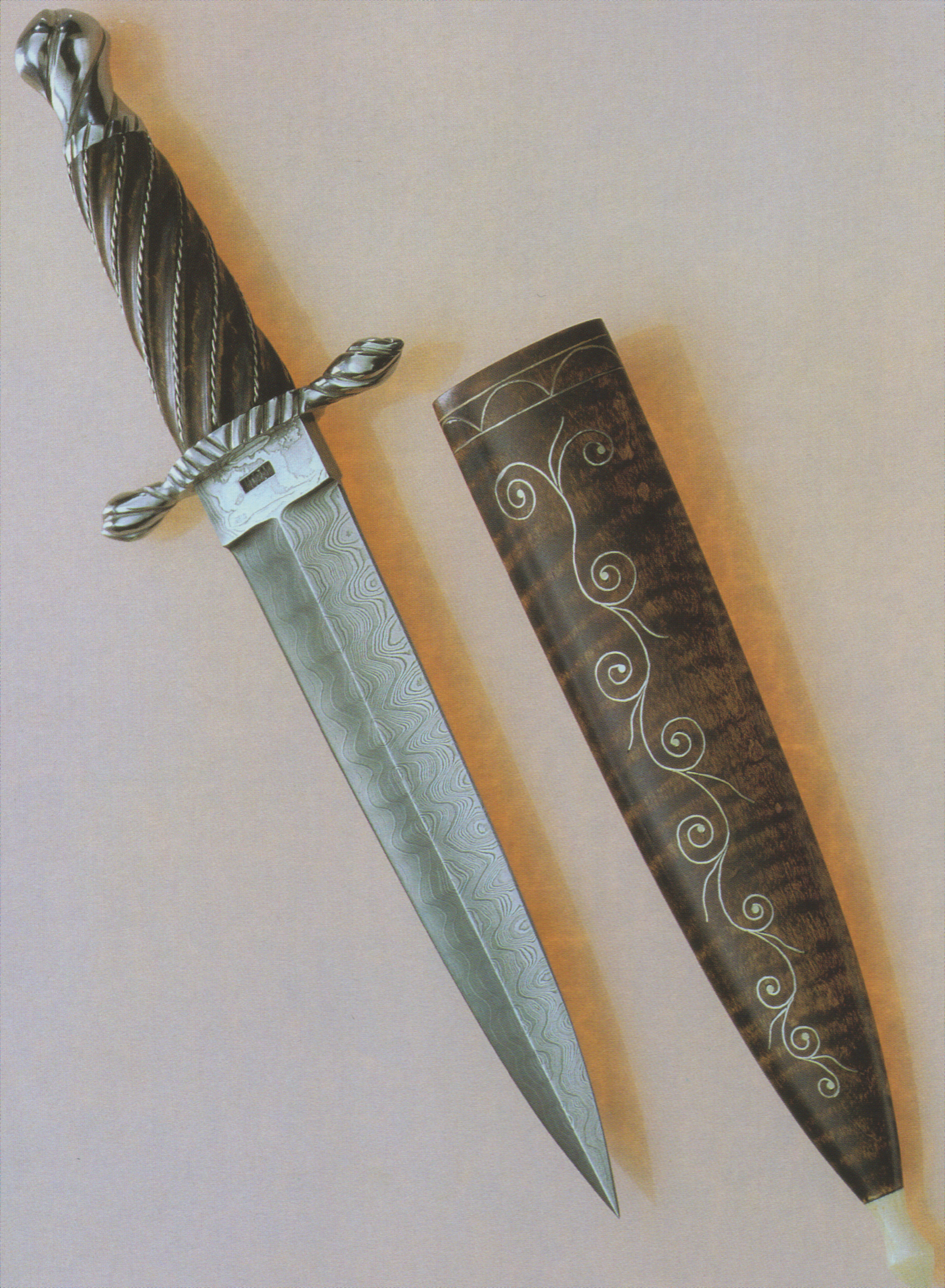

Moran and the Reintroduction of Pattern-Welded Damascus
Moran popularized pattern-welded Damascus in the early 1970s. This was due to his studies of ancient blades [4]: “Ever since I can remember, I, like all who love fine blades, have been fascinated with the beautiful Damascus blade. Many legends abound throughout history pertaining to the wonderful quality of these remarkable blades. After years of study and research, I felt I would like to try making them.” Moran would claim that Damascus blades had better properties [5]:
No one was more surprised than I, when I found this steel did have most unusual qualities. I found these blades could be left as-quenched and still have good flexibility, they also would hold a very good edge. Indeed I am now convinced that many of the old legends concerning these blades are true. These blades were far superior to any other blade because of the hundreds of alternating layers of iron and steel. The principle is the same as plywood or the laminated bow. I am now convinced that Damascus blades stopped being made so long ago for the same reason the wonderful composite bows of the Turks died out; that reason being they were so terribly difficult to make and after the fall of the Saracen empire, man went back to the self-bow which was made from a single piece of wood. The same being true for the Damascus blade; it was so much easier to make a blade from a single piece of steel.
Moran presented his first Damascus blades at the 1973 Knifemakers’ Guild Show in Kansas City. Knifemakers and collectors alike were very impressed. Butch Winter wrote [6]: “In those days the Guild Show crowds weren’t that big. There were a few people looking at Moran’s knives but they more or less were agog and didn’t understand what he’d done. The other makers were saying, ‘I wish I could do that,’ or ‘How’d he do that?'” Moran said that pattern-welded Damascus was key to bringing back forging and making his business sustainable [7]:
[T]he first year I showed my Damascus blades in Kansas City, I took in the most money I had ever made at any one show. For the first time, it occurred to me that it just might be possible to earn a decent living making knives. However, making Damascus cut my production by about two-thirds, and as I get older, it seems that I can’t make knives as quickly as I once did, and I was never a very fast bladesmith.”
Early 1970s Moran Damascus dagger. Weyer photo.

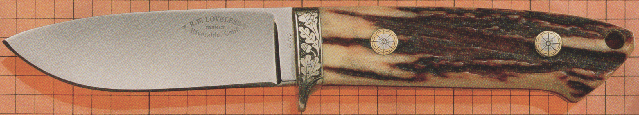

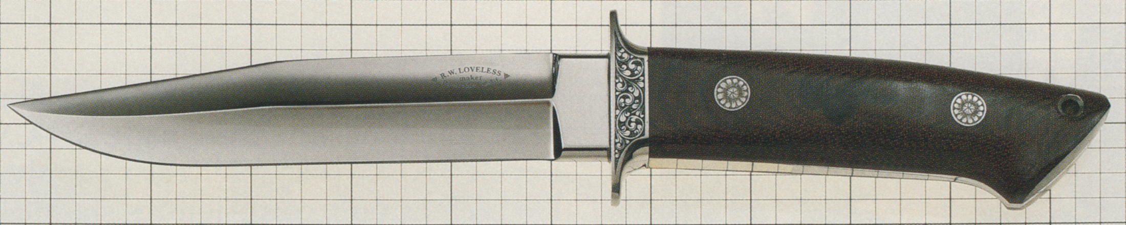

Loveless and Knife Design
Bob Loveless first attempted making knives after reading an article about Randall knives in 1953. He tried to buy one from Abercrombie & Fitch (then a sporting goods store) but the salesperson was rude and said it would be many months to be able to purchase one. Loveless made his own knife and returned to Abercrombie to show the rude sales clerk. He found instead that the clerk had been fired, but the floor manager was impressed with his knife and began ordering dozens of them.
Loveless is perhaps best known for his unique design sense. However, early on his knives looked a lot like Randall’s [8]:
[My first knives] looked a lot like knives that Bo Randall produced. The knives all had narrow tangs, single guards, leather washer handles with finger grooves and an aluminum pommel. Looking back, there is really no comparison between what we produce now and those early knives. They might have been good, solid edged tools, but they were lacking in aesthetics. Thankfully, over the years I’ve been able to break out of that early mold and create knives that not only are functional, but also look good.
Early Loveless knives. Weyer photos.
Loveless felt that first the knife must look good, and then when the customer picks it up it has to feel good [9]:
Eye appeal is the very first thing – it has a bearing on whether or not the knife will be accepted… If it is not appealing to the eye, then the prospect won‘t pick it up. If he doesn’t pick it up – you’re lost. But for the intelligent outdoorsman, you have got to get him to pick up the knife.
A knife must feel good in a man’s hand. Whether we realize it or not, our sense of touch is very critical to us. We get a lot of our input from our fingertips … it has to feel good … since we are directing our effort to the user’s hand primarily … it’s important to the knifemaker to understand the function of the hand… The knife designer, if he’s good, realizes that the human hand defines everything from the guard on back, in his work.
Loveless believed that having real experience was important to designing his knives [10]:
Unless you’ve had field experience, you can’t make hunting knives. I see knives with cutting edges that are too thick. With blades that are too long… With awkward and ill-shaped handles. Too many knife makers don’t understand their own hand. Their knives are not user friendly. You can’t teach a guy to make a good hunting knife if he’s never been in the woods, shot a deer, and been up to his elbows in deer guts. It’s like giving a typewriter to a man who is illiterate.
Loveless’s more developed style. Weyer photo.

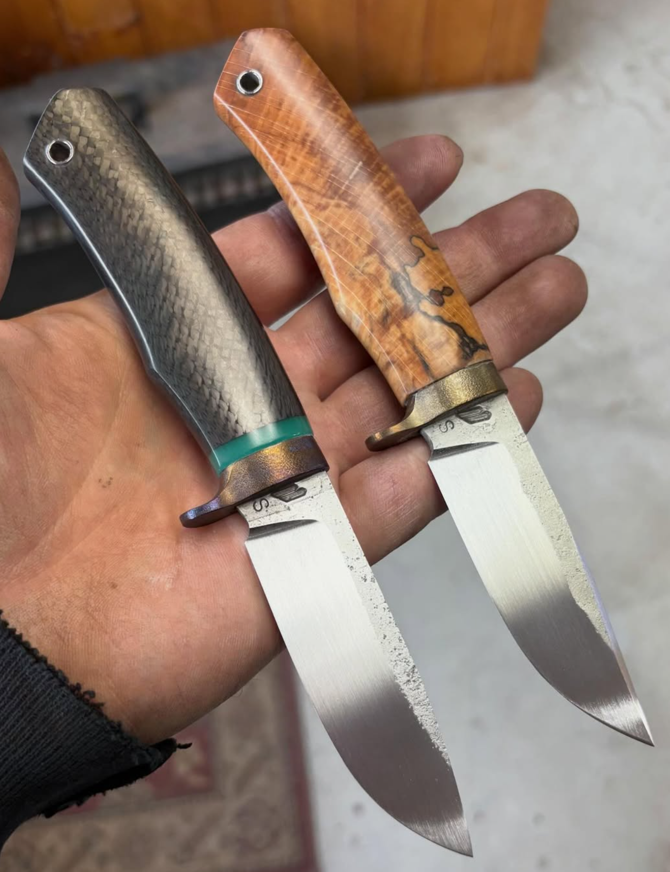

Of course there have been a few brave bladesmiths who have used stainless steel despite the heavy social pressure of the ABS to avoid it, but they have remained a small number. For those who are brave, I have an article on how to effectively heat treat stainless steels that have been forged.
Nick Rossi knives in forged AEB-L
Another big difference between now and then is that the most common stock removal steels were 440C, D2, and 154CM, as Hughes mentioned. Those steels were very different than simple carbon steels. They have much higher carbide volume and thus higher wear resistance, but toughness is limited from those carbide structures. The chromium carbides were also relatively large which also limited toughness. So these steel choices led to very different properties, on the one end were low wear resistance simple steels with good toughness and ease in sharpening, used primarily by forging bladesmiths. On the other end were steels with high wear resistance and relatively low toughness (and some complained about sharpenability), used primarily by stock removal makers. Things have changed since then, such as the rise in popularity of AEB-L. Ironically, that steel dates back to the late 1960s, before the formation of the Knifemakers Guild, but did not become common in USA custom knives until the 2010s. AEB-L was designed for razors, and it has a much finer microstructure and much higher toughness than grades like 440C, D2, and 154CM. It has a much more similar performance profile to a low alloy steel favored by forging bladesmiths. And of course there are now a wide array of powder metallurgy high alloy and stainless steels available with a wide range of properties at different levels of wear resistance, toughness, and corrosion resistance.
I do think that claims from bladesmiths about the superiority of forged blades have slowed down. It was still relatively common in the 1990s and early 2000s but I don’t see it as much anymore. From my perspective the divide between forging bladesmiths and stock removal makers is smaller than ever. I do not see as much arguing about superiority as happened decades ago. It is most common for knifemakers to choose the method that is most appealing to them without making judgments about superiority (or inferiority) of the other method. So I think that improvement should be celebrated.
