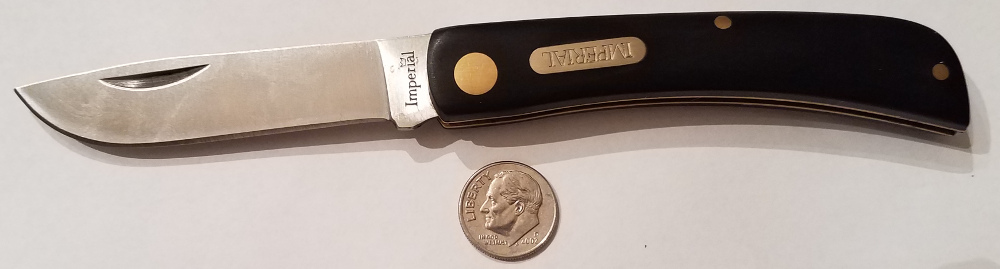

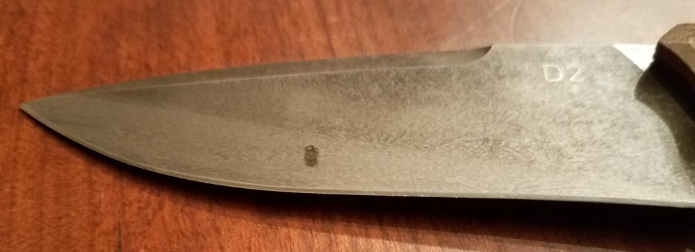

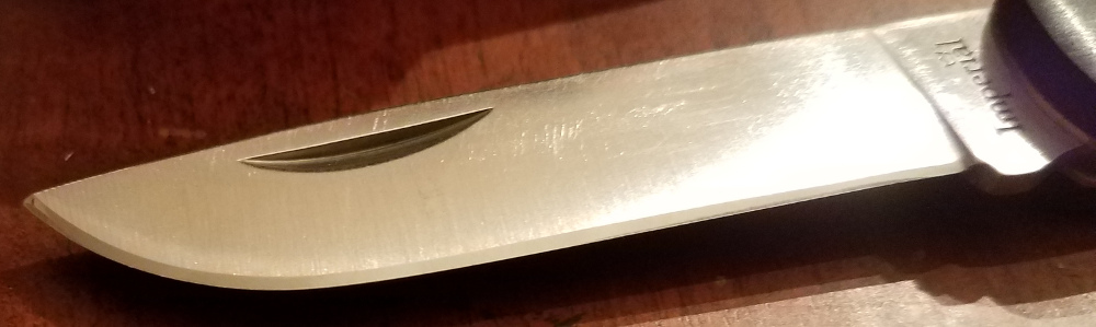

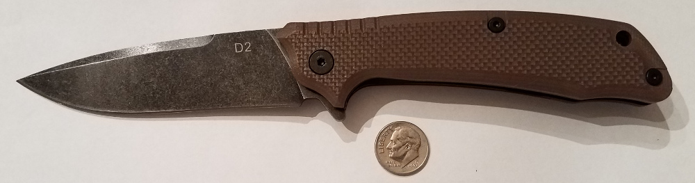

I chose three inexpensive knives to compare the effect of corrosion, at three different levels of corrosion resistance. One is a knife in 1055 which is a simple carbon steel with no inherent corrosion resistance. Another is a D2 knife which represents a “semi-stainless” steel with moderate corrosion resistance. And a knife in 440A which is fully stainless and should have excellent corrosion resistance. The approximate chromium in solution for each steel is 0% for 1055, 6.5% for D2, and 13.9% for 440A. That chromium content in solution controls the degree of corrosion resistance of the steel. The method for estimating the chromium in solution is described in this article on corrosion resistance of knife steel. I re-beveled each of the knives to 20° per side using an Edge Pro with a diamond plate, and then sharpened it with a Sharpmaker, also to 20° per side. The 1055 knife is 53.6 Rc, the D2 knife is 62.0 Rc, and the 440A knife is 55.4 Rc. The low hardness and low wear resistance of the 1055 and 440A knives meant the re-beveling process was very fast, though it also meant the knives were difficult to de-burr.

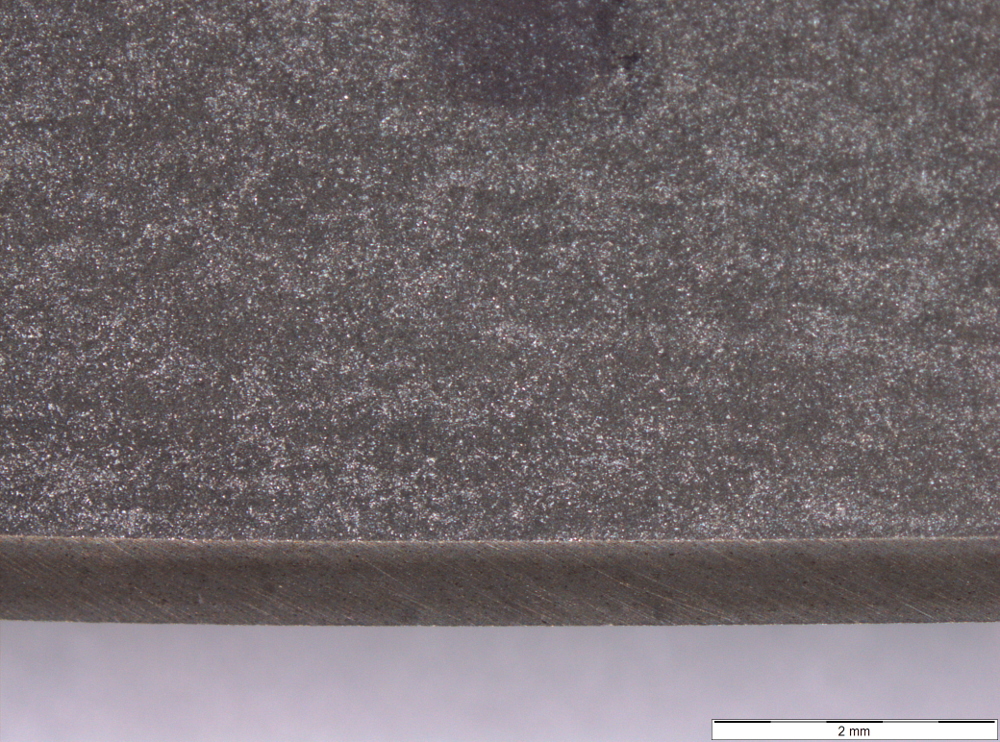

The D2 and 440A knives still sliced paper pretty well, though the 1055 knife was a little rough. I was surprised that the 1055 knife was still slicing paper okay, considering the relatively poor value it measured on the sharpness tester. I think that is because the edge corrosion is leading to increased edge roughness rather than increasing the edge radius. I don’t have sufficient magnification to compare before and after. That change in edge roughness greatly affected the push cutting sharpness test but was comparatively better at slicing paper. Looking at the 1055 and D2 edges, however, corrosion is evident. Surface finish is a strong controlling factor with corrosion, but since each knife was sharpened to the same level, the finish of the edges should be the same. The 440A edge was still so reflective I couldn’t even get a very good picture of it.
1055 knife edge after exposure to lemon juice
D2 knife edge after exposure to lemon juice
440A knife edge after exposure to lemon juice

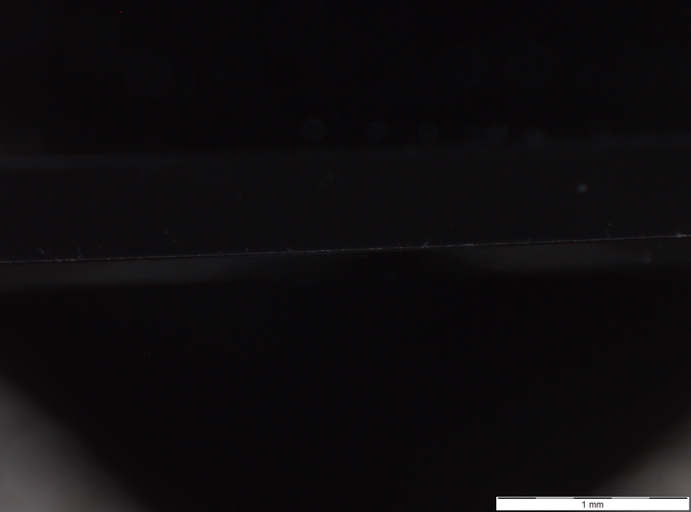

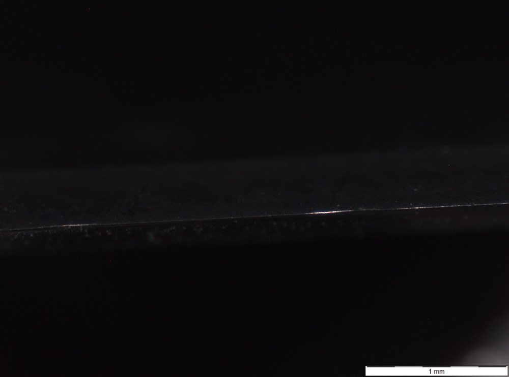

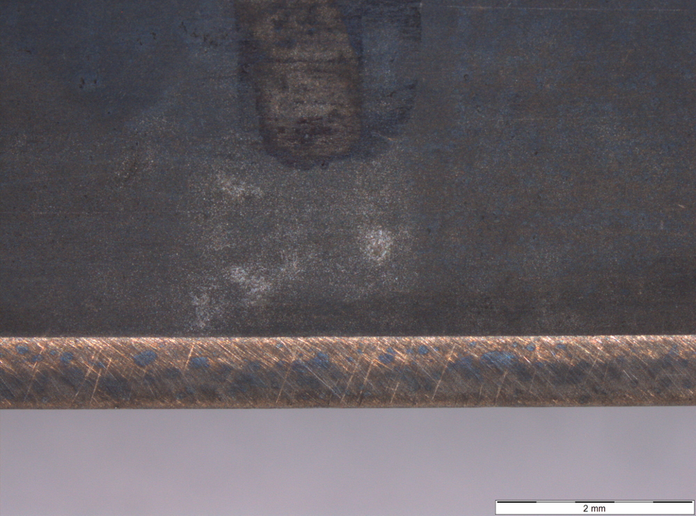

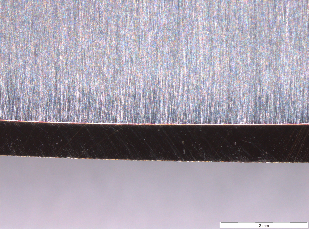

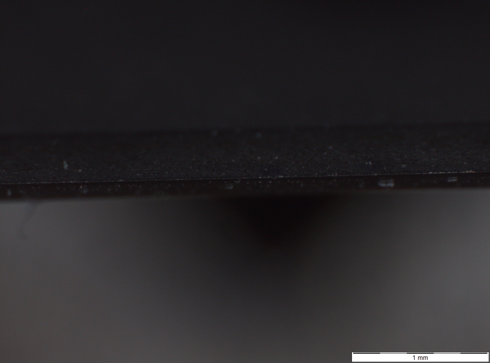

Looking at the edges “edge on” also makes it apparent that the 1055 knife has lost more sharpness than the others. There are more “bright spots” in the edge, indicating that those areas are low in sharpness. In contrast, the 440A edge is largely not visible. The D2 edge is somewhere in between.
The corroded 1055 edge has many visible shiny spots
The D2 edge has a few barely visible regions
The 440A edge is difficult to see indicating better sharpness

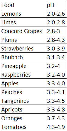

I don’t expect many people to spend 5 hours cutting lemons, though I suppose it is not impossible. Regular exposure to acidic foods is not out of the question, however, and the exposure is likely cumulative; the knife may be used and cleaned several times before re-sharpening. Lemons are not the only food that is acidic. Many fruits have a low reported pH [4]:
