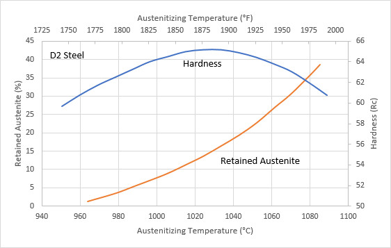

You can see that for two of the datasheets above, the hardness peaks with a carbon content around 0.9% and then decreases above that carbon content. The other studies used liquid nitrogen (cryo) after quenching to increase hardness. Martensite formation is controlled by temperature; lower temperature means more martensite until the transformation is complete. With increasing carbon, the temperature at which martensite begins to form (Ms) is decreased. This also decreases the temperature at which martensite finishes (Mf) its transformation:

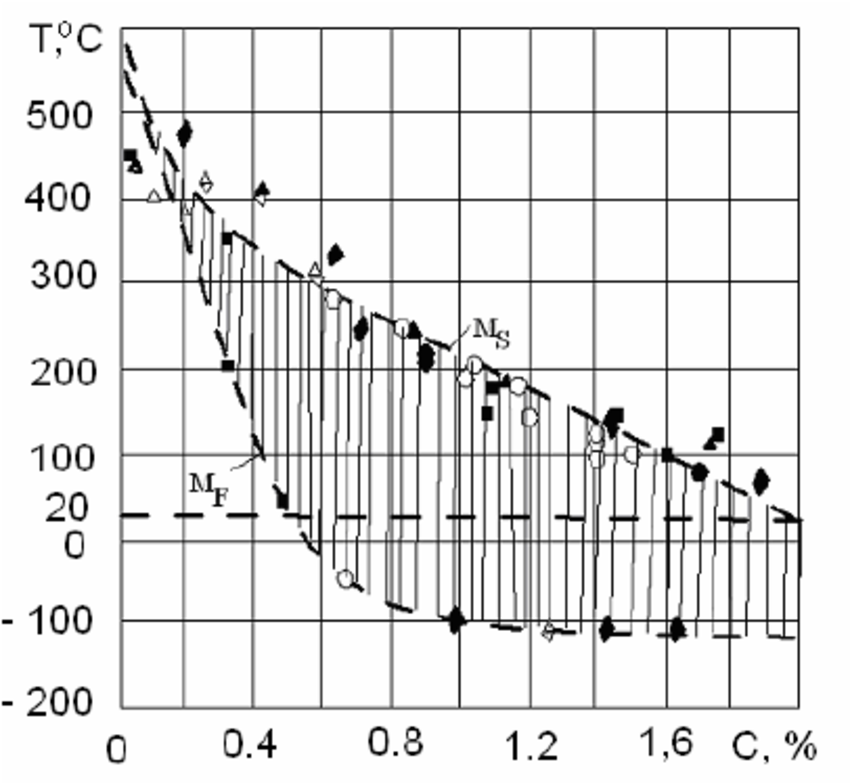

This image from [2]
You can see that the martensite finish temperature can be below room temperature (~20°C) meaning that when the steel is quenched to room temperature the transformation to martensite is incomplete. When the transformation is incomplete there is some amount of “retained austenite” which is a much softer phase and therefore when there is a sufficient amount of retained austenite the bulk hardness of the steel is reduced. This amount of retained austenite is typically in the range of 15-20% where peak hardness is achieved:

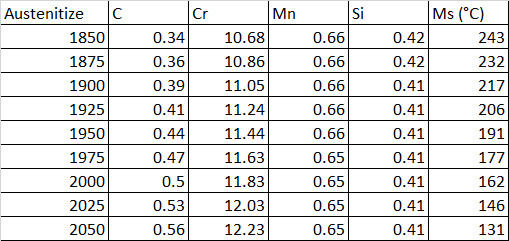

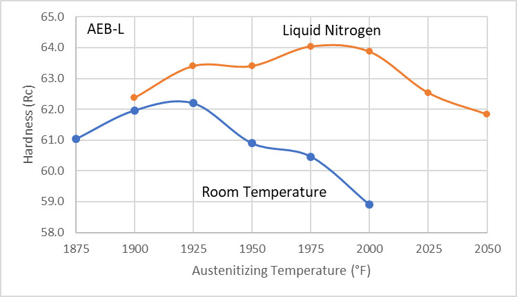

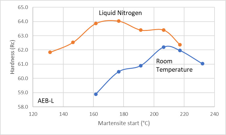

To give one more example before we get to Vanax, I will give a short description of AEB-L using data previously presented in this article about AEB-L. I heat treated AEB-L with different austenitizing (hardening) temperatures followed by plate quenching, and some of the samples I put in either my freezer or liquid nitrogen. I am going to focus on the room temperature and liquid nitrogen conditions here to simplify things. Just like in the D2 chart above, there was a peak in hardness, which was seen with both room temperature and liquid nitrogen conditions:
As the austenitizing temperature increases, more carbide is dissolved putting more carbon and chromium “in solution” to contribute to hardness, corrosion resistance, and the martensite formation temperatures. I have calculated the different alloying elements in solution using JMatPro along with the estimated Ms temperature:

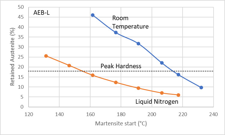

The estimated martensite start temperature correlates well with the retained austenite that I measured with the steel:
You can see that liquid nitrogen was effective at reducing the retained austenite but did not fully eliminate it. However, a higher austenitizing temperature can be used (and a correspondingly lower martensite start) to acheive higher hardness. The martensite start at which peak hardness is achieved is reduced from about 210°C to 170°C:
The hardness achieved is also higher with liquid nitrogen because the peak hardness was reached with a calculated carbon in solution of about 0.47-0.5% (1975-2000°F) while only about 0.41% carbon was in solution with a 1925°F austenitize when quenched to room temperature. Therefore we can effectively get more carbon in solution to contribute to hardness when using liquid nitrogen because the retained austenite is reduced so that it does not affect hardness to the same extent.

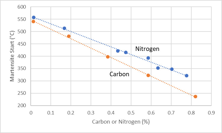

When it comes to decreasing martensite start and therefore increasing retained austenite, however, nitrogen does not contribute as strongly:
Adapted from [7][8]

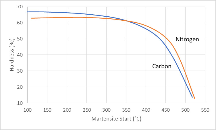

I calculate the slope of the nitrogen line above at -311°C per 1% nitrogen, which is lower than the value of carbon mentioned earlier at -423°C. If we plot the martensite start vs hardness for both nitrogen and carbon we can determine which will result in higher hardness when accounting for retained austenite:
Nitrogen is able to provide more hardness for a given reduction in martensite start up to about 61 Rc, after which carbon overtakes it because of its greater contribution to peak hardness.

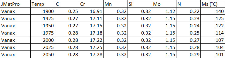

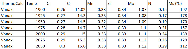

OK. We made it to Vanax. The recommended austenitizing temperature for Vanax is 1080°C (1975°F) along with a cold treatment. So I calculated the alloy in solution at different temperatures using both JMatPro and ThermoCalc:
The Ms temperatures calculated using JMatPro alloy in solution are significantly lower than ThermoCalc. JMatPro calculates more nitrogen and chromium in solution than ThermoCalc does. With AEB-L we got peak hardness when using cryo with an Ms around 160°C, which is higher than any of the calculated values from JMatPro. Therefore I think that ThermoCalc is more accurate as its estimated Ms with 1975°F is around 157°C which is in line with what we would expect for peak hardness. Using our carbon and nitrogen hardness information from earlier, we can estimate the maximum potential hardness using the carbon and nitrogen in solution:

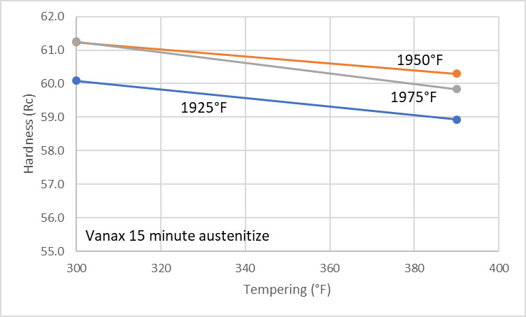

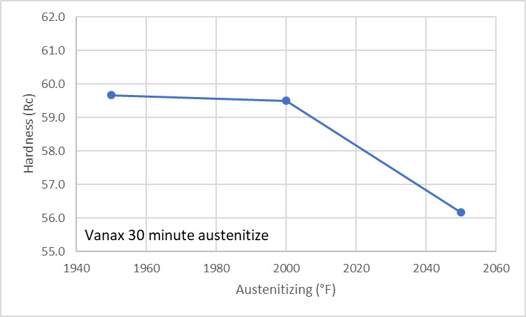

So we expect a peak hardness of about 62 Rc, which is substantially lower than used in many kitchen knives with 63 Rc or even 65+. I heat treated Vanax using my Evenheat furnace with steel wrapped in foil, held at the austenitizing temperature for 30 minutes, plate quenched, and then dipped in liquid nitrogen for 30-60 minutes:

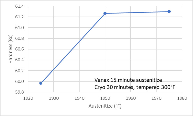

I did not achieve even 60 Rc. Hardness peaked in the range of 1950°F which is consistent with the calculations shown above, but there we estimated 61.6 Rc. 2050°F austenitize is clearly too high and led to reduced hardness due to retained austenite. Based on the relatively low hardness achieved and concerns that nitrogen is lost at high temperature, I reduced the hold time at the peak temperature to 15 minutes, narrowed the range tested to 1925-1975°F, and tempered everything at 300°F:
Hardness was identical with 1950 and 1975°F, indicating that that is about the peak austenitize for hardness. We got just over 61 Rc which is an improvement relative to the non-tempered samples, and close to the predicted 61.6 Rc for 1950°F. I am not sure if the hardness was higher here because the low temper increased hardness somewhat (learn why this might occur in this article), or if the as-quenched hardness was improved as well with the shorter austenitize. I was particularly interested in the low 300°F temper because the Vanax datasheet only shows information from 200°C (390°F) tempering and higher. And I tried the 2050°F austenitizing temperature before because only 1050 and 1080°C are shown in the datasheet:

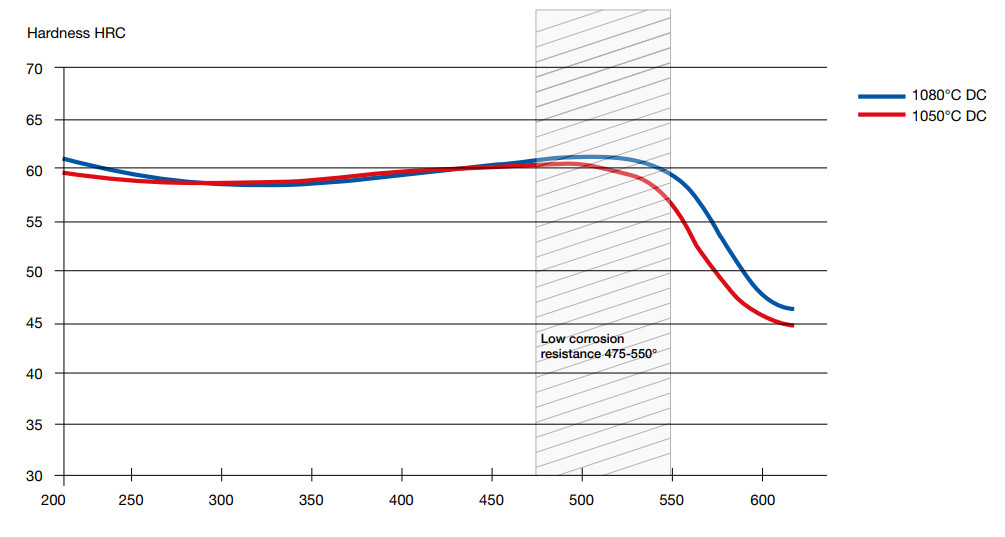

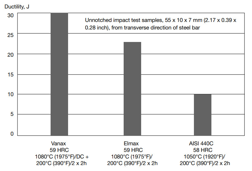

Interestingly, the hardness is shown to be as high as 61 Rc with a 200°C temper in the tempering curve, but with the same heat treatment for their toughness testing they show only 59 Rc:
Image from [9]
With a similar heat treatment I split the difference with about 60 Rc:

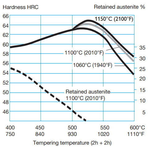

Another way to reduce retained austenite is to use high temperature tempering. This can be effective to eliminating retained austenite even in cases where liquid nitrogen doesn’t. Here is an example of the reduction in retained austenite using high temperature tempering with Vanadis 4 Extra steel:
Image from [10]
You can see that Vanax is shown to have another peak in hardness with a tempering temperature around 500°C:

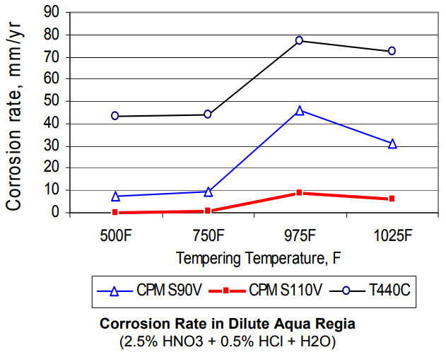

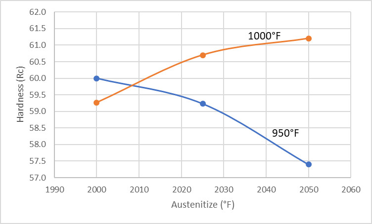

However, you can also see in the chart above that S110V still has quite good corrosion resistance with high temperature tempering, better than 440C. Perhaps with Vanax the corrosion resistance would still be very good if we temper at a high temperature. And regardless, I wanted to see if we could bring the hardness yet higher with such a tempering treatment. So I austenitized at 2000, 2025, and 2050°F and tempered at 950 and 1000°F followed by measuring the hardness:
With a 950°F temper the hardness goes down above a 2000°F austenitize, probably indicating that the temper was not sufficient to transform retained austenite. With 1000°F, however, the hardness was highest with a 2050°F austenitize. However, the hardness still topped out just above 61 Rc. So not really an improvement versus what we got with low temperature tempering. After these results I tried 2100°F and 2150°F along with a 1000°F tempering treatment but the hardness dropped to the low 40’s. Perhaps a yet higher tempering temperature is required to transform the retained austenite after such high austenitizing temperatures.
