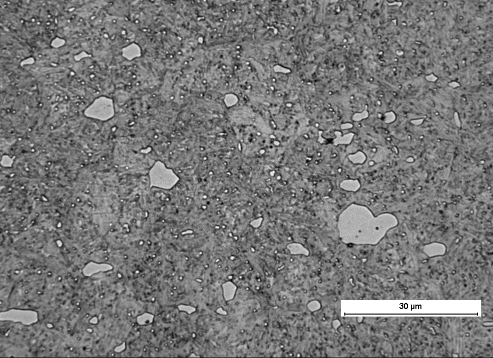

AEB-H/19C27 microstructure with some large carbides
13C26 (same as AEB-L) with very small carbides

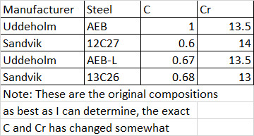

Wilkinson first released stainless razors in Britain in 1956. In the early 1960’s Wilkinson sword introduced stainless razors on a broad scale, which quickly gave them a competitive advantage [3]. Gillette patented the polymer coating on razor blades which made the shave smoother and protected the blade from corrosion [4], which mentioned stainless steel as an option in 1959, but had not released any stainless razors. Schick, American Safety Razor, and Gillette all released their own stainless steel razors in the years shortly after Wilkinson [3]. Stainless razors were so disruptive that Gillette, despite being the largest razor manufacturer in the world, had dropped 8% in 1963 and a further 11.5% in 1964. AEB-L was not used in these early razors. Wilkinson’s patent on stainless razors listed Uddeholm SS716 (0.35C-13.5Cr-1.0Mo) and the previously mentioned AEB, but AEB-L was not mentioned [5]. Uddeholm did, however, produce the majority of the stainless steel for razors, with 85% made by Uddeholm in 1961 [6].
The development and transition to AEB-L from AEB is hard to track. AEB-L has reduced carbon relative to AEB (0.65-0.7% C) which gives it a much finer carbide structure, while being capable of much higher hardness of lower carbon steels like Uddeholom 716. The finer carbide structure makes it capable of better sharpness than AEB, though superior fine blanking (stamping without cracking), and improved cold rolling performance were likely significant factors. I found a reference to an Uddeholm steel with 0.5%C and 13%Cr used in microtome knives (require very high sharpness) in 1955 [7], but I can’t find a name for this steel and it doesn’t seem to have been used in razors. A Gillette patent filed in 1962 references only AEB as an example of a stainless razor steel [8], but in a patent filed in 1964 it references both Uddeholm AEB and Sandvik 12C27 [9]. 12C27 still exists today but may have served as a precursor to Uddeholm AEB-L and Sandvik 13C26. 12C27 has somewhat less carbon (0.6%C) and somewhat higher chromium (14%), and its properties are close to AEB-L and 13C26. I believe that the good performance of 12C27 led to AEB-L and 13C26 which were adjusted to have higher hardness. The German 1.4034 steel (0.45%C, 13%, Cr) existed by at least 1957 [10], which may have also served as a stepping stone to the higher carbon 12C27. Uddeholm filed for patents of processing methods for decreasing the final carbide size of steel in the late 1960’s [11][12], both for improving cold rolling performance (avoid cracking) and toughness. Those patents included a composition for AEB-L. So the timeline as I see it is that Wilkinson started producing stainless razors in Uddeholm AEB in 1955-1956, Sandvik 12C27 saw some use by 1964, followed by Uddeholm AEB-L in the mid or late 1960’s, and Sandvik 13C26 by 1975 [13].
Use of AEB-L and 13C26 in Custom Knives
12C27 and AEB-L have been used in production knives for many years, particularly in Europe, due to their very good blanking properties, which is significantly cheaper than saw cutting or waterjet cutting. However, the steel used in those knives was not frequently advertised so finding an early date for them is not easy. Sandvik and Uddeholm sold some steel to custom knifemakers but had minimum order sizes which were prohibitive to most. My father, Devin Thomas, began using AEB-L in the early 1990’s in his stainless damascus. He had been looking for a steel available in thin strip to minimize the number of forging and re-welding operations. Wayne Goddard recommended that he look into AEB-L. Advertising the damascus as being produced in AEB-L was a roadblock as the steel was not widely known, and the composition was not exciting with only 0.68% carbon. Up until 2005 popular articles summarizing types of blade steel stated that AEB-L is similar to 440B stainless, which has a poor reputation [14]. In March 2005, John Verhoeven released “Metallurgy for Bladesmiths” where he wrote about AEB-L as being an ideal blade steel due to its very fine carbide size and high potential hardness [15]. Also in 2005, I wrote a short summary about AEB-L for DevinThomas.com to promote the virtues of AEB-L where I attempted to describe why it is different than 440A and 440B [16]. In 2006 Roman Landes published Messerklingen und Stahl where he gave AEB-L very high scores for sharpness, ease in sharpening, toughness and edge stability. The steel continued to see little use in custom knives, in part because it was not regularly available at knife supply companies.
By 2004, Kershaw began to use Sandvik 13C26 [18], and more broadly in 2007 [19] due to its high potential hardness and very good blanking performance. Sandvik began attempting to get into the knife market to a greater extent at this point, and began selling their 13C26 through Admiral Steel in the US in 2007 [20]. Sandvik developed 14C28N for Kershaw to improve the corrosion resistance of 13C26, and those knives were being sold by 2009 [21]. You can read about what the nitrogen addition to 14C28N does in this article. The 13C26 steel was used in relatively inexpensive consumer knives where returns are likely if any rust is observed, leading to the development of 14C28N. By 2010 AEB-L was also offered in good sizes for knives through supply companies [22] and its popularity grew to today where it is relatively common in custom knives.

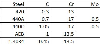

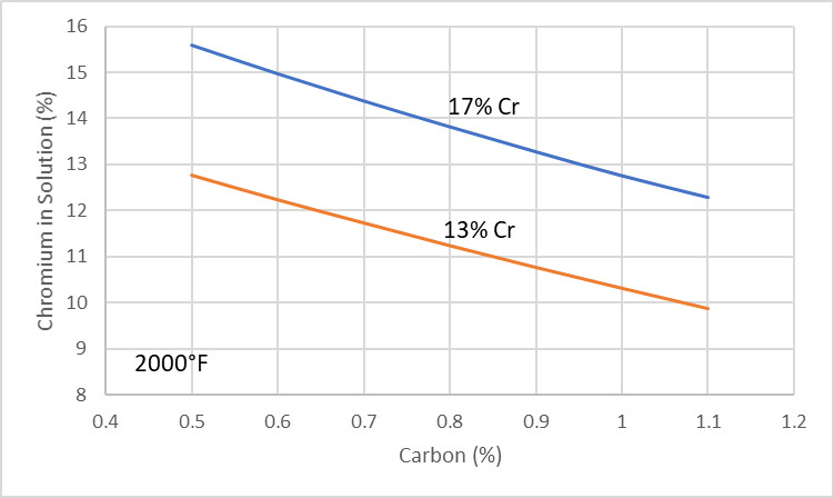

There seem to have been two directions that metallurgists had gone with previous stainless steels, either the high chromium 17% approach or the low chromium approach with 13%. 420 with 0.3% carbon and 13% chromium was the first commercial stainless, and when carbon was raised to increase hardness they thought that chromium also needed to be increased to maintain corrosion resistance, which led to 440A and 440C. AEB had significantly less corrosion resistance than those other steels (around 10.5% Cr in the chart below), despite the claim that Mn would improve corrosion resistance. As expected, with higher chromium, the “chromium in solution” that contributes to corrosion resistance is higher. If the chromium is not “in solution” it does not contribute to corrosion resistance. You can read more about chromium in solution and corrosion resistance in this article.

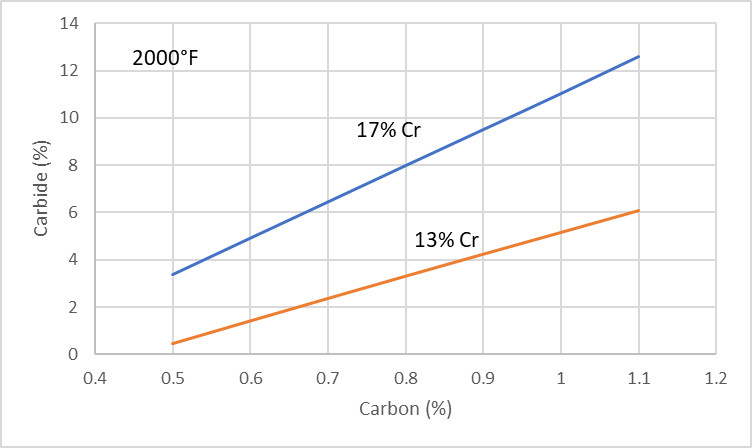

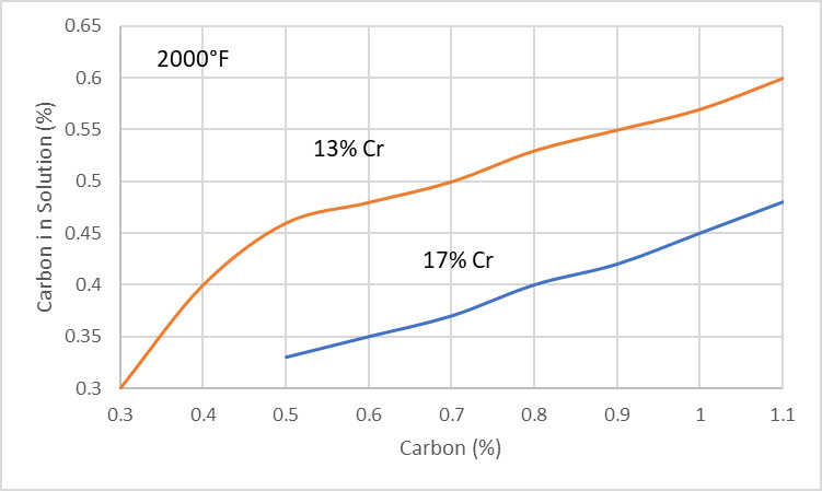

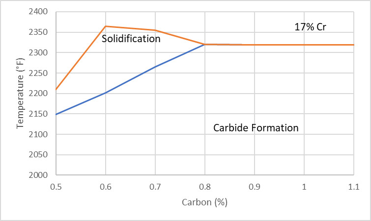

The reason that the increase in carbon decreases the amount of chromium in solution is because more chromium carbides are formed. More carbon means the steel wants to form more carbide. So if you want to add more carbon to the steel, corrosion resistance can be maintained if the chromium content is also increased. However, more chromium also reduces the amount of carbon that goes in solution to contribute to hardness. If the carbon is tied up in carbides then it is not contributing to hardness. You can read about how carbon increases hardness in this article. To regularly reach 60+ Rc we probably want about 0.5% carbon in solution, which for a steel with 13% bulk chromium requires about 0.7% carbon on the chart below. For a steel with 17% bulk chromium, more than 1.1% carbon is required to reach the same carbon in solution:
So because of the effect of higher chromium, carbon in solution only increases from 0.3% to 0.37% by moving from 420 to 440A, despite 440A having 0.4% higher carbon. Where does the extra carbon go? To carbides. More chromium means the steel wants to form more chromium carbide. So more carbon and more chromium both lead to more carbides. That can be seen in the following chart:

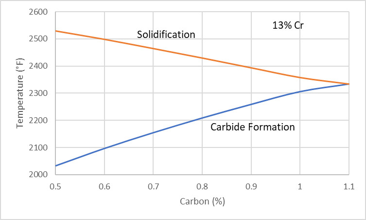

More chromium carbide means better wear resistance, but at some point the greater amount of carbide and larger carbide size will mean that toughness and blanking performance is poor. During casting of the liquid steel, different phases can form at different temperatures. The typical high temperature steel phase “austenite” can form as well as chromium carbides. The higher the temperature is that the carbides form the larger they will be, and that temperature is also controlled by the carbon and chromium content. I have plotted the temperature at which the steel solidifies to austenite (“solidification”) and also the temperature at which the chromium carbide begins to form for both 17% and 13% chromium:

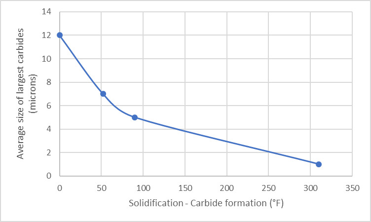

The higher the temperature of carbide formation, the larger the carbides are, particularly when carbide forms at the same temperature that the steel completes solidification. When the carbide formation and solidification temperature are the same that leads to the formation of “ledeburite,” a combination of carbide and austenite, which is difficult to break up during forging leading to large chromium carbides. You can learn about ledeburite and how powder metallurgy helps in this article. If we subtract the carbide formation temperature from the solidification temperature, the difference correlates very well with carbide size:
Though the thermodynamic software predicts that the carbide formation occurs at a lower temperature than solidification for all but the “0” point on the chart above, segregation of elements like carbon and chromium means that it is more and more likely that ledeburite is formed the smaller the predicted difference between solidification and carbide formation. At the top end is 440C with carbides over 10 microns, and AEB-L on the low end with carbides of one micron or less:
440C has large carbides
13C26 (same as AEB-L) has tiny carbides

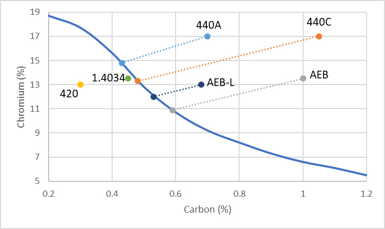

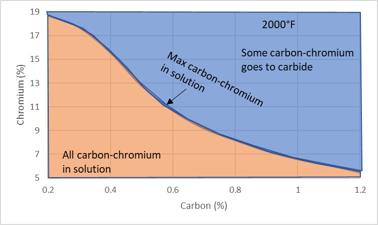

So the design of AEB-L is essentially the following: maximize hardness and wear resistance while still maintaining very tiny carbides and good corrosion resistance. If we take the same plots of carbon and chromium in solution, we can make another view that tells us the maximum combinations we can achieve with different carbon and chromium contents:
Any place in orange on the chart means that all of the carbon and chromium is in solution at 2000°F. So a steel with 0.4% carbon and 11% chromium at 2000°F would have no carbide and would have 0.4% and 11% chromium in solution. The line marked “max carbon-chromium” is the point above which some carbide will form (the blue area). An infinite amount of carbon and chromium cannot be in solution because carbides will form. So with 0.4% carbon in solution the maximum amount of chromium in solution is about 15.5%, and with 1% carbon it is 6.5%. The farther away the steel composition is from the max line the more carbide that has formed. So first we need to pick a place along the line that gives the balance of hardness and corrosion resistance we want. To achieve high hardness, we should have around 0.5% carbon in solution, as that will give us about 62 Rc as-quenched so that we can temper down to 60 Rc:
The 0.5% carbon point on the max carbon-chromium line also gives us around 12-12.5% chromium in solution which is sufficiently high for good corrosion resistance, as shown in this chart showing the amount of weight loss (corrosion) for different levels of chromium:
Then we can set how much carbide we want by the distance from the “max carbon-chromium” line. We want a relatively small fraction of chromium carbide to provide wear resistance, while not having so much that we have large carbides like 440A, 440C, and AEB. You can see the position of the previous stainless steels relative to the diagram, along with the “tie lines” for AEB-L, 440A, 440C, and AEB showing the carbon and chromium in solution. The length of the tie line is an indication of how much carbide is present.
So AEB-L is an expertly designed steel, balancing high hardness with good corrosion resistance, and maxing out the amount of carbide that still maintains high toughness, sharpness, and blanking performance for razors. Those qualities make it a good knife steel in many ways as well.

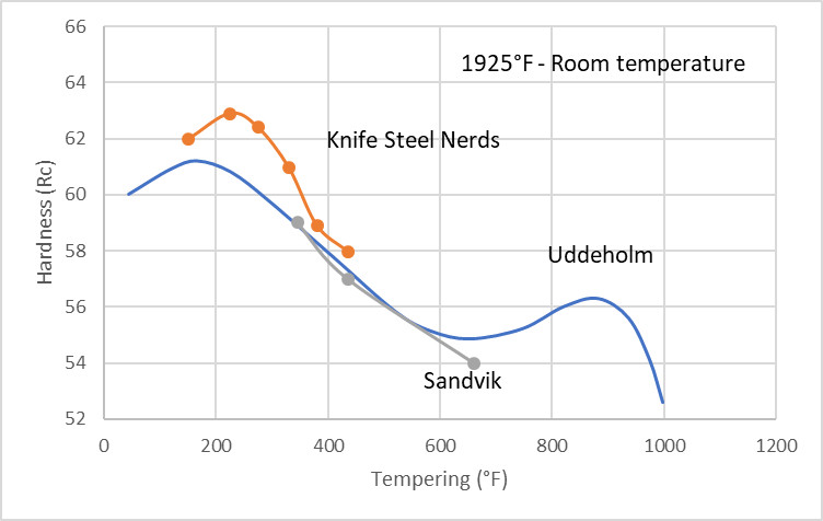

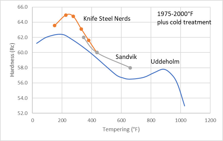

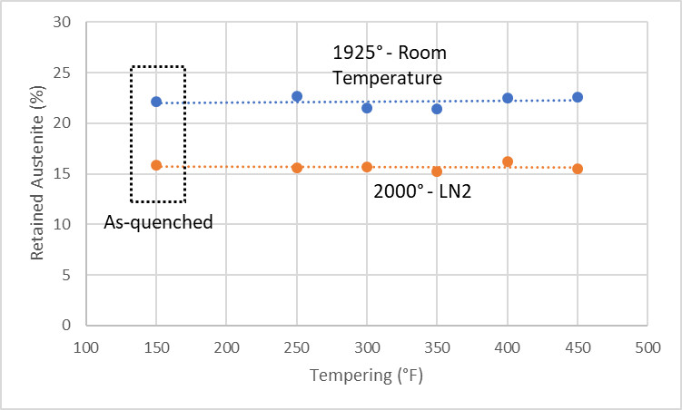

I did some simple heat treatment experiments with AEB-L recently, measuring hardness and retained austenite with different austenitizing/hardening temperatures. For each temperature I held for 15 minutes prior to a plate quench, followed by either liquid nitrogen for 30-60 minutes, my household freezer for 30-60 minutes, or no cold treatment. As expected, the liquid nitrogen treatment cryogenic treatment led to the highest hardness, followed by the freezer, then room temperature. Some have claimed that a freezer isn’t cold enough to do anything. You can read about cryo, freezer, and other cold treatments in this article.
Using the freezer or liquid nitrogen also raises the austenitizing temperature that leads to maximum hardness: 1925°F with room temperature, 1950°F with the freezer, and 1975°F with liquid nitrogen. The peak hardness was increased from 62.2 Rc with room temperature to 62.8 Rc with the freezer, to 64 Rc with liquid nitrogen. Higher austenitizing temperature means more carbon in solution for higher hardness, but more carbon and chromium in solution also increases the amount of retained austenite. At some amount of retained austenite, usually in the range of 15-20%, the soft austenite begins to affect the bulk hardness of the steel and the hardness drops. This was also seen in retained austenite measurements of AEB-L:
Interestingly, the peak hardness is obtained with less retained austenite when using liquid nitrogen than when cooling only to room temperature, about 12% for liquid nitrogen (1975°F) and about 22% for room temperature (1925°F). Perhaps that means that strength is higher when using cryo even when at the same hardness. Learn why in this article about why rockwell hardness can be misleading. I also generated a tempering curve for 1925°F with room temperature and 2000°F with cryo:
The hardness is increased by using low tempering temperatures, you can learn why in this article on tempering. Some of that hardness is maintained even with 300°F tempering, where nearly 65 Rc was reached with cryo. 300°F tempering temperature is the minimum that I typically recommend for heat treating with good toughness.
Some low alloy steels can lose some retained austenite during tempering at temperatures of 400 or 450°F, but the high chromium content of AEB-L means that retained austenite was flat because the loss of austenite was suppressed:
My values for hardness are similar to, though somewhat higher than, those reported by Uddeholm [23] and Sandvik [24][25]:

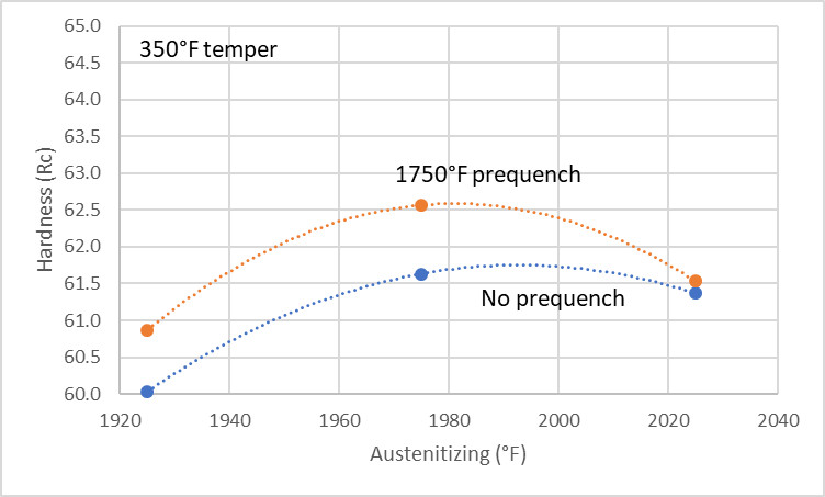

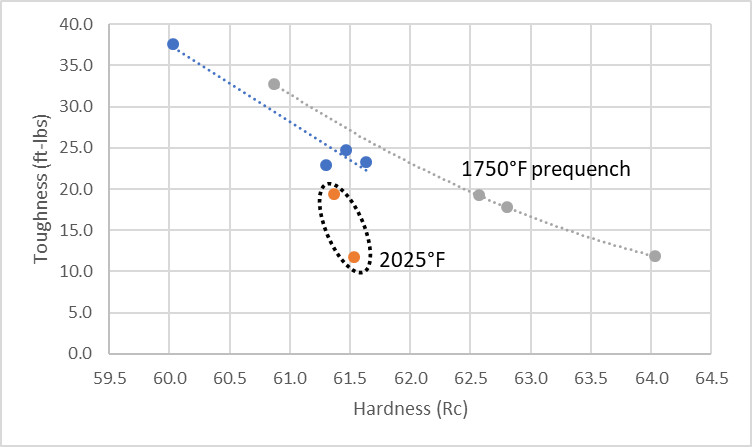

Along with Michael Drinkwine we recently did a study on AEB-L toughness, looking at a range of heat treatment parameters. You can read about our toughness testing procedure here. One thing we wanted to look at is the effect of a prequench. A prequench is similar to the “multiple quench” or “triple quench” used in low alloy steels for grain refinement. We tested a triple quench with CruForgeV and found no benefit to toughness in this article. And I have previously written about prequenches in this article. Multiple quenches with high alloy steels have been found to lead to “discontinuous grain growth” leading to larger grains and poorer toughness. However, if the first quench is performed from a lower austenitizing temperature, grain refinement has been observed with D2 and M2 tool steels:

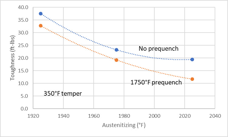

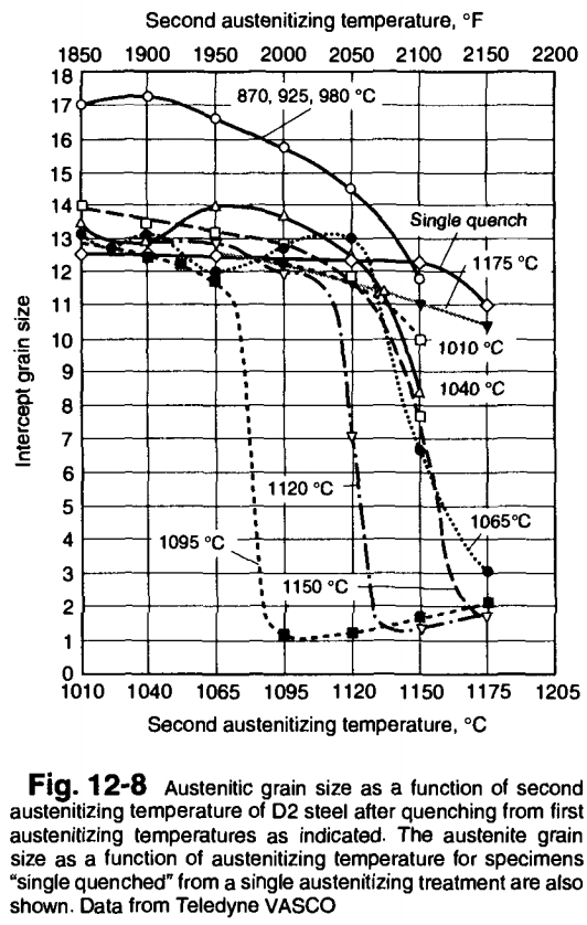

In the chart above you can see that a double austenitize and quench from 1010 °C (1850°F), the common temperature for D2, there was no grain refinement. However, if the first austenitze and quench was performed from 870, 925, or 980°C (1600-1800°F) then the grain size was smaller. No toughness numbers were included, however.

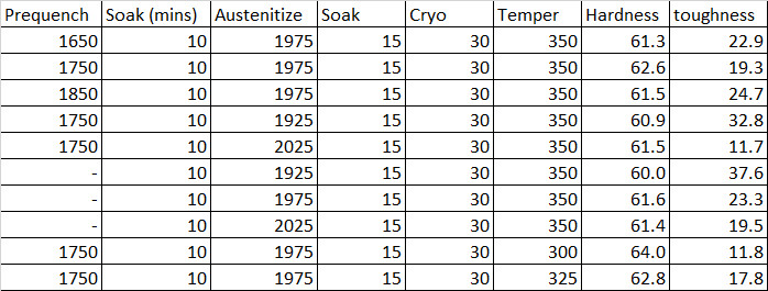

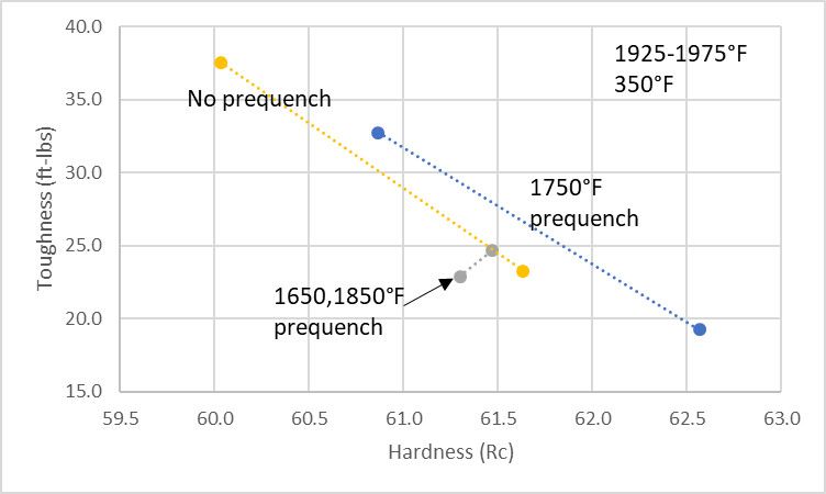

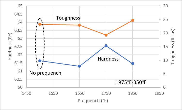

So for AEB-L we tried prequenches of 1650, 1750, and 1850°F, all for 10 minutes and plate quenched, followed by an austenitizing at 1925, 1975, or 2025°F, plate quenched, and given a 30 minute cryo treatment. They were finally tempered twice for an hour each time at 350°F unless otherwise indicated.
Unfortunately, prequenching does not appear to have improved toughness. Toughness was flat with the exception of the 1750°F prequench which had lower toughness because the hardness was increased for reasons unknown. There may have been a small improvement using 1850°F but that could very well be experimental noise.
Comparing the 1750°F prequench across different austenitizing temperatures, it is seen that the increase in hardness was consistent. The increase was smallest at 2025°F, likely because retained austenite lowered hardness at that temperature:
There was a corresponding decrease in toughness because of the higher hardness from the 1750°F prequench. However, the greatest decrease in toughness was with 2025°F austenitize despite having very similar hardness. That may indicate that the prequench led to either grain growth or excessive carbon in solution for a decrease in toughness when over-austenitized:
When plotted vs hardness this same behavior is seen, where toughness is primarily controlled by hardness whether prequenched or not, expect for the case of 2025°F austenitizing which I will discuss later. However, in the cast of the 1750°F prequench the hardness-toughness balance is a little bit better than the non-prequench, and 1650 and 1850°F prequench heat treatments. There is enough scatter in toughness testing that this may have not been a real improvement. On the other hand, a small decrease in grain size fits this degree of toughness improvement.

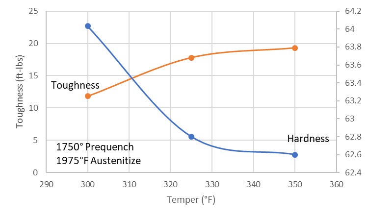

When looking at tempering, increase from 300 to 350°F leads to a decrease in hardness and an increase in toughness, as expected. There is no big drop off in toughness by using 300°F, so it is probably safe to got that low for tempering temperature with this steel, if the extra hardness is desired:
Decent toughness (11.8 ft-lbs) was obtained even with 1975°F-300°F giving 64 Rc. Plotting hardness vs toughness for all heat treatments shows that hardness was the primary controlling factor for toughness as long as the steel was not over-austenitized:

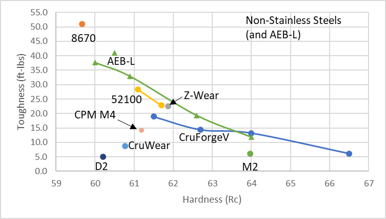

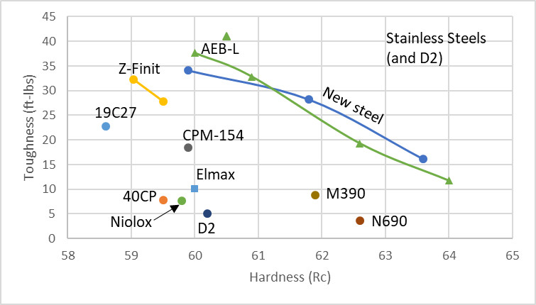

Toughness Compared
These toughness values are slightly lower than a previous test we did with AEB-L using a 1950°-350°F heat treatment using cryo but no prequench. However, that difference can probably be explained by a different batch of steel or perhaps just experimental variability. That higher toughness datapoint is the separate floating green triangle along with the simplified dataset from the toughness testing with Michael Drinkwine. Regardless, AEB-L still scores very well for toughness relative to other steels, particularly stainless steels, due to its small volume of very tiny carbides. You can read how carbides affect toughness in this article.
In terms of stainless steels AEB-L beats everything except for possibly “new steel” which was discussed briefly in this article on niobium steels. AEB-L at 62.2 Rc matches the toughness of 59.8 Rc CPM-154. And at 64 Rc AEB-L is still tougher than a range of steels including D2, M390, and Elmax at lower hardness. In terms of non-stainless steels AEB-L is slightly better than 52100 and Z-Wear, an impressive showing, though it does not quite match the very tough 8670. At 64 Rc AEB-L is approximately equal to CruForgeV at the same hardness. These excellent toughness values means that AEB-L can be heat treated to high hardness for high “edge stability” for thin edges that need high strength. Maximizing hardness also means that wear resistance is maximized, of course. Lower hardness can be used for applications that require very high toughness.

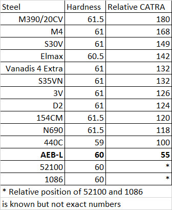

The factors that control slicing edge retention are described in this article on CATRA testing. In terms of knives, edge geometry is the most important factor for edge retention. In terms of steel, the hardness of the steel, the hardness of the carbides, and the volume fraction of the carbides control edge retention. High hardness steel, and a large volume fraction of very hard carbides is best for high edge retention.
After heat treatment AEB-L has around 4-6% chromium carbide. That is significantly less than lower toughness stainless steels like 440C, CPM-154, Elmax, M390, etc. which all have 16%+. That is why AEB-L has very high toughness, but it also means that the wear resistance and slicing edge retention is not going to match those high carbide stainless steels. However, because chromium carbides are harder than the iron carbide cementite in low alloy steels like 1095, O1, and 52100, AEB-L does slightly exceed the edge retention of those steels. That was confirmed in CATRA testing by Verhoeven where he compared AEB-L with 52100 and 1086 [26]. We previously compared the CATRA edge retention of AEB-L with 154CM and AEB-L/154CM damascus, which I first wrote about in this article. This relative value allows us to compare the edge retention of AEB-L with other steels using results reported by Crucible [27] and Bohler-Uddeholm [28]:
The values above are the edge retention numbers relative to 440C, hence why it is 100, meaning 60 Rc AEB-L has approximately 55% of the slicing edge retention of 440C at 59 Rc. Heat treating AEB-L to higher hardness would increase the slicing edge retention value but to what extent is not known. Using the previously calculated effect of hardness on CATRA edge retention, I would expect AEB-L to reach as high as 75 on the chart above when at maximum hardness.

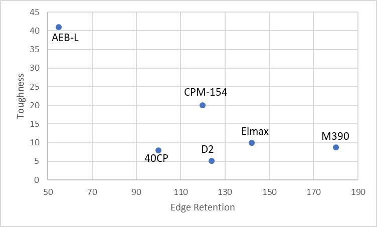

Plotting toughness vs edge retention shows that AEB-L is by itself compared to many of the commonly available stainless steels:
AEB-L has much higher toughness and correspondingly lower edge retention than many other common stainless steel options. Other stainless steels not on the chart (S35VN, Vanax), are unlikely to come close to the toughness of AEB-L because they also have very high carbide/nitride volume (13%+). AEB-L is really a steel that is more similar to low alloy steels like 52100 and O1, where they have very good toughness and average wear resistance. This sets apart AEB-L from many other stainless steel options that are all kind of in the same ballpark for edge retention (high) and toughness (low). It is true that the powder metallurgy process in steels like CPM-154 does improve toughness but the high carbide volume fraction limits toughness. The very fine carbides and low volume fraction of them means that the toughness of AEB-L is very high.
The carbide size of AEB-L (top) is much finer than even the powder metallurgy CPM-154 (bottom)

I see one glaring discrepancy between your data and Bohler’s impact testing, which was custom unnotched like yours. They show Elmax as much tougher, not far more brittle, than CPM-154. This was a major surprise for the high alloy composition, and attributable to their 3G PM and perhaps a very specialized HT. I think this certainly bears more investigation at various HRC, because if Bohler’s right, Elmax would be like a stainless Z-wear, i.e. a well-balanced performance leader that could merit near ubiquitous use in more wear resistant applications than AEB-L. Pdf links were removed, though I could send a copy if you want. The data can be viewed in Post #15 https://www.bladeforums.com/threads/so-i-want-to-try-out-elmax.1073013/ By the way, do you use Peter’s HT, your own, or other contributors?
I’m also grateful for the AEB-L HT exploration. It looks like a full hardness medium chopper may be viable, though I’d be interested in toughness estimates and HT schedules for the mid to upper 50’s HRC if anyone knows.
Keep up the good work!
Other steels are being added to the toughness database slowly but surely. Samples of 3V and S35VN are coming among others. Heat treatments have all been performed by knifemakers thus far.
I am familiar with the Bohler-Uddeholm toughness testing, I have the original hosted on my site here: https://knifesteelnerds.com/wp-content/uploads/2018/10/Bohler-Uddeholm-toughness-testing-1.pdf
More samples of Elmax are coming, so if it does better the chart will be updated. I won’t accuse them of manipulating data, but they wouldn’t have shared it if it didn’t show their product in a positive light. Those numbers were generated by Bohler-Uddeholm USA as I understand it.
Either way, Elmax is unlikely to be in the same category of toughness as Z-Wear. Z-Wear has much less carbide volume, and according to Uddeholm’s own numbers (in Sweden), Elmax is much less tough than Vanadis 4 Extra, for example. Elmax is listed as 22J at 59 Rc here: https://www.uddeholm.com/app/uploads/sites/36/2017/08/VANAX-Superclean-eng-1705-e1.pdf while Vanadis 4 Extra is shown as testing at 75J with the same hardness: https://www.uddeholm.com/files/PB_Uddeholm_vanadis_4_extra_english.pdf So looking at their numbers Elmax does not appear to be in the upper echelon for toughness.

Dear Larrin,
The chart Hardness vs weight % carbon with data from different authors seems to be taken from an article in scientific litterature. Can you share the reference please (I did not find any in your post). I am wondering if the carbon percent (X-axis) is for general carbon content or carbon in solid solution.
Thanks
It was cited in this article about martensite hardness: https://knifesteelnerds.com/2018/04/10/what-makes-quenched-steel-so-hard/

I plan on going w 1925 15 minutes then the plate quench then my deep freezer.
I thought I read letting it get to room temp before the freezer gains nothing. Dry ice and LN are not really an option.
Couple questions if you please.
How cool do I plate quench it before I put it in the freezer? I know you have a specific time to get it down to a certain temp to harden it but I couldn’t find what that time and temp is for aeb-l.
How fast will the plates cool it?
Thanks.
How fast it is cooled down will depend on the size of the knife, whether you hit it with compressed air at the same time, etc. You can check with a laser thermometer or something if you want to get a feel for how fast it is cooling. Should take less than 30 seconds.
