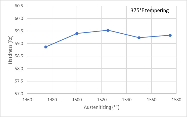

Austenitizing = 15 minute hold at the indicated temperature. Temperatures of 1475, 1500, 1525, 1550, and 1575°F were tested.

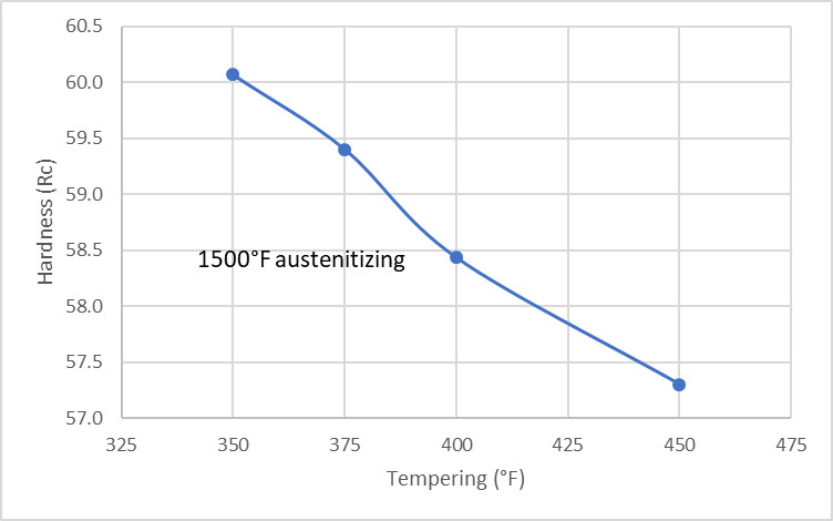

Tempering = 1 hour performed twice (cooled to room temperature between tempers). Temperatures of 350, 375, 400, and 450°F were used.

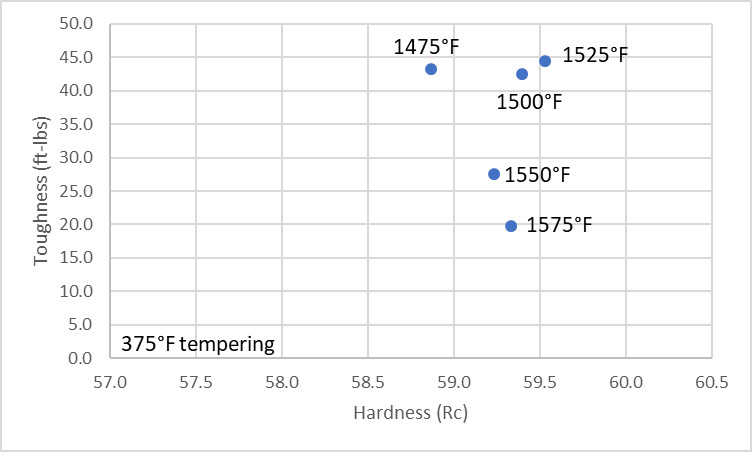

The lowest hardness was measured with the lowest austenitizing temperature (1475°F), as expected. However, hardness was relatively flat from 1500-1575°F, indicating that more carbide was dissolved by increasing from 1475 to 1500°F austenitizing temperature, but that there was not a significant change above that temperature.

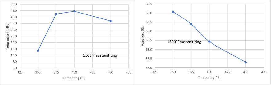

For increasing tempering temperature the hardness was reduced, as expected. Just over 60 Rc was reached with a relatively low tempering temperature of 350°F, and only 57.3 Rc with 450°F.

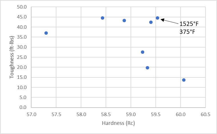

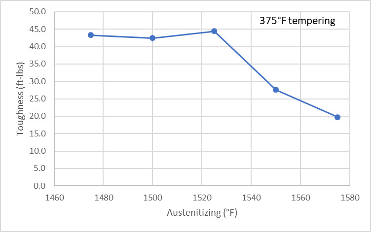

A peak in toughness was reached with an austenitizing temperature of 1525°F, though the toughness is relatively flat between 1475-1525°F. The toughness drops above 1525°F, either because of excess carbon in solution or because of grain growth. Because the hardness was flat above 1500°F, grain growth is more likely. 1525°F is the recommended temperature of heat treatment in the ASM Heat Treater’s Guide.

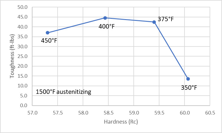

With tempering there was a peak in toughness with a temperature of 400°F, with slightly less using a 375°F temper. There is a surprisingly large drop in toughness when reducing the tempering temperature from 375 to 350°F. This large drop is surprising because in testing of CruForgeV and AEB-L we did not see similarly large drops in toughness even when tempering as low as 300°F. There was also a drop in toughness when increasing the tempering temperature from 400 to 450°F, despite the reduction in hardness. The drop in toughness when tempering at 450°F is because of “tempered martensite embrittlement” which is described in this article.
Hardness-Toughness Balance
In terms of tempering, the hardness-toughness balance is highest with 375 or 400°F. Using 350°F led to an increase in hardness of only 0.7 Rc, but the toughness was drastically reduced, so the hardness-toughness balance is much poorer. Increasing the tempering temperature from 400 to 450°F led to a decrease in both hardness and toughness. Therefore tempering above 400 or below 375°F is not recommended.
Increasing the austenitizing temperature between 1475 and 1525°F led to increases in both hardness and toughness, for a peak in the hardness-toughness balance at 1525°F. Austenitizing higher than 1525 led to a small decrease in hardness and a significant reduction in toughness so those austenitizing temperatures are not recommended.
Because of the drops in toughness with low or high tempering temperatures, and the relatively flat hardness with different austenitizing temperatures, 5160 does not appear to be very flexible in terms of its possible property combinations. Austenitizing in the range of 1500-1525°F and tempering in the range of 375-400°F provides the best combination of properties, and adjusting from there provides either a drop in toughness, hardness, or both. Perhaps removing the cryo step would lead to an improvement in toughness along with a corresponding drop in hardness. Otherwise, don’t get too creative in heat treating 5160.

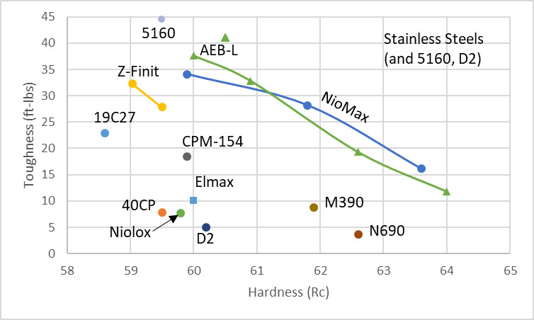

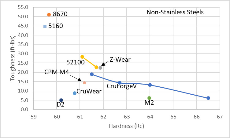

For our optimized heat treatment, 5160 toughness is very high compared to other steels. This is in line with what we would expect based on the very low carbide fraction in heat treated 5160. 5160 was better than any other steel apart from 8670. However, the 8670 steel was heat treated without a cryo treatment so I am not sure if the 8670 has inherently better toughness, perhaps due to its nickel addition, or if higher retained austenite from lack of cryo improved toughness.
5160 has very good toughness with a heat treatment using an austenitizing temperature of 1500-1525°F and tempered at 375-400°F. That results in 58.5-59.5 Rc and very high toughness when heat treated with a cryo step. Skipping cryo may improve toughness slightly with a drop in hardness but this was not tested. The prior processing used in this study (forging temperature, normalizing, and annealing) is recommended to ensure the same results, but the heat treatment may still work with annealed barstock used for stock removal.
