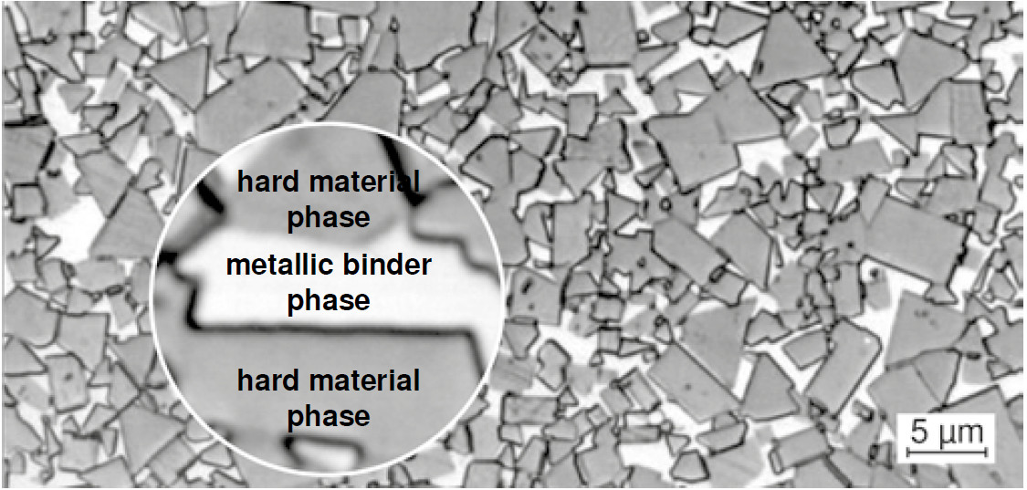

Cemented Carbide
The company Sandrin produces knives out of cemented tungsten carbide. This is a common material for machining due to its high wear resistance, strength, stiffness, and hot hardness (resistance to softening at high temperatures and speeds). The material is sometimes called “tungsten carbide” or even just “carbide” as shorthand though it is in fact tungsten carbide plus some amount of cobalt “binder” that holds the carbide together. There are other types of binder and carbide used but cobalt and tungsten carbide is the most common and is also what Sandrin uses so I will not distract you with more details. An example micrograph of the WC-Co (tungsten carbide-cobalt) type is below:
Image from [1]

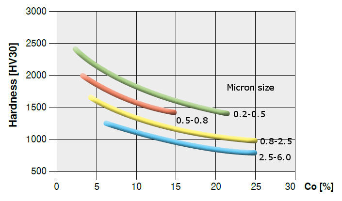

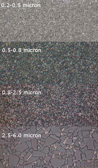

The properties of cemented tungsten carbide are greatly controlled by the amount of binder and the size of the carbide. The tungsten carbide itself is extremely high in hardness (which is why it’s so good at machining other metals) but the cobalt is relatively soft. Therefore the more binder is used the lower the hardness is of the cemented carbide. A finer carbide size for a given amount of binder also means higher hardness.
Image from [1]
Images adapted from [1]

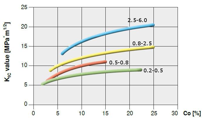

In steels I am used to a finer carbide size meaning better toughness, but with cemented carbide it is the opposite. A coarser carbide size actually means higher toughness, as can be seen in the following figure:
Image from [1]

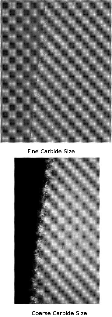

Effect of Carbide Size on Edges
Sandrin compared the sharpened edges of a carbide grade which had a carbide size of greater than 3 microns, vs one which had a size of 0.8-2.0 microns (still greater than the final recommended size). They found that the edge was very irregular with the coarse carbide size which is why they determined a fine carbide size is necessary for knives.
Images from [2]

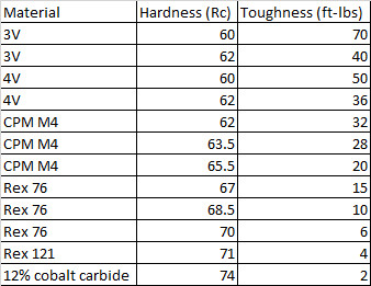

Since no toughness numbers are reported for the Sandrin cemented carbide grade it is challenging to compare toughness to common knife steels. Crucible reported that a 12% binder cemented carbide grade was measured at 2 ft-lbs in their charpy c-notch test [7]. This has a lower cobalt content and higher hardness than the Sandrin grade but may provide some reference point. The toughness may be slightly better for the Sandrin grade, though even 3 ft-lbs may be too high to hope for. A comparison with other knife steels is below [8][9][10][11]:
