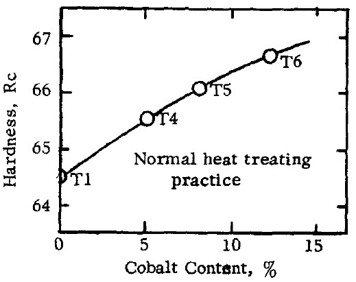

The addition of cobalt to high speed steel was first patented in Germany in 1912 [4]. Cobalt was found to increase hardness after tempering. I previously wrote about the effects of cobalt in this article. Cobalt suppresses recovery of martensite, reduces retained austenite, increases the nucleation density of tempering carbides, and slows the coarsening of those carbides. Therefore increases in cobalt content generally lead to increased hardness in high speed steels, such as with these “T” series high speed steels with approximately the same composition other than cobalt:
Image from [5]

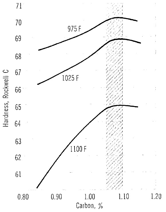

And here is an example of the process for finding the optimal carbon content, in this case M42. With too much carbon the retained austenite reaches levels that are too high to eliminate with multiple tempering cycles.
Image from [16]

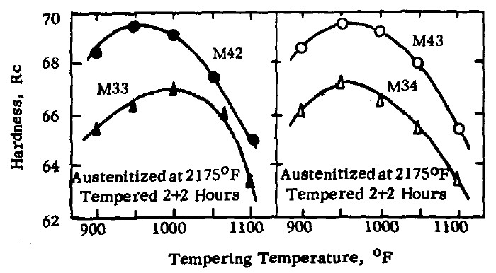

These steels were dubbed “Super Hard” [5] or “Ultra Hard” [14] High Speed Steels, though eventually they were generally lumped into the “Super High Speed Steel” category along with M4 and T15. However, these steels generally did not have wear resistance as high as M4 and T15. Therefore, the selection between “super hard” and “super” was whether higher hardness or higher wear resistance was desired for the cutting operation. The higher hardness is desirable for machining of high hardness materials like high strength steel and titanium alloys, where the greater hardness difference improves performance. And when cutting materials with a higher cutting speed requiring better hot hardness.
Image from [5]
Image from [5]

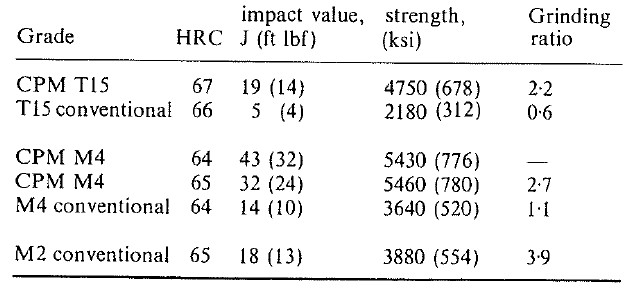

Powder metallurgy technology further increased possibilities for Super Hard High Speed Steels. Powder metallurgy steel was first produced on a commercial scale by Crucible Steel at the end of 1970. You can read more about powder metallurgy and what it does in this article. Early PM high speed steels were simply taking existing compositions and producing PM versions of them, such as M2, M42, and T15. However, the use of PM technology allowed an increase in vanadium content. Vanadium carbides can become very large with conventional steel production which limits grindability and toughness. However, powder metallurgy largely leads to the elimination of this problem. For example, both T15 and M4 were found to have a large improvement in toughness and grindability due to the great reduction in carbide size from powder metallurgy.
Table from [17]
Therefore, super hard high speed steels could be developed with powder metallurgy technology which also utilized increased vanadium content for a combination of both high hardness and high wear resistance. The earliest of these was Crucible Rex 76, the patent of which was filed in 1972 [18]. This steel combined 3% vanadium along with high carbon and cobalt to achieve these properties.

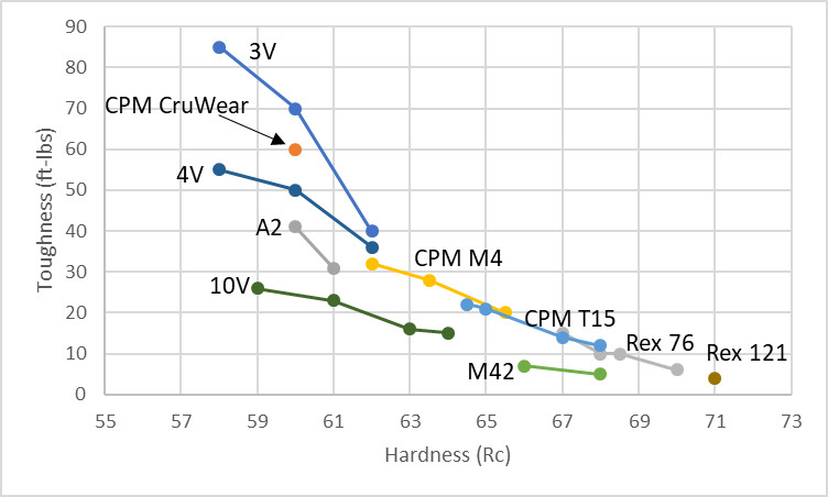

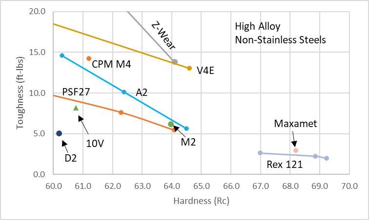

Carbide Replacement High Speed Steel Toughness
In terms of toughness the carbide replacement high speed steels are relatively low. After all, they are designed to be heat treated to at least 67 Rc. If lower hardness is desired, it would be better to use a steel like CPM-M4 or CPM-T15 since they have higher toughness at lower hardness values. Even with a fine microstructure from powder metallurgy, toughness is inherently low in the 68-72 Rc range. You can see what I am talking about by looking at the toughness of Rex 76 and Rex 121 compared with other Crucible steels [23][26-33], or HAP 72 compared with other Hitachi steels [34].
Perhaps we can make some prediction of which carbide replacement steels would have the best toughness by looking at the relative carbide contents are predicted by Thermo-Calc at 2200°F:
Maxamet is predicted to have the lowest carbide content and Rex 121 the highest carbide content so those steels would be expected to have the highest and lowest toughness. Those carbide contents are supported by micrographs I took of both of those steels, where you can see that Rex 121 has both more carbide and larger carbides than Maxamet. You can compare with micrographs of other steels in this article.
Rex 121 Steel (1925°F austenitize) – 32% carbide volume
Maxamet Steel (1975°F austenitize) – 22% carbide volume

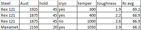

Toughness testing by Knife Steel Nerds used steel heat treated by Warren Krywko and myself, and machined by Alpha Knife Supply and Mike Pierce. These tests showed the expected superior toughness of Maxamet, though the difference is not much to write home about. There is another set of specimens I heat treated of Maxamet using 1900°F austenitizing and 500°F temper and when those are machined and tested I will update this article (hopefully).
The only edge retention value I have for any of these steels is from Maxamet. It did very well in the test as we would expect for a steel with both high hardness and high vanadium content. Each of the following values come from CATRA experiments, and are then normalized relative to 440C at 58-59 Rc which is assigned a base value of 100. So Maxamet with a value of 222 for 68 Rc has approximately 2.2x the edge retention of 440C at 59 Rc if both have the same edge geometry and sharpening.
