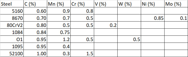

I chose a range of different low alloy steels typically used by forging bladesmiths. I wanted to do different steels to make sure that the process worked with different carbon and alloy content. With each I overheated the steel at 2100°F/1150°C for an hour to simulate forging, normalized at 1550-1700°F for 10 minutes and air cooled. The normalizing temperature varied by steel. This was the condition that I used when heating to nonmagnetic in the forge and quenching in Parks 50. These were all 1/8″ pieces of steel.
Because of the different compositions of these steels the hardness of the normalized steel varied though I was able to cut all of them with a bandsaw and drill a small hole. A very high hardenability steel like L6 or thinner steel like 1/16″ may air harden enough where bandsaw cutting or drilling may be difficult.

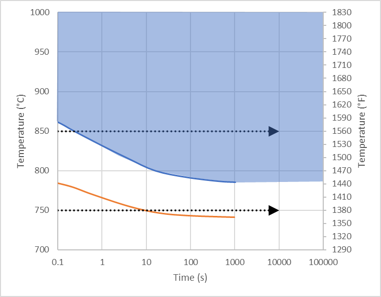

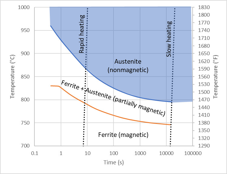

Magnetism and Heating Rate
The steel becomes nonmagnetic when it has transformed to austenite, a nonmagnetic phase of steel. There are certain steels, notably austenitic stainless steels, which are designed to be austenite at room temperature and are therefore nonmagnetic at room temperature. These are not used for knives but I am giving an example for better understanding of magnetic/nonmagnetic behavior. Fortunately for us with normalized pearlitic steel, it becomes nonmagnetic when the pearlite has been replaced with austenite and is ready for quenching. With annealed steel it will also become nonmagnetic when it has transformed to austenite, but the higher required temperature is to get more carbide to dissolve and to put more carbon and alloy in solution by dissolving those carbides. With the pearlite starting condition there is enough carbon in solution immediately after the pearlite has been replaced with austenite (see the previous chart of 52100 hardness vs time for pearlite and spheroidized carbide).
Different steels will transform to austenite at somewhat different temperatures but we don’t have to worry about that because we are checking with a magnet; when the steel has transformed we see that with the magnet. Another potential concern is that the transformation temperature can change based on how rapidly the steel is heated. Faster heating means the transformation is delayed to a somewhat higher temperature. Steel can heat relatively rapidly in a forge so the transformation may be shifted up a few degrees. However, we are checking with a magnet so once the steel has transformed we quench from there regardless of the temperature where that has actually happened. (Note: The dissolution of all of the carbide/cementite is not shown on the diagram.)
52100 transformation temperatures with continuous heating at different rates. Adapted from [2].
However, while with continuous heating the transformation is shifted up, if the steel is held at that temperature for a period of time the transformation will occur at a lower temperature. Therefore if the relatively fast heating of a forge leads to an increased temperature of transformation, attempting to hold the steel at that temperature may lead to the steel being overheated.
52100 transformation temperatures with holding at a constant temperature. Adapted from [2].

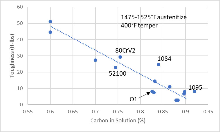

Carbon in Solution

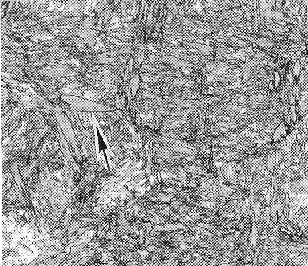

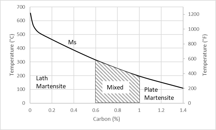

However, grain growth is not the only danger of overheating. When too much carbide is dissolved putting excess carbon in solution toughness is reduced. Above about 0.6% carbon in solution the type of martensite starts to transition from “lath” to “plate” martensite. Plate martensite is brittle and prone to microcracks. A 1% carbon steel does not necessarily have 1% carbon in solution. The steel is generally austenitized at such a temperature where some carbon remains in carbides.
The arrow points to plate martensite within a matrix of primarily lath martensite [3]
Image from [4]
I also compared the toughness of low alloy knife steels in this article where I also used calculated carbon in solution to compare them. The trend was pretty convincing, showing how important this factor is for knife steel toughness, particularly in low alloy knife steel where carbon in solution is not as easily controlled as in high alloy steels.

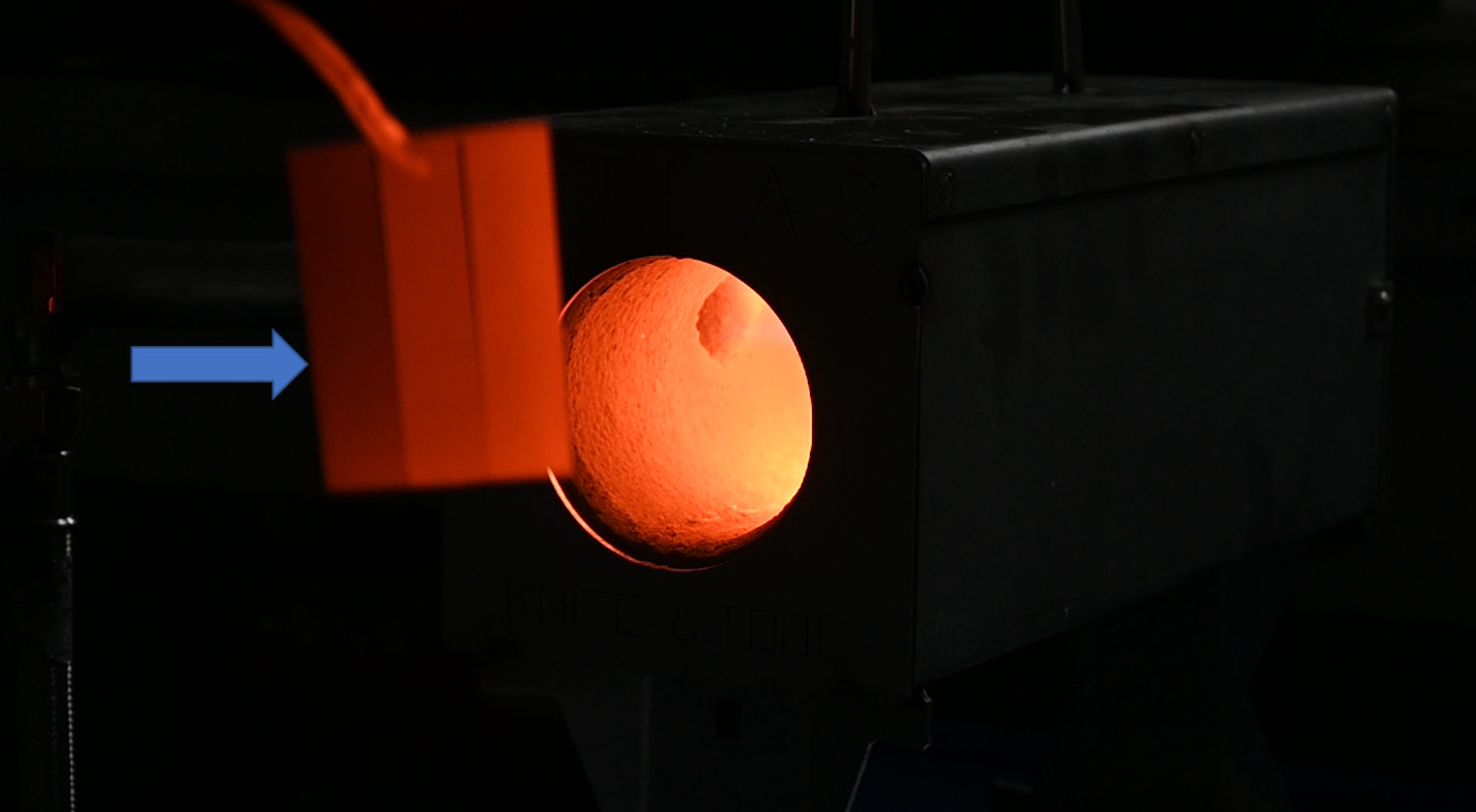

So I heat treated these steels in an Atlas Forge with the propane set to very low pressure. This is still at relatively high temperature, approximately 2000°F/1095°C. I heated them up to a consistent temperature the best I could while occasionally checking with a magnet. When the steel was nonmagnetic I quenched in Parks 50. The samples were then tempered twice for 2 hours at 400°F/205°C. I tested the samples for hardness and also toughness using my standard unnotched subsize charpy specimens.

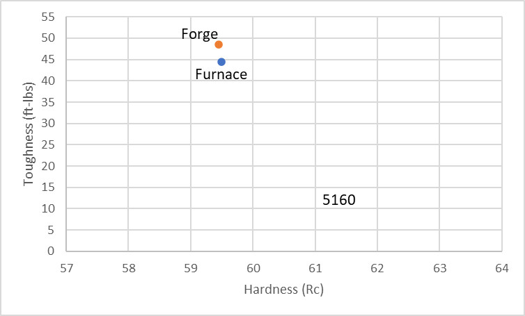

5160 and 8670
These steels are the lowest in carbon that I tested with these experiments. These steels are also among the highest toughness that I have tested, see the chart below for low alloy knife steels. I have separate articles about the heat treatment of these two steels:
How to Heat Treat 5160
How to Heat Treat 8670
In my forge heat treatments of 5160 and 8670 I measured similar hardness and toughness to the furnace heat treated specimens:
This indicates that the steel was both sufficiently heated (similar hardness to the furnace heat treated specimens) but not overheated (similar toughness). In furnace heat treatments of 5160 we found that when using temperatures of 1550°F or above the toughness was significantly reduced from grain growth. This gives a relatively wide window when forge heat treating between nonmagnetic and excessive grain growth when using normalized steel, as it becomes nonmagnetic at least 100°F below that point.

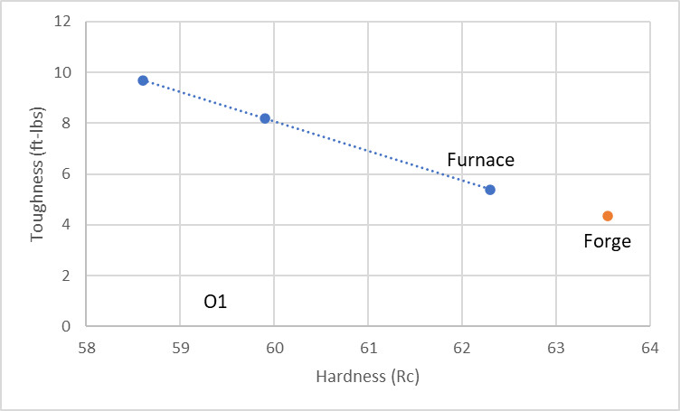

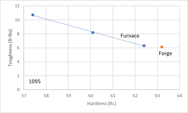

O1 and 1095
With the relatively low carbon content of 5160 and 8670, excessive carbon in solution is not as much of a potential problem with overheating. Instead we are primarily concerned about grain growth. However, with high carbon steel the effect of carbon in solution is much more significant. This is why the toughness of O1 and 1095 is so much lower than 5160/8670 in the low alloy steel toughness chart. Sometimes using reduced austenitizing temperatures with high carbon steels can result in improved toughness because of the reduction in carbon in solution (less carbide dissolved). See below where austenitizing O1 at 1475 and especially 1425°F resulted in superior toughness when compared with 1550°F even after compensating for hardness.
This was also an important topic when comparing the toughness of low alloy steels with a heat treatment for bainite, as bainite does not have the carbon in solution problem that plate martensite has. This resulted in higher toughness for O1 and 1095 with austempering treatments for bainite because of the elimination of plate martensite.
1475°F is the typical temperature recommended for furnace heat treating in these steels, so this is the comparison I made with the forge heat treated specimens. In this case the hardness was somewhat higher for my forge heat treated coupons but the hardness-toughness balance was similar to the 1475°F furnace heat treated coupons. So this is a good result I think.

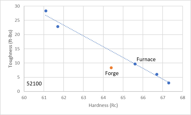

52100
With 52100 the furnace heat treated coupons have significantly better toughness than furnace heat treated O1 and 1095. The chromium addition reduces the carbon in solution for a given austenitizing temperature and makes controlling the carbon in solution easier. This gives 52100 excellent toughness and wear resistance when compared with other high carbon low alloy steels. However, this is for furnace heat treating from a spheroidized annealed condition. When heat treating from pearlite you do not have the same control over the carbon in solution and the resulting as-quenched hardness, as shown below.
Chart adapted from [1]
However, 52100 would be the most difficult to heat treat in a forge from the spheroidized annealed condition because of how sluggish the dissolution of carbide is. And even if that was effectively done it would be difficult to target specific temperatures as with a furnace. So like with 1095 and O1 you are limited to relatively high hardness. You could temper higher than 400°F but then you would run into the issue of tempered martensite embrittlement where hardness is reduced but toughness also goes down. This was seen when heat treating 52100 with a 450°F tempering temperature, see this article on heat treating 52100 for more.
The toughness of the 52100 forge heat treated specimens was still good, with higher toughness than O1 and 1095. However, the toughness was somewhat worse than other high hardness furnace heat treated 52100. This may be because of greater carbon in solution from the pearlite starting microstructure. The other high hardness coupons from furnace heat treating used lower tempering temperatures (300°F/150°C) in combination with lower carbon in solution. However, as I said the properties are still reasonable and would do well for thin, high performance knives.

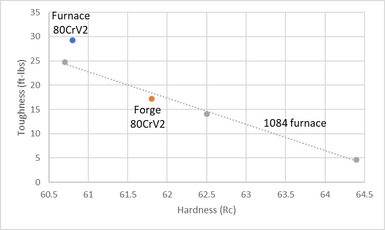

80CrV2 and 1084
I saved these two steels for last because they are in between the medium carbon (5160/8670) and high carbon (1095/O1/52100) categories described above. They therefore have behavior that is basically in between those two categories. 1084 is known as being very easy to heat treat in a forge because of its low alloy content and good hardenability (doesn’t have to be quenched as fast as 1095). Using a pearlite starting structure in all of the steels I have heat treated does somewhat remove the advantage 1084 has from the low alloy content, however, as all of these steels hardened from nonmagnetic just fine. Ironically, 1084 gave me the most trouble in heat treating because two of the coupons had lower toughness than the third. This was because I was having trouble heating the piece evenly and had a hot spot on one side of the steel, as shown in the image below, which is from video footage of me heat treating the specimens:
So to get the entire piece to reach nonmagnetic I ended up overheating those two hotter specimens resulting in grain growth and reduced toughness. This was also visible in the fracture grain of the specimens, though it was not as bad as you might think based on the reduction in toughness (remember these are only 10 mm wide):
This overheated treatment of 1084 would still result in an acceptable knife; there are many steel-heat treatment combinations used in common knives with lower toughness. However, we would of course prefer an optimized heat treatment rather a subpar one.
For 80CrV2 the toughness was somewhat lower than the furnace heat treated specimen. However, the hardness was also higher. So to have some idea of how it compared I overlaid the toughness of the furnace heat treated 1084 coupons since I don’t have a trend for 80CrV2. When viewed against the furnace heat treated 1084 the hardness-toughness-balance of the forge heat treated 80CrV2 looks pretty good.

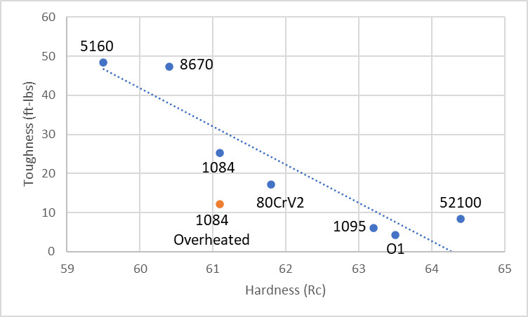

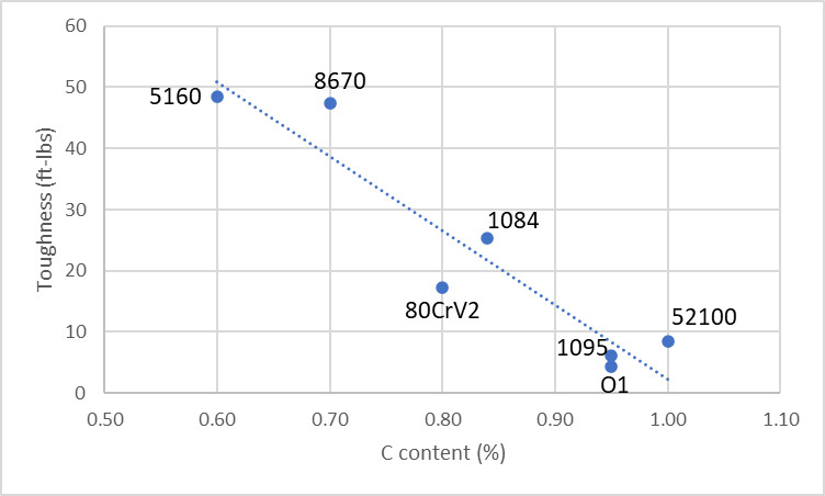

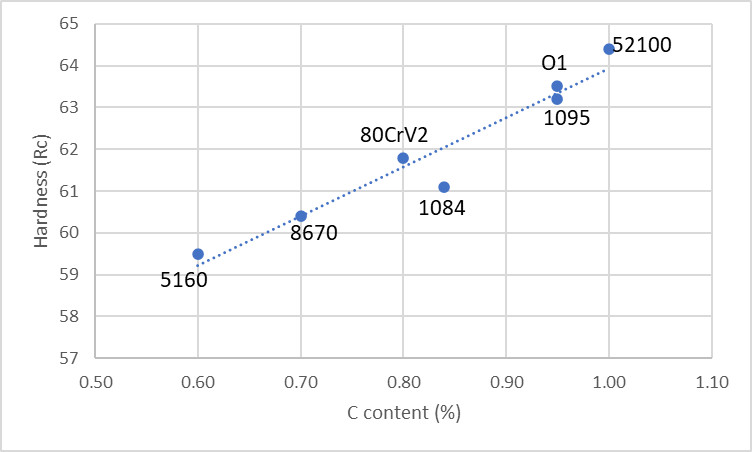

Overall Trends
Because I heat treated from a pearlite microstructure rather than spheroidized annealed, and all of them were tempered at 400°F, the resulting hardness and toughness was primarily controlled by the carbon content of the steel, as shown below:
And then if we plot the hardness vs toughness balance you can better see where the different steels ended up in their overall properties:
So 5160 and 8670 would be best for knives requiring high toughness like heavy choppers. The medium carbon content gives them good hardness (58-60 Rc with a 400°F temper) without having significant issues with high carbon in solution and plate martensite.
1095, O1, and 52100 would be best for fine cutting knives like kitchen knives. Though 52100 did have better hardness and toughness than 1095 and O1 so it would be my choice. And 52100 has better edge retention than either of those steels.
1084 and 80CrV2 would be best for general purpose knives. Their medium-high carbon content gives them somewhat more hardness/strength and edge retention while still having very good toughness.

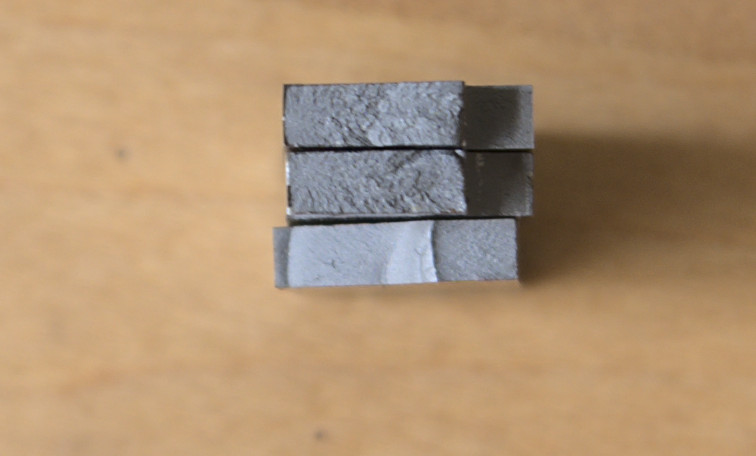

      I used to think it would be difficult to cycle grain smaller than what comes in a file (these are 50x optical).
      The first is a file (sorry for the blur, they didn’t all break into neat flat surfaces):
      https://i.imgur.com/CgnLghi.jpg (it almost looks as if they’re untempered, and they break like it.
      Next, 1095 taken above and below magnetic three cycles (the grain got more coarse than just using flat stock as delivered, but only slightly):
      https://i.imgur.com/XcQqRj2.jpg
      Then, another piece of stock cycled by eye and with a magnet to not quite get to nonmagnetic – cycled four times (same 1095 bar, all other than the file cut from adjacent pieces)
      https://i.imgur.com/fAEI7Xk.jpg
      And then finally, a control piece that was left in the back of the forge more or less a color above magnetic for 10 minutes (as in just a little too hot, but to gather just how bad the grain would be if the 1095 test piece was allowed to get to a low-mid orange in normal interior unlit environment).
      https://i.imgur.com/EDaU2Kx.jpg
      (not nearly as big as some of the grain shown on forged in fire, etc, but it never got more than just a little too hot).
      The thermally cycled piece was heated only quickly to more or less nonmagnetic plus one color (so instead of the dull orange, heated to a step brighter uniformly and then quenched – so as not to have the time for grain growth, but to also not have failed hardening).
      The key in this case is without experimentation (cycling in the forge above magnetic, even only just), the result isn’t as good. Going just short yields finer grain, but it seems like there’s no secret going on – some of the steel is probably transitioning to nonmagnetic but I’m cutting it off before it’s completely nonmagnetic.
      Parks 50 in all cases, including the sub-critical seeming thermal cycling quenches.
