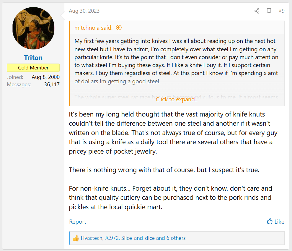

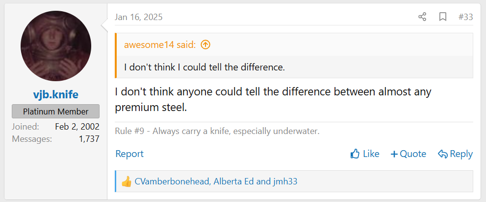

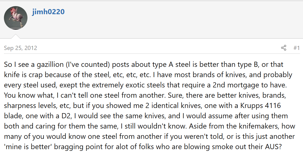

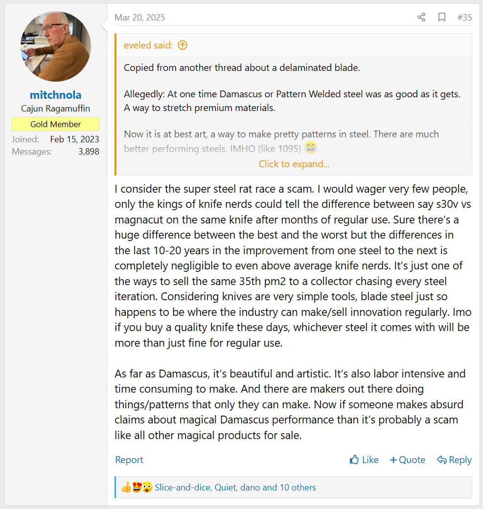

I have seen a common comment on knife forums and on my YouTube videos. It seems to be one of those statements that different people unintentionally copy from someone else. Everyone seems to think they thought of it on their own. It has a lot of variations but boils down to one statement: “People can’t tell the difference between knife steels anyway.”
The reason why the variations matter is because people are making different points when saying it. I believe that these kinds of statements started out as a criticism of certain knife buyers: “You never use your knives so you wouldn’t know what knife steel was even used.”
Another variation is to say that “premium” knife steels are all good and the differences between them are so small that nitpicking about which one is used is unimportant.
But I have seen people take this statement to the extreme and claim that there actually is no real difference between steels at all.

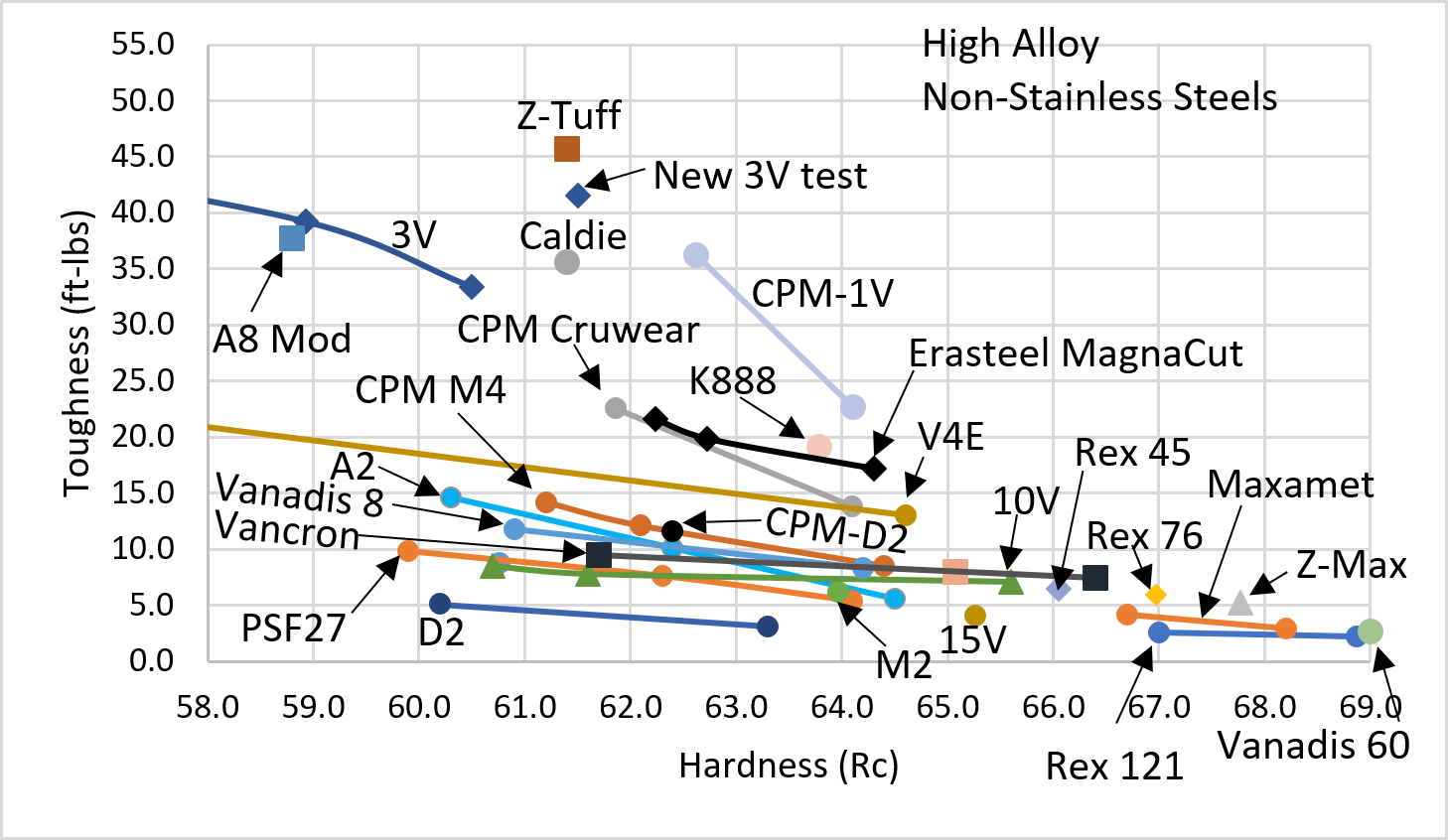

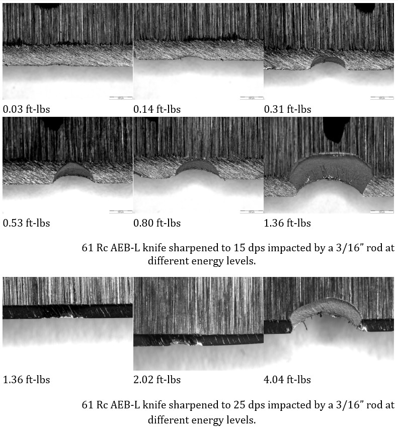

Big chopping knives and axes generally require thicker, more obtuse edges to handle abuse. Below I have images of AEB-L knives that I tested with controlled impacts at 15 dps vs 25 dps. With the 15 dps edge it only took 0.31 ft-lbs to generate a good size chip, and 1.36 ft-lbs to completely blow out the edge. With 25 dps with the same 1.36 ft-lbs there was just a minor ripple.
So just like with edge retention, the edge geometry is going to be most important, before steel type or heat treatment. However, there are real differences in toughness between different steels. Some are more prone to chipping and breaking than others:
I have definitely seen more broken Spyderco knives in high hardness Maxamet and Rex 121 than I have in higher toughness steels. That is the tradeoff. Engineering is all about tradeoffs. If you want the ultimate in wear resistance you will no longer have the ultimate in toughness. Some steels will have a higher wear resistance for a given level of toughness, but there will never be a magic steel that is perfect in every category. This is another of the many reasons why you can’t just say that there is no difference between steels. The right steel should be chosen for the right knife and the right buyer/user.
Toughness is one of those properties where you have enough of it until you didn’t. Either the toughness was sufficient for the task and there was no chipping or breaking, or the knife failed. So there can always be a debate as to whether how much toughness is enough. Because that will change based on the edge geometry and how the knife is being used.
Hardness is less a reflection of steel type than it is of heat treatment, but there are still ranges. Some steels can’t go any higher than 60 Rc or even lower. Some steels like the “super” high speed steels can go all the way up to 70 Rc. Hardness is another of the places where I see people misinterpret steel properties, especially when it comes to relatively soft steel. Knives with soft steel will almost always deform rather than chip. This is sometimes misinterpreted as the steel having high “toughness.” If a knife edge deformed it failed due to insufficient strength, not because it was high in toughness. For example, knifemaker Shawn Houston compared an ESEE in relatively soft 1095 and compared it with a MagnaCut knife with similar edge geometry but higher hardness. In the nail chop test the 1095 failed due to deformation while the MagnaCut did not. This was due to hardness, not toughness.
