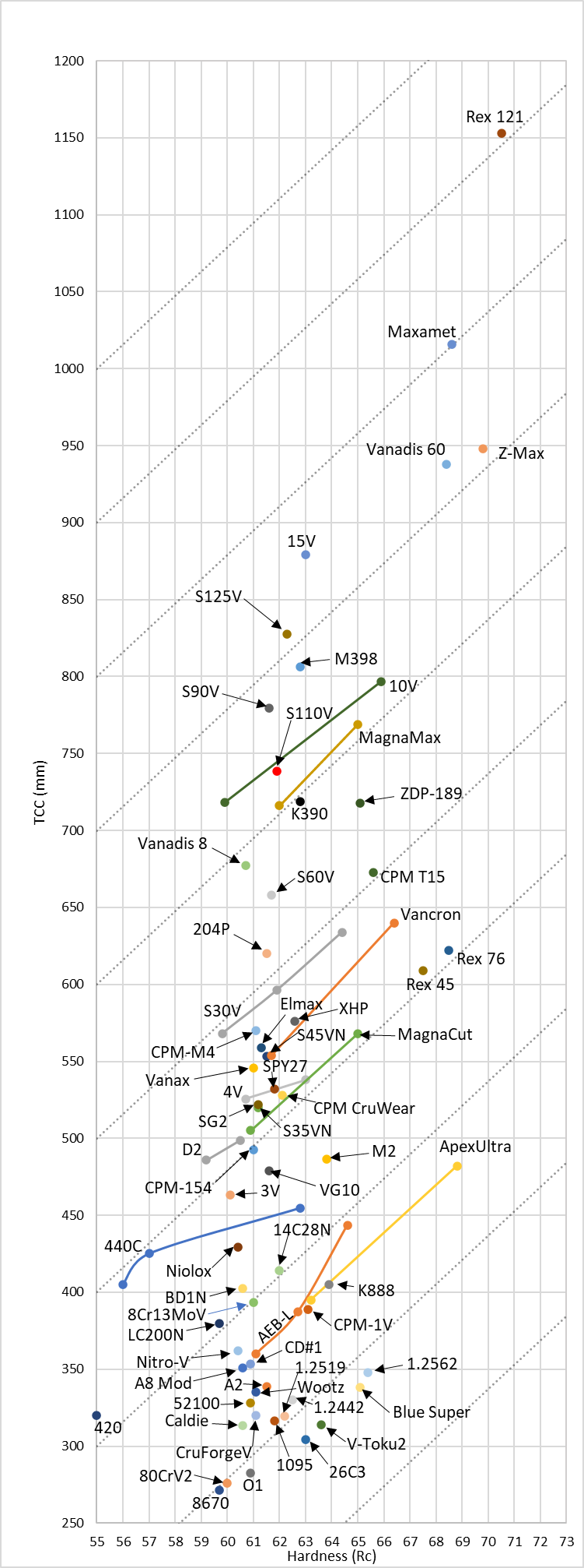

The biggest change from MagnaCut is of course the increase in edge retention. MagnaMax matches the edge retention of K390 and Vanadis 8, as was intended:
This also puts it in the same range as steels like CPM-10V and CPM-S110V. It puts it above several notable steels like M390, ZDP-189, S60V, S30V, and CPM-M4. This is a sizeable increase in edge retention over MagnaCut.

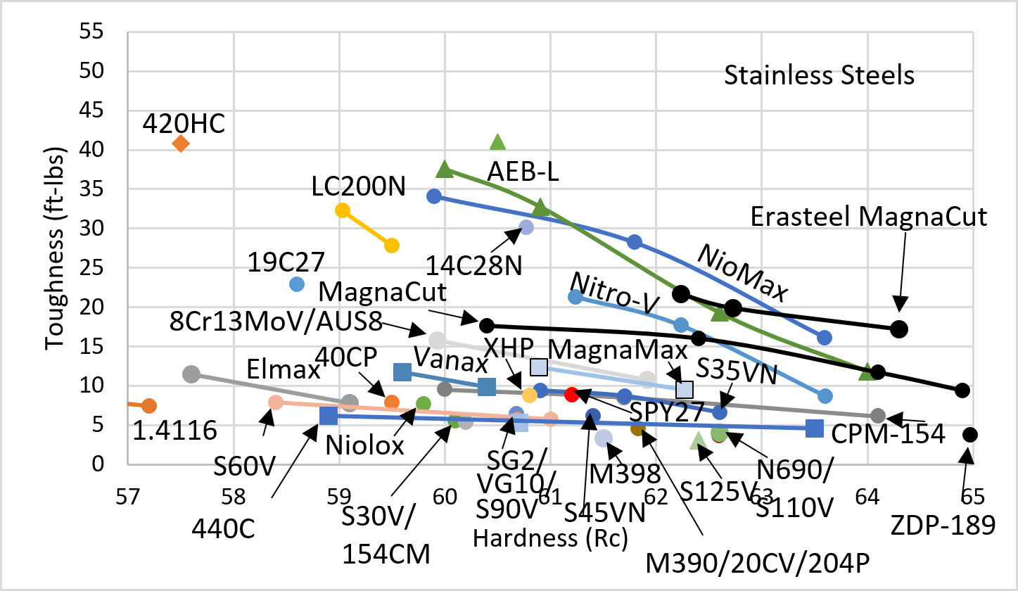

My stainless toughness chart has gotten pretty busy. MagnaMax is just above Vanax, S35VN, CPM-154, and XHP. These four steels were the toughest powder metallurgy stainless steels available prior to MagnaCut. So MagnaMax matching or exceeding the toughness of these grades is exciting. You will notice that MagnaCut is on the chart twice, once as “MagnaCut” and once as “Erasteel MagnaCut.” You can read about the switch to Erasteel for MagnaCut in this article.

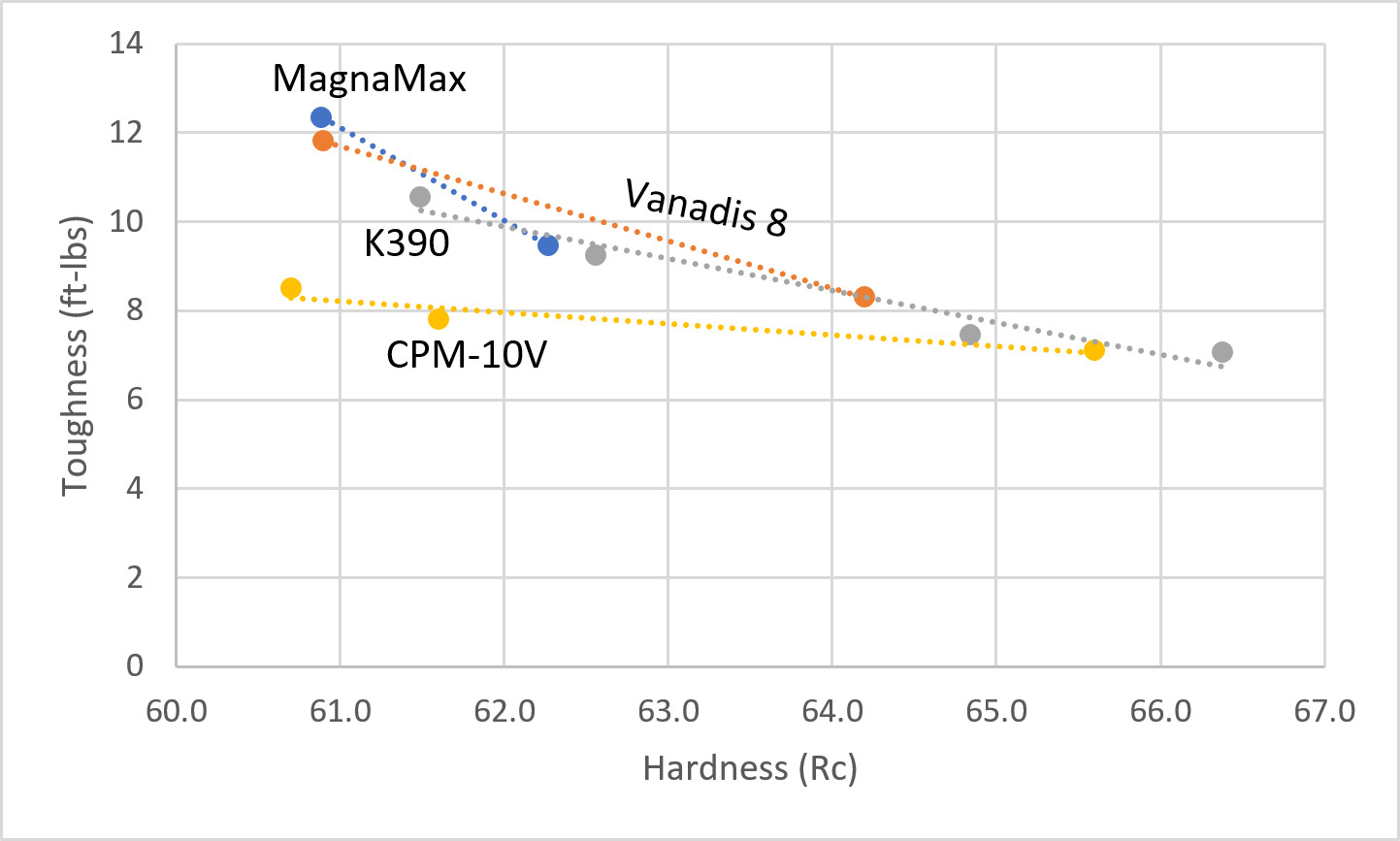

Comparing against its benchmark grades, MagnaMax is the same as Vanadis 8 and K390, a small step above CPM-10V. So even though it is a stainless it still matched the toughness of the non-stainless powder metallurgy steels. So those that have been happy with the toughness of their K390 knives will also be happy with MagnaMax.

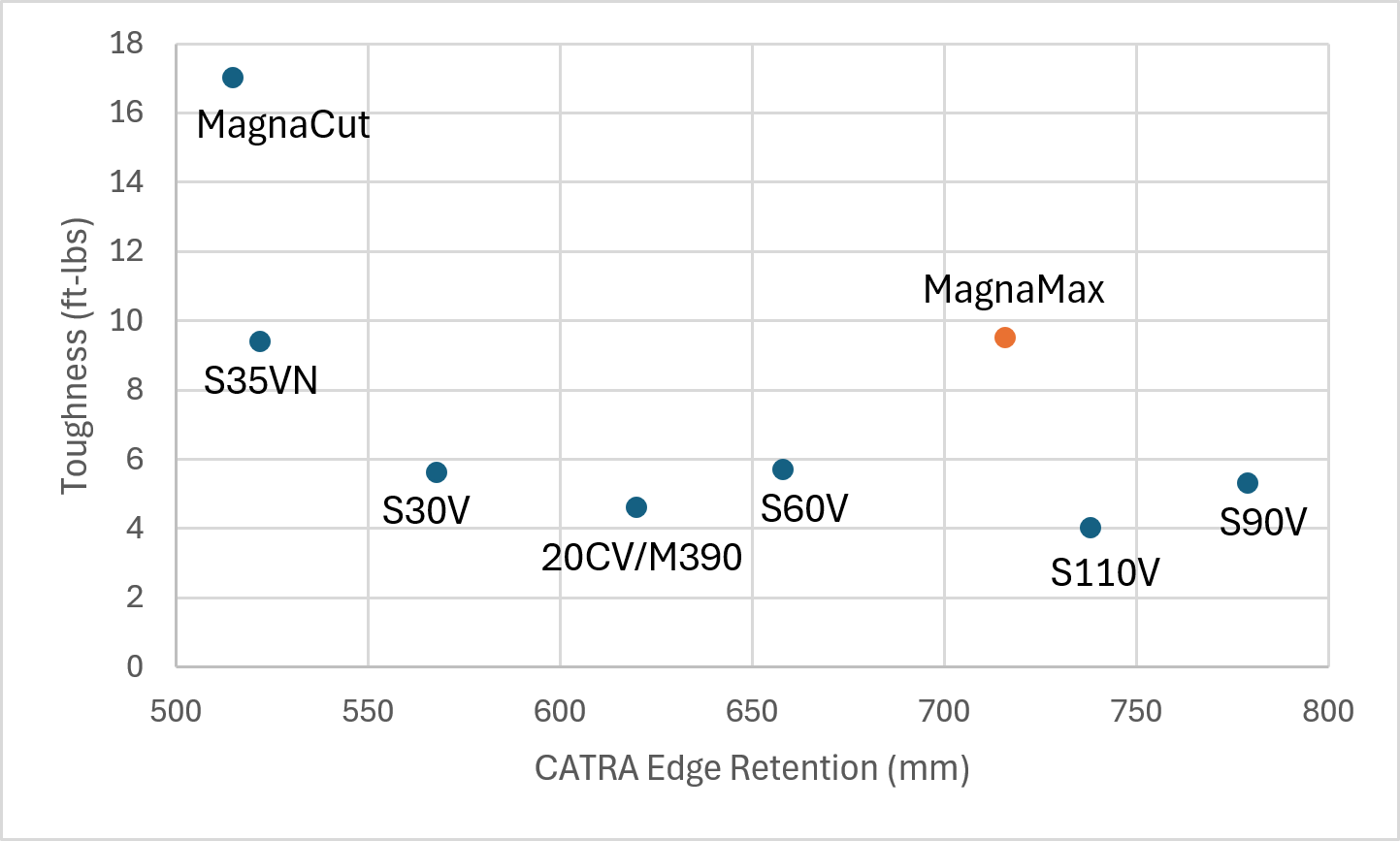

Comparing the edge retention and toughness at the same time, MagnaMax also looks excellent on the chart:
With similar edge retention to S110V but substantially higher toughness, the property balance is much better than previous stainless PM steels. This datapoint is for 62 Rc, it could be a bit higher for edge retention at the cost of some toughness at higher hardness. You will notice that in the past, if you wanted higher edge retention than MagnaCut or S35VN, there was a steep drop off in toughness, and the toughness was relatively flat with higher levels of edge retention from there. MagnaMax has similar toughness to S35VN but with much greater edge retention, also highlighting its well-balanced properties. Comparing with the popular M390, MagnaMax is a significant improvement in both toughness and edge retention. Previously this combination of toughness and edge retention was only available in non-stainless powder metallurgy steels.

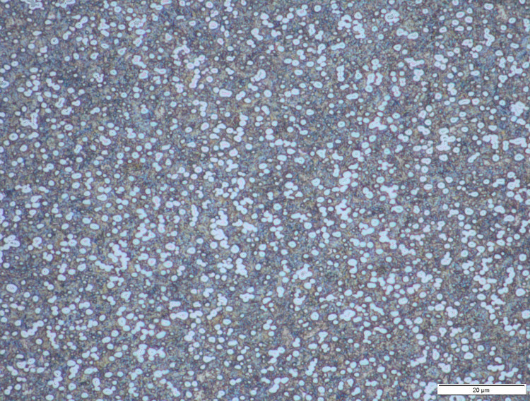

MagnaMax gets those excellent properties by achieving a very fine carbide structure made up of hard vanadium and niobium carbides. It has a similar amount of carbide to K390, with a somewhat finer carbide size:
MagnaMax

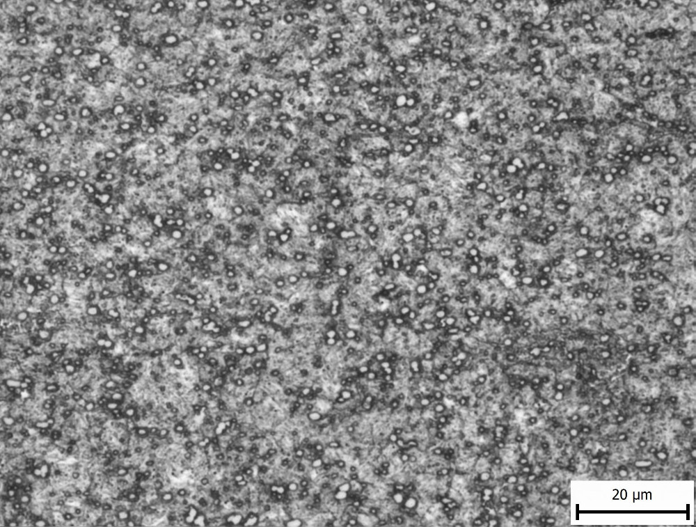

K390

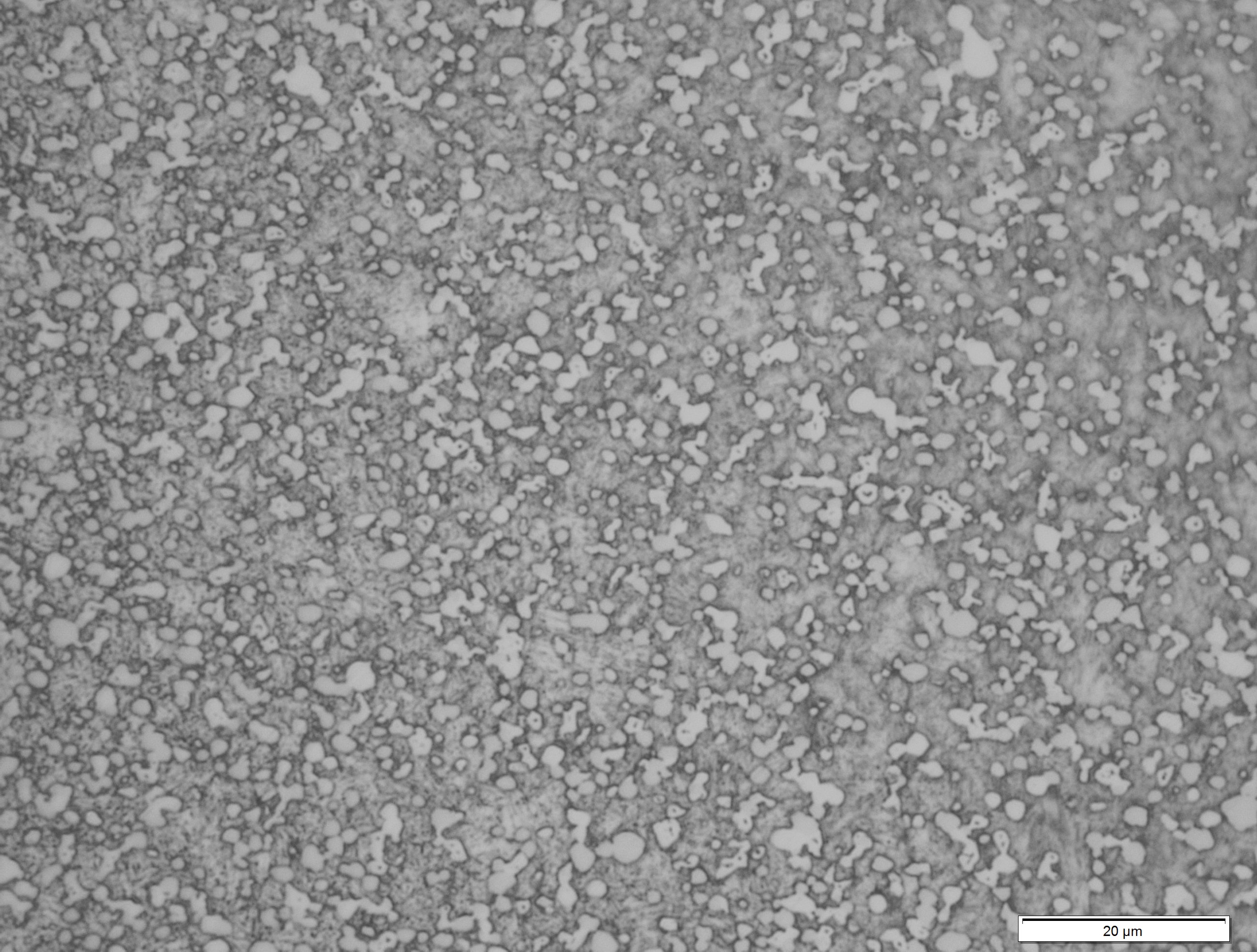

MagnaMax has about 16% carbide volume, which is roughly double MagnaCut. This is why MagnaMax has so much greater wear resistance and slicing edge retention:
MagnaCut

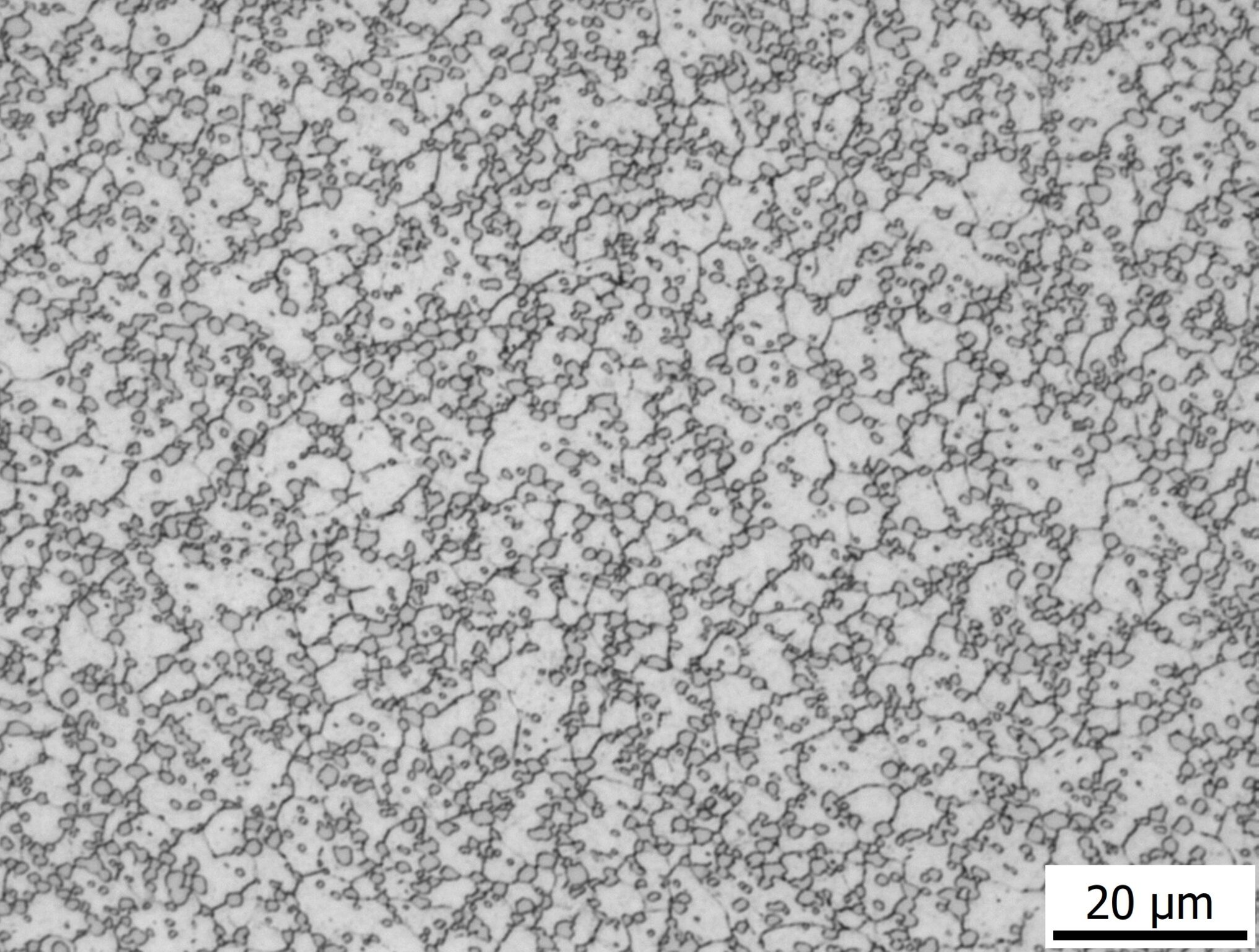

MagnaMax has so much greater toughness than previous high edge retention stainless PM steels because its carbide volume is much lower and the carbides are much smaller. Chromium carbides are relatively large in powder metallurgy steels, so eliminating them from the microstructure gives much better toughness. Notice how big the carbides are in M390:
M390

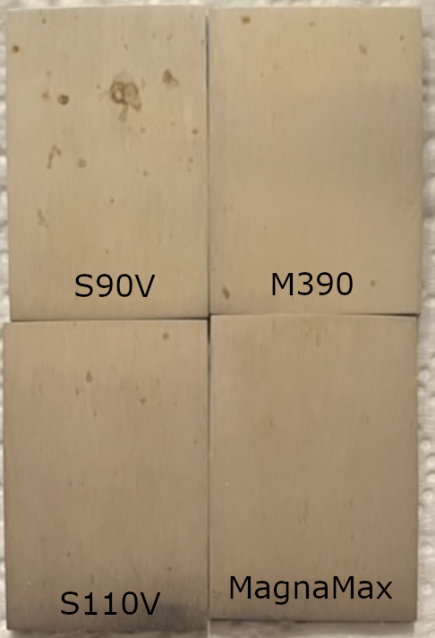

One of the things that made MagnaCut popular was that its corrosion resistance was surprisingly excellent, better than most other stainless knife steels. I compared its corrosion resistance to other high edge retention stainless steels with my standard 1% saltwater test:
M390 and S110V actually have pretty good corrosion resistance, I had previously given both a “9” in my knife steel ratings. So it isn’t surprising that both of those grades had only a few small rust spots in this test. S90V has worse corrosion resistance and had significant rusting. MagnaMax, however, showed no rust spots in this test.

Larrin – for Magnamax and M390, are the lines we’re seeing prior austenite boundaries. Or are they just boundaries if these samples are not tempered?
Why do they remain so visible there if that’s what they are, but not for some of the other steels?
Those are prior austenite grain boundaries. Revealing PAGS with etching is known to be difficult so I’m not sure what made them show up. I have some guesses but none of them correlate with every sample I would expect to see them.
