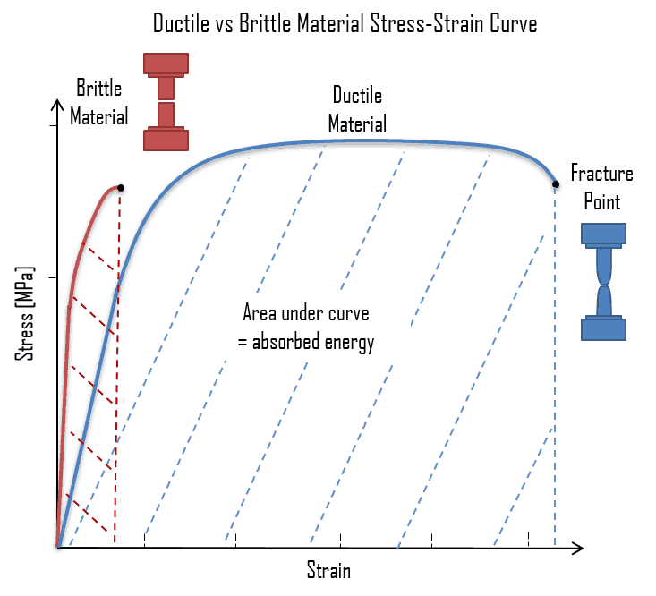

Tensile tests also reveal brittle materials (see below), which shows up with a low ductility result. In fact the majority of knife steels are very high in hardness and contain brittle carbides, so most of them do not have much ductility in a tensile test. Bending tests tend to do better with tool steels because the tested volume is smaller. However, there are certain types of embrittlement that do not show up in a tensile or bending test and are better revealed through impact testing because of the strain rate difference.
Example tensile curves from here

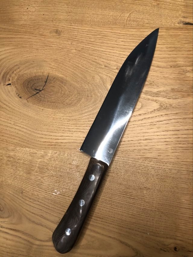

I previously wrote about Richtig in an article about his knives. I also covered his history in The Story of Knife Steel book. Richtig began as a blacksmith apprentice at 19 years old in 1906. In 1908 he and a friend set up their own blacksmithing shop until 1923, when he sold his share. In about 1916, he began experimenting with a heat treating process for knives. In July 1925, he leased a shop and began producing knives. Despite his previous experience as a blacksmith, his knives were made by stock removal. His typical knives had a cast aluminum handle though some rare knives had leather washer handles. He primarily produced kitchen and butcher knives though also produced some fighting knives for soldiers.
A Richtig butcher knife that I own
In the early 1930s, Richtig and his wife began traveling to the state fair to demonstrate the superiority of his knives. They would take old pieces of steel like railroad spikes, axles, or horseshoes, and he would hammer the knife through the steel and then slice through newspaper afterward. In 1936 his knives were featured in Ripley’s Believe It or Not!, which was published in newspapers across the country. Richtig advertised that his knives could pass these tests due to superior heat treating [3] : “We have discovered and developed a special new process in tempering knives. This method of tempering assures you of a better and more lasting quality of cutlery.”

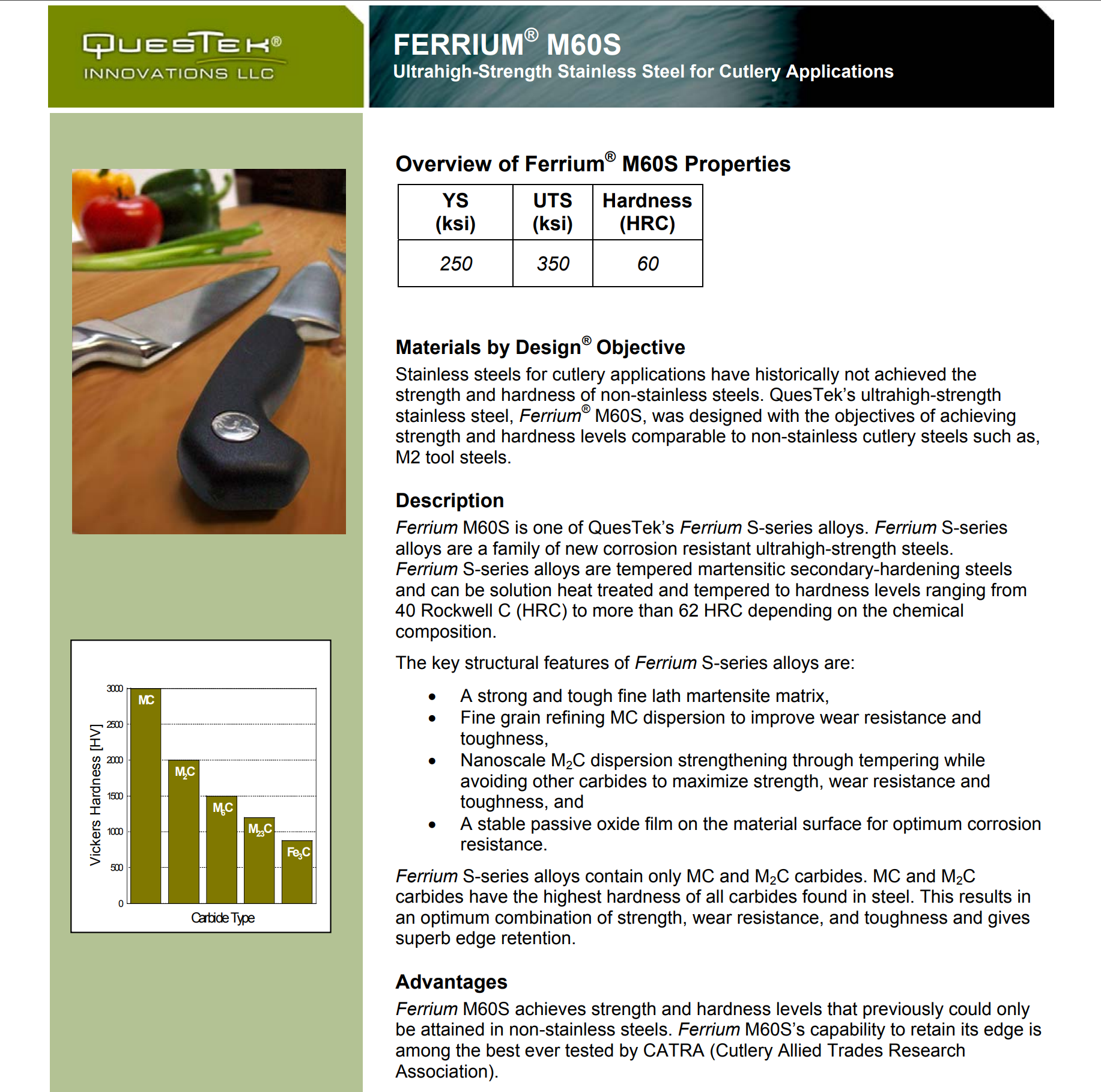

Questek Ferrium M60S Steel
M60S was a brand new steel designed specifically for knives and cutlery that was announced back in 2003. I have written about this steel previously in this article, where I more thoroughly described its history and the design behind it. Here is the first page of the datasheet which advertises what was supposed to make it better:
Questek is a company that designs new materials using “Integrated Computational Materials Engineering” (ICME). In other words, they use computer simulations to design new materials. This sounded especially forward-thinking and advanced in 2003. A new knife steel designed by computer-aided metallurgists? Wow! However, this steel never came to market. I contacted the inventors of this steel about why it didn’t come to market and Professor Greg Olson told me by email: “I recall denting of cutting edges due to early yielding from retained austenite.” I had remembered this result. Knifemaker Jerry Hossom reported edges that deformed easily from a sample of the grade he had been provided, heat treated to 60 HRC [10]. Hossom also reported that a knife in S30V had very little damage [11].

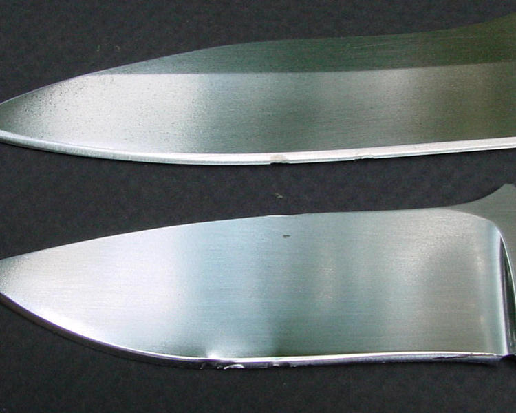

Jerry Hossom test of chopping an 8d nail. 61 HRC 154CM (top) and 60 HRC M60S (bottom).
What led to the easy deformation? It wasn’t hardness, 60 HRC was roughly the same as the 61 HRC of the 154CM blade. The difference was in the yield strength of the material. Typically yield strength and hardness are highly correlated, but there are some cases where they deviate. If you look at the M60S datasheet you will see that it says at 60 HRC the yield strength was 250 ksi and the ultimate strength was 350 ksi. This is a relatively low “yield ratio,” or the ratio of yield strength to ultimate strength, YS/UTS. This means that in terms of yielding behavior, the stress required to deform this steel would be lower than other steels heat treated to 60 HRC. I have seen some people speculate that this lower yield strength comes from the strength of this steel being achieved with carbide precipitation rather than strictly higher carbon martensite. However, when comparing the yield strength of Ferrium-series steels [12] to AerMet-series steels [13-16], a non-stainless precipitation strengthened steel, the Ferrium yield strength is significantly lower (M60S is the orange dot):

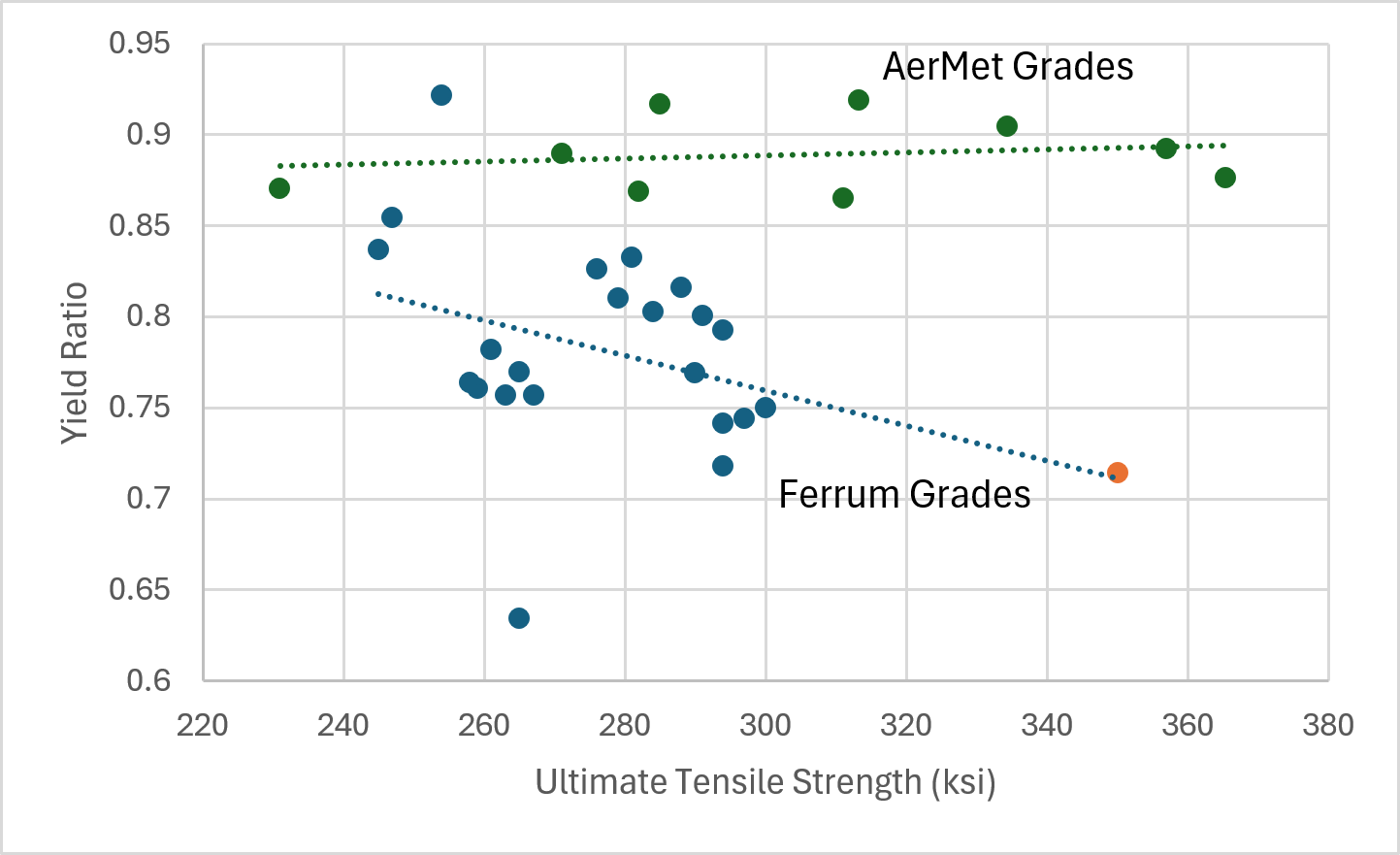

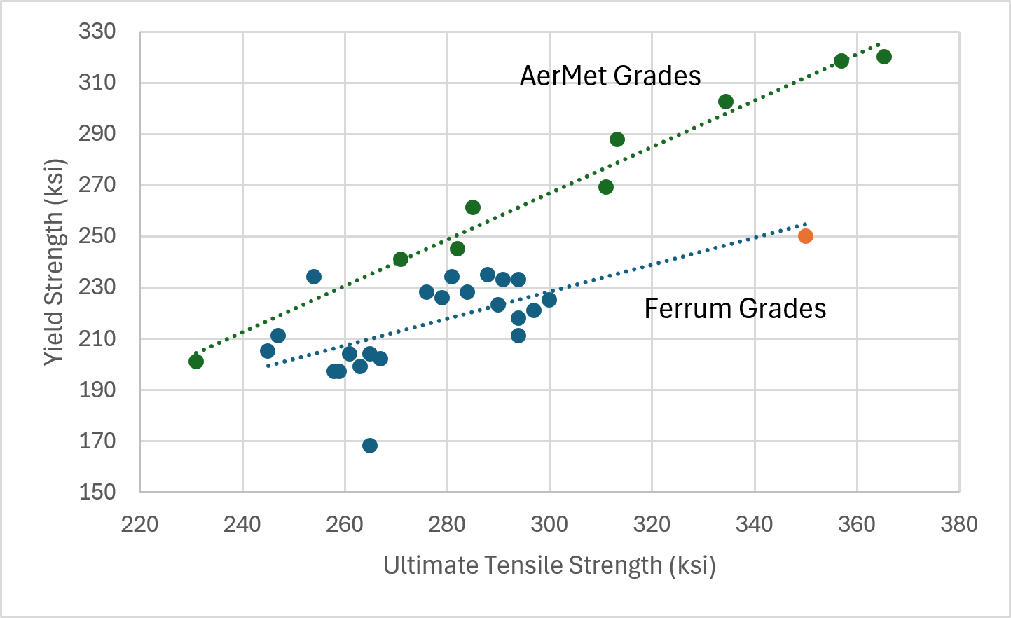

You can see that as the ultimate strength increases, the yield strength of the two sets of materials diverges more and more. This is somewhat clearer if we plot vs yield ratio instead:
You can see that for the AerMet grades the yield ratio was flat with increasing ultimate strength (and hardness), but for the Ferrium grades like M60S the yield ratio decreased. So while a lower hardness/strength Ferrium grade has been commercialized as Ferrium S53, the yield strength issue became more relevant after pushing the hardness up to 60+ HRC for knives. As Professor Olson noted, this was due to excessive retained austenite in the higher strength Ferrium grade M60S. When steel is quenched from high temperature it transforms from the austenite phase to the hard martensite phase. With certain compositions and temperatures, the austenite does not fully convert, leading to “retained” austenite. Retained austenite can lead to reduced yield strength even while at the same hardness:

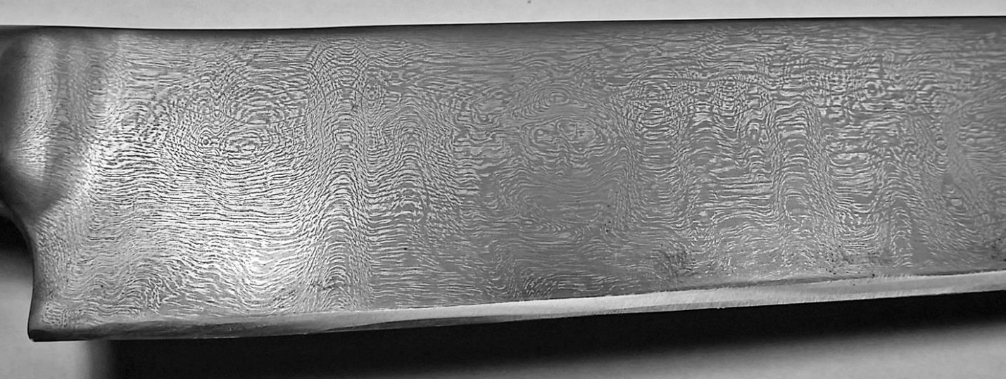

Al Pendray was a bladesmith trying to develop a consistent process for making Wootz. Verhoeven is an emeritus metallurgy professor. Both men reported that they needed the other to solve the question of how Wootz Damascus was made. I won’t recount the entire history here. Verhoeven has a book about the history which I reviewed here. And I also have a chapter about it in The Story of Knife Steel. There are also a couple of videos on YouTube (Video 1 and Video 2). But I will include a couple of my favorite quotes about what the two thought of each other.
Pendray Wootz knife
Verhoeven said about Pendray [19]: “He could have gone to college and gotten a Ph.D. just like that. I never worked with anybody that could learn faster. And he is extremely patient. I think Al is an amazing man. It’s been a pleasure for me to know him.” Verhoeven also reported that Pendray said that it was another famous metallurgist who encouraged him to pursue the mysteries of Wootz [20]: “Al often spoke in a sort of reverent tone of ‘Dr. Cyril Stanley’ and how Dr. Smith had taken him aside at the meeting, encouraged him in his work, saying that it was his opinion that the mystery of how to make these blades would probably be solved by a working smith.”
