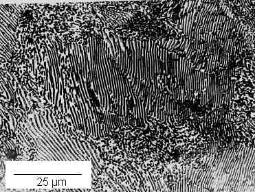

When slow cooling a eutectoid steel it cools directly from the austenite phase to “ferrite + cementite.” Therefore both ferrite and carbide has to form at the same time. This leads to a phase called pearlite which is alternating bands of ferrite and cementite. I wrote about pearlite briefly in this article on 52100. Cementite is iron carbide which is a high hardness phase that contributes to wear resistance.

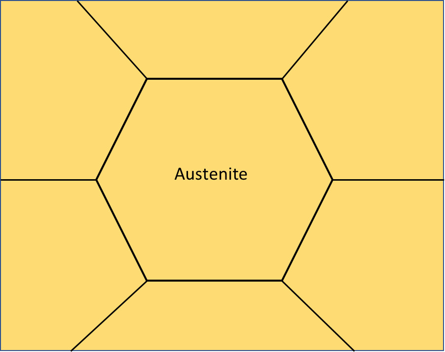

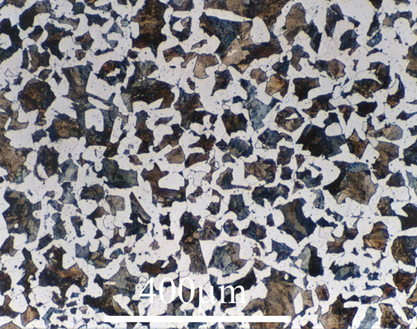

Pearlite forms from the grain boundaries of austenite. Grain boundaries are high energy regions that are preferential for the nucleation of new phases. Therefore when pearlite forms it is highly likely to grow from the grain boundaries:
Those cabbage looking things coming off the grain boundaries are the pearlite, with the black lines representing the cementite and the white regions in between being the ferrite. The pearlite continues to grow until it has replaced the former austenite microstructure:

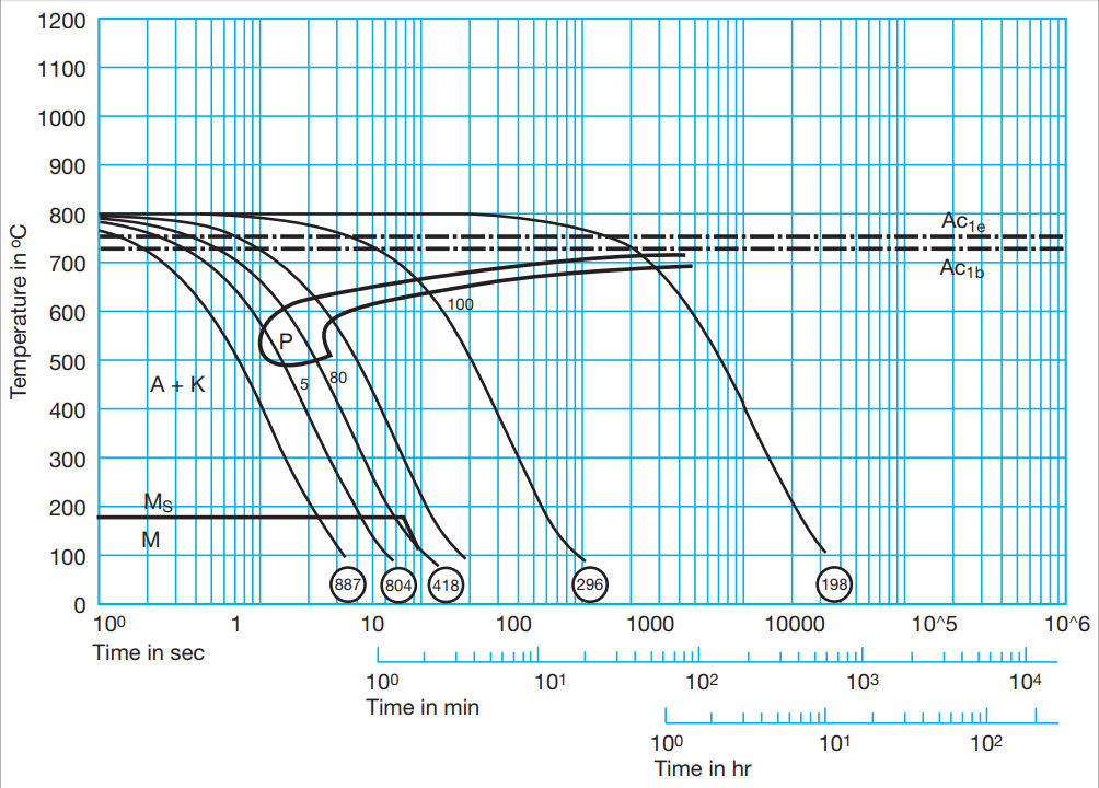

This schematic from [1]
This micrograph from [2]
Ferrite has a very low carbon content (~0.02%), and the cementite has a very high carbon content (6.67%) so during the formation of pearlite carbon has to diffuse over a relatively short distance so that it leaves the growing ferrite and enters the growing cementite:

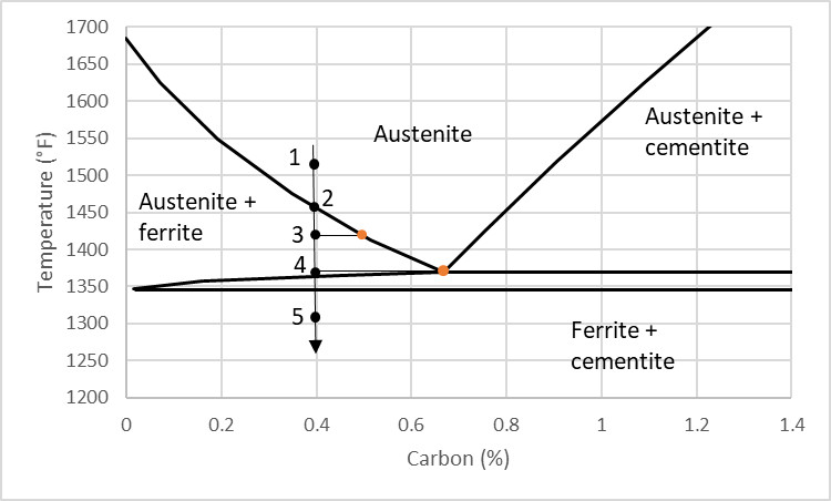

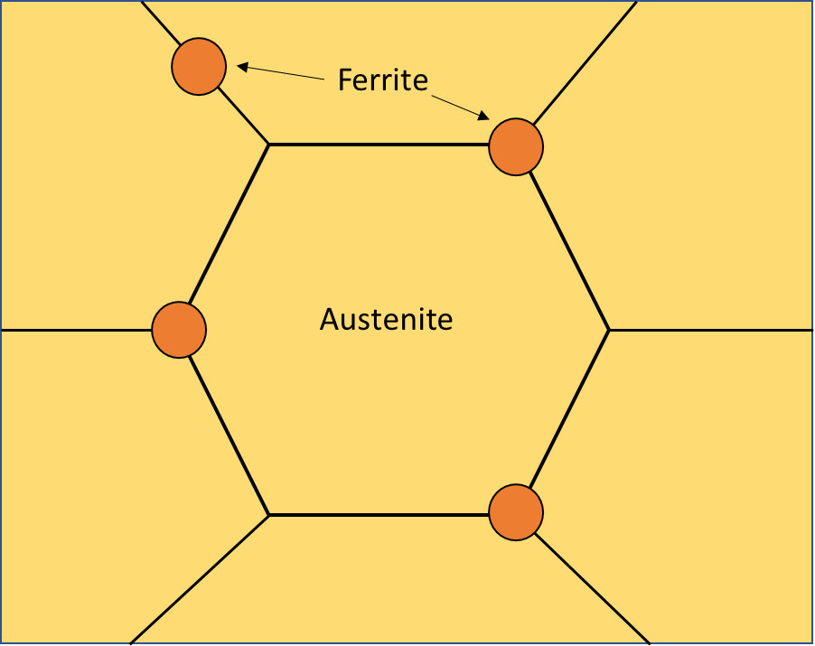

Hypoeutectoid Steel

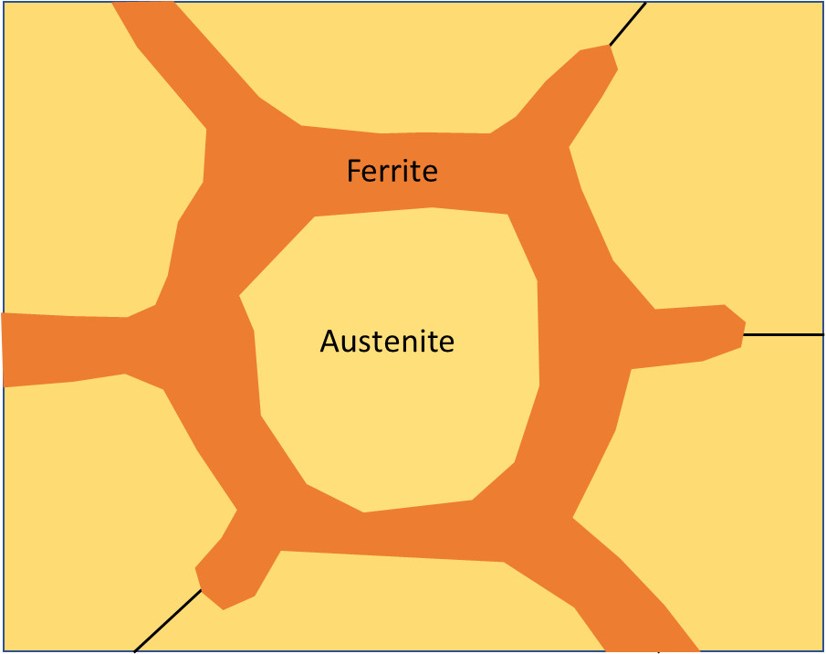

With low carbon hypoetuectoid steel, during cooling the steel passes through the “austenite + ferrite” region:

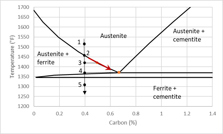

At points 1 and 2, the steel is fully austenite and the carbon content of the austenite is equal to the bulk composition of the steel, in this case 0.4%. As the steel cools it reaches point 3 where ferrite is forming:
Just like with pearlite formation, ferrite contains very little carbon. Therefore, carbon diffuses out of the growing ferrite into the surrounding austenite. The carbon content of the austenite is shown by the orange circles on the phase diagram, following the line down and to the right.
So the ferrite continues to grow and the carbon content of the austenite continues to increase until point four where the carbon content of the austenite has reached the eutectoid. Then with further cooling the austenite undergoes a pearlite transoformation as if it was a eutectoid steel, for a final microstructure of ferrite plus pearlite:

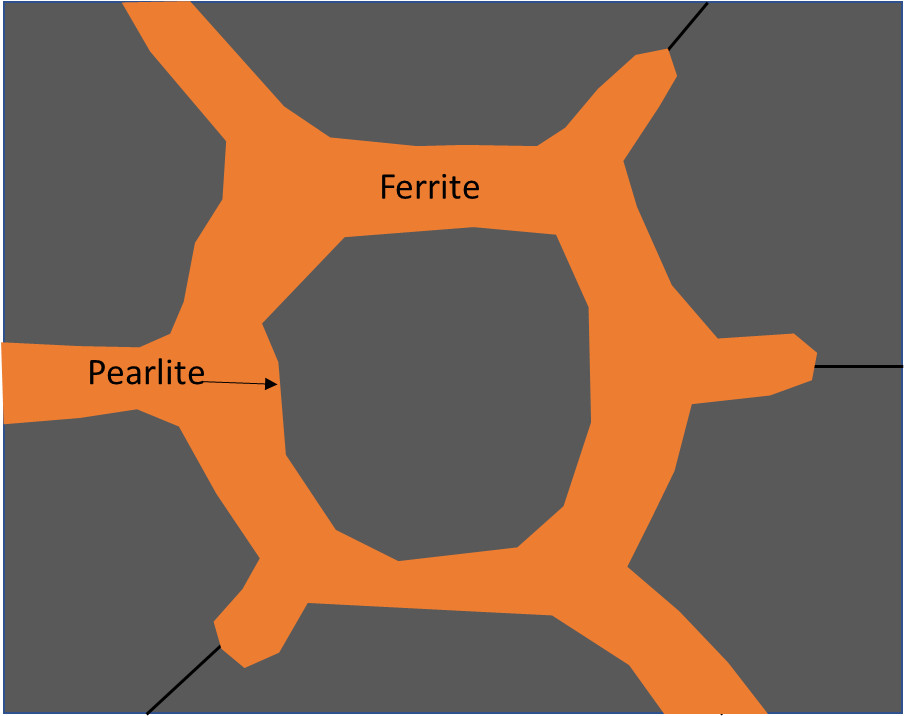

The above schematic diagram showing pearlite as a dark phase is also similar to what it looks like in an optical microscope where the alternating bands of ferrite and cementite are not easily visible. That leads to a micrograph where there is white ferrite and dark pearlite:

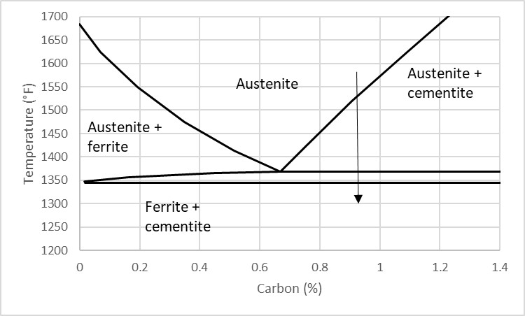

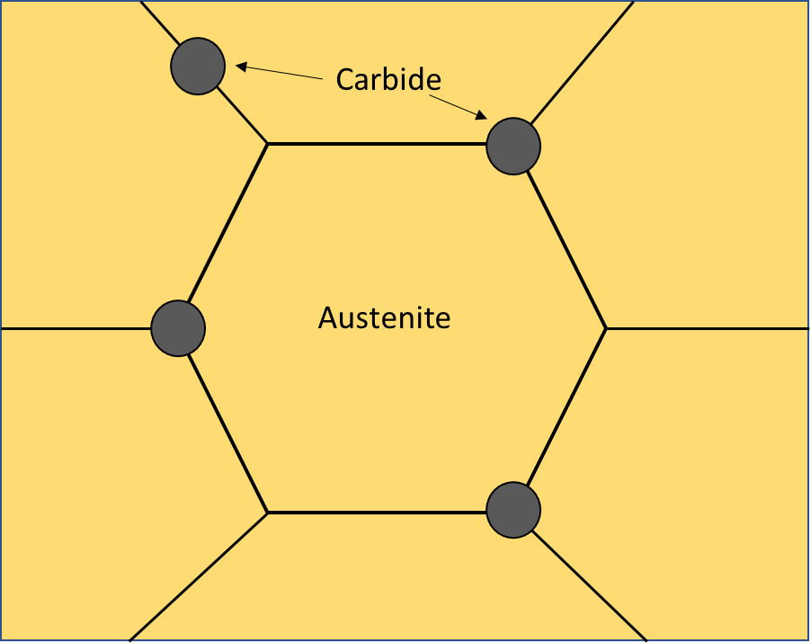

Hypereutectoid steel
High carbon hypereutectoid steel is similar where it is also cooled through a two phase region, though austenite + cementite instead:
Once the steel has passed through the austenite + cementite phase field and carbides have formed, it reaches the eutectoid and the remaining austenite transforms to pearlite just like in a hypoeutectoid steel. Alloying elements affect carbide formation in the same way they affect pearlite formation. Carbide forming elements diffuse into the growing carbides which slows their growth. And vice versa for elements like Si and Al where they are not typically contained in carbides. With low carbon steel forming ferrite and high carbon steel forming carbides, the mechanisms that control hardenability are somewhat different. The majority of the published literature is focused on the hardenability of low carbon steel.

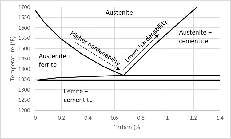

Effect of Carbon Content
Carbon affects hardenability through the change in the temperature where ferrite or carbide forms:
The higher the temperature where ferrite or cementite begins to form during slow cooling, the lower the hardenability is. This is relatively intuitive, as the steel “wants” to transform to the other phase at a higher temperature. And the more the temperature is reduced below that transition the stronger the “driving force” is for the transformation to cementite or ferrite. This leads to a peak in hardenability around the eutectoid composition:

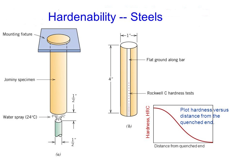

Measuring Hardenability
There are a few different methods for determining the hardenability of steel. One is called a Jominy test where a steel bar is heated to austenite and then sprayed with water on one end. The hardness is measured along the bar to see how slow the steel can be cooled while maintaining high hardness, or how thick a piece can be and still achieve full hardness at the core:
This image from [4]
In the bottom right corner it shows a Jominy plot with hardness vs the distance from the quenched end. Sometimes the Jominy specimen is sectioned and the microstructure is observed, to see if ferrite, carbide, or pearlite is detected.

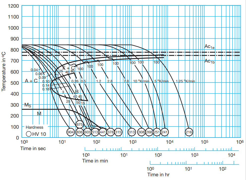

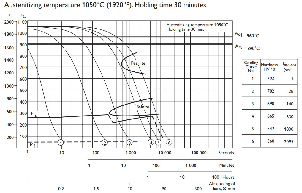

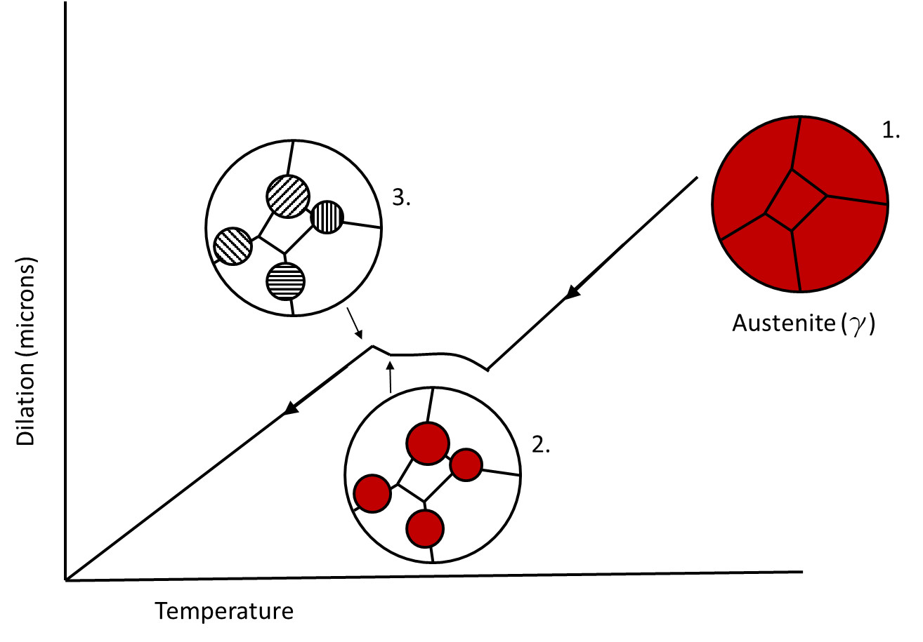

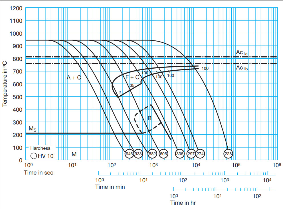

Steel can also be cooled at different rates while measuring the size change of the steel, known as “dilatometry” because it measures the “dilation” of the specimen. Different steel phases, ie ferrite, austenite, pearlite, martensite, etc. have different densities, and therefore size changes can be observed during cooling. If no transformation was observed it would be a straight line. In other words, steel grows when it is heated and shrinks when it is cooled. However, if the steel transforms to a different phase then deviations are observed as the steel cools. Here is an example of a steel cooling slowly to form ferrite and the remaining austenite transforms to pearlite:
The points where the line deviates are the start and end of the different transformations, so those transformation temperatures can be determined with dilatometry. The experiment is repeated at multiple cooling rates and that information can be used to generate a diagram representing the temperatures at which different transformations occur and how fast a steel must be cooled to form martensite instead. These are called “continuous cooling transformation” (CCT) diagrams. Here is an example of one with a 5160-type steel:

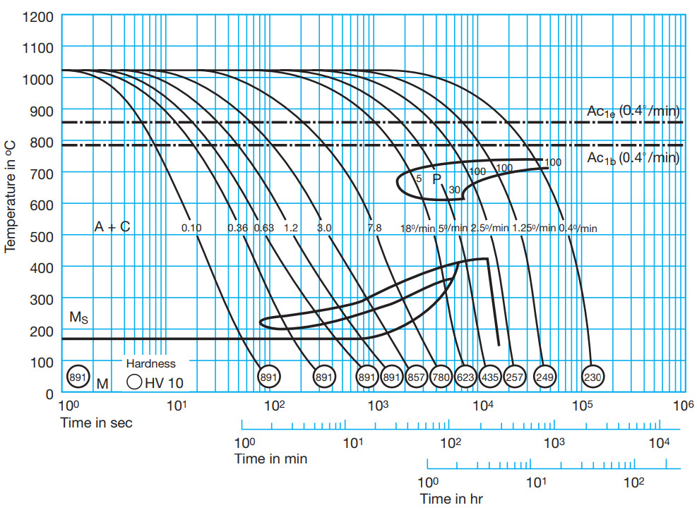

This image from [5]
The diagram above has a range of cooling rates, from 0.04°C/s to 32.7°C/s. The two slowest cooling rates pass through the “P” field which represents pearlite. The three fastest cooling rates do not transform to any phases until they reach the “Ms” line around 230°C which represents martensite. At intermediate rates the steel also passes through the “B” field which represents bainite. You can read more about bainite in this article. At the bottom of each cooling rate there is a final hardness of the steel in Vickers (Hv). Interestingly, the 8.2°C/s cooling rate resulted in 743 Hv, which is lower than the hardness from 32.7°C/s (760 Hv), despite not forming any bainite or pearlite. This difference in hardness is probably due to “autotempering” which can occur when the steel cools sufficiently slowly. The martensite undergoes some tempering during cooling, whereas we normally think of tempering as being a separate step where the steel is reheated.

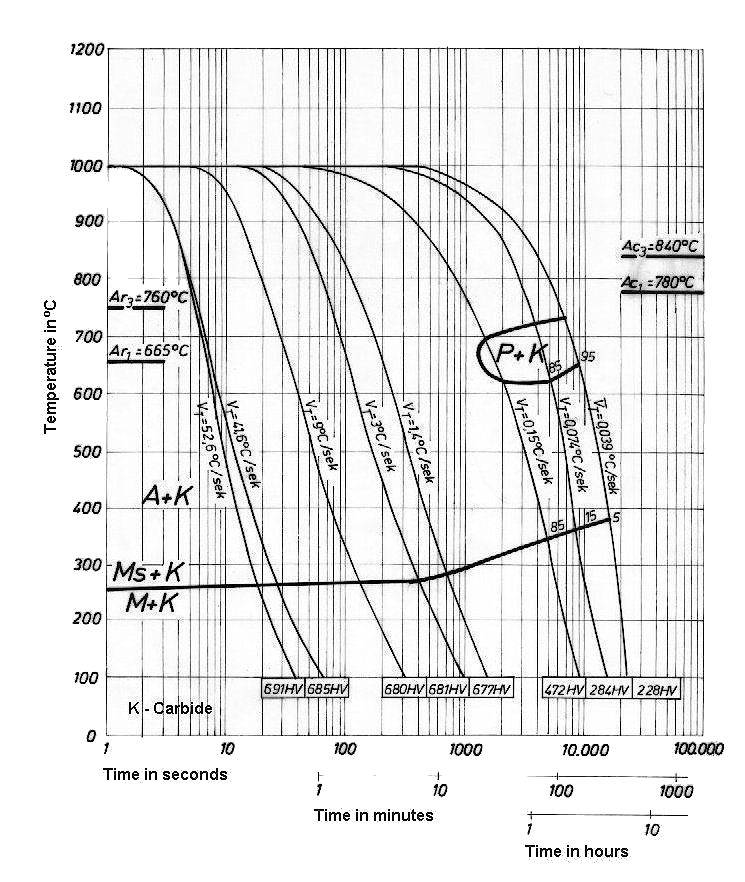

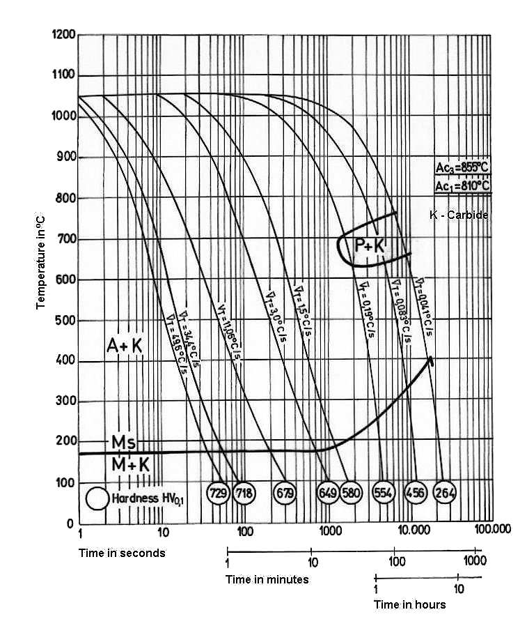

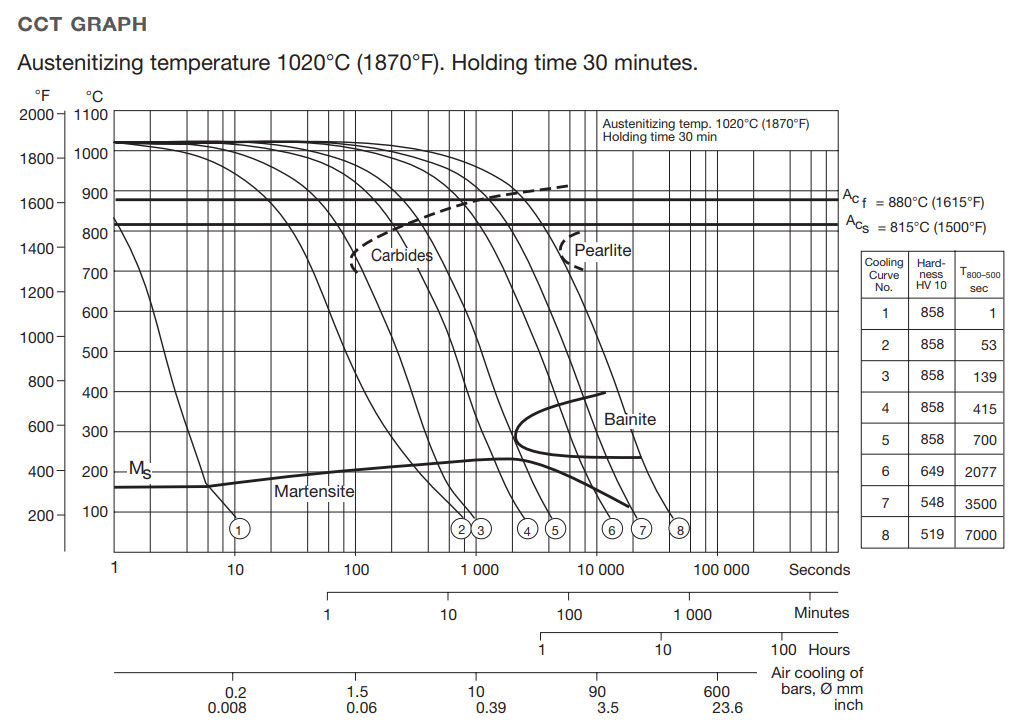

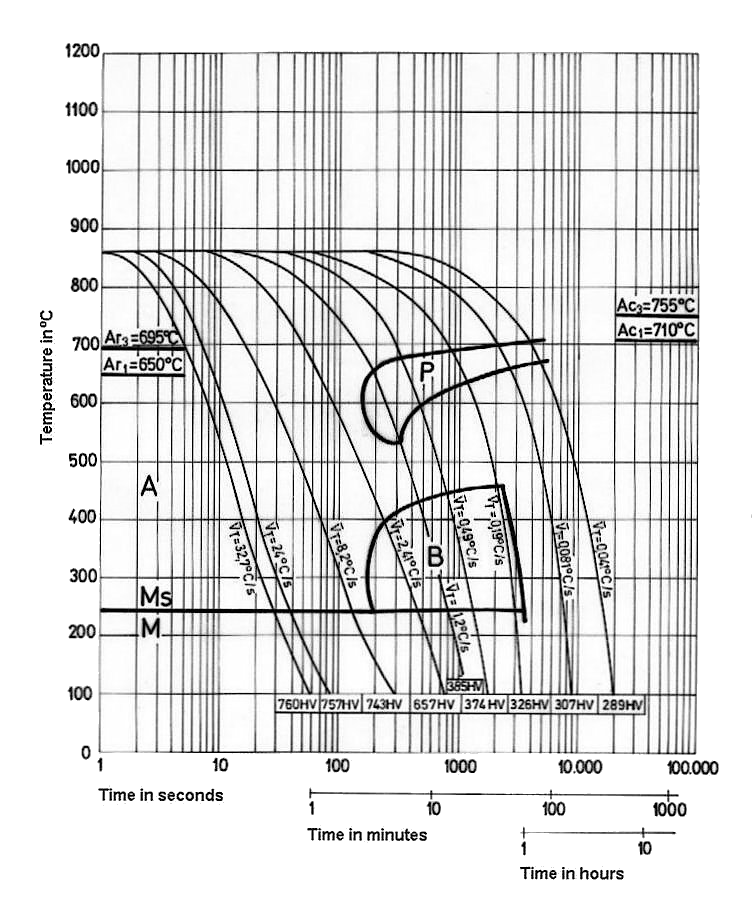

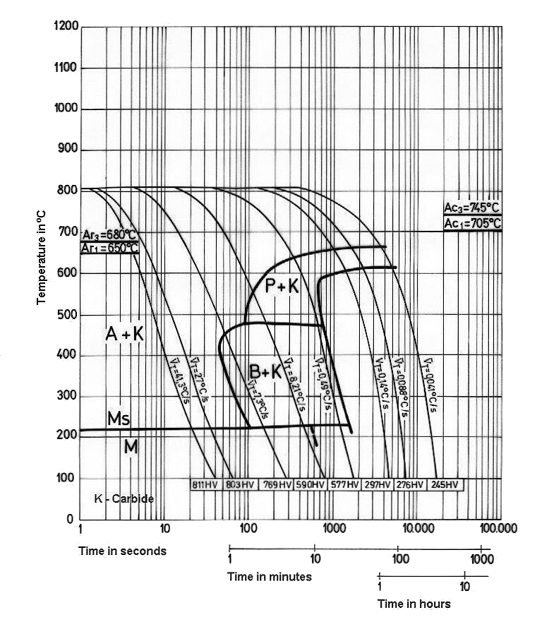

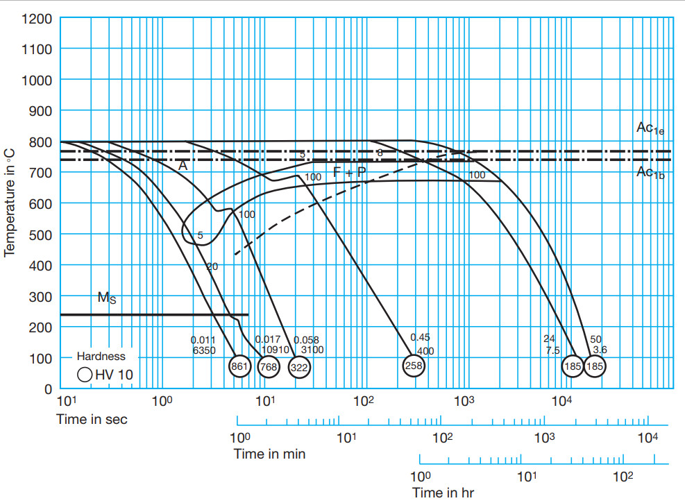

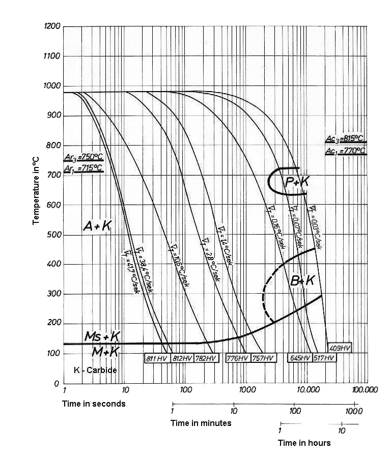

Critical Cooling Rate

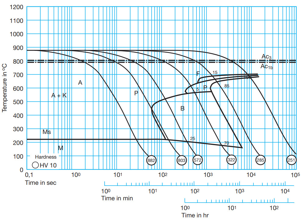

The critical cooling rate is the rate required to form full martensite. The critical cooling rate in the 5160 diagram above is somewhere between the 2.4 and 8.2°C/s cooling rates. Or if bainite is acceptable then somewhere between the 1.2 and 2.4°C/s cooling rates. Different steels have different critical cooling rates. For example, W1 or 1095 have low hardenability due to the high carbon content and low additions of hardenability elements, typically 0.3% Mn and Si. That leads to a CCT looking something like the following:
This CCT for W1 from [5]
This CCT has a field labeled as “P+K” where the K refers to carbides (CCT is German). This diagram goes down to 0.1 seconds because of the lower hardenability of the steel. Only the fastest cooling rate (reached 100°C in 2 seconds) achieved full martensite. Below the phase field there is a number listed which represents how complete the transformation was, so “100” means it fully transformed to pearlite and carbide. The second fastest cooling rate formed 2% carbide and the third fastest transformed to 15% carbide. The hardness is only marginally lower with the second fastest cooling rate (901 vs 914 Hv) showing that you can’t always tell that carbide formed during cooling based on hardness alone. The carbides that form during cooling can be detrimental to toughness, especially because they typically form on grain boundaries. The very high cooling rate required to achieve full hardness in 1095 and W1 is why they are called “water hardening” steels, because water cools steel very rapidly.

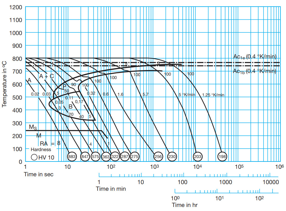

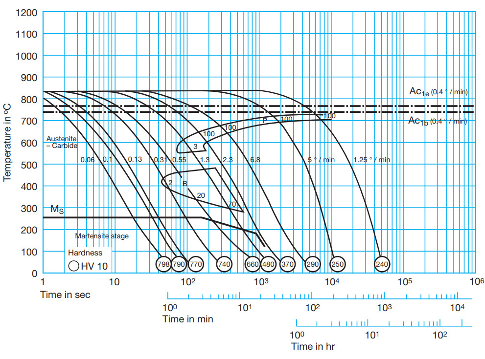

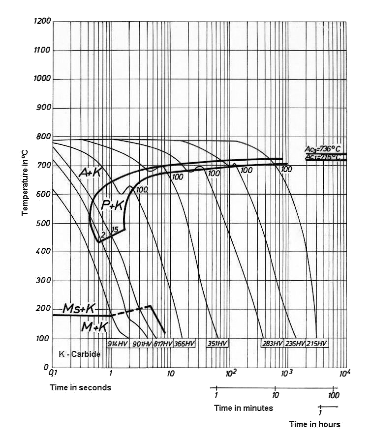

Oil hardening steels like O1 and O2 require a slower cooling rate. O1 has additions of about 1.2% Mn, 0.5% Cr, and 0.5% W. Tungsten contributes little to hardenability but the Mn and Cr increases hardenability by suppressing carbide and pearlite formation. O2 instead has around 1.6% Mn to have its relatively high hardenability. O1 has a critical cooling rate somewhere around 10°C/s:
O1 steel CCT [5]

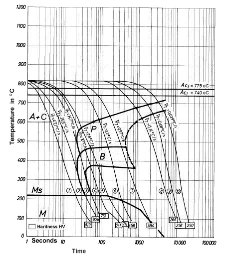

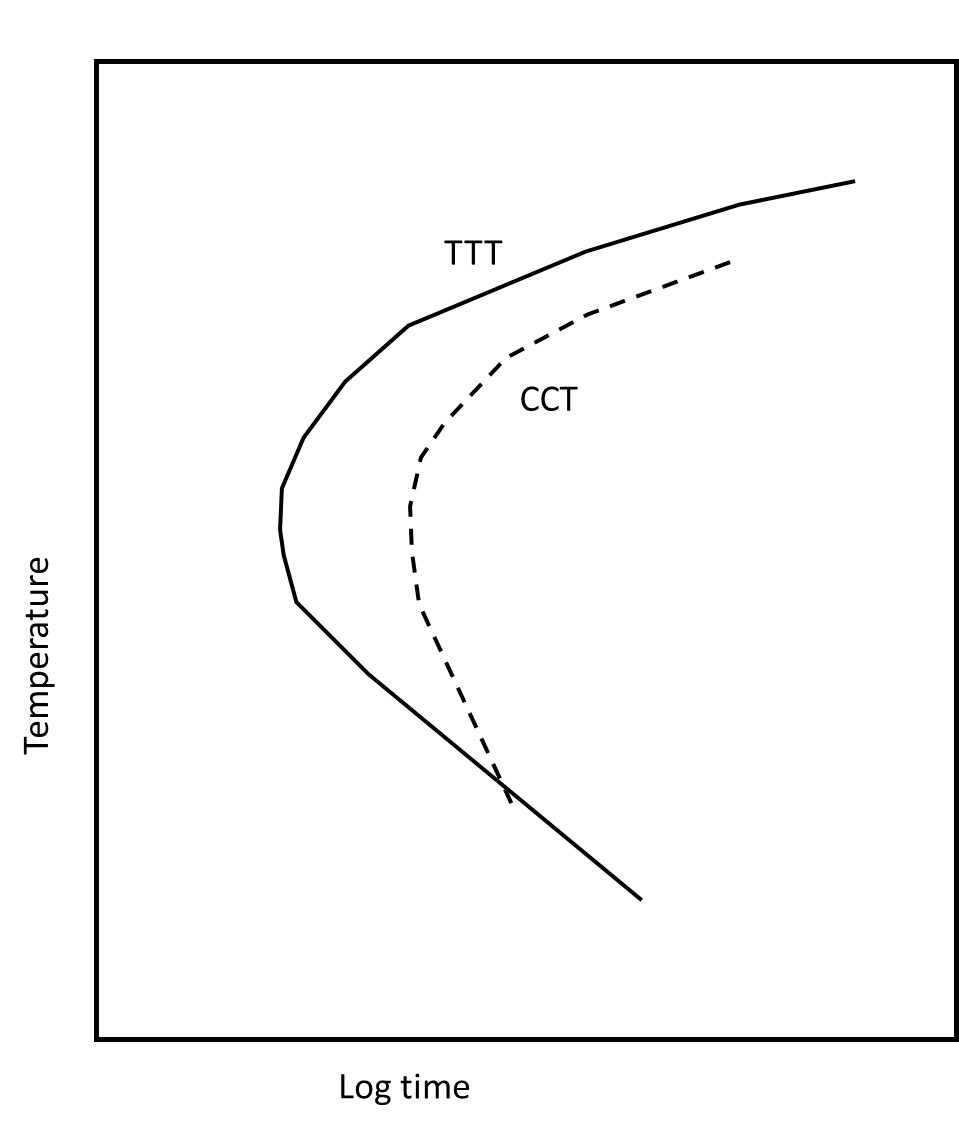

CCT vs TTT
You may have come across Time-Temperature-Transformation (TTT) or Isothermal Transformation (IT) diagrams which look similar to CCT diagrams but the two should not be confused. When generating a TTT you quench to a single temperature and hold, such as quenching to 600°C and holding there until the transformation has completed. This process is performed for all temperatures of interest and then the TTT diagram is generated with the resulting transformation data. TTT diagrams may look similar to CCT diagrams but there are sometimes significant differences. CCT diagrams are preferred for looking at quenching or slow cooling processes. TTT diagrams are better for intentionally forming bainite or pearlite by holding at specific temperatures. I wrote about the use of TTT diagrams for bainite in this article. For very simple CCT and TTT diagrams, the CCT is typically at somewhat lower temperatures and longer times than a TTT, so in cases where only TTT diagrams are available you may still be able to get an idea of relative hardenability from a TTT (comparing one steel to another). This simple relationship is because a CCT with continous cooling can be thought of as many tiny time steps at each descending temperature. However, the diagrams can be significantly different because transformations that occur at higher temperatures can affect low temperature transformations. So a steel that is transforming to ferrite or pearlite at high temperature may mean that bainite transformation is not observed, such as in the W1 steel CCT previously shown. However, in a TTT for W1 the bainite transformation is a significant part of the diagram.
Simple schematic showing the general difference between a CCT and TTT
This TTT for W1 looks significantly different than the CCT shown previously because of the bainite transformation

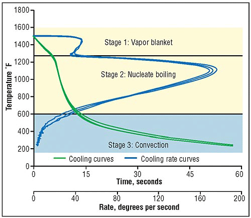

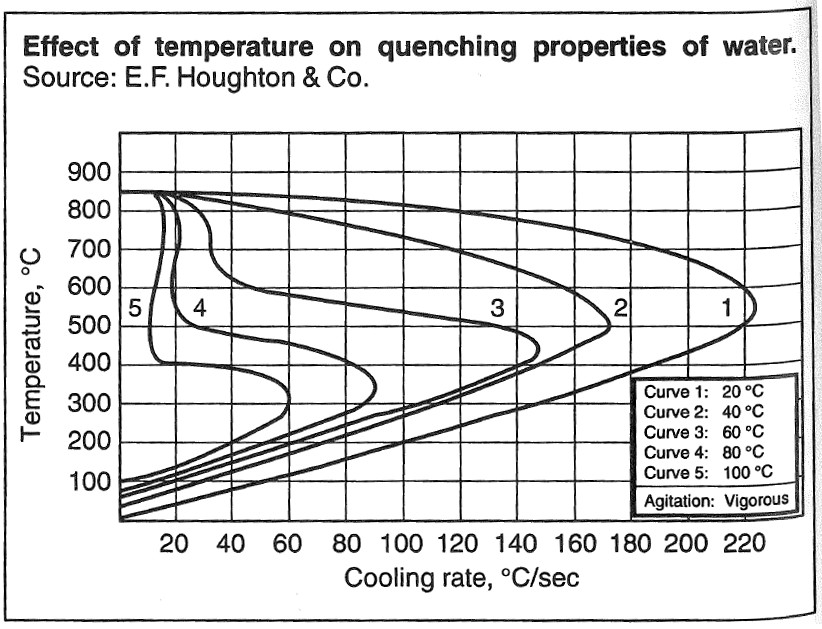

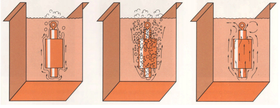

This is probably as good a point as any to discuss the quenching medium. As mentioned previously, water is typically the fastest quenchant used, and it achieves very fast cooling rates, over 150°C/s:
This image from [6]
The chart above shows water cooling rate (blue lines) as well as the temperature vs time in green. During quenching into water, the water is vaporized and forms a “vapor blanket” around the steel which limits the cooling the steel experiences as the steam is a much poorer conductor than liquid water. The formation of a vapor jacket is reduced by agitating the water, but is not perfect, which is why the cooling rate increases from the quenching temperature (1500°F) to the peak cooling rate. Once the vapor blanket is broken there is more of a boiling action where the water boils and forms bubbles around the steel. The bubbles float away and the liquid contacts the steel again. Finally, the steel cools sufficiently that boiling no longer occurs, and cooling then occurs due to convection (the heated water rises and is replaced with cooler water). Here is another schematic diagram representing the process:
The left image shows the vapor blanket, the middle rapid boiling, and on the right in “normal” convection cooling. This image from [7]
The temperature of the water also affects the vapor blanket formation. The closer the water is to the boiling temperature the easier it is for the vapor blanket to form. This leads to a decrease in cooling rate due to the more tenacious vapor blanket:

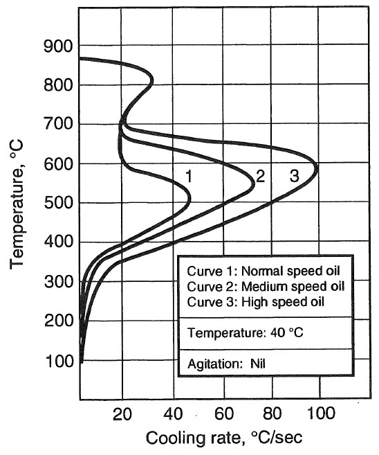

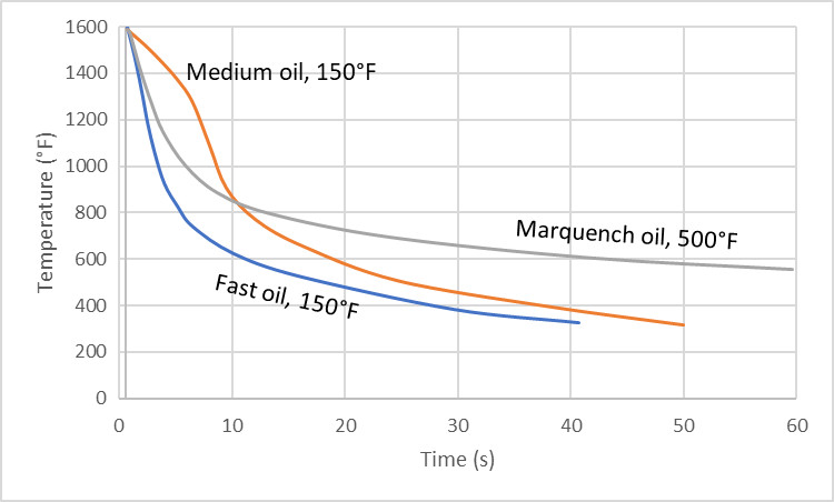

The principles of oil quenching are very similar to water quenching, but the quench rate is somewhat slower:
This image from [8]
High speed oil is for low hardenability steels or water quenching steels. A common high speed oil is Parks 50. Medium speed would be an oil like AAA. Oils cool more uniformly than water does, reducing the chance of warping and cracking. Some oils like AAA require heating to a certain temperature (~150°F) so that they have sufficient viscosity for good quenching. Oils have a “flash point” above which they will ignite. Marquenching oils have a higher flash point so that they can be heated to high temperatures (~500°F). Quenching to a higher temperature means that the transformation of martensite is slowed, but the quenching rate to avoid pearlite and carbide remains high. Slowing down the rate of martensite transformation reduces the chance of warping and cracking. The cooling rate naturally slows as it approaches the temperature of the quenchant, so as the oil temperature approaches the martensite start temperature, the cooling rate during martensite formation is reduced.

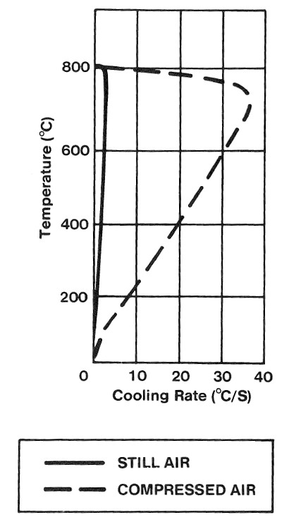

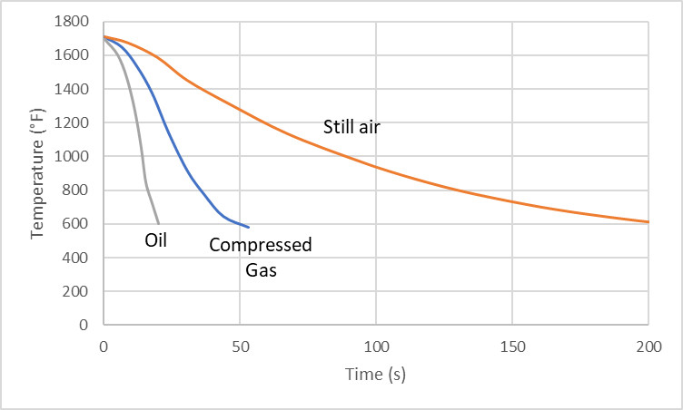

Air Quenching
Even slower than oil quenching is air quenching. This can be performed under compressed air or in still air, and there is a big difference between the rates of these two options. Different gases can be used as well with compressed air such as hydrogen, helium, or nitrogen. In the home shop options for consistent compressed air quenching are not typically available. More common is to use “quench plates” where the knife is placed between two aluminum plates and the heat is drawn out through conduction, significantly faster than still air alone. Quench plates also have the advantage of helping to achieve good flatness without warping.
This image from [8]
Data from [8]

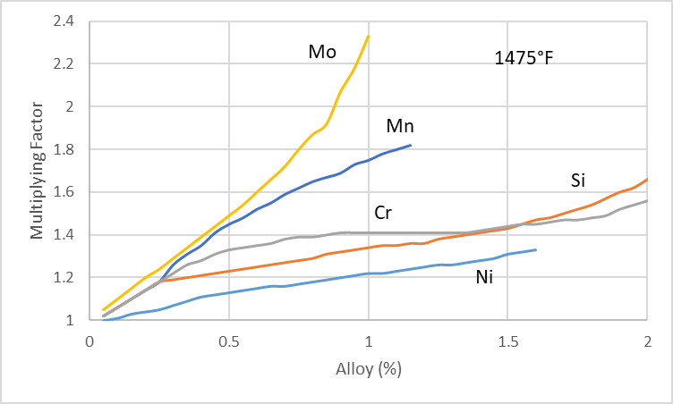

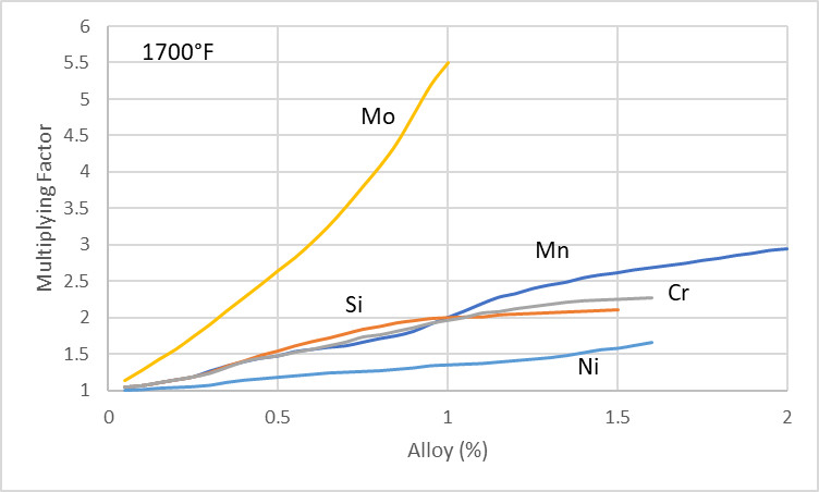

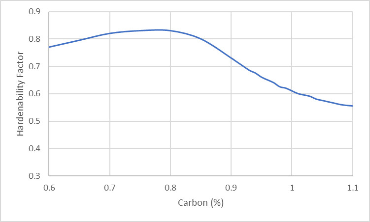

Multiplying Factors for Steel Hardenability
Tests have been performed to find the relative effect of different alloying elements on hardenability, such as carbon shown in the earlier plot:
Data from [9]
So for a carbon content of 1%, there is a multiplying factor of approximately 0.61. This multiplying factor for carbon can then be used with other alloy that is in the steel:
Data from [9]
So if the steel had 1%Mn the Mn multiplying factor would be about 1.75, and a factor for 0.5% Si would be about 1.22. Using the factors for C, Mn, and Si then, the factors are multiplied together: 0.61*1.75*1.22 = 1.3 which gives a relative, approximate value for hardenability. For example, I do not know about any CCT diagrams to estimate hardenability for CruforgeV, and we may want to know how it compares to a steel like 52100. For both, the carbon factor would be about 0.61. For 52100, the 0.3Mn, 0.3Si, and 1.5Cr would give factors of about 1.2, 1.2, and 1.45 for total hardenability of 0.61*1.2*1.2*1.45 = 1.27. CruForgeV with 0.75Mn, 0.5Cr, and 0.3Si would give 0.61*1.6*1.3*1.2 = 1.52 so we would expect CruForgeV to have higher hardenability than 52100. These estimates are not perfect but can give a general idea of relative hardenability.
As seen in the chart, Mo is the most effective hardenability element. Molybdenum is often added to air hardening steels like A2, D2, or 440C in amounts of 0.5-1% to ensure that they harden properly. And those steels have significant amounts of chromium in solution where we would expect them to have high hardenability. However, the addition of Mo ensures that steels with thick cross sections cooled in still air will still achieve full hardness. Some oil hardening grades are given Mo additions of around 0.3% to give higher hardenability.

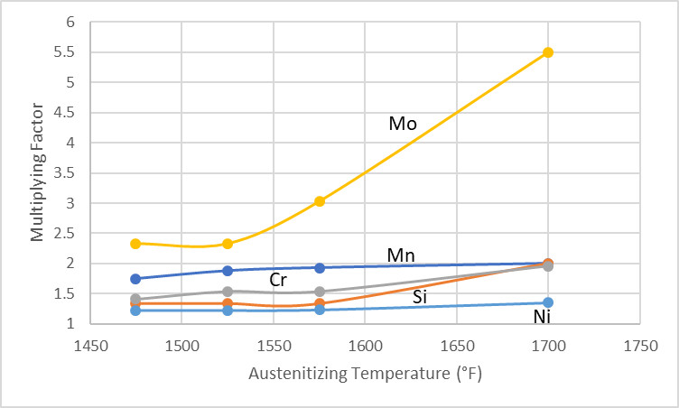

Austenitizing Temperature
Hardening temperature also affects how different alloying additions contribute to hardenability. This is because the carbides must dissolve for the alloy to be in solution to contribute to hardenability. This is especially evident with Mo where at 1700°F the multiplying factor is much higher than at 1475°F:
Data from [9]

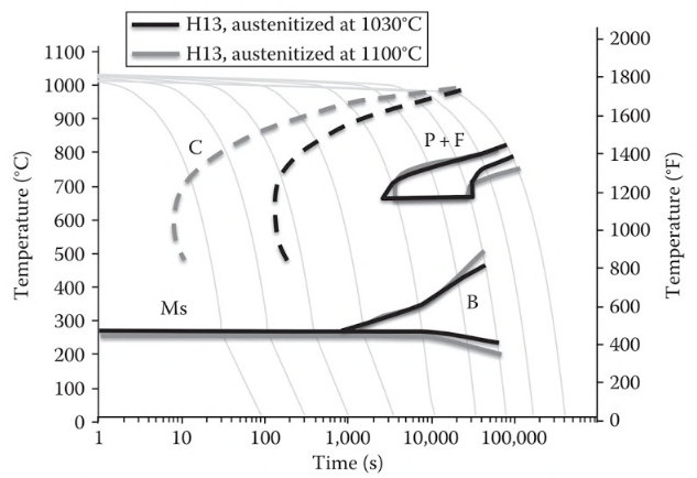

Hypereutectoid Steels
However, with hypereutectoid steels, higher temperatures puts more carbon and alloy in solution which increases the driving force for carbide formation during cooling. This can mean that using higher temperatures lowers hardenability because carbide formation is promoted. Here is an example with H13 steel where using a high austenitizing temperature led to carbide formation (marked “C”) at quite rapid cooling rates:
This image from [10]

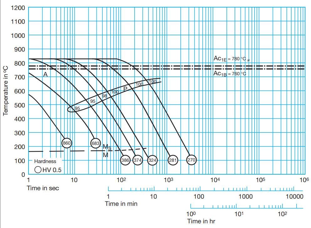

W2 steel [11] – 1.0C-0.2Mn-0.2Si-0.1V – Very low hardenability, needs to be quenched in 3 seconds
W1 – 1.05C-0.25Mn-0.2Si – Very low hardenability
0.70C-0.25Mn-0.25Si [5]- 1070 though with lower Mn than normal (typically around 0.7Mn). The lower carbon gives it somewhat better hardenability than the “W” steels above. Needs to be cooled in about 5 seconds
