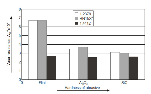

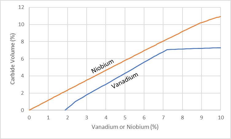

Wear Resistance
Carbides are hard particles that contribute to wear resistance of steels. The more carbide is present the lower the toughness is of the steel. The carbides are hard but brittle which is why toughness is reduced. Harder carbides are better at contributing to wear resistance. So a low volume of very hard carbides can give a better balance of properties than a larger volume of softer carbides. Vanadium carbides are among the hardest carbides so vanadium additions are often used for this purpose. This is seen in steels like 10V and 15V which have very high vanadium content (10% or 15%) for very high wear resistance. Or steels like 3V or 4V which have a lower amount of vanadium for high toughness but good wear resistance for the level of toughness.
Niobium carbides are very hard, similar in hardness to vanadium carbides. I have seen some studies that found niobium carbides to be slightly softer than vanadium carbides but other studies that found the reverse. I think it is safe to say that they are similar in hardness. Both are used to make high wear resistance steels. Therefore, in general, niobium can be used as a replacement for vanadium for the formation of very hard carbides to contribute to wear resistance.

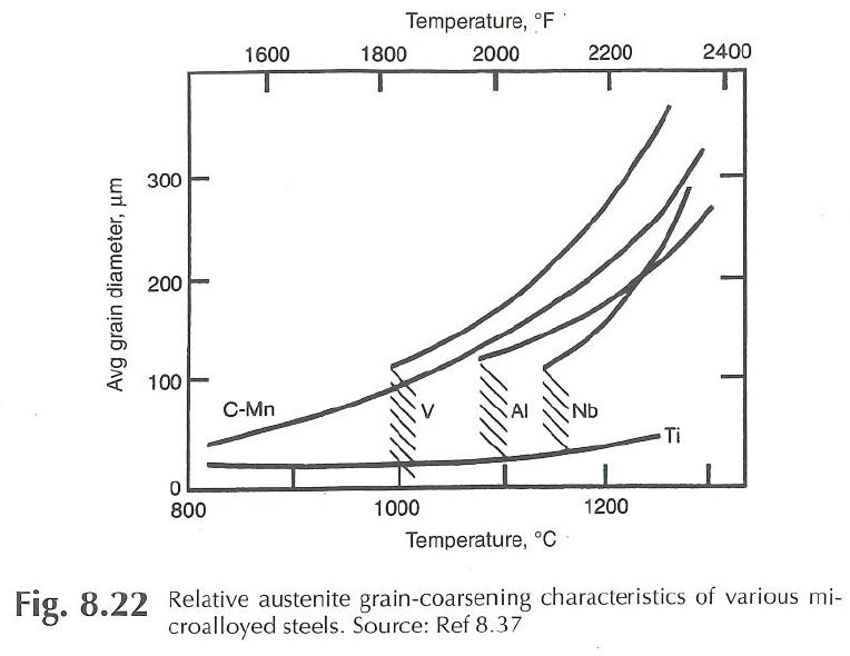

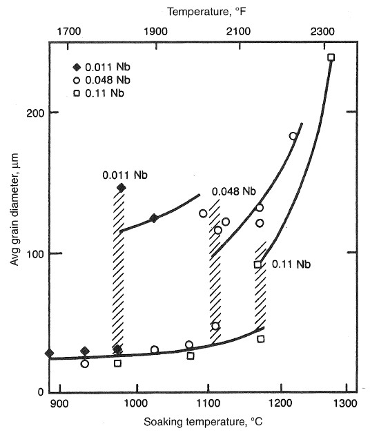

Grain Refinement
The top steel in the chart is Carpenter CRB-7, a bearing steel steel. B70P is the same steel but produced with powder metallurgy instead. The niobium addition is relatively small. There are a few other steels with a similarly small niobium addition, such as certain versions of 1% carbon, 8% chromium steels [1][2]. These small niobium additions are made for the same reason: grain size control. When carbides are present in a fine array throughout the microstructure, they act to “pin” the grain boundaries so that the grains are unable to grow. Fine grain size is desirable because it leads to superior strength and toughness; you can read why in this article. Normally grains grow freely at high temperature when there are no carbides present. The higher the temperature, the faster the grains grow because diffusion is faster.
However, when there is a fine array of carbides then the carbides “pin” the grain boundaries so they are unable to grow. This keeps the grain size small even at high temperatures:
Why add 0.25% niobium if the steel already has 1% vanadium? Well, niobium carbides are better for pinning grains. They dissolve at higher temperatures, so the steel can be forged or hardened from higher temperatures while keeping the grain size small. In the chart below you can see that for a simple steel (labeled C-Mn) the grain growth is relatively continuous with increasing temperature. With a Ti addition (bottom line) there is very little grain growth even up to 1250°C (2300°F). Vanadium keeps the grain size as small as Ti does up to about 1000°C (1825°F), and then when the vanadium carbides are dissolved the grain growth rapidly reaches the same level as the C-Mn steel. Niobium, however, maintains a small grain size all the way up to 1150°C.
This is somewhat of a simplification, as it also depends on how much vanadium or niobium is added. When more V or Nb is added then the carbide dissolution is shifted up to higher temperatures. However, V dissolves at significantly lower temperatures than Nb, and with quite small additions of Nb grain growth is inhibited to very high temperatures:
The CRB-7 patent [3] says that the niobium addition allows hardening/austenitizing temperatures as high as 2100°F without a drop in toughness because of the better grain pinning of niobium carbides. JMatPro calculations confirm that no vanadium carbide is predicted to be present at high temperature in CRB-7, but a small amount of niobium carbide is present up to very high temperatures, and therefore would be available for grain pinning. In fact, no vanadium carbide (VC) is predicted to have formed at all in CRB-7. The reason is that vanadium is very soluble in chromium carbides, making a chromium carbide that is enriched in vanadium, which increases the hardness of the chromium carbide but not to the level of the very hard VC. The lack of any VC means that the effect of vanadium carbide on pinning of grain boundaries is not present, of course. Niobium, however, is a “stronger” carbide former than vanadium and NbC is formed even with small amounts of Nb and very large amounts of Cr. That makes niobium effective at maintaining a small grain size in steel. Below I have plotted vanadium or niobium vs MC in CRB-7 at 2000°F calculated with JMatPro. Nearly 2% vanadium is necessary to form any VC, while NbC begins to form with the smallest amount of Nb. This is due to the high chromium content (14%) which affects vanadium carbide formation:

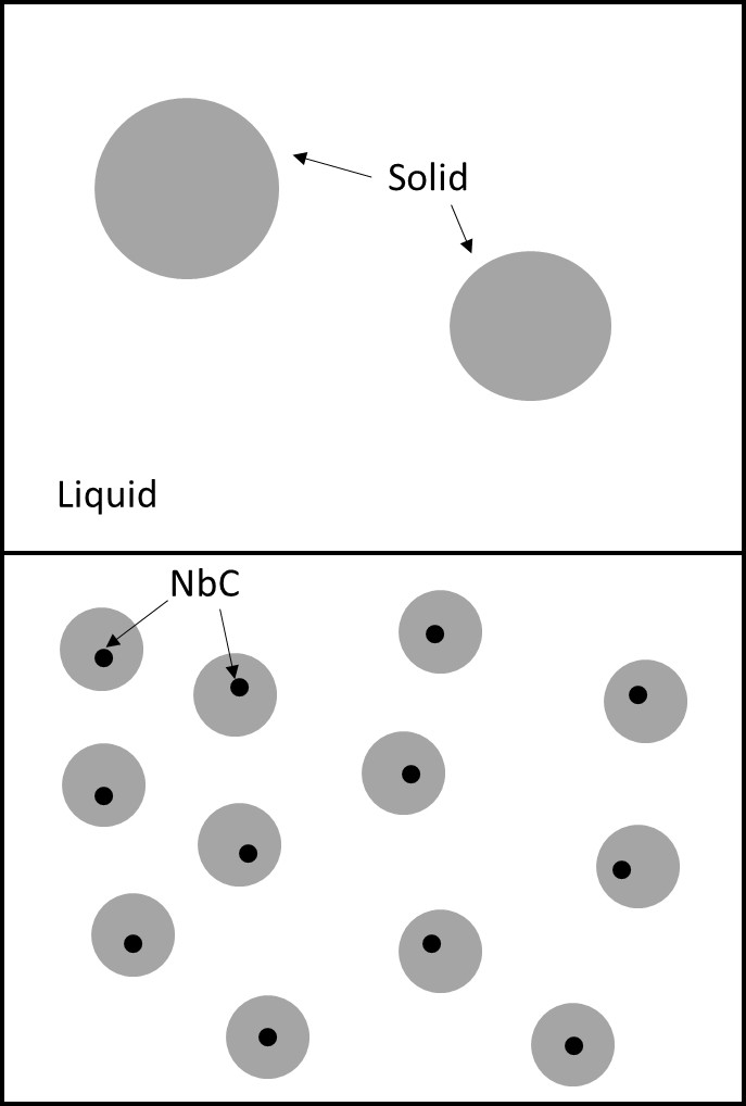

Carbide Structure Refinement
In a previous article on powder metallurgy, I described how carbide structures end up being large during casting, which leads to large carbides in the final product and toughness is poor. High chromium steels like D2 and stainless steels form chromium carbide networks in the liquid steel that are very difficult to break up in future forging, as the carbides are stable up to melting. A structure called “ledeburite” is formed which is a combination of carbide and austenite in a structure that looks something like this:
Additions of Nb can lead to a refinement of the as-cast structure [4] so that the carbides are more easily refined during forging and heat treatment operations. The niobium carbides that form in the liquid before the austenite and carbide acts as “nucleation sites” for the resulting solid phases. The austenite and carbide nucleates on the niobium carbides, and the dispersion of those carbides leads to a higher nucleation density for a refined cast structure.
The top schematic represents typical solidification of steel, the bottom showing the effect of NbC on solidification
This image from [4] showing refined cast structure with Nb addition

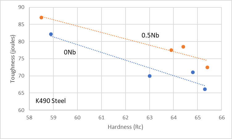

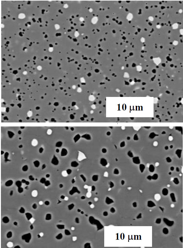

This is the principle by which the 0.5% Nb was added to steels K490 and S35VN, and to some extent in the larger niobium-addition steels. S35VN is a modification of S30V steel where the vanadium was reduced from 4 to 3% and replaced with 0.5% niobium. Even with powder metallurgy, carbides can form in a range of sizes. Niobium additions to powder metallurgy steels can also lead to a refinement of the final microstructure. ASP2055 is a powder metallurgy high speed steel with 3.2% V and 2.1% Nb, while ASP2052 is a PM high speed steel with 5% vanadium. A clear difference in carbide size is evident, where the Nb-alloyed steel on top has much finer MC carbides (black particles):
This image from [5], top is Nb-alloyed steel and bottom is V-alloyed only
S35VN has better transverse toughness than S30V (12 ft-lbs vs 10 ft-lbs) [6]. That improved toughness is likely due to a refined carbide structure. In the patent of K490 [7], they measured the toughness both with and without a 0.5% niobium addition. They found an improvement in toughness by addition the niobium. They also showed micrographs which had a clear difference in carbide size, though the images in scanned patents are terrible so the ASP2055 comparison above will have to suffice.

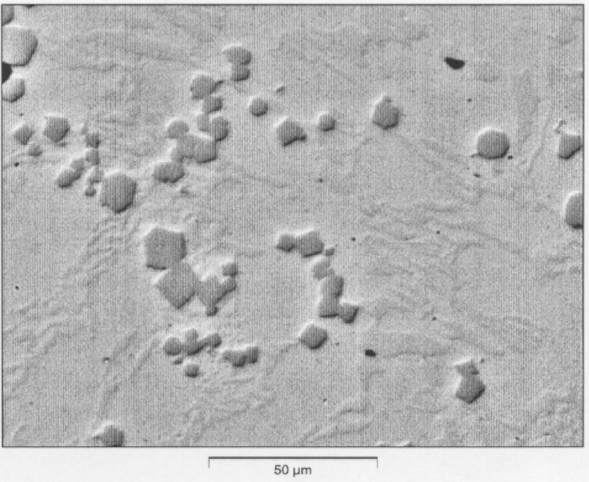

Formation and Size of Niobium Carbides
There are three different regimes for niobium carbide formation during solidification of steel:
  1. Small niobium additions (<0.3% or so) form after the solid austenite has formed. The carbides are small (<1 micron) and well dispersed because they form at lower temperature where diffusion is slower and because of the presence of solid steel where growth is slower. These carbides are particularly good for pinning grain boundaries because there is a high density of carbides.
  2. Medium niobium additions. Greater than about 0.3%, the upper bound is somewhat unknown, somewhere in the range of 1.0% [9] to 2.5% [10]. A medium amount of niobium carbide forms concurrently with austenite (eutectic) leading to a mixed structure of medium sized niobium carbides (<10 microns) in the final forged product that contribute to wear resistance.
  3. High niobium additions. Greater than 1.0-2.5% depending on which reference you look at. The niobium carbides form directly in the liquid steel and can become quite large (>10 microns). These carbides have a more square or “cuboidal” shape.

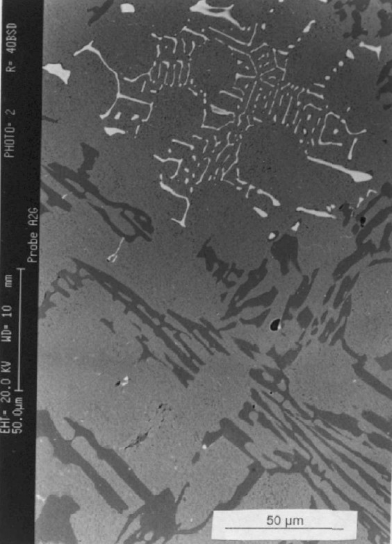

The white structure is the niobium carbide “eutectic” and the dark grey is the chromium carbide eutectic  in a cast “medium niobium” steel [10]
Cuboidal niobium carbides in a high Nb steel [10]

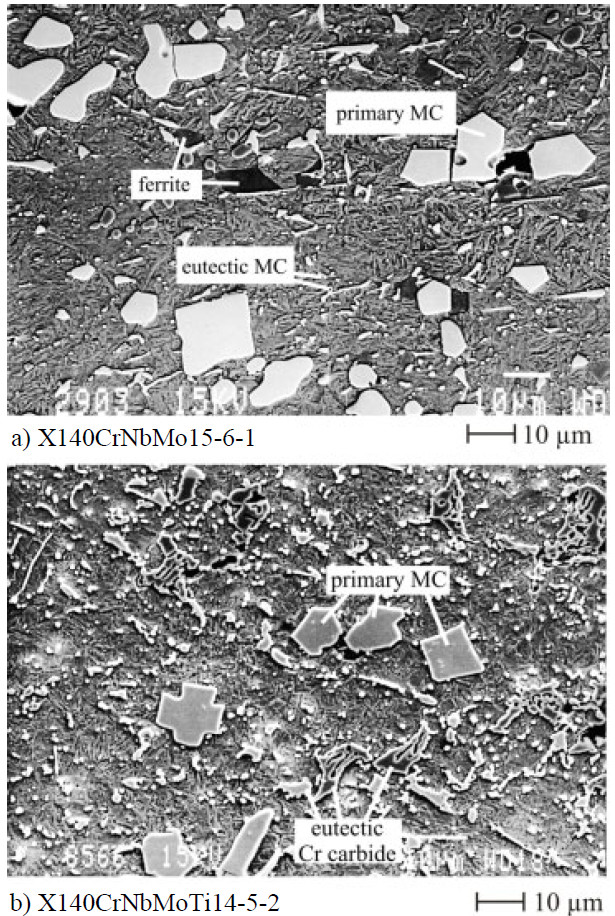

Effect of Titanium on Niobium Carbides
There is some mixed information about the addition of titanium for controlling niobium carbide size. With large Niobium additions of >4%, titanium additions have been found to decrease the niobium carbide size. The mechanism is similar to that described for how niobium carbides reduce chromium carbide size. The titanium carbides form at a higher temperature than the niobium carbides, and then act as preferential nucleation sites so that there are more niobium carbides formed which reduces their final size. Here is a comparison between steels with 5-6% niobum, RN15X [11], the top without Ti and the bottom with a 0.12% Ti addition, where the Ti-added steel has somewhat smaller carbides:
However, there is a patent on niobium-alloyed steels using 2.5% NbC where they found that a small addition of Ti led to larger carbides [12], and in the case of that patent the larger carbides were desirable for wear resistance. However, in knives we would like to keep carbides small because knife edges are very small and smaller carbides keeps our toughness high. With lower amounts of Nb, the addition of Ti means the structure is shifted from the “eutectic” mixture of NbC and austenite to the cuboidal, large niobium carbides [13]. That may be desirable for a cast structure as can be seen in the image below, but for typical steel where the eutectic will be broken up during forging the final carbide size is larger with the Ti addition.
This image from [13]

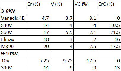

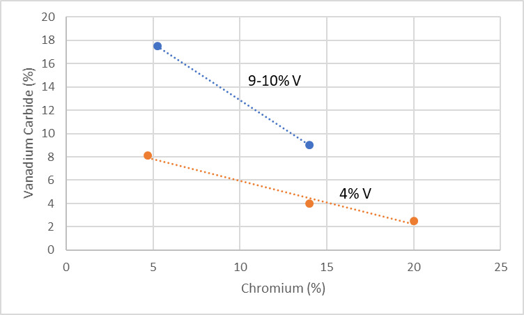

The Problems with Vanadium in Stainless Steel – Toughness
One issue with vanadium additions for hard VC in stainless steels was previously mentioned: vanadium tends to be enriched in chromium carbides rather than forming the harder VC. The more chromium is in the steel, the less VC will form. I have the bulk chromium and vanadium content for a range of steels, and then the amount of vanadium carbide (VC) and chromium carbide (CrC) that is in the heat treated microstructure:

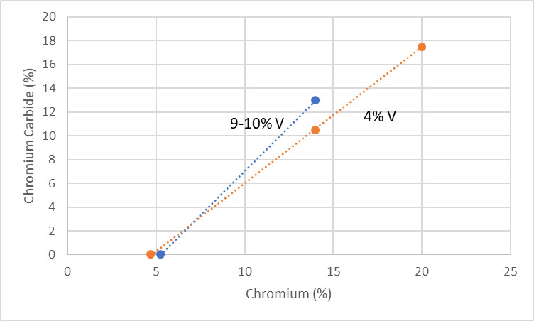

Below you can see that as more chromium is added the amount of vanadium carbide (VC) goes down:
At the same time that the vanadium carbide content goes down with more chromium, the amount of chromium carbide goes up:
Steels like 3V, 4V, and 10V get their excellent combination of toughness and wear resistance by having all vanadium carbide. Toughness is controlled by carbide volume fraction (lower is better) and wear resistance is controlled by carbide hardness and volume fraction (harder is better, more is better). Therefore to maximize the toughness-wear resistance balance you maximize carbide hardness (by using hard VC) and then select the level of toughness and wear resistance with the amount of VC. 10V has very high wear resistance with average toughness (17.5% VC), and 3V has very high toughness with average wear resistance (5% VC). The vanadium-alloyed stainless steels have a very high content of chromium carbides which upsets this design principle. The chromium carbide is not as hard as VC so it reduces the level of wear resistance for a given level of toughness (carbide volume). This leads to Uddeholm steels Elmax (18% Cr) and Vanadis 4 Extra (5% Cr) having similar CATRA edge retention, but the toughness of V4E is much higher:

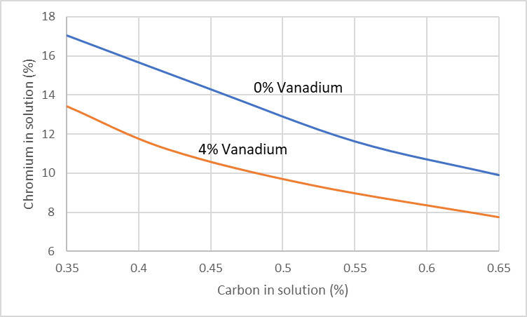

The Problems with Vanadium in Stainless Steel – Corrosion Resistance
Vanadium also reduces corrosion resistance of stainless steels. Every stainless steel has some balance between carbon and chromium “in solution,” shown by the line “0% Vanadium” on the chart below, indicating the maximum level of C-Cr that can be achieved. More carbon means higher hardness and more chromium means higher corrosion resistance. However, having more chromium in solution reduces the amount of carbon in solution and vice versa. This makes it very difficult to design steels with both high corrosion resistance and high hardness. I wrote about this design difficulty and how molybdenum changes things in this article on 154CM, and how nitrogen affects the balance in this article. Adding vanadium increases the amount of chromium carbide that is formed and drops the carbon-chromium curve, reducing the level of hardness and corrosion resistance that can be obtained:
These C-Cr curves calculated at 2000°F using JMatPro

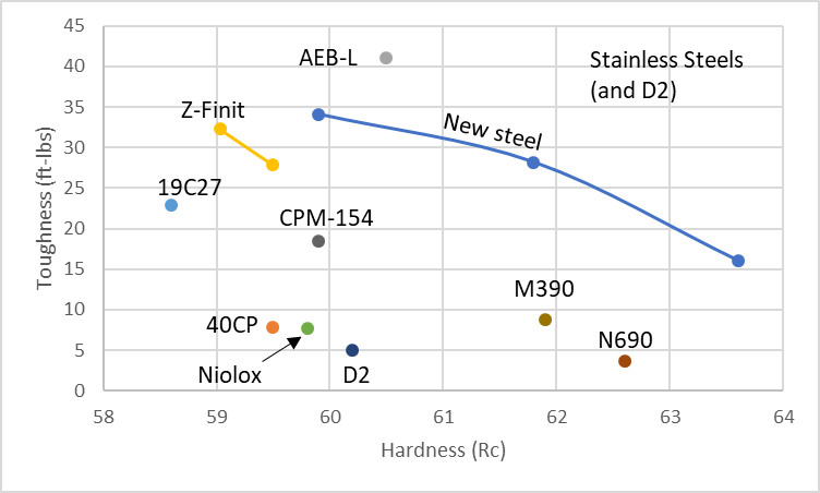

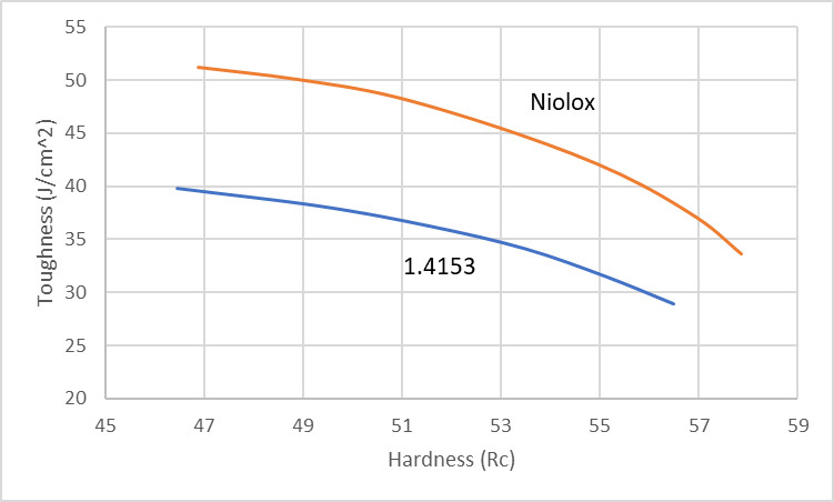

Niolox
Niolox is a stainless steel with 0.7% Nb along with 0.9% V, relatively small amounts for enhanced wear resistance over a steel like AEB-L. Niolox began as German steel 1.4153 which has an approximate composition of 0.8%C, 13% Cr, 0.5% Mo, and 1.7% V. In 1989 Niolox was patented [17] which is a modification of that steel. They increased the Mo to 1.1% for better corrosion resistance, and replaced some of the vanadium with niobium for 0.9%V and 0.7%Nb. They found that Niolox has good corrosion resistance, wear resistance, and toughness due to the modified composition including the change to niobium. They found that Niolox outperformed 1.4153 in a salt spray corrosion test. And they found that hardness and toughness was significantly improved vs the older 1.4153:
Niolox was introduced to knives in the early 2000’s with help from Achim Wirtz. On paper it looks like a well-balanced steel for good toughness and wear resistance.  There are many stainless steels with high wear resistance like S30V, Elmax, and M390, and a few with high toughness like AEB-L but not much between. However, in toughness testing that we performed Niolox was not particularly spectacular, similar to the PM steel 40CP, but significantly lower than CPM-154, and much worse than AEB-L. This result is somewhat surprising because based on the carbide volume I would expect Niolox to perform similarly to 19C27. We have only tested the one condition so far (an average of 3 samples), so maybe other heat treatments would do better.
In a previous article I presented micrographs of Niolox along with AEB-L and CPM-154. Niolox, despite having only 0.7% Nb, had surprisingly large Niobium carbides which may explain the poor toughness:
Niolox
AEB-L
CPM-154

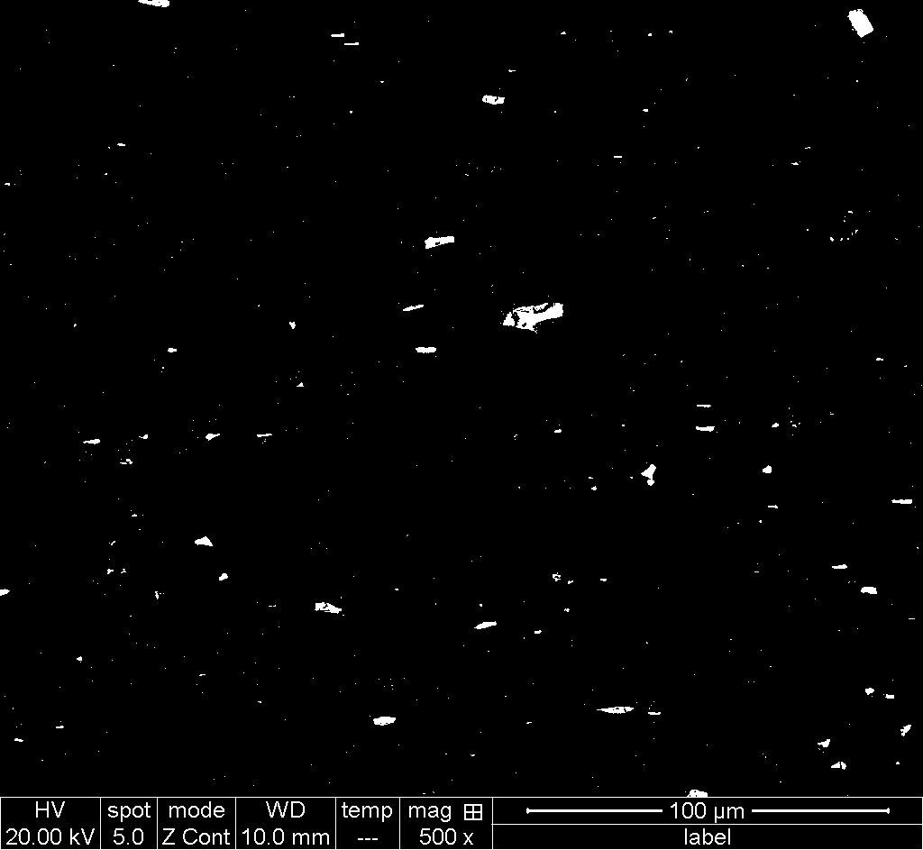

New Steel
The “new steel” listed in the toughness chart is a steel that we are developing that includes a significant Nb addition. Comparing the Nb carbides between Niolox and the new steel show that the size and density of NbC is much improved relative to Niolox, which may explain the much better toughness of the new steel:
Niobium carbides in Niolox
Niobium carbides in new steel
Development is still not far enough along to discuss the new steel further, but I bring it up to point out that niobium-alloyed conventional ingot steels can be produced with relatively small carbides and high toughness.

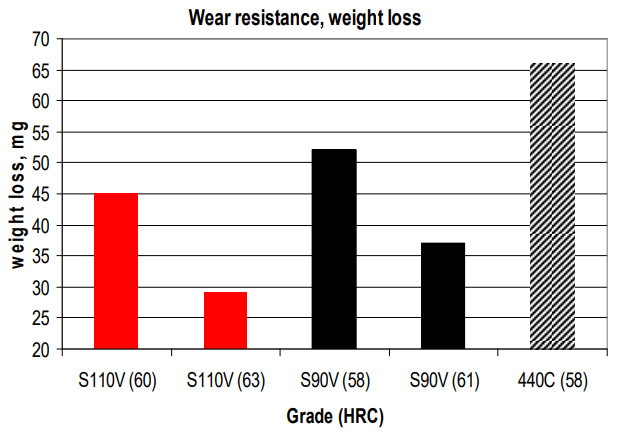

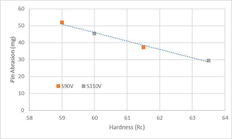

S110V
S110V is essentially a modified version of S90V or S125V designed for improved corrosion resistance when compared with those steels. S90V has 14% Cr and 1% Mo, while S110V has 2.25% Mo and 15.25% Cr for improved corrosion resistance. The addition of niobium also helps with corrosion resistance. As the patent [18] says, “It has been discovered that the presence of niobium in the alloy of the invention also lowers the amount of chromium that dissolves in MC primary carbides. This in turn increases the amount of ‘free’ chromium in the matrix, which further improves the corrosion resistance.” Their calculations of an 11V steel yielded 12.55% Cr in solution when heated to 2050°F, while the 9V-3.5Nb steel had 13.39% Cr in solution. Corrosion resistance tests confirmed that superior behavior was achieved with S110V, where a pitting potential test yielded 403 mV for S110V compared to only 59 mV for S90V (higher is better):
With the same 9% V of S90V plus an extra 3% Nb we would expect a significant improvement in wear resistance by using S110V instead of S90V. And looking at the datasheet [19] that appears to be the case:
However, the hardness of the S110V is higher than for the S90V in that chart, and when the two are plotted vs hardness it turns out the wear resistance appears to be identical:
Therefore, S110V is probably best seen as an improved corrosion resistance upgrade over S90V, with also higher potential hardness. No toughness data on S110V is available, which would also be an interesting comparison with S90V.

    I have some questions regarding niobium alloyed steels :
    – can such coarse niobium carbides refined by “severe” forging ? or its blocky shape make these particles highly resistant to fragmentation ?
    – why they didn’t use titanium or zirconium instead of niobium ?
    comparing density of their carbides titanium give highest volume fraction of hard MC carbides per 1% addition compared to all MC formers . TiC is also the hardest MC carbide . Ti carbides have higher solubility than Nb during high temperatures austenizing , this can induce better secondary hardening .
    all these factors should make Ti steels more better Nb steels , then why there is no such interesting in Titanium alloyed steels compared to Niobium ?
    1. With large carbides that form in the melt it is seemingly impossible to refine them all to the sub 5 micron range. They are very stable and become very large so it’s not really practical even if there is some extreme exception. The size they are in the melt depends on how much Nb was added and the melting practice.
      Titanium is an even stronger carbide former than Nb so TiC have an ever greater tendency to become very large.
      1. I mean using titanium by powder metallurgy . steels like 4V , M4 & even 10V when their vanadium content replaced by titanium they should at least theoretically have higher wear resistance than vanadium bearing steels due to larger volume fraction of MC in titanium steels compared to vanadium steels thanks to lower density & lower solubility of TiC compared to VC .
        compared to Nb , Ti is about 10 times cheaper & more abundant .
        so , why there is no interest in titanium steels ?
        1. Titanium is an even stronger carbide former than niobium so it is even more limited than niobium in terms of how much can be added before it causes problems in production.

  7. “The carbides are hard but brittle which is why toughness is reduced.”
    “Steels like 3V, 4V, and 10V get their excellent combination of toughness and wear resistance by having all vanadium carbide.”
    something doesn’t add up here. VC is harder than CC but less brittle. Carbides are brittle because they’re larger than the surrounding matrix, there’s less energy in their boundaries because those are less numerous at any given volume. Correct me if I’m wrong.
    1. VC is not less brittle than chromium carbide. Carbides primarily affect toughness in terms of their size and volume of carbide. Vanadium carbides are smaller than chromium carbides in PM steels and they contribute more to wear resistance. So it allows a lower volume of carbide for the same level of wear resistance. That means that have a carbide structure of only VC provides a better balance of toughness and wear resistance.
