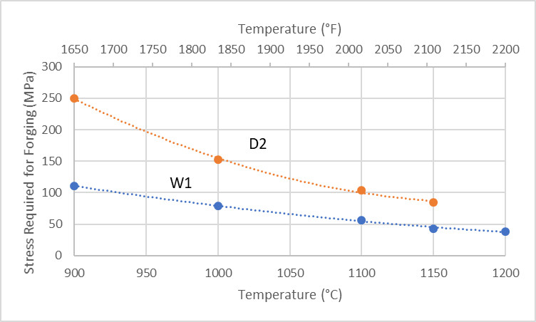

Effect of Temperature
Higher temperatures usually mean that the stress (load per area) required to deform steel is less. The hotter it is the easier it is to shape the steel. The higher the stress measured the stronger the steel is at high temperature. Here is the stress required for forging D2 (high alloy tool steel) and W1 (simple high carbon steel):
Data adapted from [1]

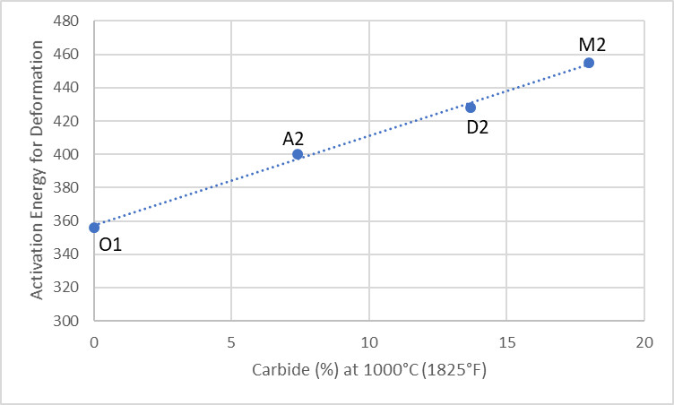

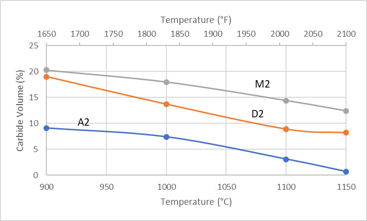

Effect of Carbides
You can see that D2 requires much more stress to forge than W1. One big difference between the two is that D2 has significant amounts of hard carbide at forging temperatures, while in W1 the carbides dissolve at forging temperatures. These carbides raise the required stress for forging. The stress required for forging can be translated into an “activation energy” required for forging, allowing a simple comparison of “forgeability” for different steels. I compared the activation energy of a few common tool steels along with the experimentally measured carbide volume fraction at 1000°C:
Data adapted from [2][3][4]

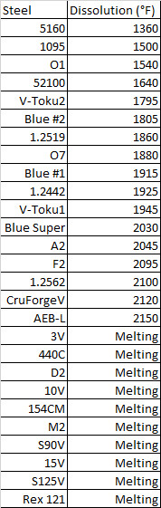

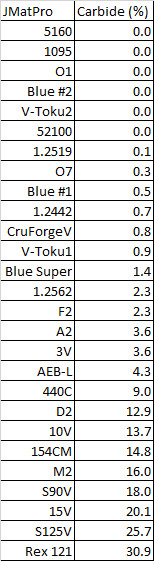

To estimate the forgeability of different steels, then, I used Thermo-Calc to calculate the estimated carbide volume fraction at 1000°C for a range of steels. I focused on low alloy steels since they are more commonly used for forging, but included some high alloy tool steels and stainless steels to compare:
The software typically somewhat under-predicts the amount of carbide because it assumes an infinite hold at temperature. Unlike the very simple steels, forging steels with significant amounts of vanadium or tungsten do have some amount of carbide present at forging temperatures, including steels like CruForgeV and Blue Super steel. This would make these steels on the more difficult end for forgeability of the typical “forging steels.” However, you can see that even very high tungsten (~3.5%) low alloy steels 1.2562 and F2 have considerably less carbide at 1000°C than high alloy steels. On the other end of the spectrum, steels like Rex 121 and S125V would be expected to be very difficult to forge. You can see that low alloy steels like 5160, 1095, O1, and 52100 don’t have any carbide at 1000°C, at least as predicted by the software. Therefore I also calculated the temperature at which all the carbide is dissolved:
The temperature at which the carbides “actually” dissolve is likely somewhat higher than predicted for the same reason that it underpredicts the carbide volume fraction. The forging steels with vanadium or tungsten can have relatively high temperatures at which the carbide fully dissolves, though the amount of carbide is pretty small over a wide range of temperature, so the carbide volume at 1000°C is probably a better indication of forgeability in that case. So between the two calculations (carbide volume at 1000°C and carbide dissolution temperature), relatively forgeability of the different steels can be estimated.

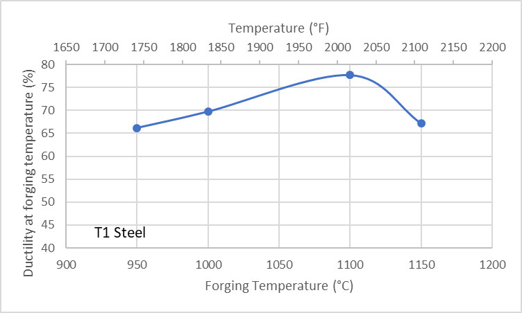

Hot Ductility
The strength of steel at high temperature is not the only important measure of “forgeability.” Another is ductility, or the amount of strain the steel can withstand before it begins cracking. Typically, the ductility increases as the strength goes down and temperature goes up. However, for every steel there is a temperature beyond which the ductility goes down, as can be seen in this chart of ductility vs temperature for T1 high speed steel:
Data adapted from [6]

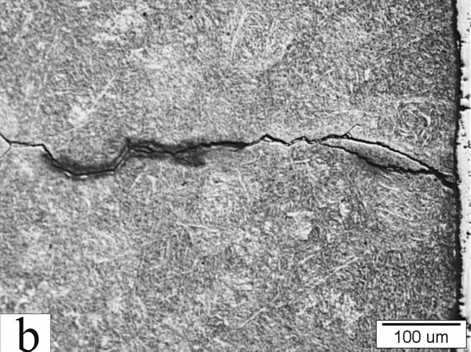

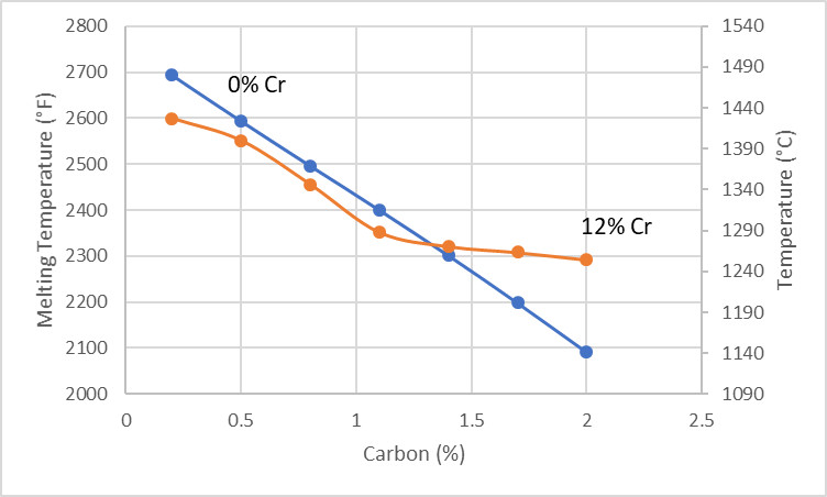

Melting
One important factor that leads to a reduction in ductility is the melting of grain boundaries at high temperatures. Cracks form at these melted grain boundaries. Knife steels are somewhat susceptible to this behavior because they are high in carbon. This effect of carbon remains even with significant alloying additions, as shown by the comparison 12% Cr line below:
While a 1.1% carbon steel is shown to have a melting temperature between 2350-2400°F, the temperature at which grain boundary melting can occur is significantly lower. This is because of segregation of carbon and alloying elements to the grain boundaries that leads to locally richer areas. Grain boundary melting has been reported as starting around 2200°F for several steels including O1 [3] and D2 [8]. There is some time required for the melting to start, of course, with sufficiently short soaking times melting is not observed. However, insufficient soaking is not recommended, and using safer lower temperatures is easier than trying to maintain short soak times. Below is a comparison between the microstructure of forged D2 when it was soaked at the optimum temperature (a) vs too high temperature (b). In (b) you can see thick black lines which are microcracks along the former grain boundaries:
Images from [7]
And here is a crack which has formed in O1 steel when forged from 1200°C (2200°F):
Image from [3]

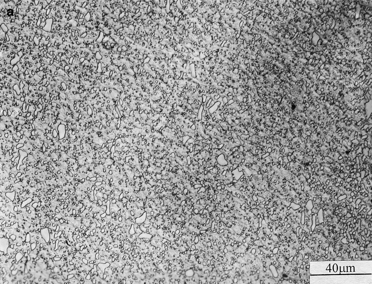

Carbide Coarsening
Other factors that lead to poor ductility at high temperatures requires the discussion of high alloy steels that are “ledeburitic.” A ledeburitic steel refers to one where carbide is present all the way up to melting. When the steel is solidified from liquid, it forms a phase that is a combination of liquid and carbide called ledeburite. I first wrote about ledeburitic steels in this article on powder metallurgy.
Ledeburite. Image from [9]
In the previous chart showing the temperature at which all of the carbide dissolves, any steel listed as “melting” is ledeburitic. Therefore, the steel cannot simply be heated to such a high temperature that the carbide is dissolved. And while more carbide is dissolved at higher temperatures, the carbides that remain will also grow faster at higher temperatures. When there is sufficiently high temperature for diffusion, smaller carbides dissolve and larger carbides grow. This process is called “Ostwald ripening.”
When the soaking temperature is too high, the carbides will grow which reduces the ductility of the steel which can lead to cracks, even at high temperature. Large carbides are also undesirable in the final product because that will reduce the toughness of the steel in the final product. Below is M42 high speed steel soaked at 1180°C (2150°F) in (a) and 1150°C (2100°F) in (b) where you can see the carbides are much larger when soaked at the higher temperature:

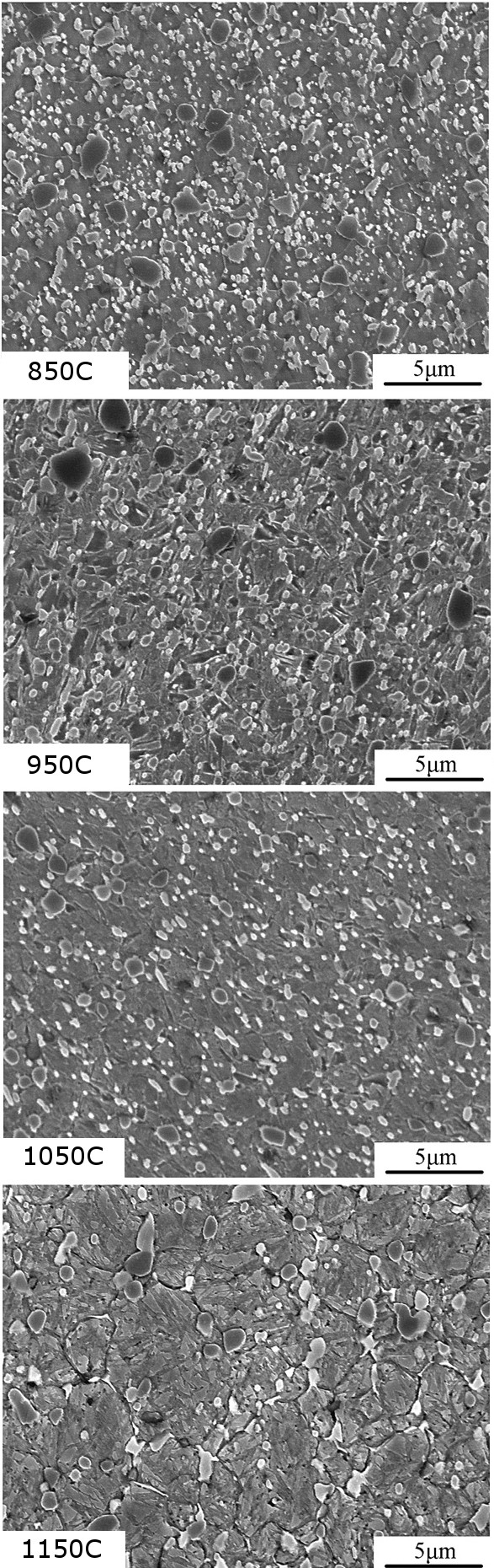

While on the subject of carbide size, even when the carbides have not grown to the extent that they are affecting hot ductility, there are optimal soaking temperatures that lead to the finest carbide size. This is dependent on the steel in question, of course. Too low and the larger carbides cannot be broken up in the forging process, too high and the carbides will coarsen. Here are micrographs of a sprayform Vanadis 4 (non-extra) steel where they forged from different temperatures, where the finest carbide size was achieved with a temperature of 1050°C (1925°F):
Image from [11]

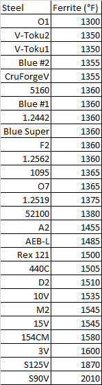

Ferrite
As temperature goes down the forgeability of the steel also decreases as would be expected. However, there are other factors that can further reduce hot ductility at lower temperatures. One is the transformation from the high temperature austenite phase to the low temperature ferrite phase. Austenite is more ductile than ferrite. Steels with significant “ferrite stabilizing” elements like the high chromium in D2 or stainless steels have a higher temperature at which they transform to ferrite. I have calculated using Thermo-Calc the temperature at which ferrite begins to form for the same range of steels as before. The actual temperature that ferrite will form during cooling from forging temperature will be somewhat lower, sometimes significantly lower, because of hardenability. An air hardening steel needs to be cooled very slowly for ferrite to form, which is why they can transform to martensite while cooling in air; ferrite or pearlite does not form. However, the strain induced by forging can also accelerate the formation of ferrite so it is difficult to predict.

It is for the two above reasons that datasheets [12] should be consulted to find the minimum recommended forging temperature, which is the temperature at which the steel should be reheated prior to any further forging operations. For a simple steel like 1095 the recommended minimum temperature is 815°C (1500°F), and for O1 it is 845°C (1555°F). For stainless steel 440C, however, the recommended minimum temperature is 1750°F.
Forging Stainless and High Alloy Tool Steels
Some forging bladesmiths believe they need to forge stainless and high alloy tool steels at extra high temperatures because they are more difficult to forge. Worse, some “experienced” bladesmiths will tell others that these high alloy steels require such high temperatures. This is the cause of many failures with forging such steels, for the reasons explained above. The high alloy steels see grain boundary melting at similar temperatures to low alloy steels, and have the added complication of carbide coarsening. This can lead to cracking and other issues if forged too hot. It is for that reason that recommended forging temperatures should not be ignored when forging high alloy steels. A maximum temperature of about 2100°F should not be exceeded, and in many cases lower is better if the carbide size is to be optimized.
On the low temperature side, high alloy steels transform to ferrite and see carbide precipitation at higher temperatures than low alloy steels. This raises the minimum recommended temperature. Therefore the “working temperature range” for forging stainless and high alloy tool steels is smaller than low alloy steels.

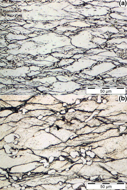

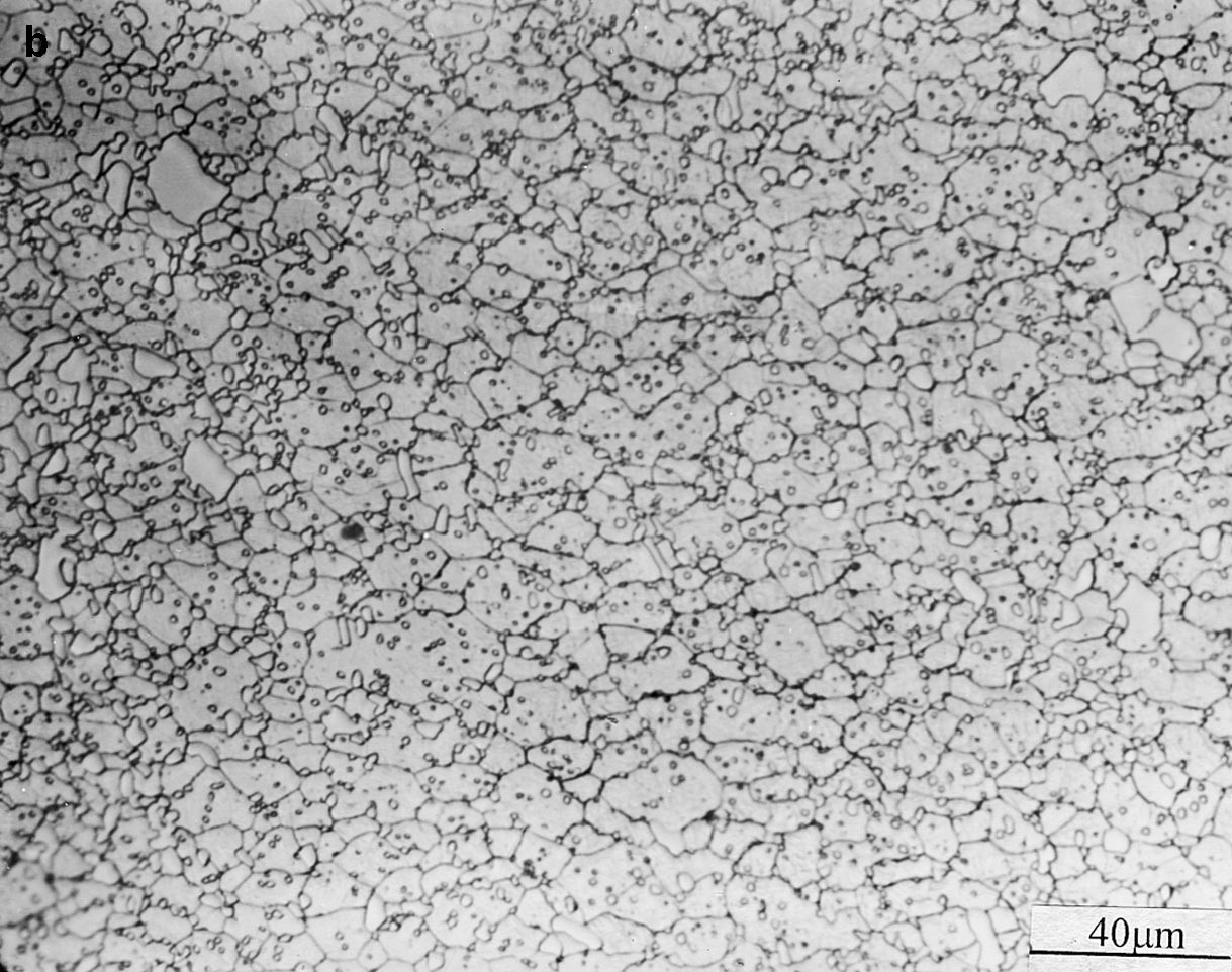

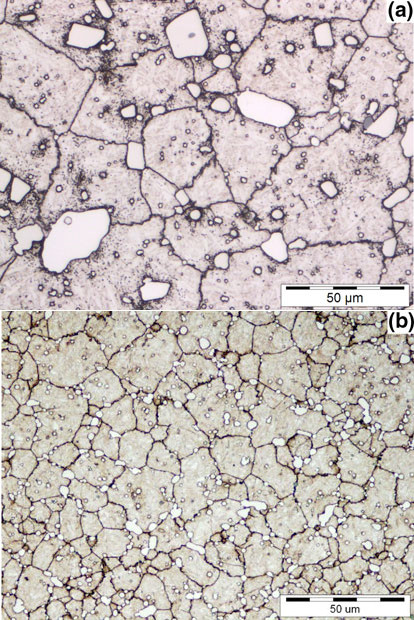

Grain Growth
There is one area where high alloy steels have an advantage during forging and that is grain size. Because low alloy steels do not have any carbides present at forging temperature, the grains are free to grow, and can do so at a relatively rapid rate. The steel can minimize its internal energy by growing the grains, because grain boundaries are high energy areas, and grain growth leads to a minimization of grain boundary area:
High alloy steels have carbides present at high temperature that “pin” grains and do not allow them to grow:
However, grain growth will still occur in high alloy steels if given sufficient temperature and time. In part because grain growth still occurs, if slowly, in the presence of carbides. Grain growth also occurs because the carbides coarsen at high temperature leading to a lower density of pinning carbides. This effect was seen in the M42 micrographs shown before with the large increase in carbide size with excessive forging temperature. You can also see this effect in the micrographs below for T1 high speed steel which was forged from 1000°C (1825°F) where the grain boundaries are so fine they were not revealed in etching, compared with the same steel forged from 1150°C (2100°F) where grain boundaries are clearly visible:
T1 steel forged from 1000°C with a fine grain size (boundaries not visible). Image from [6]
T1 steel forged from 1150°C with larger grains. Image from [6]
Even the grain size in the T1 forged from 1150°C could not be called “large” due to the effect of the carbides. However, maintaining a small grain size is advantageous for the mechanical properties of the final product.

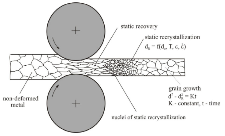

Grain Refinement
In industrial processing, grain size can be reduced through forging. This is because the steel sees a significant degree of strain to the steel. This leads to a “pancaking” of the grains and then re-formation of new smaller grains. After this process is repeated several times the grain size is reduced. You can read more about deformation and recrystallization in this article on cold forging. The only difference is that in hot working the process of deformation and recrystallization is more continuous because the steel is usually at a high enough temperature for recrystallization to occur. However, the degree of strain put into the steel during forging a blade is pretty small, so grain growth is much more likely. With low alloy steels excessive temperature should be avoided so that grain growth is reduced.
Image from [13]
High alloy steels are more difficult to forge because they have carbides present at high temperature that increase the stress required for forming the steel and decrease hot ductility. Excessively high temperatures in forging should be avoided because grain boundary melting and carbide coarsening can occur leading to poor hot ductility. Temperatures that are too high also leads to grain growth which is undesirable for the final mechanical properties. Too low temperatures can lead to ferrite and/or carbide precipitation which leads to poor ductility, which in combination with low temperatures leads to cracking. Some forging bladesmiths believe that high alloy steels need very high temperatures which will lead to problems. Instead forge from no higher than 2100°F, and in some cases lower is better. See steel datasheets for recommended forging temperatures for a given steel. If not available, look at similar steels for an idea of typical forging temperatures. Forging temperatures should be carefully optimized for ease in working and for the best possible mechanical properties in the final product.
