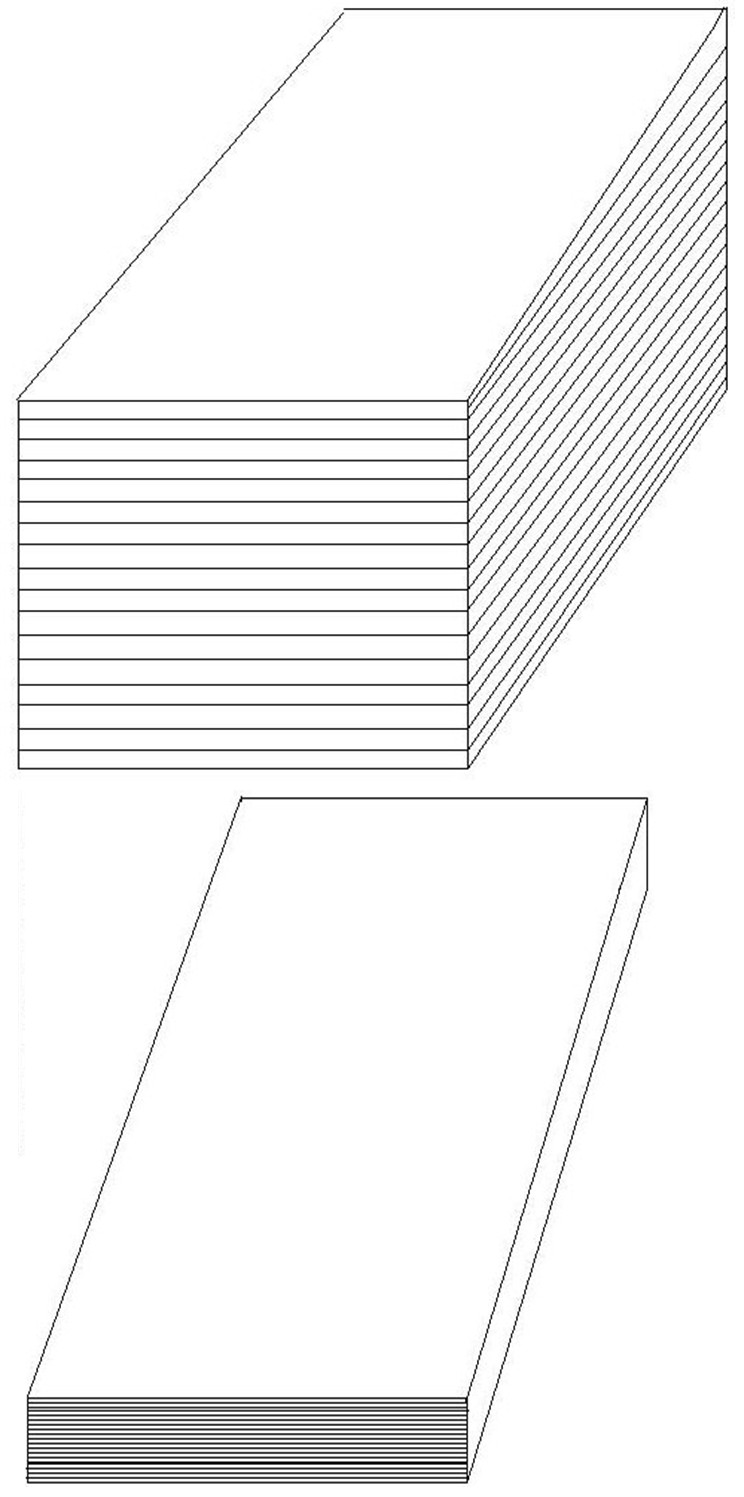

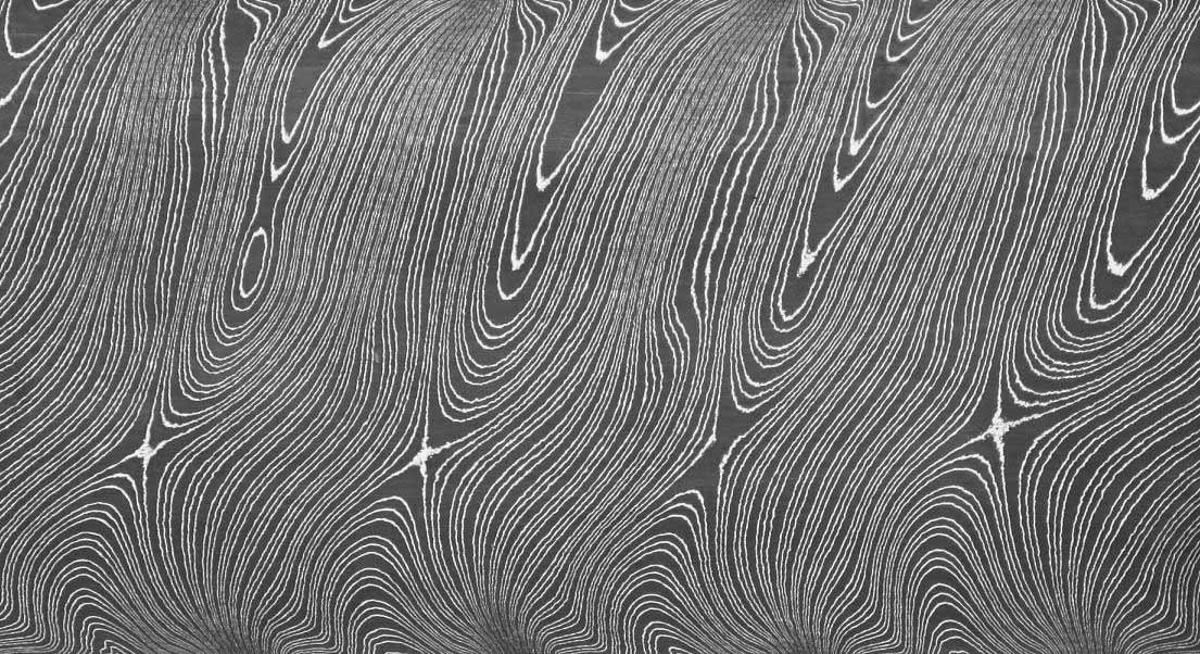

Conventional pattern-welded Damascus steel uses alternating layers of steel which will etch at different rates to provide contrast between the two different types. Layer counts can be modified by using thin stock, taller billets, or by cutting, stacking, and re-welding the billet.
If the steel is simply forged flat to be a knife it results in a “random” pattern. There are a variety of techniques that are used to give different patterns in the final piece which will not be covered in depth here. One simple patterning method is “twist” where the bar is forged round and twisted prior to forging flat again, which looks something like the following in the finished piece:

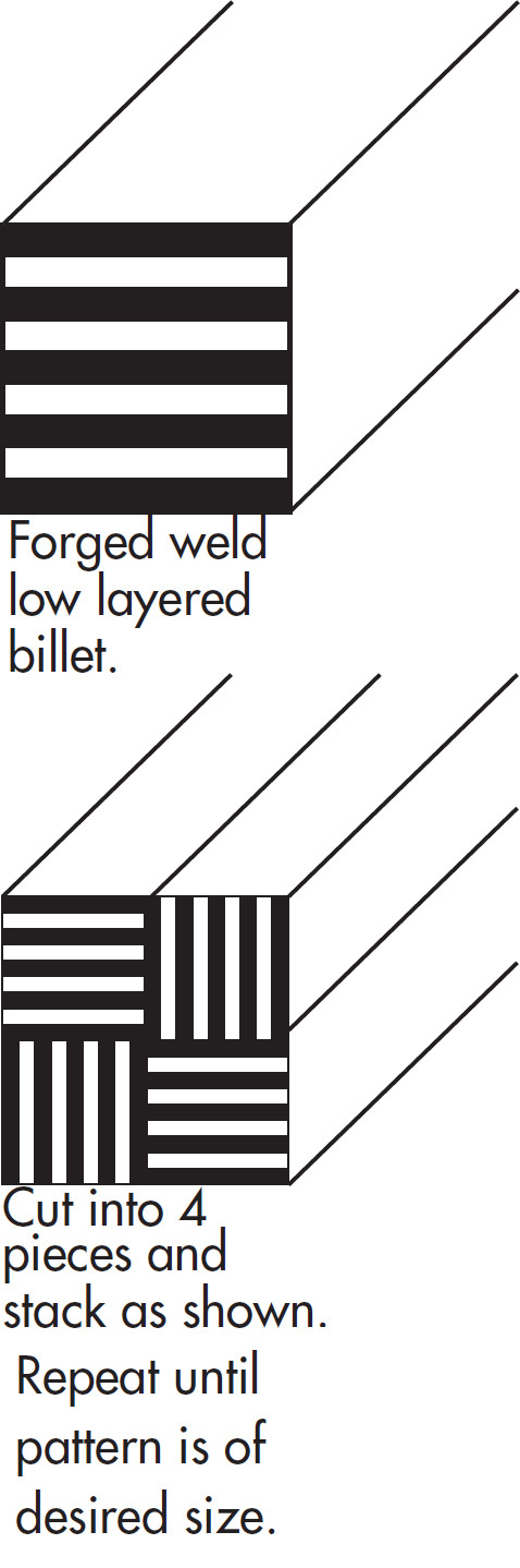

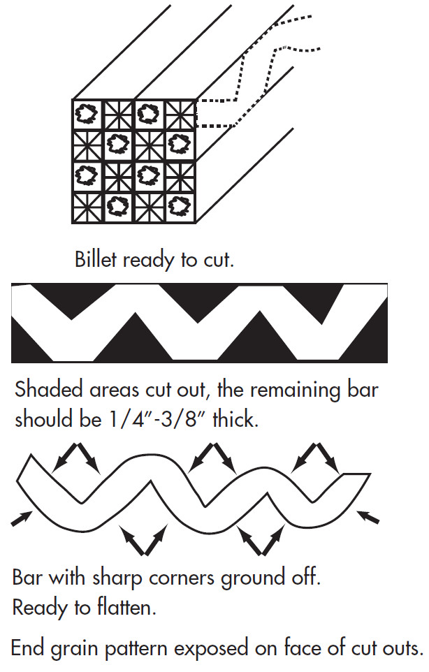

There are a range of techniques which rely on different designs on the end of the bar, and these patterning types are loosely called “Mosaic” patterns. These can range from the simple to the very complex. One simple pattern is “basketweave” where forged billets are re-stacked in contrasting directions:
Image adapted from [1]
Since the pattern is on the end of the bar it can be used in applications such as bolsters by simply slicing a piece off and using it as-is. When using mosaic patterns in a knife it is somewhat trickier because forging it to flat barstock would not be visible on the knife. If enough pieces are welded side by side a “loaf” can be made where slices are cut off to be the blade. However, different techniques can be used to bring the end pattern to the surface of the bar such as the “accordian” method:

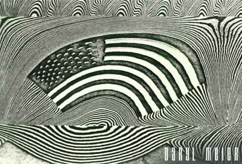

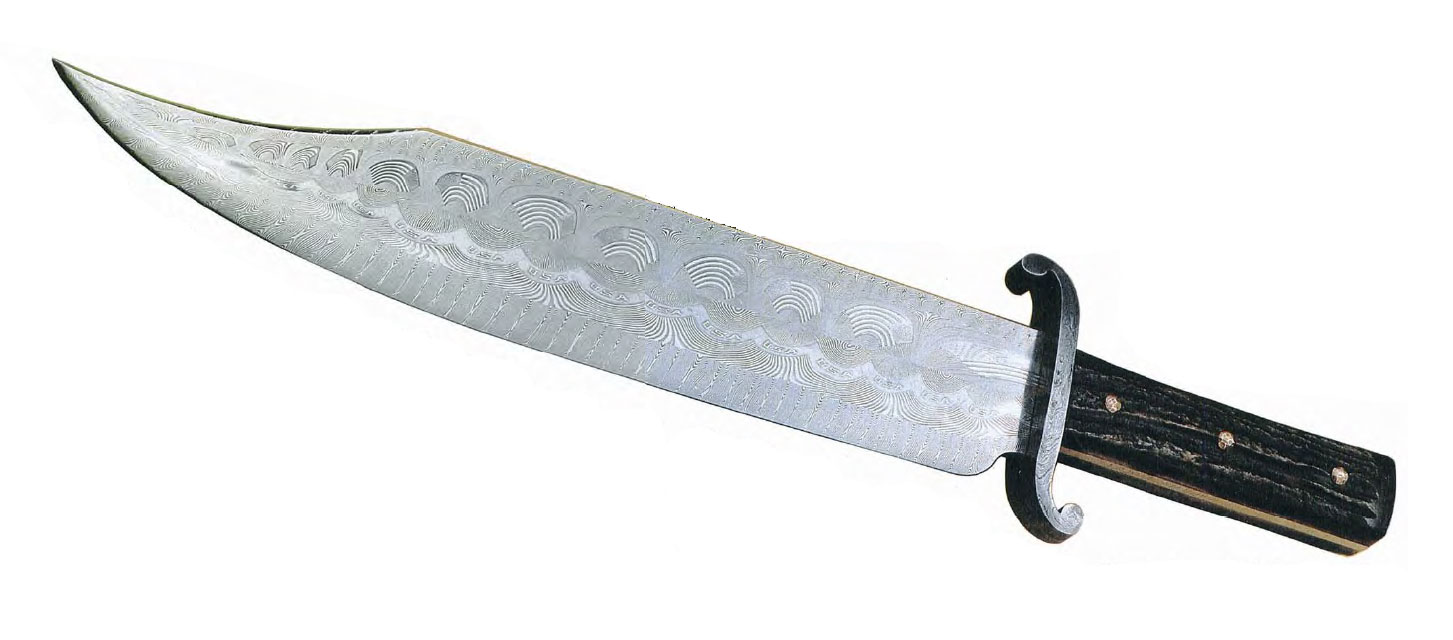

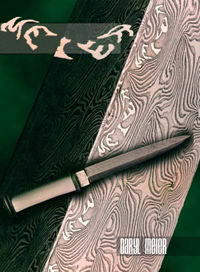

By the early 1990’s patterning techniques could be quite advanced, such as the Daryl Meier flag bowie presented to George H.W. Bush at the White House in 1990. This impressive piece had 50 stars in each of the 13 flags, and the flags were the appropriate orientation on both sides of the blade. Each of the 50 stars has five points. Meier told me that he put in about 800 hours into the knife.
Image from [4]
The knife was produced from “multi-bar” Damascus which you can see with the different sections, the bottom being a twist pattern, above that the “USA” section, then the flags, and finally another twist Damascus bar. Below you can see a closeup of one of the flags in the knife.
Image from [3]

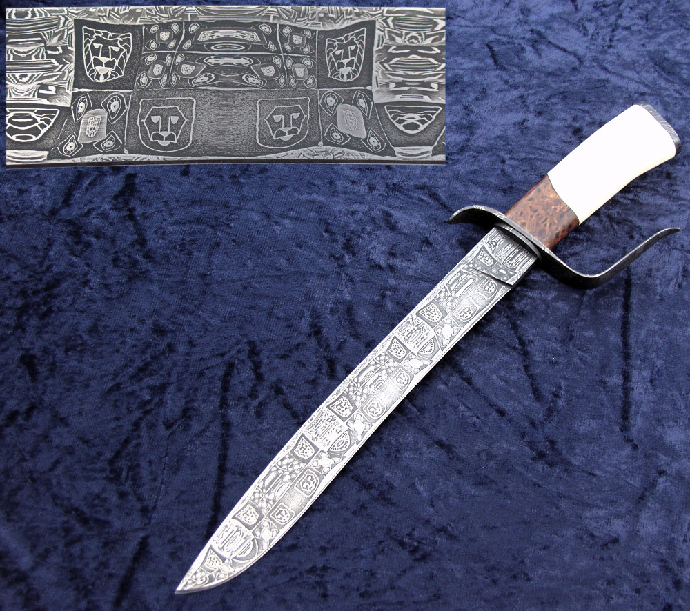

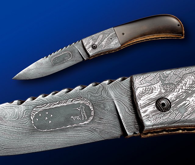

Another example of “picture” Damascus is the Hunter’s Dream landscape by Steve Schwarzer, produced in 1993:
Image from [5]
Both the stars in the flag produced by Meier and the hunter scene produced by Schwarzer used wire EDM blocks to produce the images. This requires two large blocks of steel in contrasting materials where a male and female block are produced so that once mated they can be forged to the final solid piece. Once etched the two different materials will be different colors so that the image is visible. Wire EDM and large blocks of steel are very expensive so this method has never had particularly widespread use.

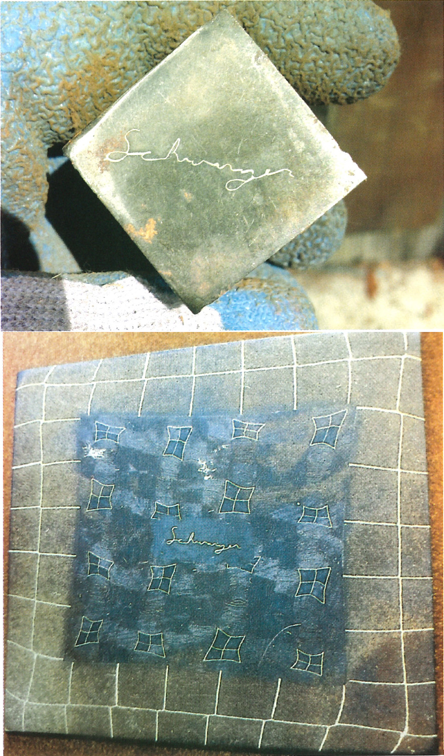

In the mid-1980’s, Steve Schwarzer was presenting on Damascus steel at a Jim Batson hammer-in. Gary Runyon was working for Allegheny Technology and had access to nickel powder. Runyon was attempting to get nickel powder to stick to cable to produce a nickel-infused cable Damascus. Schwarzer suggested that he put it in a piece of pipe so that the powder could not escape. In the early 90’s Schwarzer had his signature cut out with wire EDM and was attempting to stuff thin nickel sheet around the signature but it was not working. He contacted Runyon to acquire nickel powder and poured that around the wire-cut signature instead.
Image from [6]

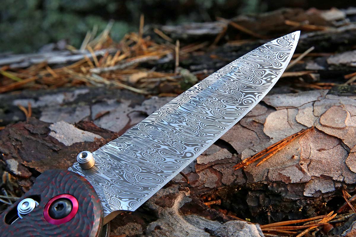

Pelle Billgren was the CEO of Söderfors [7], a division of Erasteel, a producer of powder metallurgy steel. I wrote about the history of powder metallurgy steel in this article. Billgren visited bladesmith Kay Embretsen who produced Damascus steel using traditional methods. They decided together to develop a method using the powder metallurgy steel to produce a Damascus steel product. This method relies on “hot isostatic pressing” of two or more steel powders to produce relatively large billets in different patterns. They submitted a patent application in Sweden in the beginning of 1994 [8]. This product was branded as Damasteel and is still sold today.
Benchmade Knife with a Damasteel Odin Heim blade. Image from [9]

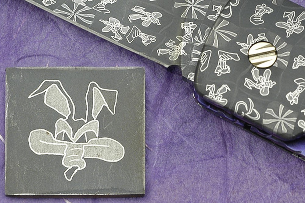

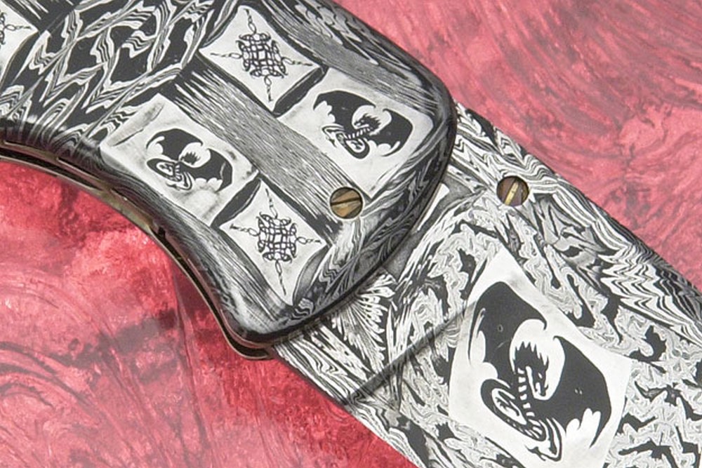

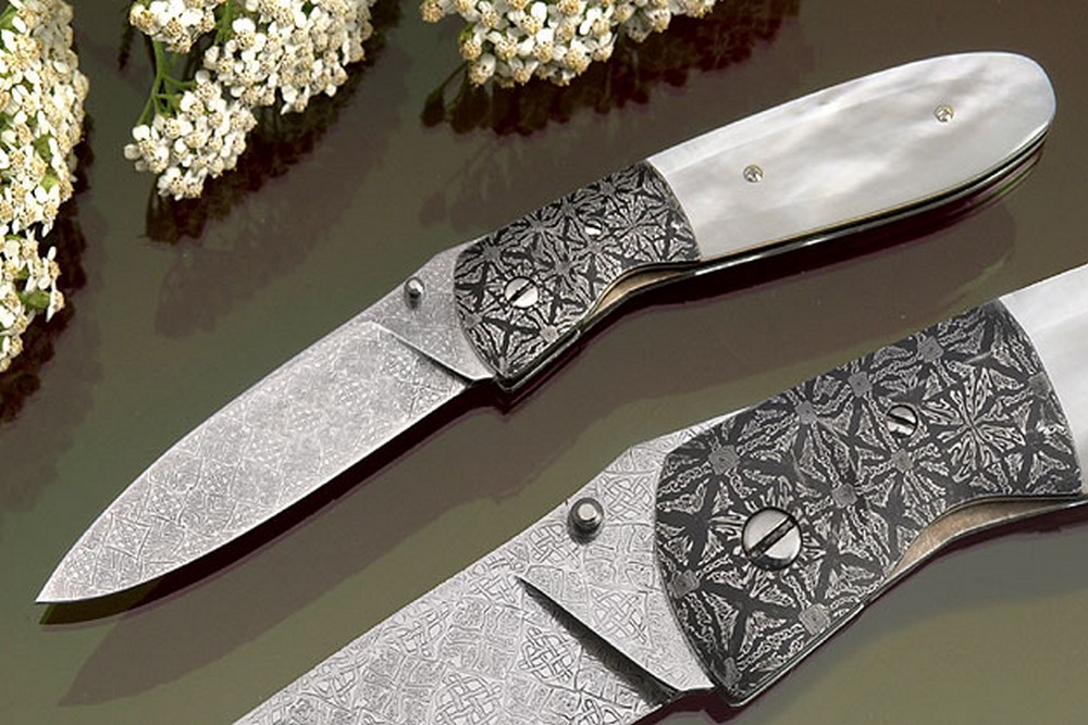

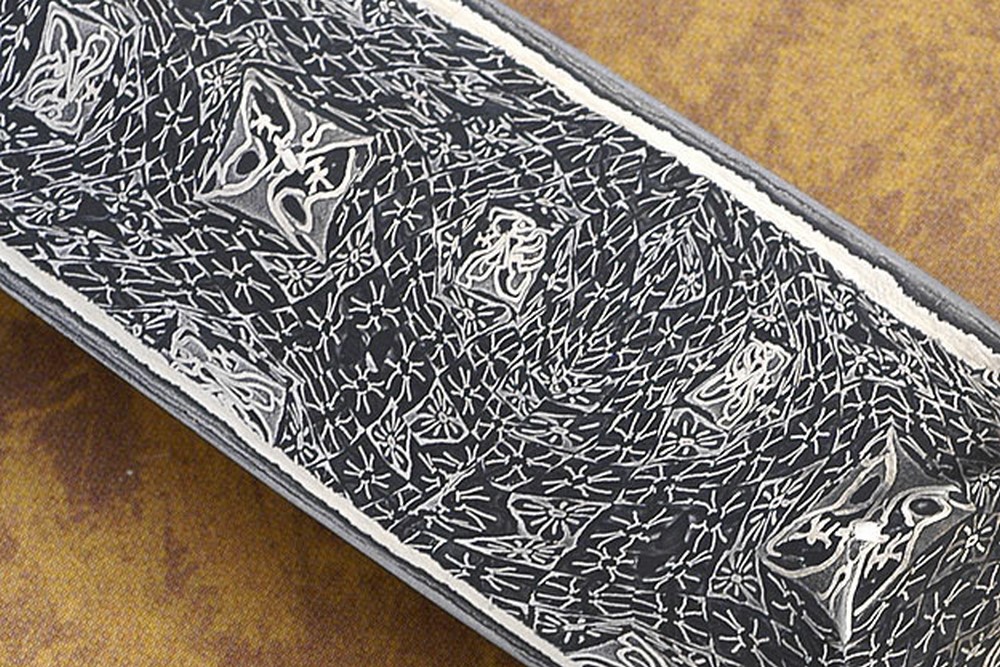

Hank Knickmeyer is another USA bladesmith that started using powder in the early 1990’s. Knickmeyer had heard about the use of powder from Steve Schwarzer and Daryl Meier. Knickmeyer credits Daryl Meier for teaching him many patterning techniques when he got started with Damascus steel. Knickmeyer was aware of the wire EDM work being done by Meier and Schwarzer but felt it was too expensive to be worth it. Knickmeyer had been experimenting with the use of different steel shapes and odd pieces in canister Damascus but needed a filler in between the pieces. He started with steel “sandblasting grit” to fill in the pieces. Hank says that he is most proud of the way that he used “distortion” of the bars of steel as he forged them to make unique and interesting patterns. Hank told me that he presented the use of this powder method at the 1994 ABANA conference in St. Louis. He suggested that I attempt to find a list of presenters from that conference to check his dates. The summary of the 1994 conference did not list Knickmeyer’s name though it was a summary of the highlights, not a full list of presenters. So if powder Damascus was presented there it apparently wasn’t a highlight (Ha!). I did find, however, that Knickmeyer presented at the 1995 conference of the Florida chapter of ABANA where he discussed mosaic Damascus.
Hank Knickmeyer “Butterflies and Flowers” Damascus steel in the Best Collaboration knife at the 2008 Blade Show. Image from BladeGallery [10]

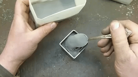

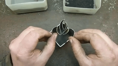

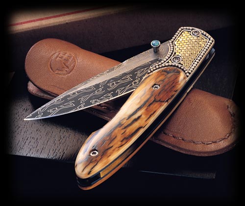

Devin Thomas used long pieces of nickel sheet to form different shapes and then fill them with powder. This provided a cheaper method than the use of wire EDM blocks for producing images. Relatively intricate designs can be produced this way without expensive wire EDM.
Gifs created from YouTube video [12]
A Knife produced by William Henry Knives (circa 2000) which was one of four pieces commissioned by Billy F. Gibbons of ZZ Top. The Damascus steel was produced by Devin Thomas using nickel sheet and steel powder which has the letters “ZZ TOP” forwards and backwards.

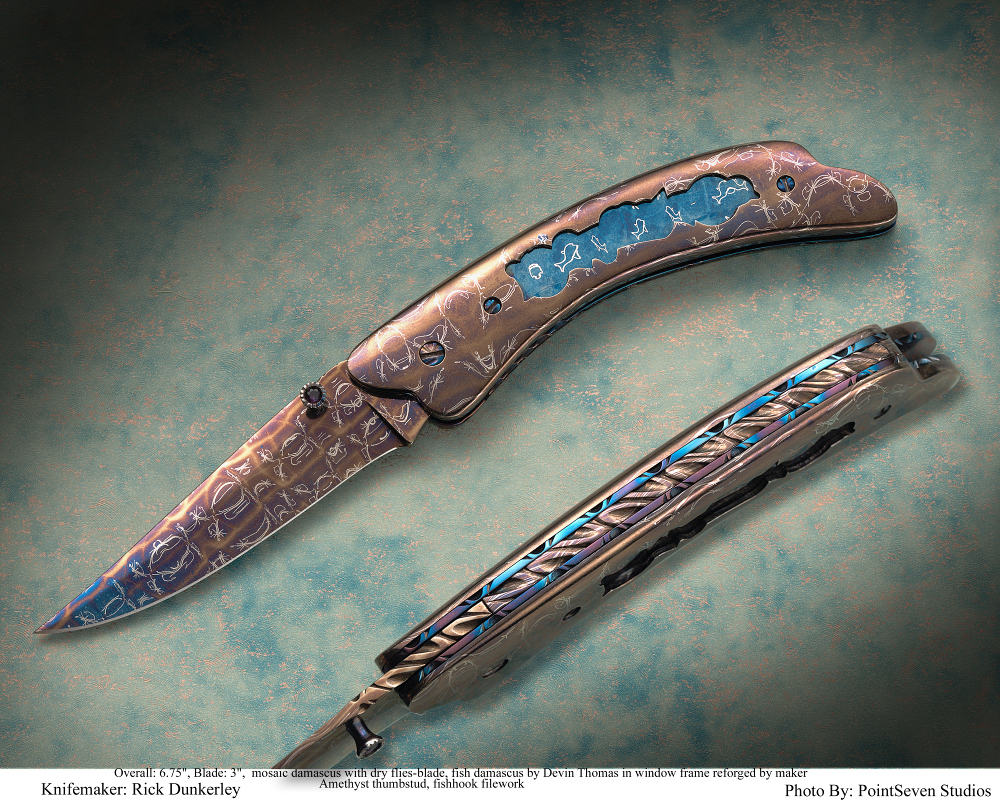

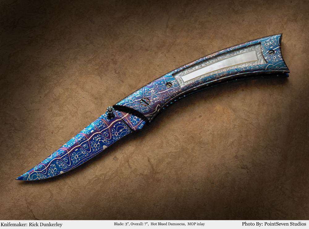

Devin made a piece of Damascus with a fish in it using his nickel sheet and powder method and showed it at Rick Dunkerley’s hammer-in in 1997. Dunkerley is one of the original members of the “Montana Mafia” which included Shane Taylor, Barry Gallagher, and Wade Colter. The four had been producing a range of different mosaic Damascus steel patterns and the use of powder offered new possibilities. At Dunkerley’s 1998 hammer-in he presented how to produce mosaic Damascus using nickel sheet and powder. Rick Dunkerley produced a knife for the 1999 Blade show using powder steel and nickel sheet for the Damascus. At that time Dunkerley only knew of one other person who had produced a knife using powder (Schwarzer). So despite the use of powder by Schwarzer and Knickmeyer in the early to mid-90’s, it hadn’t really begun to build in popularity until about 1998 or 1999.
Dunkerley’s first powder steel Damascus knife. Image provided by Eric Eggly of PointSeven Studios
Another powder Damascus knife produced by Dunkerley. The inset piece in the handle is fish Damascus produced by Devin Thomas described earlier in the article. Image provided by Eric Eggly of PointSeven Studios.

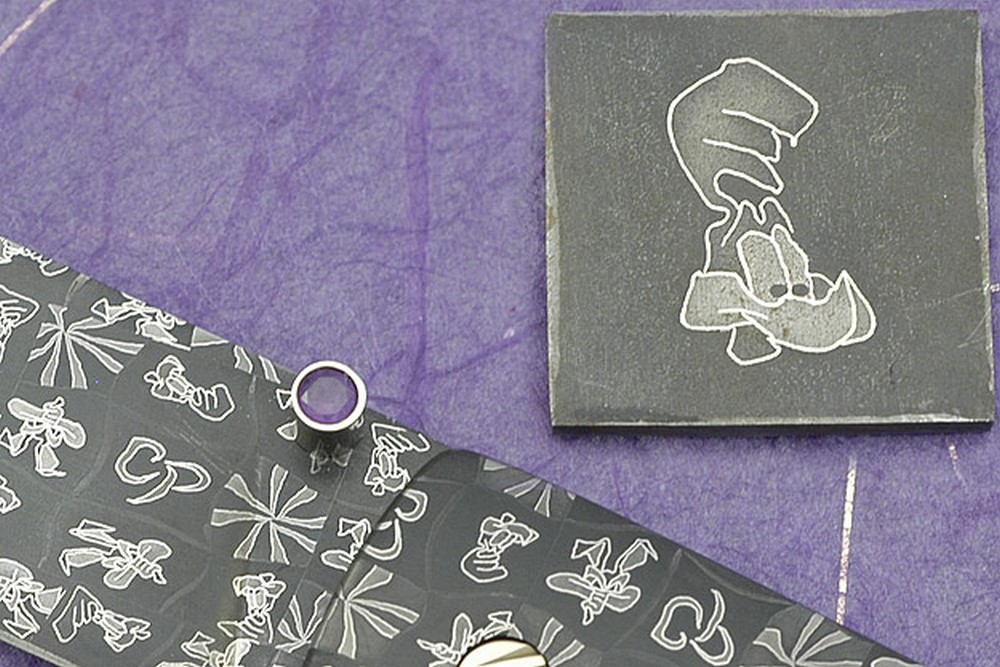

Matt Diskin saw a presentation of powder Damascus produced with powder and thin sheets and first tried using a similar method. However, Diskin had learned CAD in college and was familiar with laser cutting and waterjet methods. He used laser cutting to cut shapes out of sheet steel and then stacked them on top of each other and then filled that with powder. Matt tells me that he first produced steel using an elephant that he cut out. Because of the much lower cost of this method when compared with wire EDM other makers were interested like Steve Schwarzer and Shane Taylor. Diskin produced plates for several of those makers. Diskin’s favorite was Shane Taylor who did interesting and unique images like dragons which you can see below:
Image from BladeGallery [14]
