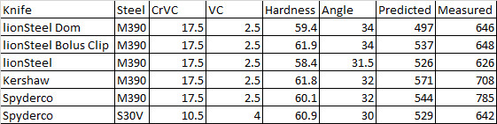

Independent M390 CATRA Tests
To see how the equation is doing with predictions of production knives I compared the estimated edge retention with the results of these new M390 tests:

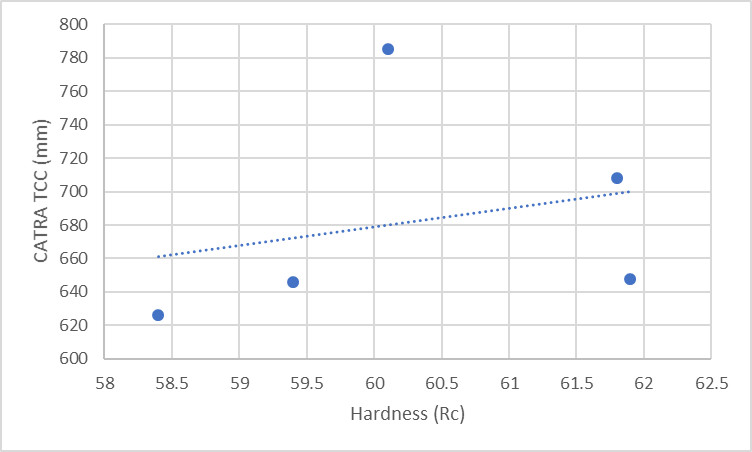

There are good examples of experimental scatter here. The three lionSteel knives performed very similarly despite having some small differences in hardness and measured edge angle. The Kershaw and Spyderco M390 knives performed a bit better, perhaps because of a bit higher hardness when at the same edge angle. The Spyderco M390 knife oddly outperformed all of the others at 785 mm, which I attribute to experimental scatter. However, it could be that thickness behind the edge is the differentiating factor between lionSteel, Kershaw, and Spyderco knives. Thickness behind the edge measurements are not available in the reports.
Comparing the two Spyderco knives, there is a significant jump between S30V and M390, though that is also a comparison with the outlier M390 result higher than the rest. But if the comparison is made with the Kershaw M390 knife instead it still appears that M390 has better edge retention than S30V, which is expected.
Hardness comparisons are a bit more challenging since the comparisons are primarily between different knives. We must not confuse comparisons between different knives with different edge profiles, thicknesses etc as being tests of the steel or hardness only. There are extra confounding variables. I don’t know if we can necessarily compare the hardness trend between the lionSteel, Kershaw, and Spyderco M390 knives due to the geometry differences between them. There is still a trend with hardness but it’s hard to tell if the geometry differences or experimental scatter are drowning it out:
Prediction vs Measurements
Across the board the predicted CATRA measurement is lower than what was measured, averaging 142 mm lower, or 122 mm if the Spyderco M390 knife is ignored. This is somewhat annoying because I was not sure what the difference could be attributed to. Possibilities include:
- Thickness behind the edge – The edge thickness was not measured either in the original dataset I used or in these new tests so comparisons could not be made. It could be that these tested knives are thinner than the knives used in the dataset, which were primarily simple rectangular test knives, not consumer pocket knives.
- Sharpening – The new tests were performed with knives sharpened by CATRA with their special sharpener which they claim leads to superior edge retention. Edge finish did not show much effect in the previous tests on 154CM knives, but I speculated in that article that the diamond sharpening plates used is the reason behind the flat trend, because others have reported a strong effect of edge finish on slicing edge retention. Diamond plates have been reported to lead to a coarse edge regardless of grit size. Typically coarser grits lead to better slicing edge retention.
- Experimental scatter – As pointed out in the above analysis, values can vary somewhat. If the knives were re-tested they would have a slightly different result. However, the knives here have a consistent delta with the prediction and it is unlikely that all of them would randomly be low.
- Stroke length of test – I was not particularly satisfied by the three possibilities listed above, and then knifemaker Shawn Houston pointed out an important detail to me – CATRA used a 25 mm stroke length because these were short pocket knives. The more typical stroke length is 40 mm which is what was used in the entire dataset that became my predictive equation. In the CATRA report it says, “The normal test is for the blade to be assessed over a 40 mm cutting stroke; however, due to the size of the blade this was reduced to 25 mm and the results factored to give an equivalent performance result. Factoring is based on a test data obtained from a single straight blade where we are able to obtain data for 25 a 40 mm cycles on the same edge.” Obviously a single test knife is not sufficient for developing a “factor” to convert from 25 to 40 mm, as that factor would change based on steel tested and especially edge angle. In an email to Shawn, a representative of CATRA actually said something similar: “I must strongly advise you not to compare 40 mm test results with 25 mm test ones even by using a multiplier. Tests carried out by CATRA show that due to the dynamic movements of the 3 slides operating during the cutting process this ratio changes depending on the actual cut level.”
Therefore my opinion is that the difference between the predictions and experimental values are due to the difference in stroke length of the test. The predictive equation is not perfect though I have confidence in it as a relative comparison (higher hardness steel with more carbide at a lower edge angle will cut better). However, the source of the consistent delta between the prediction and these experiments was curious enough to warrant a little investigation.

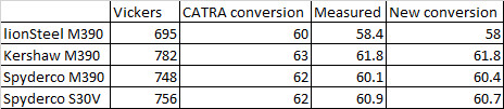

CATRA measured both Vickers and Rockwell hardness on the knives, apparently because they felt that Vickers would be more accurate. They pointed out that the Rc values were about 1 point lower than the values obtained from converting Vickers to Rc. However, conversions between different hardness tests is not an exact science. In an article on high alloy tool steels, for example, it was found that the ASTM conversion scale can be off somewhat [1]. They proposed a new equation of Vickers = 111*exp(0.0316*HRC). Below is a comparison between the hardness as CATRA converted it and the proposed improved conversion in the cited article. Using the new conversion there is very little difference between Vickers and Rockwell C. Either test appears to be relatively consistent.

Not really sure what algorithm CATRA is using for the Hv/Hrc conversions, but I noticed it was high a few months ago. Although I do feel the Vickers is a more accurate reading, that is lost if you err the conversion. I have been using Taylors table at http://www.taylorspecialsteels.co.uk/pages/main/conchart.htm and it seems to line up very close with your algorithm. I sent a blade (the Dom you reference above) that Peter’s had tested at 59.5Hrc and the Vickers came back with 722Hv; which via Taylors is @59.4Hrc and the algorithm above rates 59.26Hrc.
