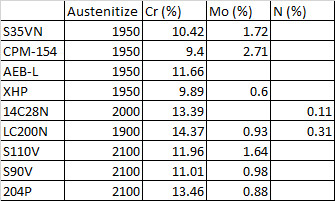

For each of the corrosion resistance experiments that I performed I started with ~1/8″ starting stock and cut out 1 x 1.5 inch pieces. Each was wrapped in heat treating foil and austenitized in my Evenheat furnace for 15-30 minutes depending on the steel. The pieces were quenched between aluminum plates and given a cryo treatment in liquid ntirogen, then tempered twice for two hours at 400°F. The austenitizing temperature selected for each steel is shown below along with the ThermoCalc-estimated Cr, Mo, and N in solution. The exception is CPM-154 which uses the Cr solution measured experimentally in this article. Each piece was then ground and finished to 400 grit. With corrosion testing of materials the steel is often mirror polished because scratches can reduce corrosion resistance. That helps with making it a test of the material only rather than the finish. However, I decided to use a more practical finish that would better represent the state of consumer knives.
You can see that Cr in solution ranges from 9.4 to 14.4%, Mo from 0 to 2.7%, and N from 0 to 0.31%. These steels were selected to have these wide ranges so that the effect of the different alloy elements could be evaluated.

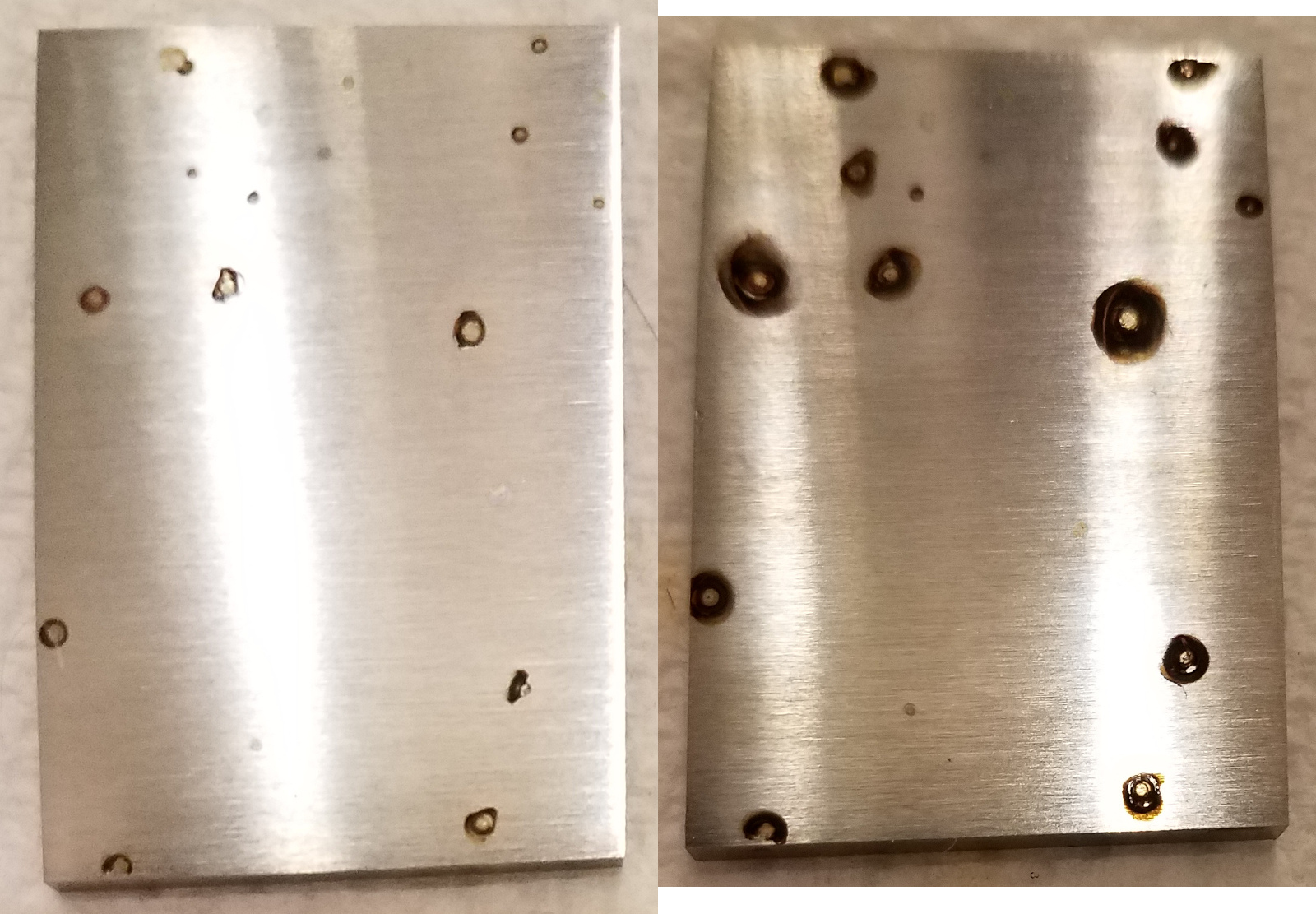

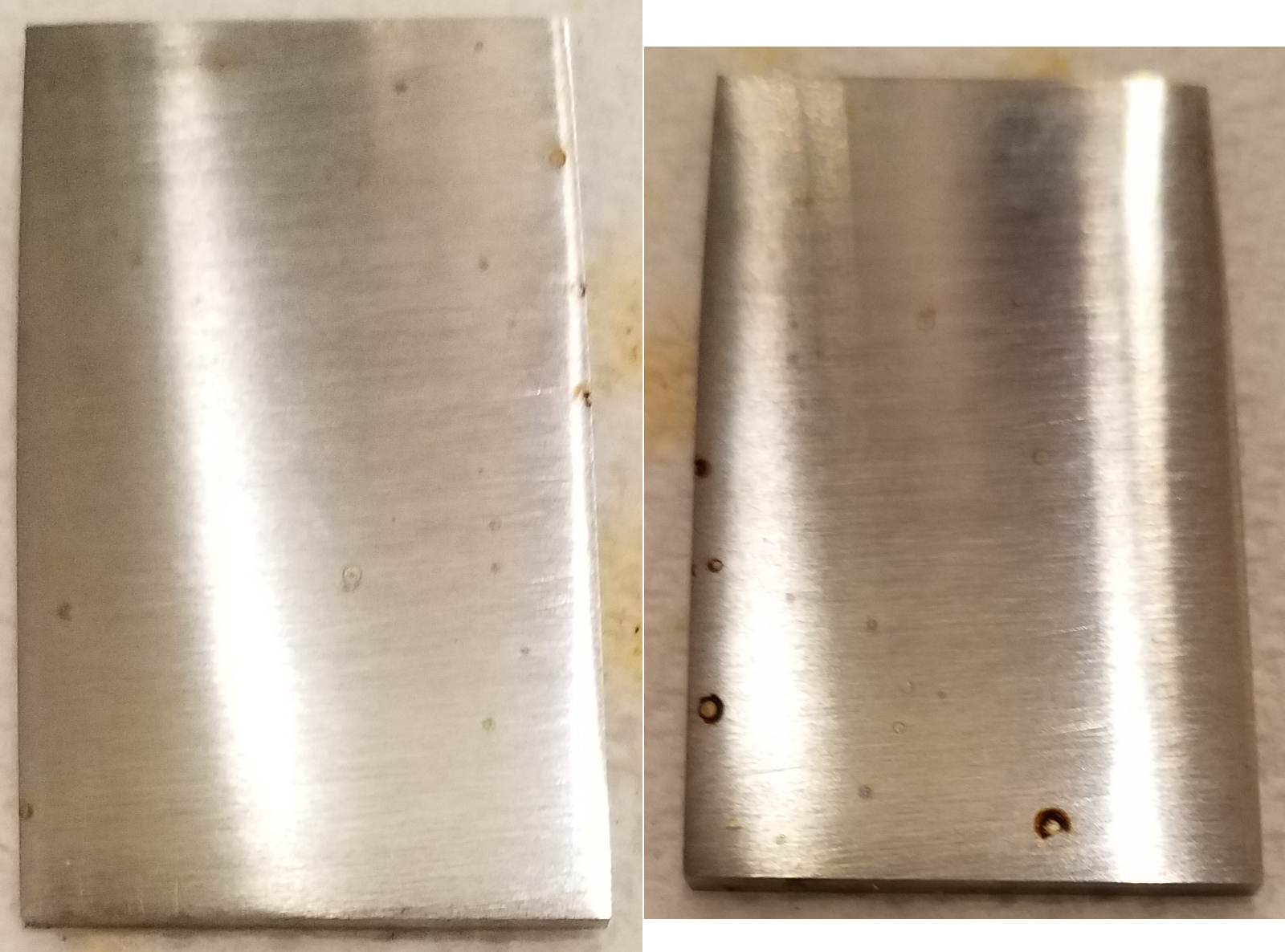

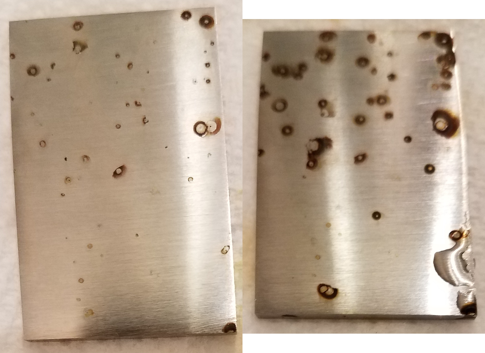

I did not continue to test XHP because it did so poorly with water. I next tested the same steels (apart from XHP) with a 3.5% saltwater solution, which is a similar salt content to seawater. However, differentiating between the different steels was somewhat difficult. LC200N did the best, 14C28N was second best, and AEB-L was last but differentiating between S35VN and CPM-154 was difficult. Significant rusting was seen after only 12 hours apart from LC200N which saw no corrosion. So I decided to reduce the salt to 1% and perform the experiment with a few more steels (now the full matrix shown above) to better differentiate between the different grades. Every 8 hours I cleaned the samples, photographed them, and then sprayed them with the 1% saltwater spray again. Here are the specimens, after 24 hours on the left and 48 hours on the right:

The Mo-free AEB-L had relatively poor corrosion resistance when compared with these other steels. 14C28N had much better corrosion resistance than AEB-L. 14C28N was designed by Sandvik to have improved corrosion resistance vs their 13C26 which is identical to AEB-L. The 14C28N was designed to have much more Cr in solution than AEB-L which is why its corrosion resistance is so much better. S110V was also found to have improved corrosion resistance when compared to its predecessor, S90V. No corrosion was observed with LC200N due to its high Cr in solution in combination with Mo and N. 204P and presumably also M390/20CV has very good corrosion resistance due to its high Cr in solution in combination with Mo and W. CPM-154 has decent corrosion resistance due to the high Mo in solution despite its relatively low Cr in solution.

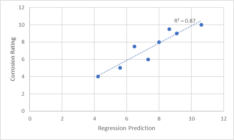

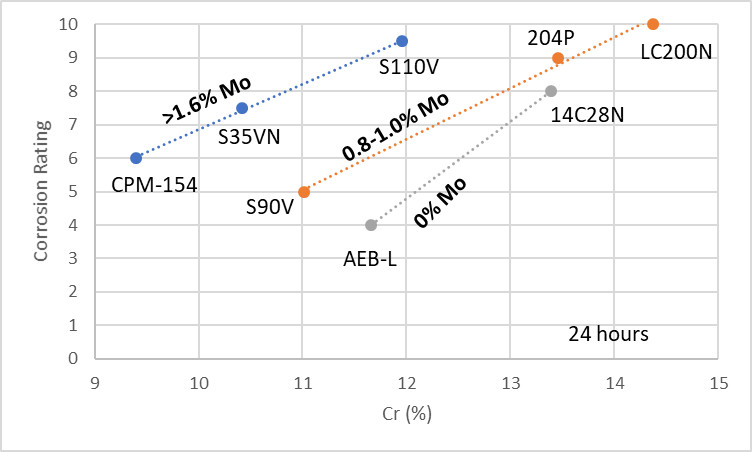

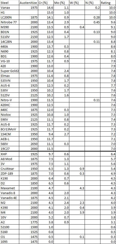

Similar to the method used by Carpenter in development of XHP [2], I assigned a rating from 1 to 10 of the surface of each specimen, where 10 means no visible rust, 9 means small light spots, 8 means easily visible rust spots, 7 means the rust spots have grown to be “medium-small,” 6 means 5-10% covered, 5 means 10-20% covered, 4 means 20-40% covered, 3 means 40-60% covered, 2 means 60-80% covered, and 1 means 80%+ covered with rust. In some cases I gave a 0.5 addition if I had difficulty assigning one of the values. I then plotted the result vs chromium in solution and got the following result:
There was a strong effect of both chromium and molybdenum on corrosion resistance. Whether there is an effect of nitrogen is somewhat less clear. The 14C28N steel seems to be closer to the 0.6-1.0% Mo steels than AEB-L and that may be from the ntirogen addition. But LC200N has such high Cr in solution so it is hard to separate out the nitrogen effect leaving 14C28N as our only datapoint. CPM-154 is on the same trend line as S110V and S35VN despite its significantly higher Mo in solution (~2.7%), which may mean either the Mo effect is not as strong with low Cr in solution or perhaps that the effect of Mo is saturated at some amount greater than 1%. This makes sense as the chromium oxide layer is most important, and the Mo in solution supports the existing Cr-oxide layer. I calculated a regression for the effect of Cr and Mo in solution for the 24 hour data which was Rating = -13.6 + 1.528*Cr + 2.419*Mo, which provides a strong correlation:
Dividing the Mo coefficient by Cr (so that Cr is equal to 1) gives 1.6 for the 24 hour and 48 hour data. The 1.6 coefficient for Mo is much lower than the PREN equation, which is Cr + 3.3*Mo + 16*N. The 1.6 value for Mo is relatively similar to the coefficient I calculated to in the previous article. The PREN equation was derived for austenitic stainless steels that have very high Cr in solution (16%+) so the chromium oxide layer was relatively strong in all of them. So it makes sense that the behavior would be somewhat different for these knife steels where 15% Cr in solution is a very high number. Also PREN is from pitting resistance specifically, not necessarily for rust formation alone.
Tungsten is reported to have half of the contribution to molybdenum so it would have a coefficient of 0.8. And if we are generous and assume that the contribution of nitrogen is significant to 14C28N, that would give a coefficient of approximately 6 to nitrogen. So our final equation for predicting the effect of each alloying element in solution is Cr + 1.6*Mo + 0.8*W + 6*N.
Rating other Steels
I next used ThermoCalc to estimate the Cr, Mo, W, and N in solution for each steel and plugged those into the equation above. I assumed that the contribution of Mo, W, and N saturates at an overall contribution of 2.6%, corresponding to 1.6% Mo (1.6*1.6 = 2.6). Each of those elements supports the chromium oxide layer rather than replacing it so I grouped them together with this contribution. Using that equation I then normalized to a 10-point scale to provide a rating for each of the steels below. I don’t think these ratings are perfect but I think it is a reasonable approximation and is an improvement over the table in the previously published article. I have a solid line which is where I think the rough border is between “stainless” and “non-stainless” steel. Apart from XHP, ZDP-189 is also below the line.
I have not listed alternate names for each steel. For example, LC200N is also called Cronidur 30 and Z-Finit. M390 is also called 20CV and 204P. S90V is also called 420CV or 20CP. I do not differentiate between CPM and conventional steels with identical composition like 154CM and CPM-154. In some cases PM technology may make the alloy more evenly distributed for better corrosion resistance but this is not factored into a ThermoCalc estimate.

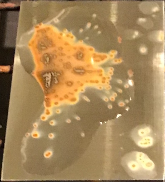

I am not sure if you are still monitoring this article for comments. I have a OKC SPL pack knife in magnacut. And observed some corrosion from putting it in the sheath wet from fresh water. I am thinking this is related to the oxide layer being interrupted from contact with the sheath and this being some form of crevices corrosion which stainless steels are susceptible to. I am wondering if the high corrosion resistant steels like magnacut and LC200 can be further differentiated by forcing crevice corrosion by putting some sort of intert material plastic or ceramic in contact with the steel in the test. As per above this has applications for knives in sheaths and also folding knives and knife handles. Cheers David
There are other factors more likely than some unknown problem with being in contact with leather.
I did some more corrosion testing on the knife with some other steels 3.5% salt water sprayed on for 8 hr then wiped off and then another spray for 3 hr before I stopped the test. The OKC SPL pack knife in magnacut was actually one of the worst stainless steels for corrosion. So I am thinking OKC have done something wrong with the heat treatment. I can send you some photos if you like. For reference the magnacut on this knife did about the same as 8cr14mov. S35vn only had one spot.
Because the old formula was scaled for 0-10 across a wide range of steels the meaning of the original formula is different. The formula to interchange between the two should be (spray rating/2.62816)+5.1744= new rating. You need to convert it I f you want to know based on the table what will happen your steel if you spray it over and over again. A normalized rating of 10 would be a 12.7 on the spray test, 9 is 10.1, 8 becomes 7.4, 7 is 4.8 and 6 is 2.2. Below 5 equates to negative numbers for the spray test. The formula for the normalized rating would be rating= 5.174+0.581(-8.9+Cr+y) where y=1.6Mo+.8W+6N with a maximum value of 2.6.
