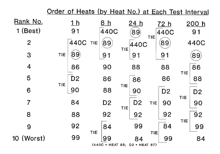

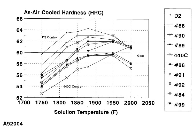

The researchers looked at a range of alloy combinations by producing 17 pound ingots in the laboratory which were then forged and tested [2]. They focused on hardness and corrosion resistance to find the optimal composition for the desired properties. Hardness was tested “as-quenched” after austenitizing at a range of temperatures from 1750-2000°F. The corrosion resistance of each steel was tested by machining a cone specimen and heat treating it by austenitizing at 25 minutes and air cooled. The specimens were then tested in a 95% relative humidity environment at 95°F for 1-200 hours. The samples were then rated for the percentage of the surface with visible rust. Results of the hardness and corrosion resistance tests are shown below:
Alloy codes 88, 90, 89, and 84 met the hardness target, though 90 and 84 had worse corrosion resistance than D2, and alloy 88 was only marginally better than D2. Alloy 91 had similar or superior corrosion resistance to 440C but did not meet the hardness target. Alloy 89, however, was similar to 440C in corrosion resistance and also had high hardness. The compositions of all of these alloys are not shown in the presentation but alloy 89 was similar to the final composition of 440XH.

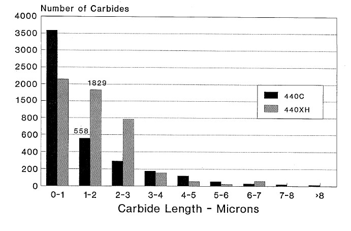

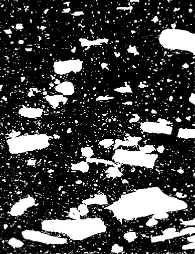

The relatively low toughness of 440XH is explained by comparing the microstructure between 440XH and 440C, where 440XH has significantly more carbide and much larger carbides:
Micrograph of 440C steel [2]
Micrograph of 440XH [2]

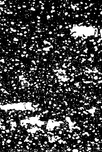

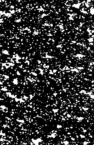

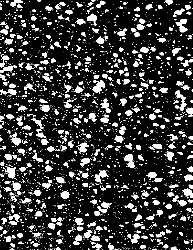

The relatively low toughness of 440XH somewhat limited the broad use of 440XH outside of applications that are limited by wear resistance. Therefore, a powder metallurgy version of 440XH was explored. The properties of the powder metallurgy version were also compared to powder metallurgy 440C, named 40CP. It was discovered that the toughness of 40CP was only marginally better than the conventional 440C, but the PM 440XH was actually found to be superior to 40CP:
To determine why the PM 440XH had superior toughness to PM 40CP, they compared the microstructure of the two steels:
PM 440C (40CP) [2]
PM 440XH (XHP) [2]
The microstructures look relatively different. The 40CP has more “clumping” of the carbides together with relatively oddly shaped carbides as a result. The PM 440XH has more spherical carbides that have a relatively large diameter for powder metallurgy, consistent with chromium carbides in PM steels. They measured the diameter of the carbides and did a full count of different carbide sizes. The 40CP has more of the largest carbides, which probably explains its poorer toughness:
Therefore the PM 440XH was found to have superior toughness, wear resistance, and hardness when compared to PM 440C (40CP), both with similar corrosion resistance. So it appears to be a superior choice overall.

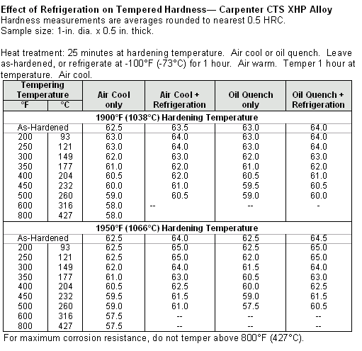

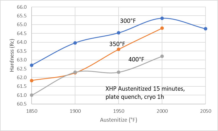

I did some limited heat treatment experiments with XHP, austenitizing for 15 minutes, plate quenched, liquid nitrogen for 1 hour, and then tempered twice for 2 hours. XHP can reach very high hardness values, up to about 65 Rc.
Those measured values are very close to those presented in the datasheet for XHP [4]:
