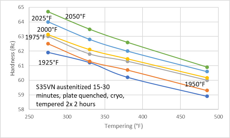

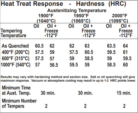

I heat treated a range of S35VN specimens using a 30 minute austenitize for 1925 and 1950°F, and 15 minutes for higher temperatures. The samples were then plate quenched, given a cryo treatment in liquid nitrogen, and then tempered twice for 2 hours each time. My heat treatment tests resulted in similar hardness to the datasheet, shown below:
S35VN has good potential hardness; it is capable of reaching at least 64 Rc. That should provide a good range of hardness values to the knifemaker.

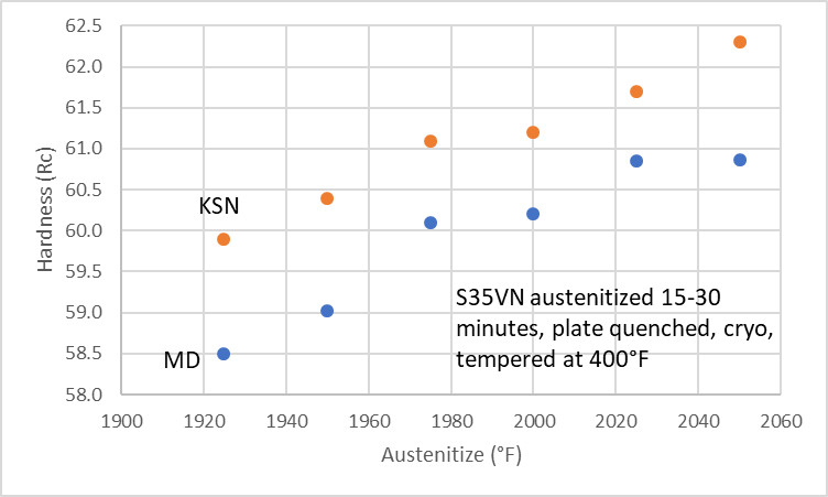

Knifemaker Michael Drinkwine heat treated and machined a set of S35VN specimens for toughness specimens for me. Each condition was tested with three specimens and averaged. One odd thing was that the specimens were consistently about 1 Rc lower in hardness than mine with the same heat treatment. Hardness was measured by me in both cases so it was not a difference in hardness tester. I am not sure what the reason for the offset was. Perhaps it was the result of a different heat of steel, or a difference in furnace, or cooling rate in quenching. It’s hard to know for sure without investigating it specifically.

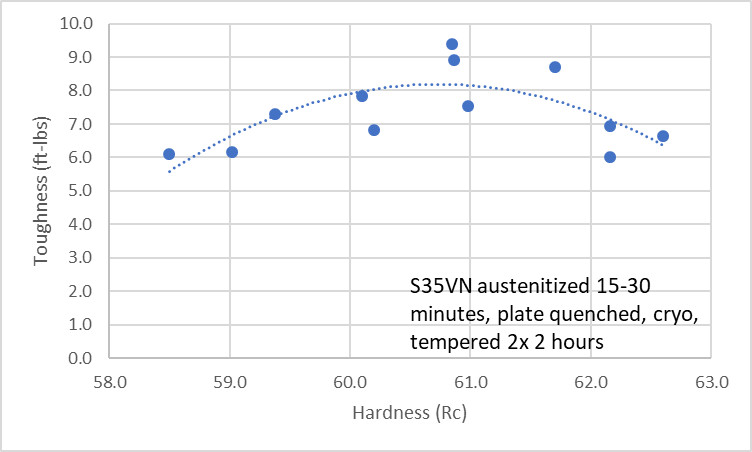

Looking at the trend of hardness vs toughness, the results are oddly flat, or perhaps with a peak around 61 Rc. This is somewhat unexpected because typically lower hardness means better toughness:

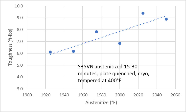

However, analyzing the trends of toughness shows us why the toughness ended up flat. First of all, increasing austenitizing temperature led to both increased hardness (see previous hardness comparison chart) and toughness. Similar behavior was also seen with S45VN where a refinement in the carbide structure was found to be the reason.
One specimen was tempered at 500°F which also led to a reduction in both hardness and toughness, possibly due to tempered martensite embrittlement, though it could be simply that the 500°F temper did not improve toughness relative to 400°F and statistical variation in toughness testing led to a slightly lower value.
So austenitizing in the upper end led to higher toughness. Tempering in the range of 300-400°F led to the best properties depending on desired hardness (lower tempering for higher hardness).

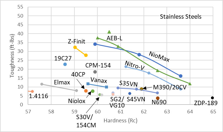

S35VN Toughness Comparisons

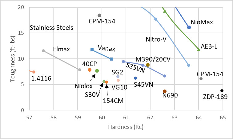

Note: The S35VN values below are slightly different than in previous charts as I re-measured the hardness of all of the toughness specimens after observing the hardness offset between Michael and myself.
Comparing with other PM stainless steels S35VN does very well, being similar to Vanax at a similar hardness. Vanax has an advantage for corrosion resistance while S35VN has the advantage in terms of potential hardness. It also has better toughness than S30V, S45VN, and Elmax. M390 and CPM-154 both have higher than expected toughness which is very intriguing. We will be looking into that more in the future.
