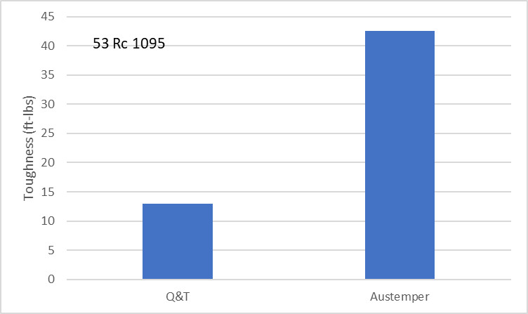

However, there are important differences, and greatly improved toughness has been reported in some studies, such as the following on 1095 cited in the ASM Handbooks:

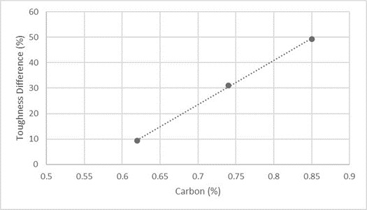

With high carbon martensite there is a switch in the type of martensite that forms, from “lath” martensite up to about 0.6% carbon to “plate” martensite at 1% carbon. And in between there are increasing amounts of plate martensite. Plate martensite has poor toughness and can even have microcracks within it which makes it undesirable.
A steel that has 1% carbon doesn’t necessarily have all of that carbon “in solution” in austenite because we can leave some carbide in the steel. The higher the temperature we austenitize, the more carbide dissolves and the higher carbon our austenite is. Learn about austenitizing in this article. It is the carbon content of the austenite that controls the formation of plate martensite during quenching. However, with low alloy steels with greater than about 0.85% carbon it is difficult to heat treat them without having at least 0.6% carbon in solution. You can read more about the toughness of low alloy knife steels in this article. With bainite, however, there is no “plate bainite” so with high carbon steels we often see the biggest jump in toughness. This was observed in previous research [1] where they found that the toughness difference between bainite and martensite increases with higher carbon content.
Another reason for the toughness difference with bainite is “tempered martensite embrittlement.” Bainite is typically lower in hardness than martensite tempered at 300-400°F. To match the hardness of bainite we have to temper in the range of 500°F or higher. This puts the steel in the embrittlement range where toughness is reduced from forming large carbide particles. So to compare bainite and martensite 1:1 at the same hardness it often requires tempering martensite in an unfavorable temperature range.

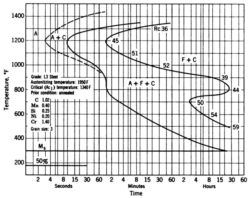

Fortunately for us there are TTT (Time-Temperature-Transformation) diagrams available on these three steels so that we can have some idea about how to austemper them for bainite.
There are several important aspects of these diagrams we will be using. One is the martensite start temperature (Ms) which is the temperature at which martensite begins to form. If we want full bainite we have to austemper above that temperature. If we austemper below Ms we can still form bainite but there will be some amount of martensite that is also formed. This isn’t necessarily bad, but we have to keep it in mind. The other important aspect of these diagrams is the start and finish points for bainite formation. For example, if we look at O1, austempering at 500°F the bainite formation begins at about 10 minutes and finishes at about 2 hours. So to have full bainite we need to austemper for at least 2 hours. You can hold it longer to ensure that the transformation is complete if you want without negatively affecting the steel. Continuing to hold at the austempering temperature after the transformation is complete will just mean more tempering of the bainite, but the hardness drop from tempering is relatively minor in bainite. If we don’t austemper long enough there will be some martensite that is formed in the remaining austenite during cooling to room temperature after the austemper. Adding a tempering step after austempering ensures there is no “untempered” martensite. Another aspect of the diagrams is that hardness measurements after austempering is listed to the right, such as 60 Rc for austempering O1 at 400°F, or 56 Rc for austempering at 500°F.
There are a couple complications of simply using the above diagrams, however. One is that the composition of steel can vary some from batch to batch or manufacturer to manufacturer. For example, the 1095 TTT diagram above is for 0.89% carbon 1095, which is actually outside of the accepted AISI range of carbon for 1095. If instead we had a higher carbon 1095 such as 1% carbon, the Ms temperature may be lower from more carbon in solution and the time for transformation is likely also shifted. Below is a TTT diagram for 1.14% carbon W1 which would also be just outside of the 1095 specification but on the high side.
Another complication is the austenitizing temperature as mentioned previously. A higher austenitizing temperature means more carbide is dissolved, higher carbon is in solution, and the Ms temperature is reduced. In some cases there is also grain growth with high austenitizing temperatures which increases “hardenability” which makes bainite formation take longer. As an extreme example below is the TTT diagram for 52100 austenitized at the very high temperature of 1950°F. The Ms temperature was reduced from ~475°F from a 1555°F austenitize to 300°F from 1950°F. And the time for transformation was increased from 15 minutes at 500°F to 15 hours by austenitizing so high.

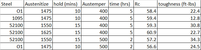

The Heat Treatments

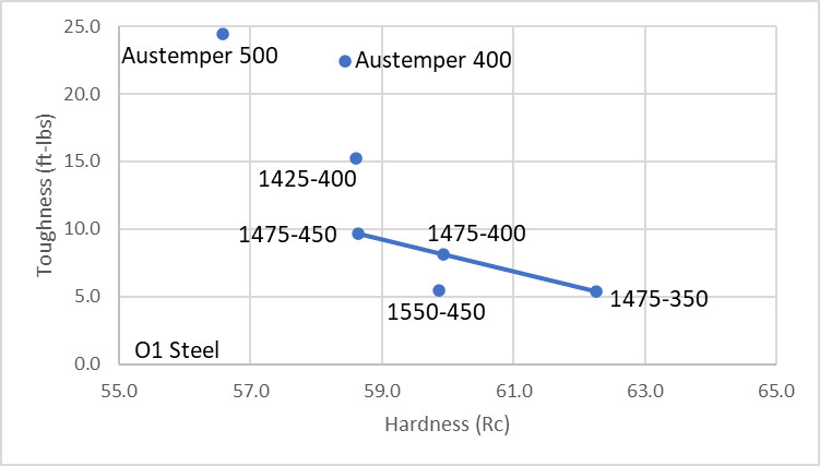

I did a range of heat treatments by austempering at 400 and 500°F. I wanted to do as many heat treatments as possible from the relatively low temperature of 400°F because knives need high hardness. There are not a lot of studies on austempering in this range when comparing toughness and other properties. The two different 400°F austempers on 52100 were done for the reasons explained in the previous section. These heat treatments were performed with an EvenHeat salt pot furnace using low temperature salts.

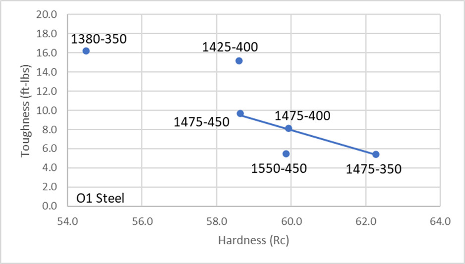

O1 Steel
So now we can compare the toughness that we got from these heat treatments with previous quench and temper treatments. Let’s start with O1; below are the previous Q&T treatments that I have done with the steel, some of these were previously reported in this article.
You can see that with previous heat treatments using a lower austenitizing temperature consistently led to improved toughness at comparable hardness, with 1425-400 leading to the best properties. Likely higher hardness could be obtained by combining the 1425°F austenitize with reduced tempering such as 300-350°F. This is because of the reduction in plate martensite as explained previously. The 1380°F austenitize led to very low hardness with little improvement in toughness, however. The low hardness is probably from not fully austenitizing (some ferrite remained). I had austenitized for 30 minutes to try to overcome this, but at low temperatures it takes longer for the steel to heat through and longer for the austenite to form. But even if 60 minutes would do it, the 1380°F is probably dancing too close to the line. So now that we have our baseline established, let’s compare with the austempered conditions:
You can see that we successfully increased the toughness, even significantly above the 1425°F austenitize. This likely means that even the 1425°F austenitize led to some plate martensite. Another factor is the amount of carbide dissolved during austenitizing. The higher austenitize (1475°F) used when austempering means that we dissolved more carbide which may have also helped to improve toughness. The 58.4 Rc achieved with the 400°F austemper was somewhat lower than the hardness reported on the TTT (60 Rc), but the 500°F hardness was similar: 56.6 vs 56 Rc. Based on these hardness results I certainly wouldn’t austemper any higher than 400°F. Even 58.4 Rc is on the low end for most knives.

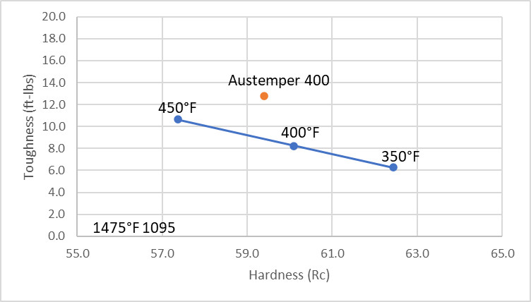

1095 Steel
With 1095 we also saw an improvement in toughness by austempering, but the toughness was much lower than with O1. In this case we had hardness somewhat higher than was reported on the TTT diagram for the 0.89% carbon steel but lower than for the 1.14% carbon W1, as we might expect.
I’m not sure why the toughness is so limited with this 1095 even with austempering. Perhaps a steel with better “cleanliness” or prior processing would lead to improved toughness. I can’t say without comparing different 1095 steels from different sources.

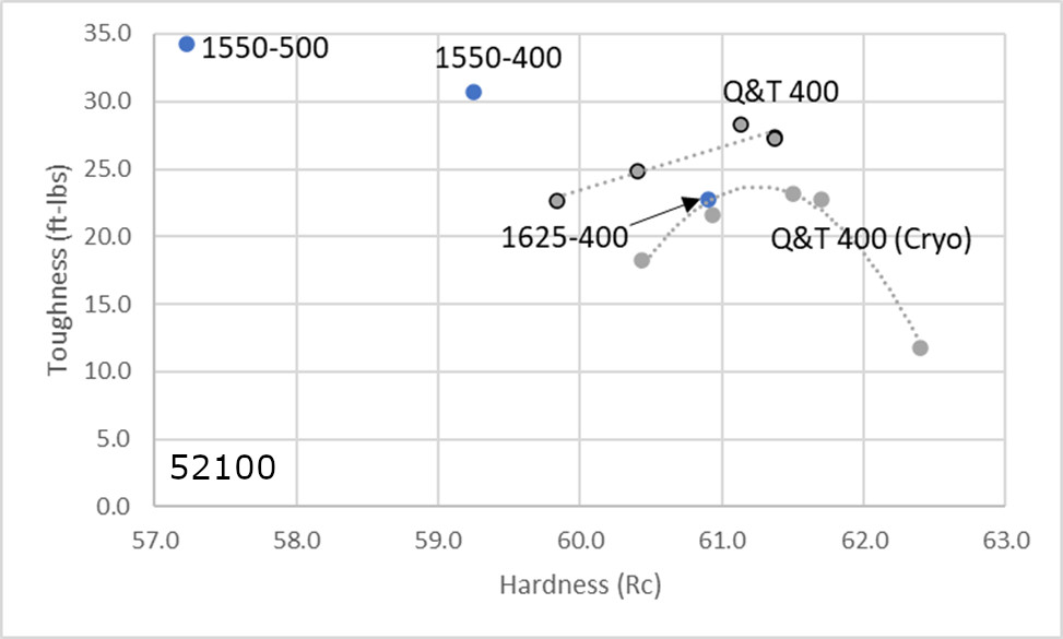

52100 Steel
With 52100 we had done a range of different heat treatment and toughness experiments which were reported in this article. There are a lot of different comparisons there but I have simplified the results to the best of the 52100 quench and temper (Q&T) results and overlaid the austempering results.
The toughness improvement with 52100 is much smaller than with the previous two steels. This seems to confirm the hypothesis that it is plate martensite that results in the difference in toughness between martensite and bainite. With the 1625-400 heat treatment the toughness is very similar to the Q&T conditions. Perhaps we got some grain growth with 1625°F limiting the toughness of the bainite. The 1550-400 and 1550-500 austemper conditions had reduced hardness but improved toughness vs the Q&T and 1625-400 conditions. These 1550°F heat treatments look very much like what would happen when tempering 52100 at 450-550°F if tempered martensite embrittlement was not a reality. So again this shows that bainite is best for intermediate hardness levels where with martensite it would require tempering in the embrittlement range.
The 1550-400 condition is somewhat interesting because we should have some tempered martensite present in that one, about 50% according to the TTT. However, the toughness appears similar to the 1550-500 condition with pure bainite if it was at higher hardness. So there does not appear to be an issue with austempering below Ms if higher hardness is desirable. It might be interesting to try low temperature austempering treatments at 350°F, and with other steels like O1. However, the data available for sub-Ms austempering is very limited and would require more experimentation.
