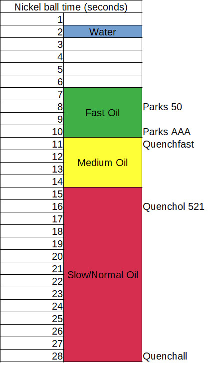

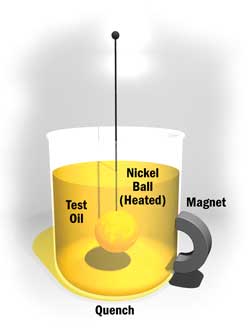

One common rating method for quench oils is the quenchometer “nickel ball” test. A 12 mm nickel ball is heated to 1620°F and then quenched into 200 ml of oil. Nickel reaches the Curie point at 670°F at which point it is attracted to a magnet.
The nickel ball is held on a string and a magnet placed outside of the beaker so that when the nickel ball becomes magnetic it is attracted to the side of the beaker. At that point the test is stopped and the time taken. A general ranking of different quenchants is found below:
Parks 50 and AAA are quite commonly known oils among knifemakers. Parks 50 is a 7-9 second oil, clearly in the “fast oil” category. Parks AAA is a medium-fast oil, taking 9-11 seconds with the nickel ball test. I bought my oils from Maxim but since then DuBois has an easy online store available for these oils.
Quenchfast and Quenchall are offered by McMaster-Carr as “11 second” (Quenchfast) and “28 second” (Quenchall) oils. I asked McMaster-Carr for more information on the oils but the sheet they sent me (hosted here) doesn’t have any more specific information on the nickel ball test ranges. In fact, for some reason the datasheet calls Quenchall a 26 second oil instead. The buckets say Reladyne oil but contacting Reladyne led to nothing; the person I spoke to on the phone didn’t seem to have any information on the products whatsoever and kept asking me for an order number. Of course giving them the McMaster-Carr order number just gave an error in the system.
The Citgo Quenchol 521 came from Jantz. Jantz lists the oil as “14-16 seconds” on their sheet, but the datasheet from Citgo lists the oil as 16.1 seconds, which looks oddly specific when the other products have ranges.
So the ratings of the oils are not quite as simple as I might have liked. There are other products available, of course, notably Houghton makes a range of oils at different speeds. If you have a supplier that regularly sells 5 gallon containers of Houghton oils those are worth looking at as well.

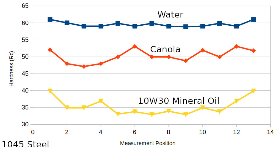

Knifemakers looking for oils to use that are cheaper than those available commercially most commonly use canola from the grocery store. However, some will also use motor oil. I found a study on 1045 steel where they found canola to quench more rapidly than motor oil so I am going to stick with canola as my “cheap” quenching option to test.
Data adapted from [1]
Despite quite a few studies that looked at canola oil I did not find any nickel ball measurements. This seems to be because the nickel ball test is outdated and has mostly been replaced by the inconel probe test.

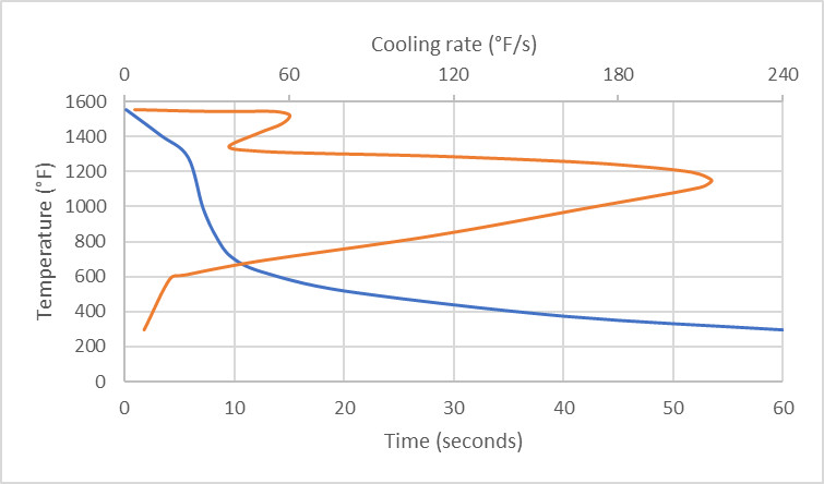

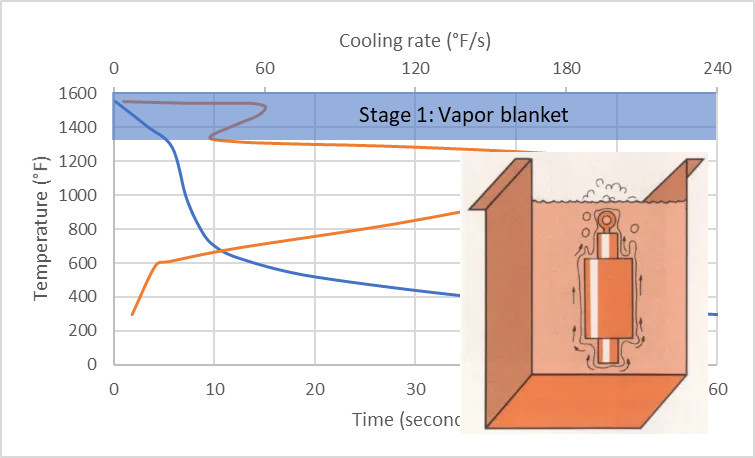

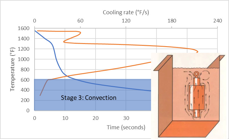

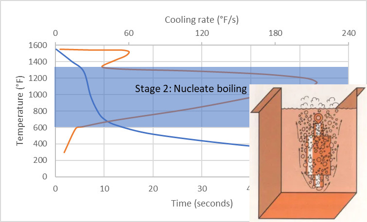

The inconel probe test is similar but the probe can measure the temperature of itself during quenching to generate more information about the quenching process rather than just generating a time in seconds. So you get a curve such as below:
The blue line is the normal time vs temperature curve, and the orange line is the “instantaneous cooling rate” at each position. In other words, the slope of the time vs temperature curve at each position. You can see that the cooling rate is relatively slow at high temperature, then accelerates to a peak cooling rate around 1150°F and the slows down to about 600°F where it becomes more stable. Those three stages are the “vapor blanket,” “nucleate boiling,” and “convection” phases, which are also shown below. I have more information about these stages in this article about hardenability of steel.

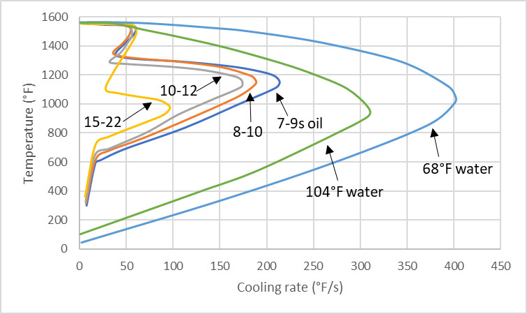

Comparing Oils with the Inconel Probe Test

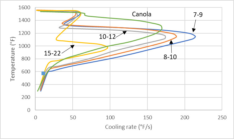

Below shows a range of different oil speeds from Houghton oils, as well as Canola:
Data adapted from Houghton International
The 7-9, 8-10, and 10-12 second oils look relatively similar but the peak cooling rates are slower as the nickel ball time goes up. The 15-22 second oil has a vapor blanket that lasts until a lower temperature, and then the peak cooling rate is significantly lower and at a lower temperature. Canola forms almost no vapor jacket at all and therefore reaches its peak cooling rate at a higher temperature. However, its cooling rate then decreases at higher temperatures, crossing over with the 15-22 second oil at about 1000°F.

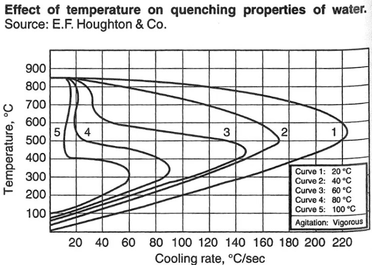

However, if we look at water we see that it is much faster than any of the oils, coinciding with the nickel ball results I listed earlier. I have two temperature results listed because water is very sensitive to temperature. The closer the water is to boiling the more tenacious its vapor blanket is.

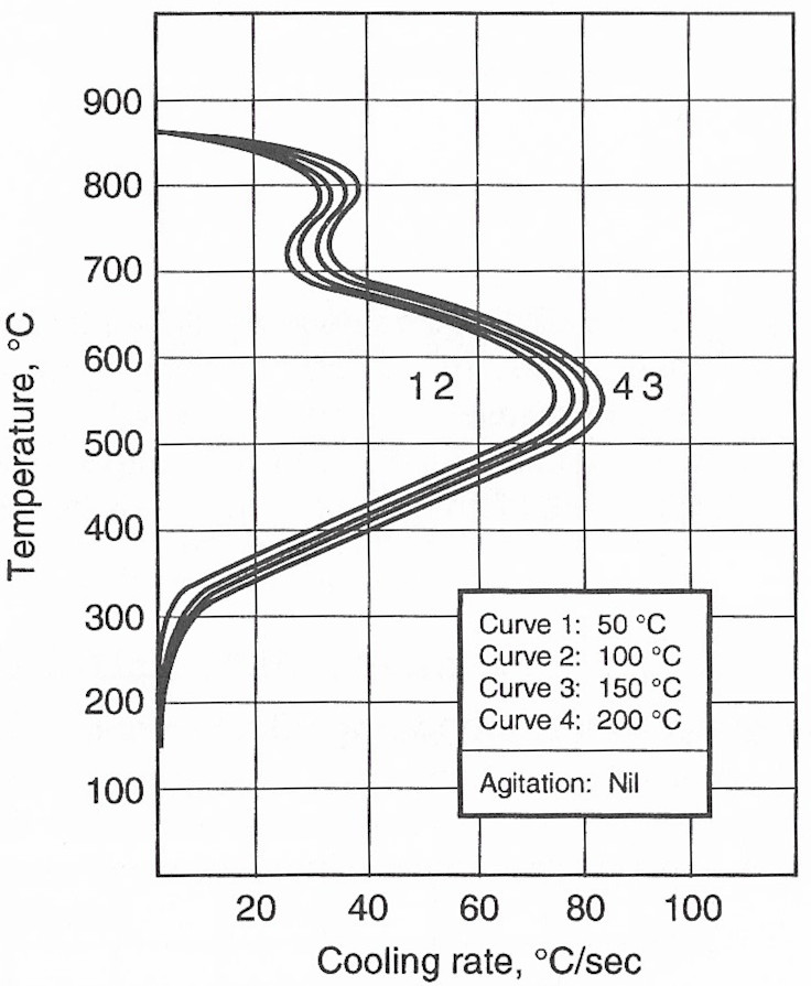

Water quenching chart from ASM Heat Treater’s Guide
However oil is much less sensitive to temperature. There are small changes in the cooling behavior with temperature but not nearly as extreme as water.

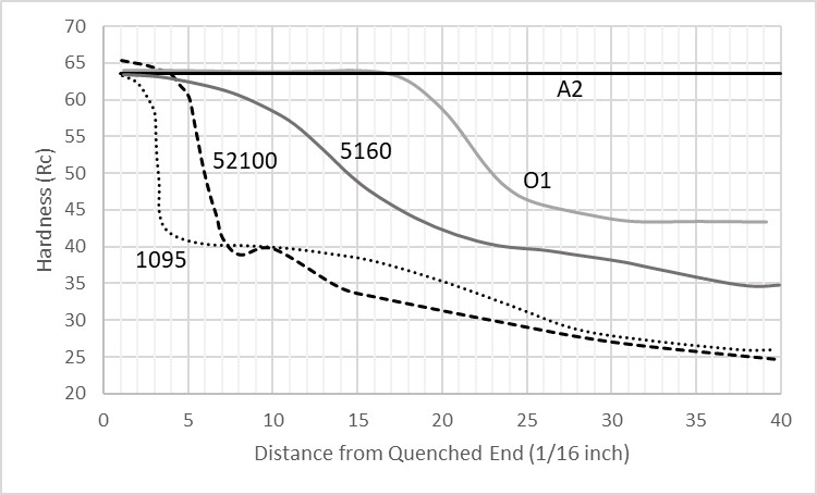

Hardenability of Steel – Jominy
Hardenability of steel also has multiple measures. I first covered hardenability in this article which had an extensive discussion of different CCT curves (continuous cooling transformation) diagrams. Hardenability is how slow you can cool the steel from high temperature and still achieve full hardness. Hardenability is not a measure of how hard a steel can be after quenching, which is controlled by other factors, primarily how much carbon is “in solution” in the martensite. One relatively simple measure of hardenability is the Jominy test where a bar of steel is heated in a furnace and then is placed in a fixture with a water spray that is directed at one end of the bar. So that end is rapidly quenched and the cooling rate is progressively slower toward the other end, which is essentially being air cooled.
Comparing different steels you get a chart that looks something like this:
Adapted from ASM Heat Treater’s Guide
A2 is an air hardening steel so its line is flat; even with slow air cooling it fully hardens. 1095 is a water hardening steel so it only reaches maximum hardness at the position measured directly next to the water quench and the hardness drops rapidly. 5160 and O1 are oil hardening steels though the O1 is significantly more hardenable. 52100 is in between the water hardening and oil hardening steels, and different datasheets will recommend that either can be used depending on the cross section.

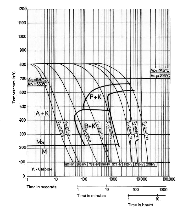

Continuous Cooling Transformation Curves
The CCT curves I mentioned above have more information about the behavior of the steel than the Jominy test. It is sort of like the difference between the nickel ball test (limited information) and the inconel probe test (more information). The CCT curve is generated by cooling the steel at different rates and measuring the phase transformations that occur during cooling. This shows the critical cooling rate required to avoid pearlite formation (makes the steel softer) and also the temperatures and times at which different phases will form. There are also certain features that can be different between steels such as some that will form some bainite (labeled B+K) if cooled at an appropriate rate, such as seen with O1 steel below:
Low hardenability steels see pearlite transformation at much shorter times such as can be seen with W2 below:
Different elements added to steel help to suppress the formation of pearlite. These elements are preferentially found in iron carbide so that when the steel tries to form the carbide phase of pearlite it is delayed by the diffusion of those elements. The most effective elements for hardenability are Mo, Mn, and Cr though Ni, Si, C, and V also affect hardenability. W2 has high carbon, low Mn/Si, and a V addition. The vanadium helps to refine the grain size which reduces hardenability (see my hardenability article). O1 has high Mn plus 0.5% Cr so it has relatively high hardenability.

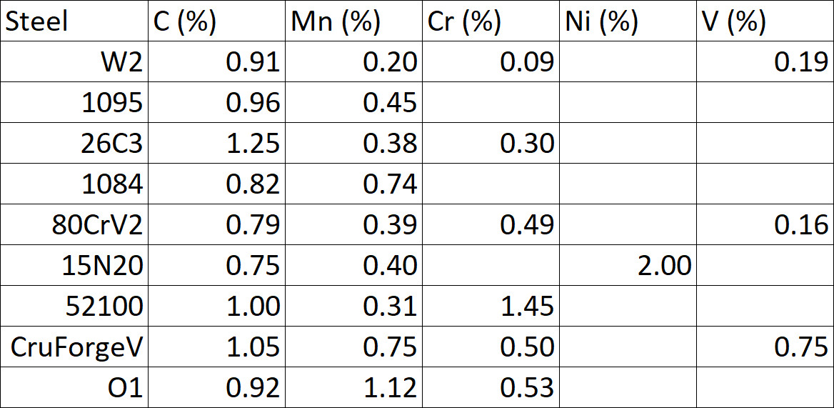

Steels Used in This Study
I chose a range of low alloy steels to test the different oils that I bought. The primary tests I performed were with 1/4″ thick stock. 1/4″ is about as thick as most knives get so if it fully hardens at that cross-section then thinner knives will also work with that particular oil.
The steels above are ranked in order of increasing hardenability based on Jominy data, CCT curves, and otherwise estimated based on the composition using equations found in the hardenability article. W2 has very low Mn and Cr which means its hardenability is quite low. And as mentioned previously the vanadium addition refines the grain and further reduces its hardenability. 1095 has somewhat higher hardenability due to the increase in Mn. 26C3 has very high carbon which reduces hardenability, but the Cr addition helps to overcome that to have somewhat higher hardenability than 1095, at least according to the CCT curves. 26C3 has a similar high carbon+Mn+Cr composition to several steels like the Blue/Aogami series. 1084 is near-eutectoid and higher Mn than the previously mentioned steels which gives it increased hardenability. 80CrV2 has reduced Mn when compared with 1084 but with a significant Cr addition that makes up for it. 15N20 is an interesting case since it has a substantial Ni addition; nickel does not contribute that much to hardenability but 2% certainly has an effect. 52100 is a similar case with relatively low Mn but a substantial Cr addition for hardenability. CruForgeV and O1 combine significant Mn with a 0.5% Cr addition which is why they are the highest hardenability steels on the chart.
The W2, 1095, 1084, 80CrV2, 52100, and O1 were purchased from New Jersey Steel Baron. Most of the steels were produced by Buderus according to the composition sheets, and the O1 was produced by Latrobe. 26C3, 15N20, and CruForgeV came from Alpha Knife Supply. The 26C3 and 15N20 are produced by Uddeholm and CruForgeV is a Crucible product.

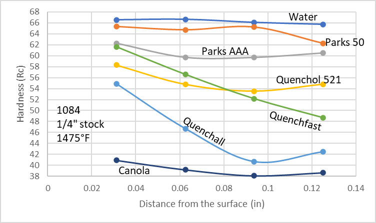

1084 and Comparing Oils
It turns out that 1084 was in the sweet spot for comparing the different oils to each other; it shows the clearest differences. This was a little bit of a surprise because I expected 1084 and 80CrV2 to have more similar hardenability since Cr is less effective than Mn for hardenability, so 0.75 Mn should be similar to 0.4 Mn + 0.5 Cr. The results of the different quench media are shown below:
Water led to the highest hardness, as expected being the fastest quenchant. Parks 50 had a drop in hardness at the center of the 1084. Parks AAA had a maximum hardness of 62 Rc near the surface though it dropped to 60 Rc through the rest of the cross-section. Quenchfast (11 second oil) and Quenchol 521 (16 second) had somewhat odd behavior. The Quenchfast started out at higher hardness as expected but then the two oils crossed over at 3/32″ from the surface. I’m not sure what led to that result. The slow oil Quenchall led to low hardness. But the biggest surprise to me was that canola was by far the slowest oil. The overall time for cooling the steel in canola is very similar to the other oils, perhaps even faster. However, the slowing of cooling rate appears to be the deciding factor here. The “pearlite nose” on the CCT curve (the shortest time for transformation) occurs around 1050°F which is where the canola has already slowed down to the cooling rate of a slow oil.

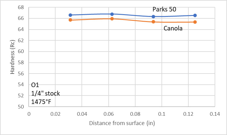

O1 High Hardenability Steel

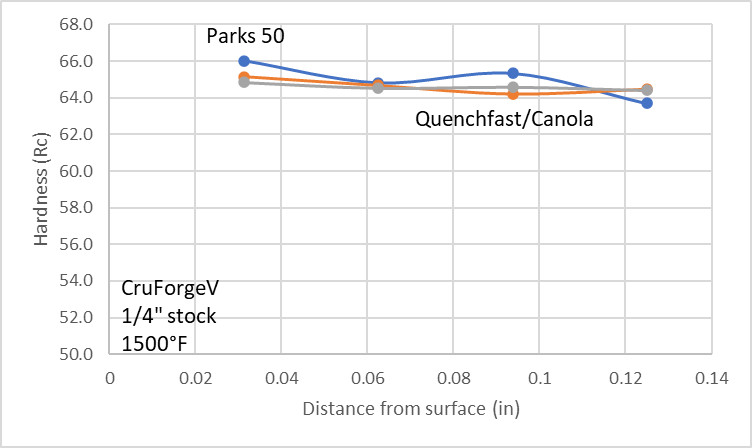

O1 with its very high hardenability there was no difference between Parks 50 and canola:
There is a small difference in hardness between the two oils shown above, however. This is likely due to “auto-tempering” which is a small amount of tempering that occurs by slow cooling through martensite formation. This explains why the two lines are parallel to each other rather than seeing a drop as would be expected from pearlite formation.

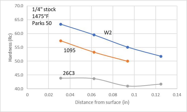

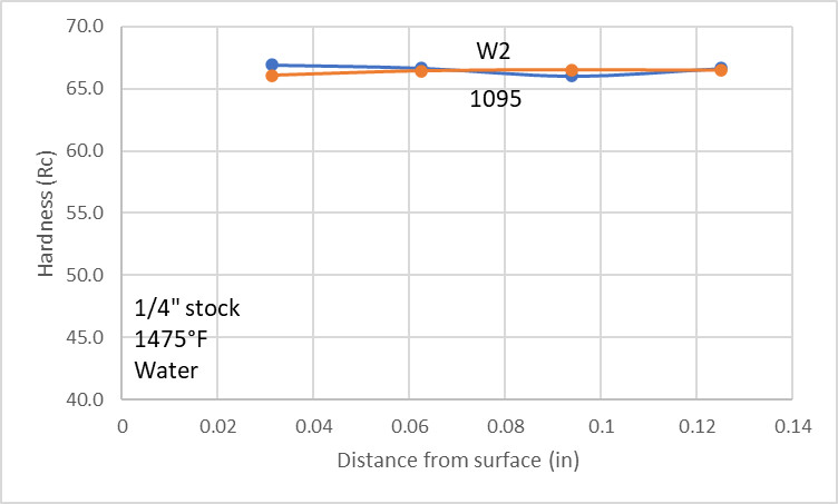

Water Hardening Steels – W2, 1095, and 26C3
I was also somewhat surprised that these water hardening grades did not fully harden in the Parks 50. Parks 50 is often promoted as “approaching the speed of water” but it turns out the word approaching is doing a lot of work in that sentence.
The other surprise here is that the steels are basically in reverse order of hardenability from what was expected on composition. I can’t think of many good reason why W2 with the lowest Mn is showing superior hardenability to the 1095, especially since both are made by the same manufacturer. I would expect the reason for reduced hardenability of 26C3 is because of differences in carbide structure from the manufacturer. Perhaps a follow-up study could be done where I dissolve the carbides and re-anneal them to all have a similar starting microstructure. When I quenched 1095 and W2 in water, however, they fully hardened. I didn’t have the 26C3 yet when I performed this experiment:

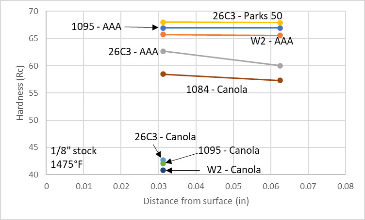

Many knives are produced with thinner than 1/4″ stock so I was also interested in how much effect that would have. And some knives have bevels before hardening and so the edges may still harden even if the spine of the knife does not. Of course we expect a faster cooling rate with thinner steel and therefore better hardening.
Canola was unable to harden 26C3, 1095, W2, or 1084, though 1084 was by far the closest of those. I was surprised that canola could not fully harden 1/8″ 1084 since this is such a common oil used by beginning knifemakers. Parks AAA did harden the 1095 and W2 but not the 26C3, it needed Parks 50. Since the W2 and 1095 had higher hardenability than expected in my tests it is possible that other steel from another manufacturer, or the same steel hardened from the normalized condition may require faster than AAA. So for steels in the “water hardening” category I would recommend using water if thicker than 1/8″. Water can be a dangerous quenchant, it is important to avoid stress risers in the knife and keep the grain size small in the steel. Also “hard” water is a faster quenchant than distilled. If 1/8″ or thinner it appears that a very fast oil is effective in these low hardenability steels.

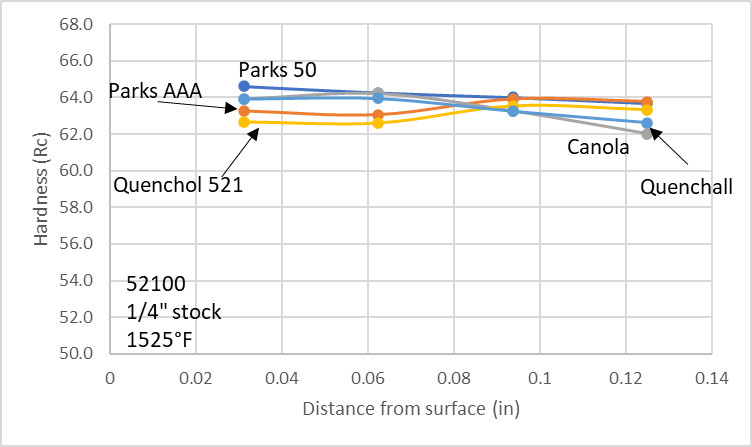

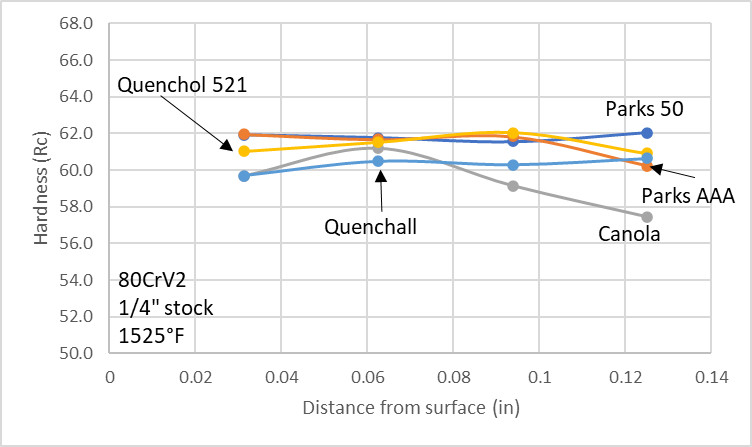

80CrV2 and 52100 had somewhat inconsistent hardening results. I believe this is also due to prior microstructure effects. Perhaps if the steel was processed for a finer microstructure in the annealed condition it would show more consistent hardness at the surface with fast oil. A finer microstructure would also reduce the hardenability of the steel so that could be an interesting follow-up as with the 1095/W2. With 80CrV2 the canola did not fully harden the 1/4″ steel and Quenchall was about 2 Rc lower than the other oils throughout. With 52100, canola and Quenchall dropped a couple Rc by the surface which makes it appear that the oils are not fast enough for that cross section. However, with the inconsistent hardening, Parks AAA and Quenchol 521 had somewhat lower hardness at the surface than the center. So it is hard to tell if the canola/Quenchall are insufficiently fast.

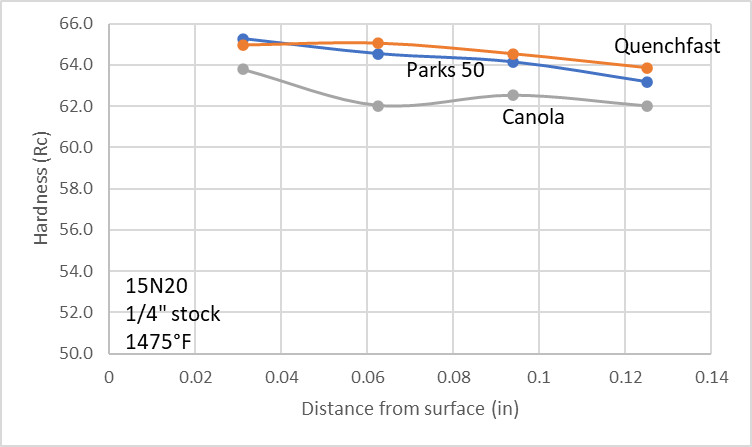

With 15N20 the Parks 50 (fast) and Quenchfast (medium) oils behaved similarly, while canola clearly led to softer steel. For CruForgeV all three oils showed similar results, so it seems to be hardenable enough that oil doesn’t matter too much with 1/4″ thickness.

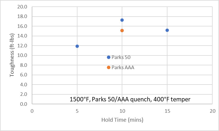

One of the concerns is that the faster oil leads to microcracks and therefore reduced toughness. Microcracks are real but they occur due to plate martensite formation not from overly-fast quenching. Plate martensite comes from very high carbon austenite so this is controlled by austenitizing (how much carbon is in solution) not from quenching.
In a previous study we did on 8670 toughness we looked at toughness differences between Parks 50 and AAA. 8670 has hardenability similar to CruForgeV and is one of the steels that is sometimes said to be a no-no for Parks 50. However, the toughness was the same whether we used Parks 50 or AAA, in fact the Parks 50 was slightly higher but that is probably just due to experimental scatter.
Instead, the concerns with quenching more rapidly are warping and cracking. Cracks are not the same as microcracks. Microcracks are a microstructure-level feature that specific etching techniques are required to reveal. Cracking is on a macro level and are much more obvious. High hardenability steels can be quenched in slower oils to minimize the chances of warping and cracking. However, quenching high hardenability steels in a fast oil is still possible and it doesn’t mean reduced toughness.

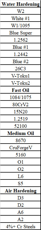

Because warping/cracking can be reduced through a slower oil it makes sense to have multiple oils depending on the hardenability of the steel. However, if you buy only one oil it should be a fast oil like Parks 50 so that you can quench the low hardenability steels. If the funds are really so tight that you are considering buying canola I would recommend getting the relatively inexpensive AAA instead.
Which Steels Can be Quenched in Slower Oils?
To know which steels can be used with slower oil to minimize warping/cracking I have the following chart that is from my book Knife Engineering. It is an approximate ranking based on hardenability. The steels at the top are expected to have the lowest hardenability and the bottom has a few air hardening steels as examples.

It is odd how badly canola did, there are plenty of videos out there of canola perfectly hardening 1084 knives. My guess is that knives are beveled making the edge cool faster compared to a 1/4 inch plate resulting in a hard edge.
Hmmmm….. RC 40 vs RC 60 is such a large difference, it does not take a PHD to tell them apart. Your statement is a little over the top….
Alex got a point. Everybody and their dog are getting good results with canola. They most likely cannot tell between 58 and 63 HRC etc. But 40? That is not really “hard”, that is only a little more than +QT 4140 and can be turned with carbide on a normal lathe. A file will slice right into it….impossible to confuse that with 60+.
There clearly are parameters unchecked by this test. The 1/8″ 1084 in canola was getting hard enough to make a workable knife. 1/8″ is still a lot for anything but a chopping/fighting knife/sword. Even huge kitches knives are much thinner. Then variation in steel composition. Then oil temperature. Canola is quite viscous but looses thickness very quickly with heat. Bunch of German dudes use it at more like 200+°F. Since it has no tendency to boil much, maybe that actually makes it faster. I think alex is on to something. Only proper scientific method can precisely determine which parameter is really responsible, but there clearly is one….
Common sense and good questions always trump fancy equipment. I’m not surprised that canola oil isn’t ideal even where it’s performance is actually competitive, but what about the TEMPERATURE of the oil. Most guys heat it up to 120-160 degrees. Did Einstein factor that in? Maybe I didn’t read closely enough, but I don’t think so.
You didn’t read closely enough.

How long do you think the nickel ball time will be when using boiling water?
Also, if that time is close to the nickel ball time of various oils, is it possible to use boiling water instead?
The vapor jacket formed in hot water leads to uneven cooling not just slower.

Is it possible to convert cooling rate (e.g time-temp) between the “nickel ball time” and other standards as ISO 9950,
ASTM D 6200-01 and ASTM D 6482-06 standards?
I hava a cooling diagram done with the IVF SmartQuench on the fuchs quenchway 22 (https://castrasteel.com/wp-content/uploads/2019/11/QuenchWay-22-at-70-and-85C.pdf) and it would be great to be able to compare the time-temperature with Parks 50 and AAA. I’ve tried to google if there is some way of roughly convert between the different methods with no luck. I understand that there are different probes, but i guess the shape of the different curves looks identical, only the scale is different.
What do you think?
Best regards
Peter
There is no way to convert between them, but the same inconel probe curves are shown in this article for different nickel ball speeds of oils.
this doesnt answer the question, but might be of interest anyway:
https://pdxscholar.library.pdx.edu/cgi/viewcontent.cgi?article=1217&context=mengin_fac
btw, ist interesting to note that clay can slow down as well as accelerate cooling. the japanese used to cover the whole blade because the thin layer at the edge promotes hardening (→steem blanket).

Looking at your 80crv2 hardening depth chart it looks like canola is only about a half point softer than parks and harder than quenchall at the .06 inch depth.
Since the center of an 1/8th inch thick blade is .0625, why would canola not work well for 1/8 inch or even 5/32 (.078) inch thick blades where it still hardens better than quenchall at the .078 inch depth?
Thanks
