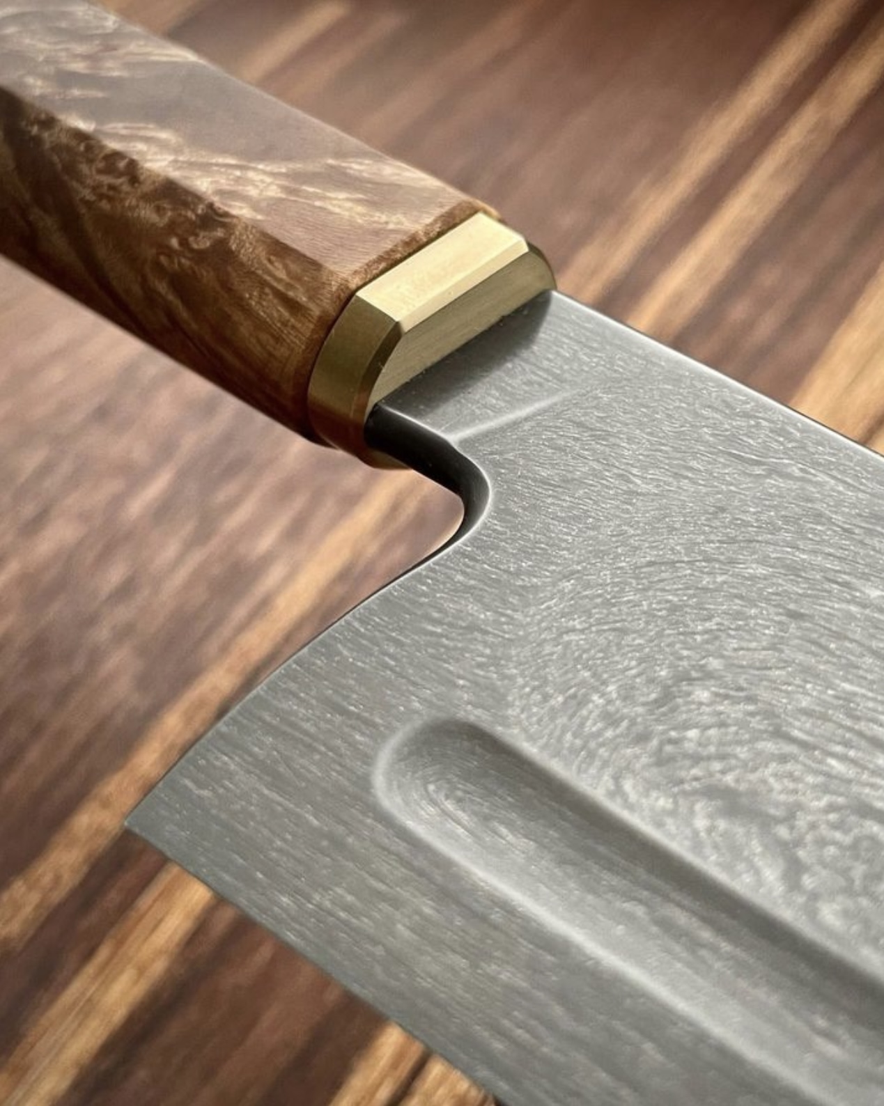

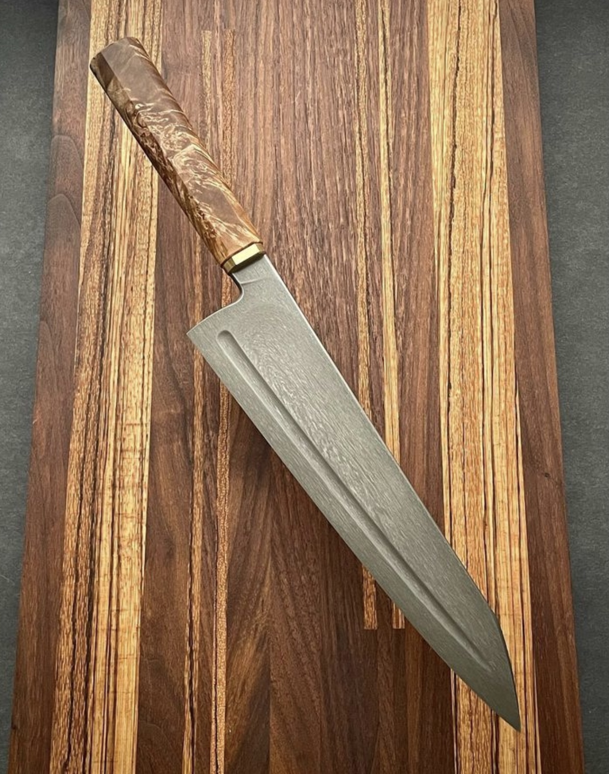

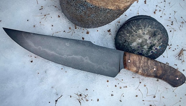

Spencer Sandison Wootz knife
I worked with bladesmith Spencer Sandison on this study as he has made Wootz knives in the past. But most importantly he volunteered. Spencer uses electrolytic iron flake (high purity iron), pig iron, and ferroniobium. Pig iron is created during steelmaking when iron ore is smelted with coke, which introduces a very high carbon content. Pig iron is relatively high in impurities, however. The pig iron acts as the carbon source in Spencer’s Wootz. Dr. Verhoeven determined that a small amount of vanadium was in the ancient iron ore used in Wootz production. This carbide former allowed segregation to occur for the carbide banding after thermal cycling. Spencer, however, adds a small amount of niobium to act as a carbide former.

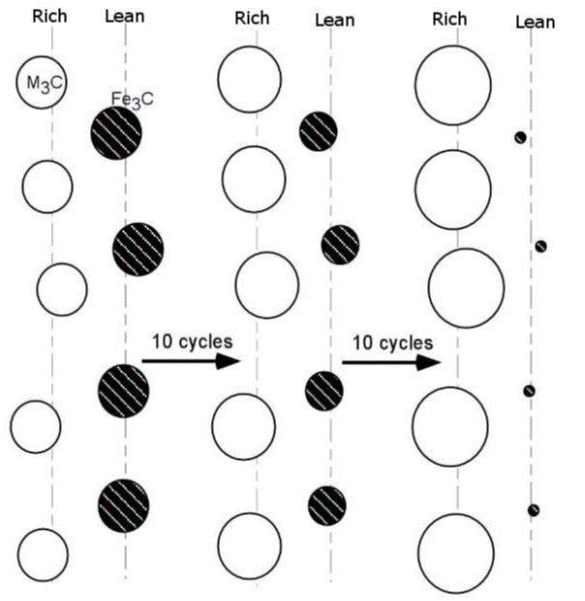

Evolution of carbide bands through thermal cycling by Verhoeven and Pendray

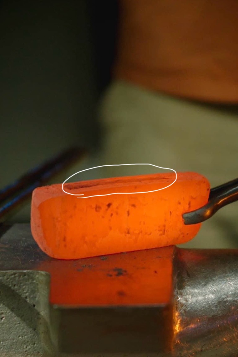

So Spencer adds those ingredients to a crucible and tops it with green glass to form a protective slag and a sealed lid to prevent oxidation. The crucible goes into the furnace to 2900°F and is held until melting, after which the crucible slowly cools and the steel solidifies. The steel is next held at high temperature called a “roast,” followed by forging down the steel. The thermal cycles the steel undergoes during the forging steps sets the final microstructure. It is important that the steel is not overheated, as that would dissolve all of the carbides. When they re-precipitate, they are evenly distributed again and would require more thermal cycles to re-segregate. This is one of the reasons that the carbon content of ancient Wootz is very high, 1.2-2.0%, averaging around 1.5%. Notice how in the iron-carbon phase diagram below, the temperature range of the “Austenite+Cementite” region gets wider as the carbon content goes up.
Carbides that are in the “rich” region of the steel (high in carbide formers) will coarsen during thermal cycling, while the lean region carbides will shrink with further cycles, leading to carbide bands. These rich and lean regions come from segregation during casting.

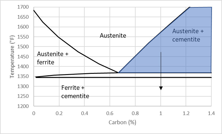

This was actually the second Wootz blank that Spencer sent me, the first he did not add any manganese and I did not successfully harden the steel with his recommended heat treatment. Typically he uses 1425°F for 6 mintues with a quench in Parks 50. I copied this heat treatment and I got inconsistent hardness readings, some high and some low, which typically indicates that some pearlite formed during the quench. The toughness coupons confirmed this as they broke in a ductile manner indicating they were not fully martensitic. Unfortunately it was a small piece of steel and I used all of the steel with these coupons. The low austenitize and short soak may be working for Spencer’s knives due to the edge being relatively thin prior to heat treatment but did not work for heat treating toughness coupons.
I don’t normally austenitize from only 1425°F, especially with only a 6 minute austenitize. Using 1475°F and 10 minutes should help with issues of insufficient soaking and ensuring full austenitization. But we also decided we would have a small manganese addition with the second one. While the heat treating was more consistent than the original steel, it was clear that there was still some pearlite forming with the Parks 50 quench. I went as thin as I could on the steel for the toughness coupons (just oversize for the final dimensions 2.5mm thick) but it wasn’t happening. I was still getting some hardness values below 60 Rc after quenching. I had to use a water quench; finally I got consistent hardness after quenching. Even coupons with Parks 50 that seemed to be testing ok for hardness we could see black pearlite colonies in the fracture surface and the metallography:

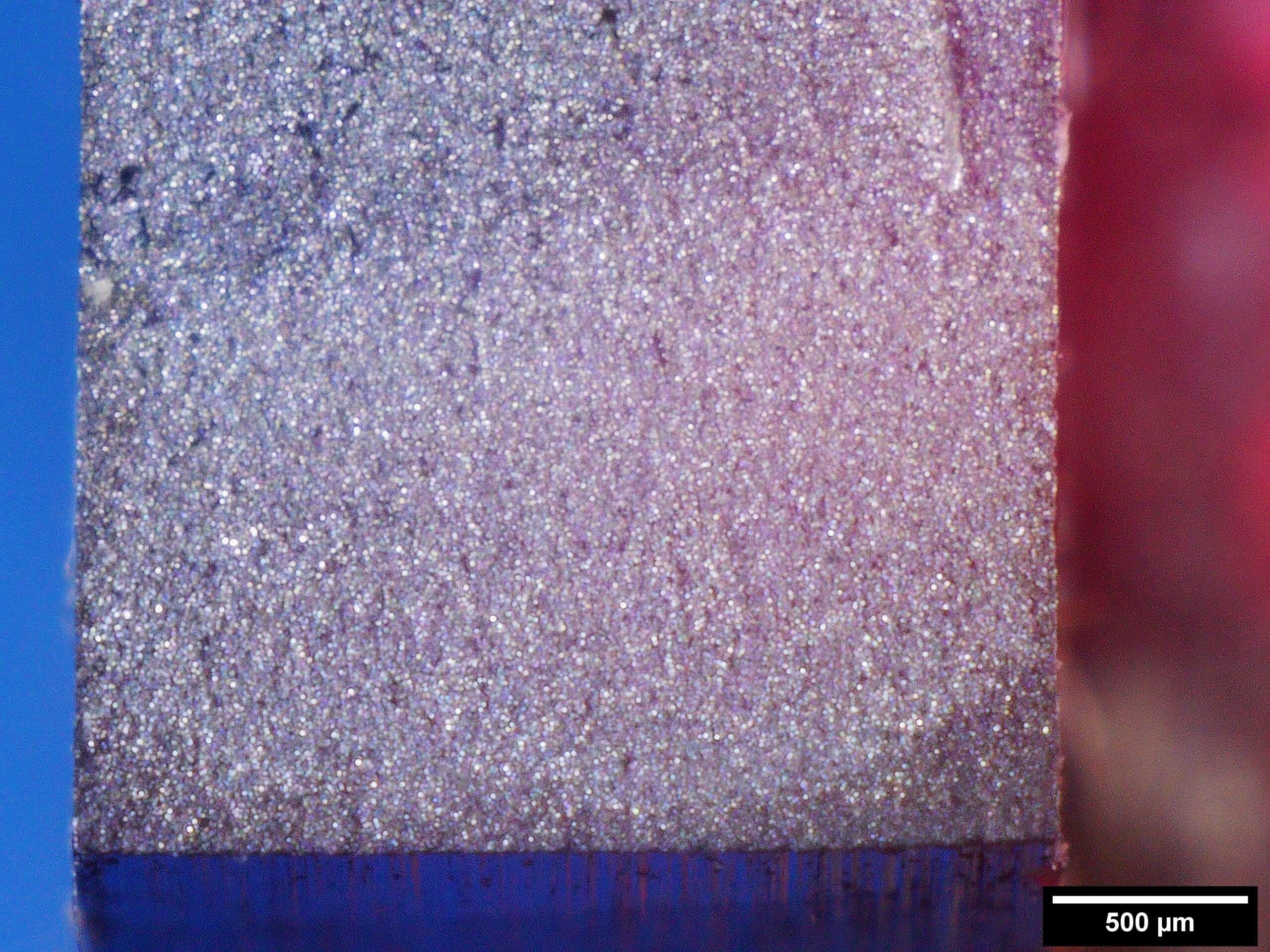

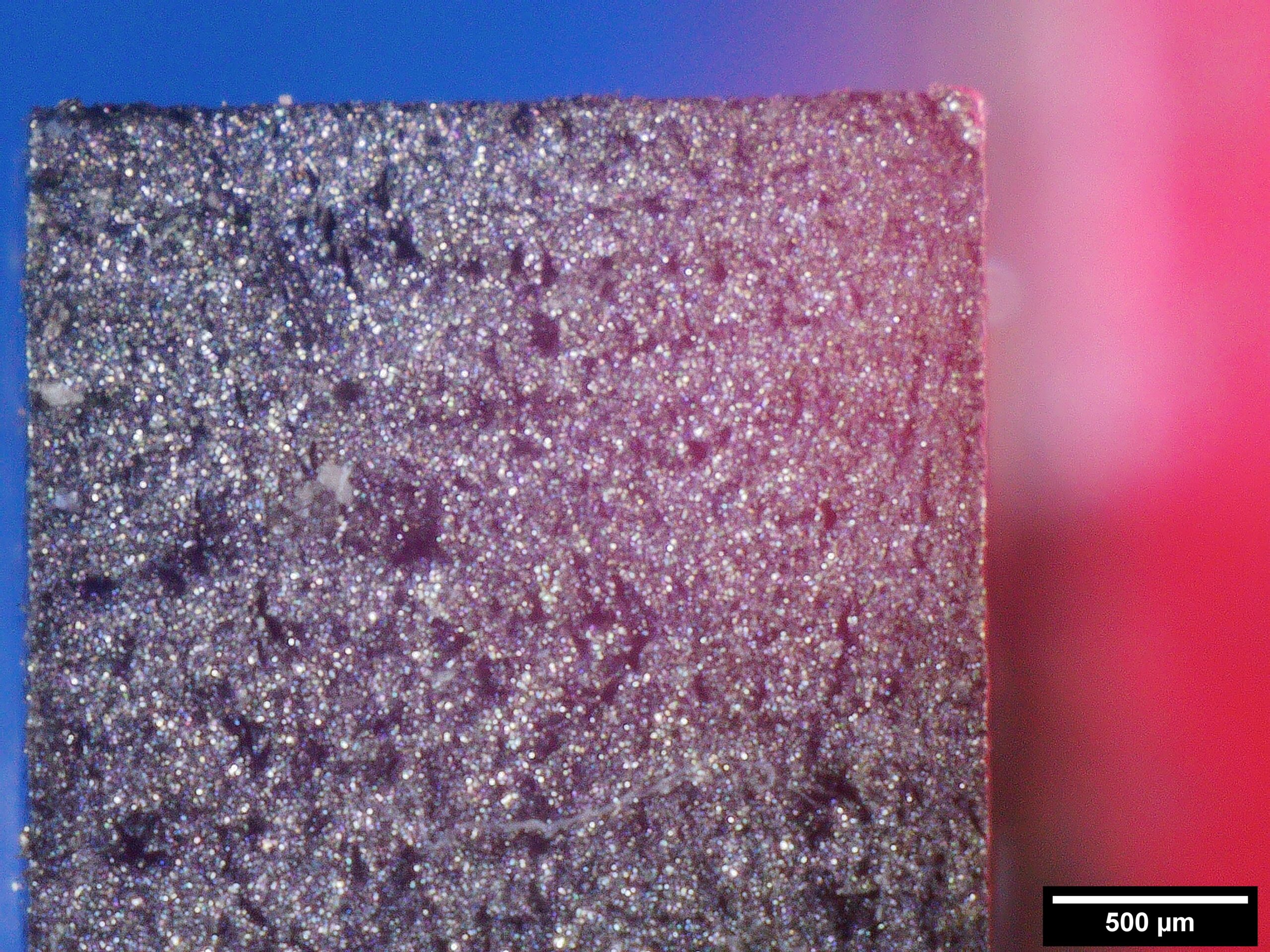

Parts of the microstructure are visible in the fracture surface including carbides (white particles) and pearlite colonies (black)
Dark pearlite colonies are visible in the microstructure
With a water quench we finally avoided pearlite. Why was the steel so difficult to harden? One reason is the very low manganese (even lower in the original). Manganese is an element that increases “hardenability,” the rate required to quench to avoid pearlite or other transformation products that aren’t martensite. A very high hardenability steel will achieve full martensite even with an air cool. Hardenability is not a measure of how hard the steel will become, but how slowly you can cool and still achieve full martensite. Another factor is the high carbon content, which means the steel “wants” to form pearlite more, reducing hardenability. You can read more about hardenability in this article, and more about quenching oils vs water in this article.
Fracture surface of water-quenched Wootz

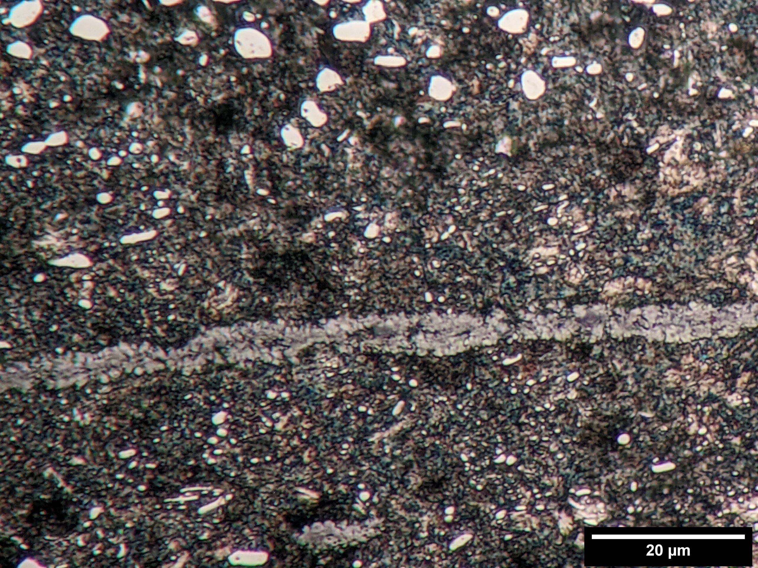

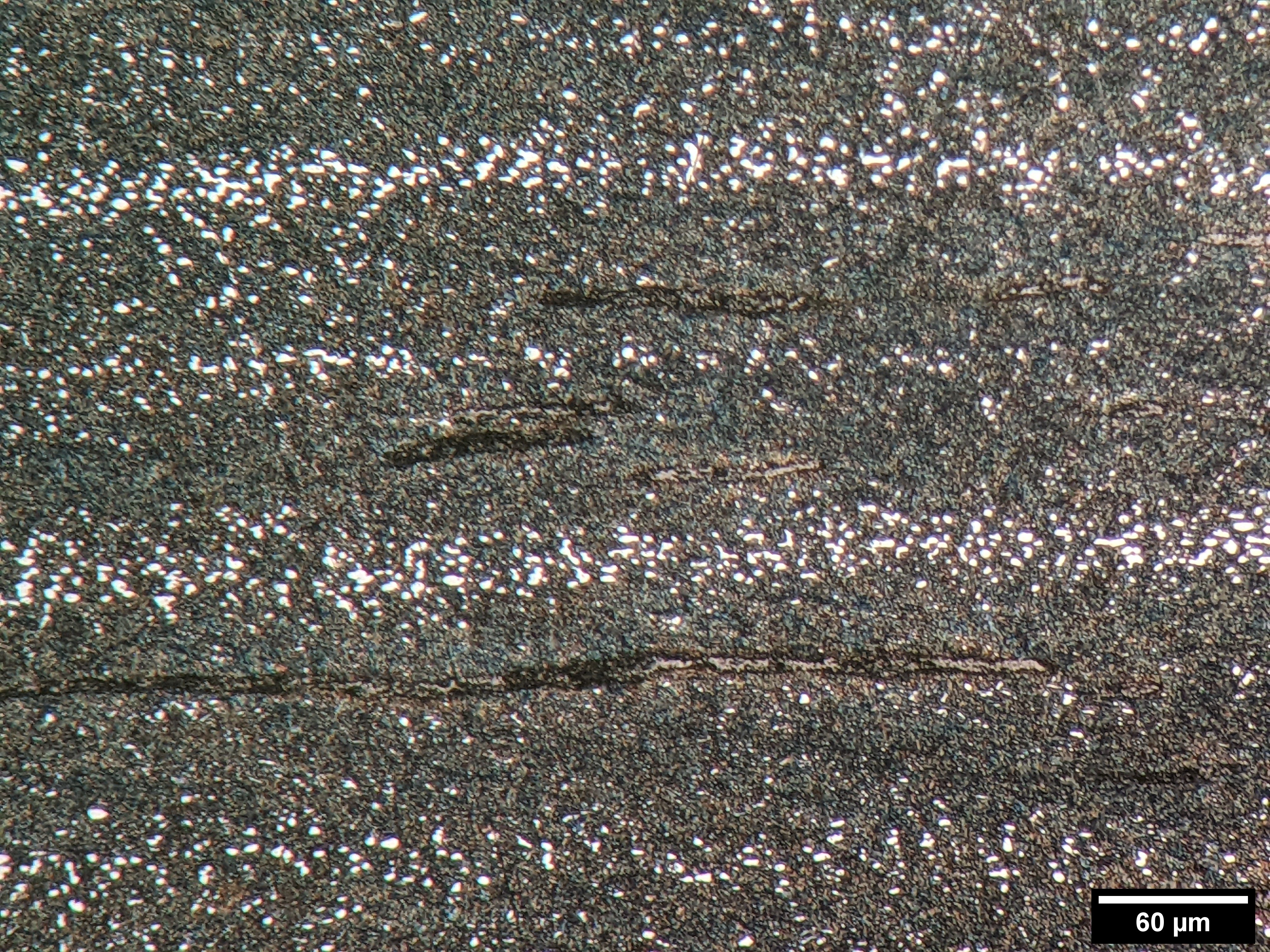

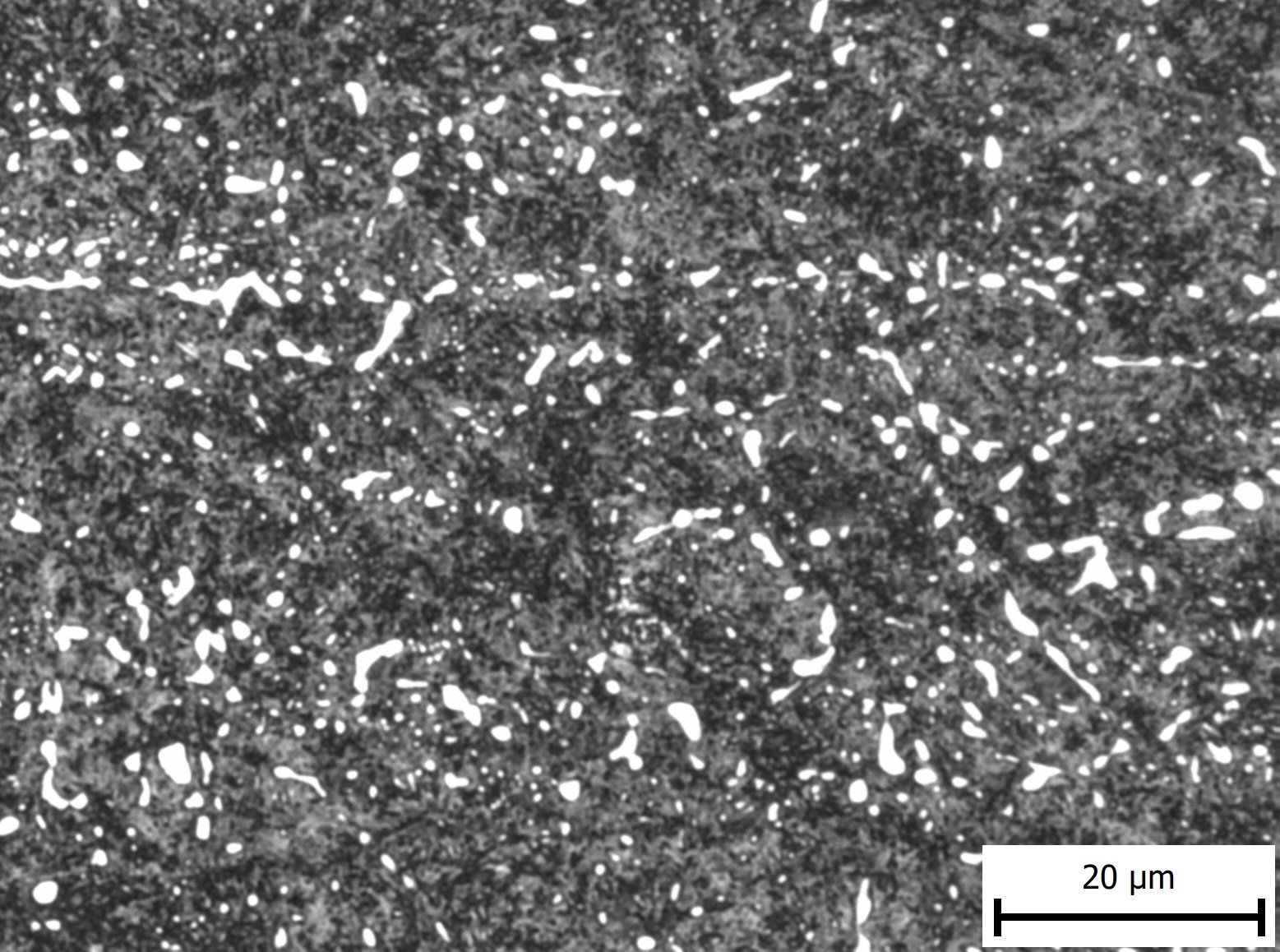

Looking at the heat treated microstructure at medium magnification we can see the characteristic bands of carbide that gives Wootz its macroscopic pattern:

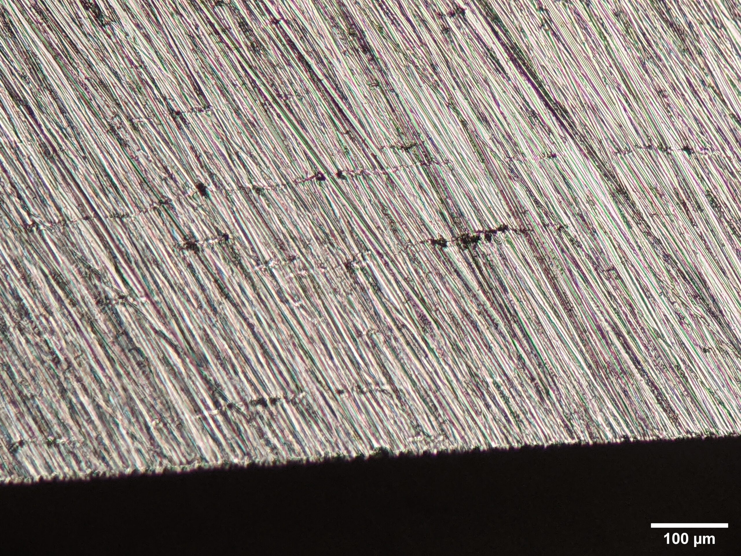

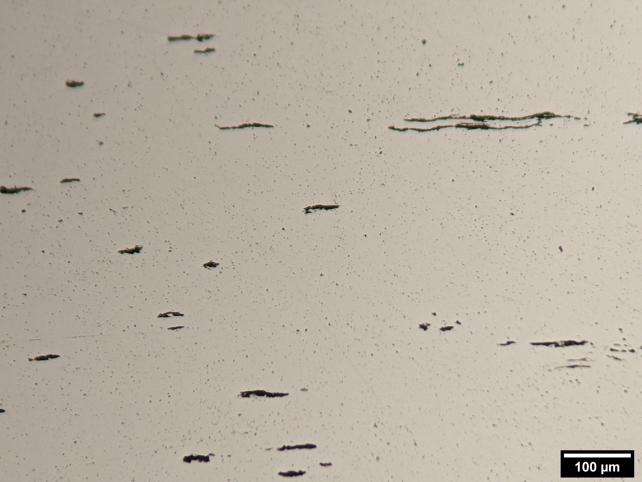

You can also see some grey elongated features in the steel which are impurities, also called inclusions. This steel has a relatively high content of them. One way of analyzing the impurities without the rest of the microstructure is to observe it as-polished rather than etched:
So now the impurities are visible as black features in the micrograph. There were enough of them that they could also be seen in the sharpened edge under magnification:
The likely source of the impurities was the pig iron which isn’t particularly clean material. Of course ancient blades also typically had relatively high impurity contents, and “backyard” steelmaking methods typically result in higher impurity content than commercial steel. However, one thing that Spencer noted was that he took a different approach to how he manipulated the “junk” material that results in the top of the ingot. Normally he forges that to one side of the billet and grinds it away. In this case he kept it in the center of the billet to try and grind it away later, but perhaps some of this was forged into the rest of the piece.

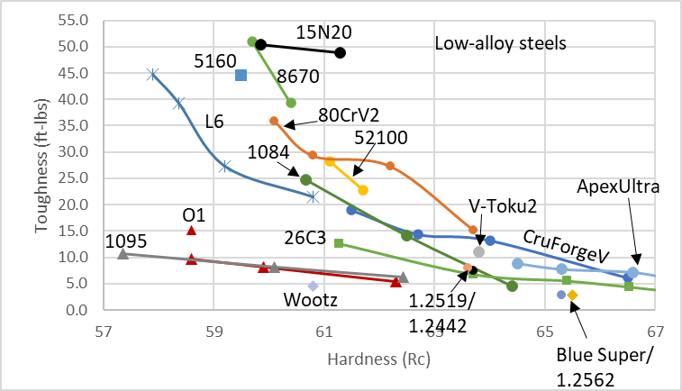

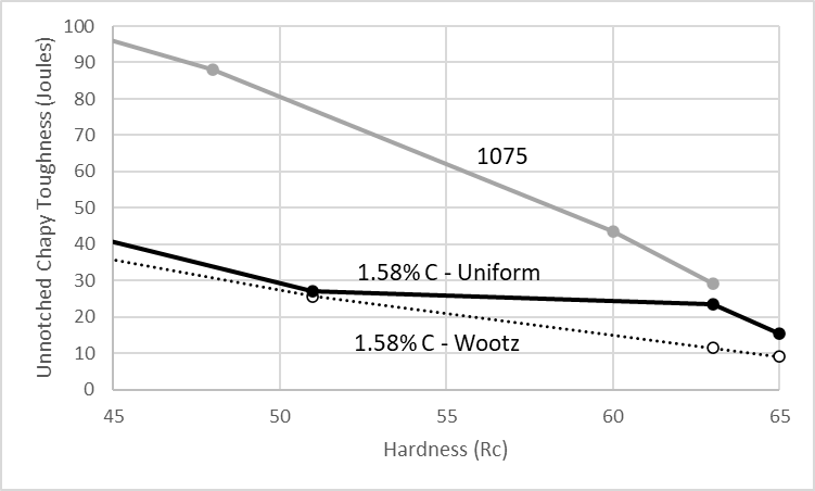

I measured the toughness of the Wootz with my standard chapy impact test, and compared it with other low alloy and simple carbon steels:

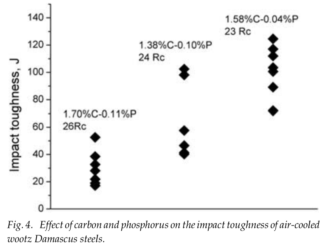

When controlling for hardness, Wootz had the worst toughness of the low alloy steels. This was somewhat expected. This Wootz had a relatively high impurity content, which did not help. Juha Perttula looked at the effect of phosphorus content on Wootz steel [1] and as expected higher phosphorus leads to poorer toughness. However, this was not the only reason the Wootz tested somewhat poorly.
One issue is that the Wootz has a very high carbon content, resulting in a high carbide content and potentially higher carbon in solution. Higher carbon steels usually have lower toughness, as I have described in earlier articles. You can see this trend in the following chart:
However, the other thing working against the Wootz is the banded carbide structure, the structure that we want for the beautiful look that Wootz provides. In a prior study performed by metallurgist Juha Perttula [1], he compared a 0.75% carbon steel with a 1.58% carbon Wootz in two interesting conditions. In one he processed the steel to have an even distribution of carbides, and in the other he left it in the typical banded structure of Wootz. Of course the lower carbon 1075 had significantly better toughness. But even when comparing the two conditions of the Wootz steel, a uniform carbide distribution led to better toughness:

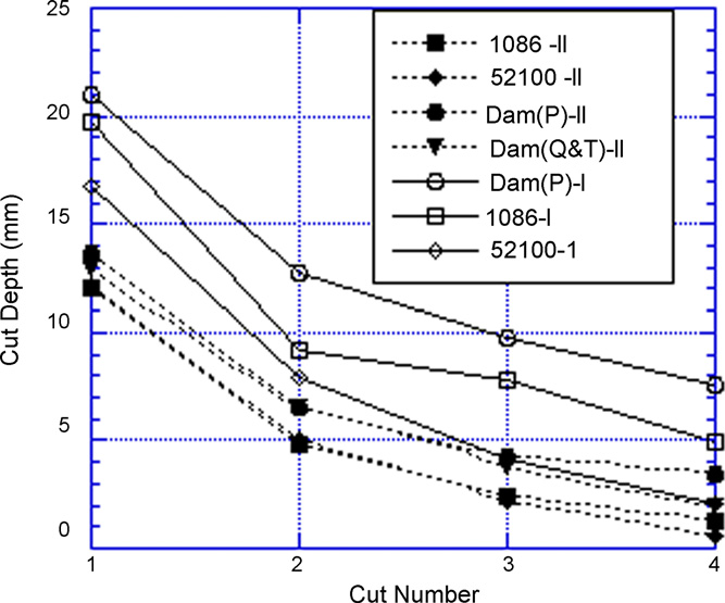

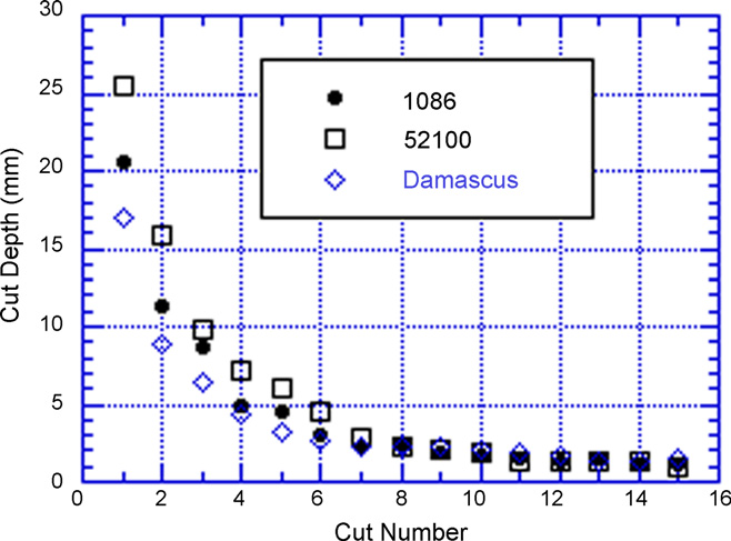

Dr. Verhoeven previously did his own CATRA comparison of Wootz, AEB-L, 52100, and 1086 steels [2]. This test was done along with knifemakers Howard Clark and Al Pendray. At 60 Rc the 52100 and 1086 both did better than the Wootz, but at 40 Rc the Wootz was better than the others at the same hardness. Dr. Verhoeven proposed that perhaps the carbides were not crossing the edge in a manner that would increase edge retention. Perhaps they tested a section that was light in carbides and I tested in a region that was rich in carbides. Another proposed reason is that in the past I have not found cementite (iron carbide) to significantly help in the CATRA test, likely because cementite is softer than the 5% silica in the CATRA cardstock used for testing. In fact I have found previously that more iron carbide can potentially be detrimental in the CATRA test:
52100, with its chromium enriched cementite, has carbide harder than the silica and does significantly better. So this may also partially explain the poor result of Wootz in Verhoeven’s study. However, that does not explain why the Wootz in my test did better. Perhaps there was poor sharpening of the Wootz blade for Verhoeven’s test, as in the 60 Rc test the Wootz blade was worse from the first cut, which was not the case in the 40 Rc test:
Verhoeven Wootz edge retention study with 60 Rc steels
The first cut is not purely a test of sharpness, as each “cut” is actually a stroke in one direction and then back again, so there is some edge wear even in “cut 1.” However, the difference shown above may be big enough to indicate a sharpening issue rather than inferior performance of the Wootz. This is also partially supported by the better result with the 40 Rc heat treatments:
In this test, comparing the (I) edge geometry (see the Verhoeven article for more details), the Damascus with the pearlite microstructure at 40 Rc labeled (P), it was outperforming from the first cut (back and forth stroke) and did the best over the course of the test. The 1086 was just below it and the 52100 was even below the 1086. I cannot think of any reasonable explanation for the poor performance of the 52100 at the lower hardness apart from poor sharpening. Or at least inconsistent sharpening.

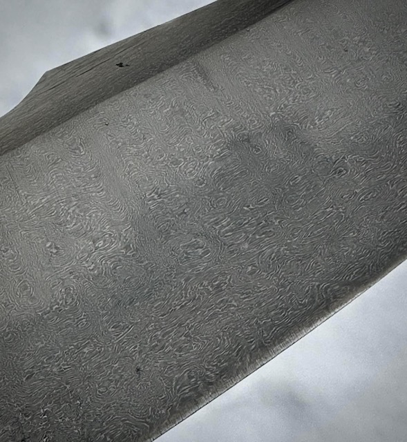

And that brings up the question: What is Wootz? If there is a banded carbide structure that results in a pattern at the surface, is that Wootz? Does it only count if it has a similar composition to ancient blades? What if the composition is similar but it did not begin with a small crucible and ingot of steel? Sometimes people prefer to use the term “Crucible Damascus” for the material rather than Wootz. However, this does not automatically discount modern steel, as melting steel in crucibles was the most common method for making tool steel until well into the early 1900s.
Ed Fowler began seeing a banded structure in his 52100 from the many thermal cycles that he put the steel through, and he began calling his steel “52100 Wootz” [3]. The high chromium in 52100 also increases the size of the “austenite + cementite” region making 52100 better for developing carbide banding in a similar way to ancient Wootz. Can this 52100 properly be called “Wootz”?

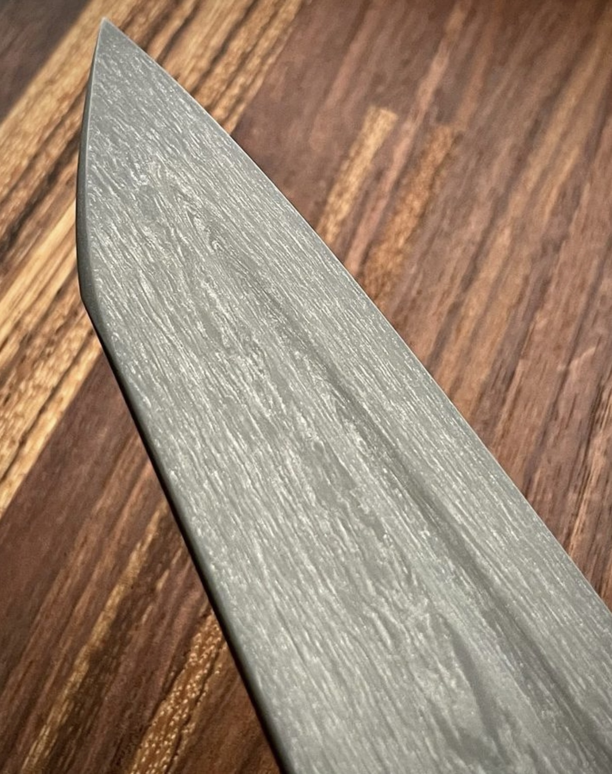

Some knifemakers now etch their commercial steel knives because they develop carbide banding due to alloy segregation and carbides that are difficult to dissolve during forging. Therefore the banding is difficult to avoid in commercial steel, resulting in a visible pattern. Of course this also occurs in stainless steels. I don’t typically see this referred to as “Wootz,” but perhaps could be due called Wootz due to a similar result. This would make high carbon stainless steel the original “stainless Damascus.” Though perhaps we are straining too much at definitions.
Dan Bidinger knife in A2 tool steel lightly etched to highlight the carbide banding

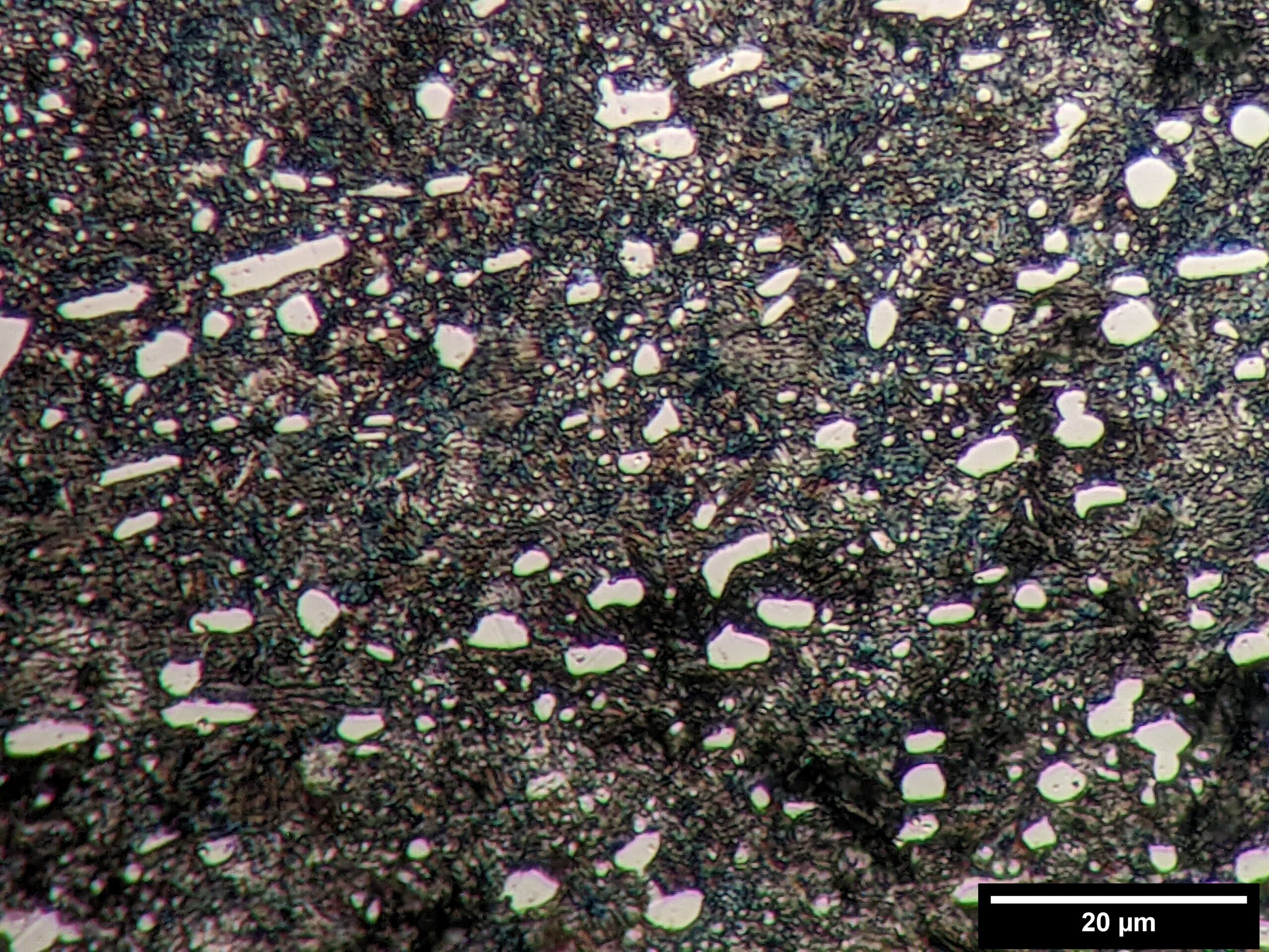

Oil quenched Wootz within a carbide band
26C3 steel
However, the carbide bands appear to have helped the edge retention of Wootz when compared with 26C3, as its CATRA edge retention measured higher than the 26C3. The extra carbon and therefore carbide content of the Wootz likely also helped. However, if we use a looser interpretation of what Wootz is we could potentially use compositions that would have better overall properties, such as lower carbon with high chromium (ie 52100). In which case the question of Wootz performance becomes pretty big, with many potential compositions.
