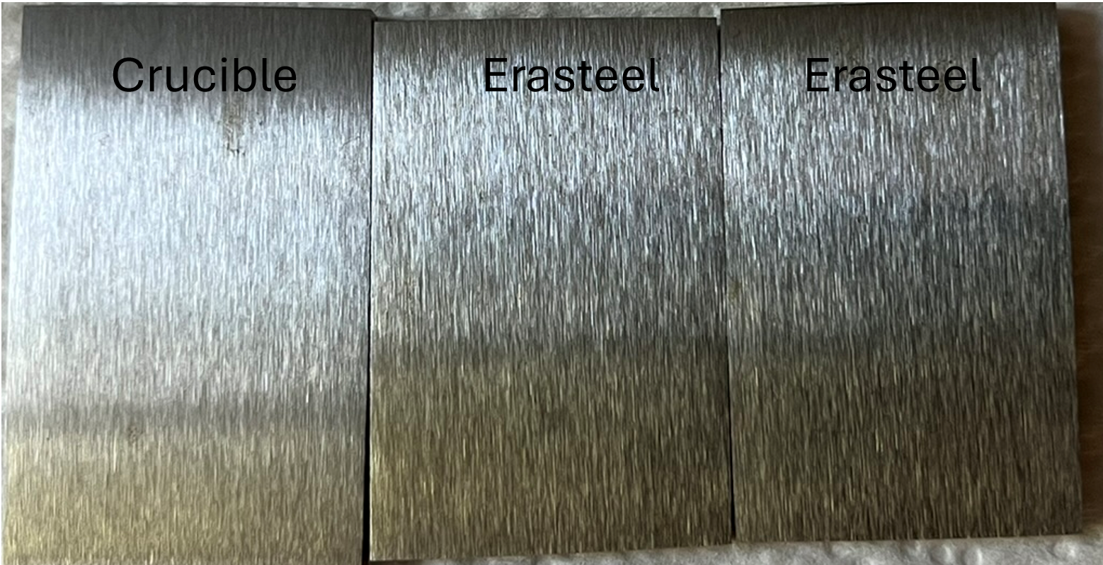

Erasteel vs Crucible MagnaCut
One very important part of MagnaCut is its high corrosion resistance. So I tested with my standard 1% saltwater spray test. Most stainless knife steels will see some rust spots with this test. In this case neither the Crucible or Erasteel material showed any rust spots:

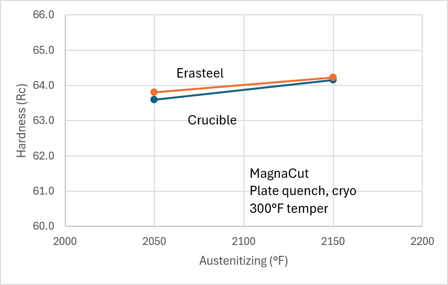

I also tested the hardening response. For a given heat treatment the hardness was very similar, perhaps the Erasteel material was slightly higher:

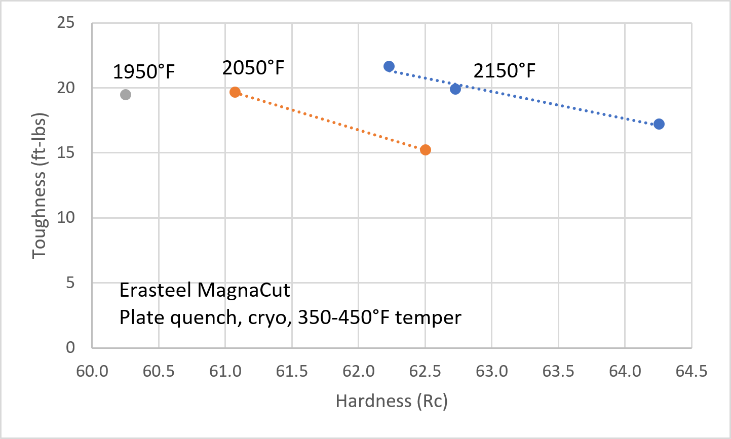

Surprisingly (based on the Z-Wear and M390 results), the toughness of Erasteel MagnaCut was significantly higher:

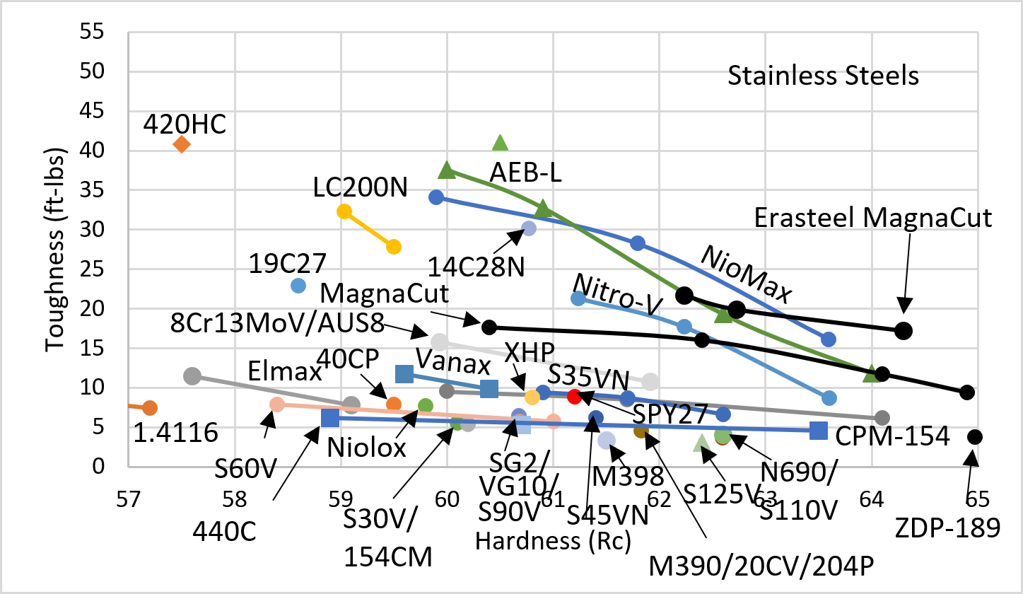

You can see that the Erasteel MagnaCut was significantly higher, matching AEB-L at ~62 Rc, and exceeding it at ~64 Rc. I wouldn’t necessarily extrapolate that up to AEB-L levels at 60-61 Rc but in that hardness range it was very good. Comparing with non-stainless steels this also makes Erasteel MagnaCut look more competitive:
While Crucible MagnaCut was a bit below the best results of CPM-CruWear and Z-Wear, the Erasteel version matches or exceeds it. In my knife steel ratings I had given MagnaCut a “7” for toughness and CPM-CruWear an “8,” so this is exciting. MagnaCut has a similar carbide volume to CPM-CruWear but has even smaller carbides so it was always a bit disappointing that the measured toughness wasn’t matching it. Perhaps this was a case where oxide inclusions were reducing toughness slightly in the Crucible version. Erasteel MagnaCut even roughly matched the new Bohler K888 steel, advertised for its high toughness, and tested better than steels like Vanadis 4 Extra. One thing to note is that toughness differences are basically on a “log scale,” meaning that differences at small values are bigger than those at large values. So the difference between 5 and 10 ft-lbs is about the same as between 10 and 20 ft-lbs.
One difference I noted in toughness testing is that using an austenitizing temperature of 2150°F (1175°C) and then tempering to desired hardness led to better toughness than lower austenitizing temperatures. With Crucible MagnaCut the optimum property balance was with 2050°F (1120°C).
You can see that for a constant toughness of ~20 ft-lbs that the hardness can be higher for that same toughness with a higher austenitizing temperature, about a 2.5 Rc increase.
The MagnaCut now being produced by Erasteel matches or exceeds the properties of the previous Crucible version. Specifically the toughness showed an improvement. We will continue to monitor the properties of the new material to ensure the performance meets expectations with the new manufacturing partner.
