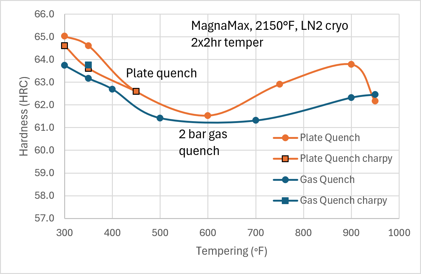

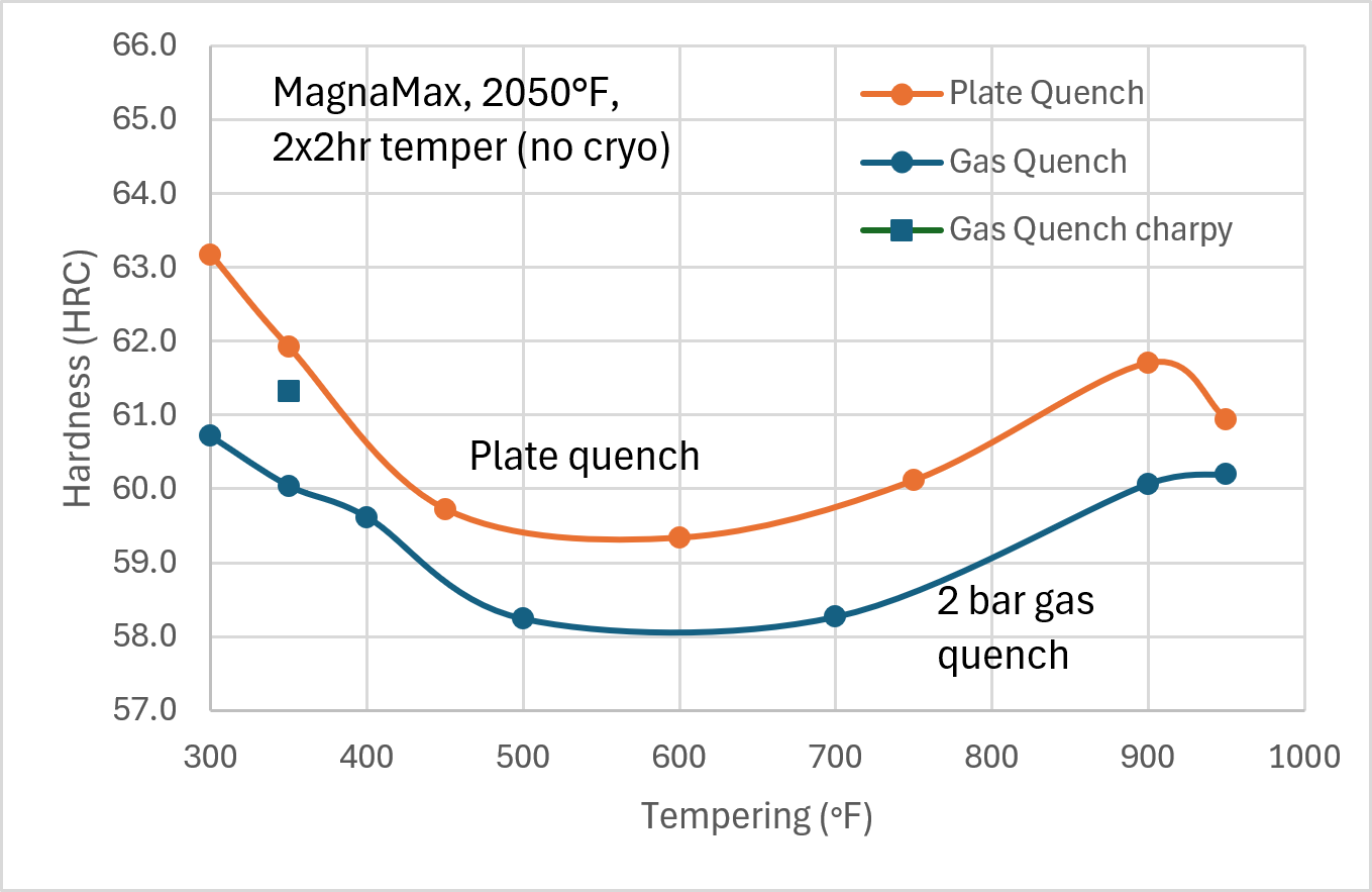

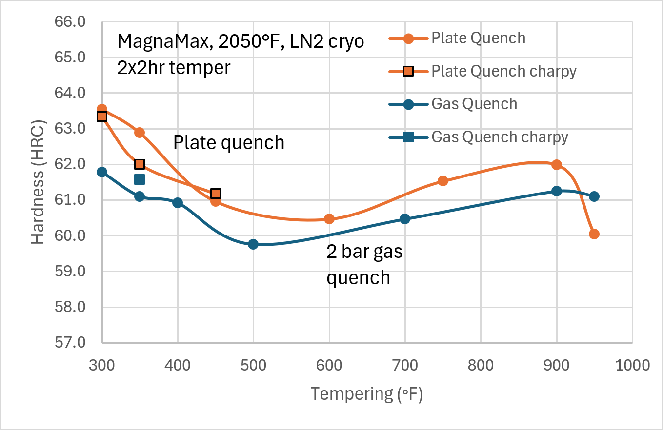

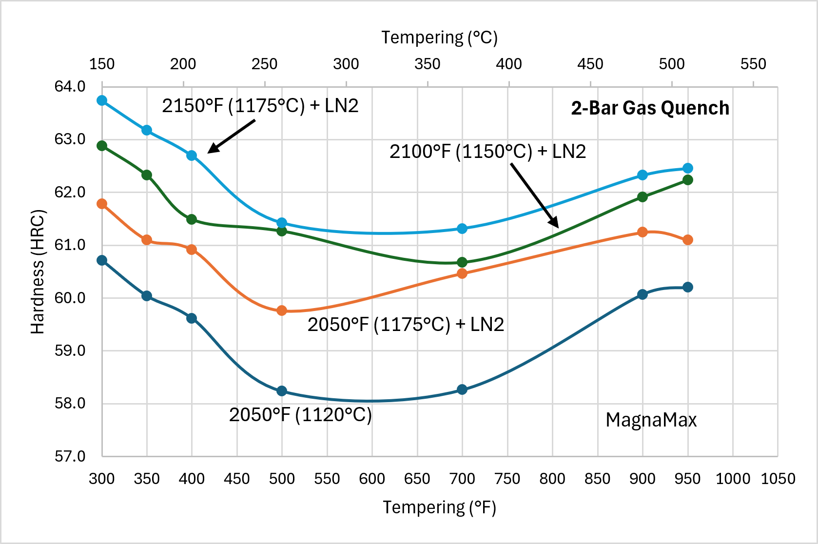

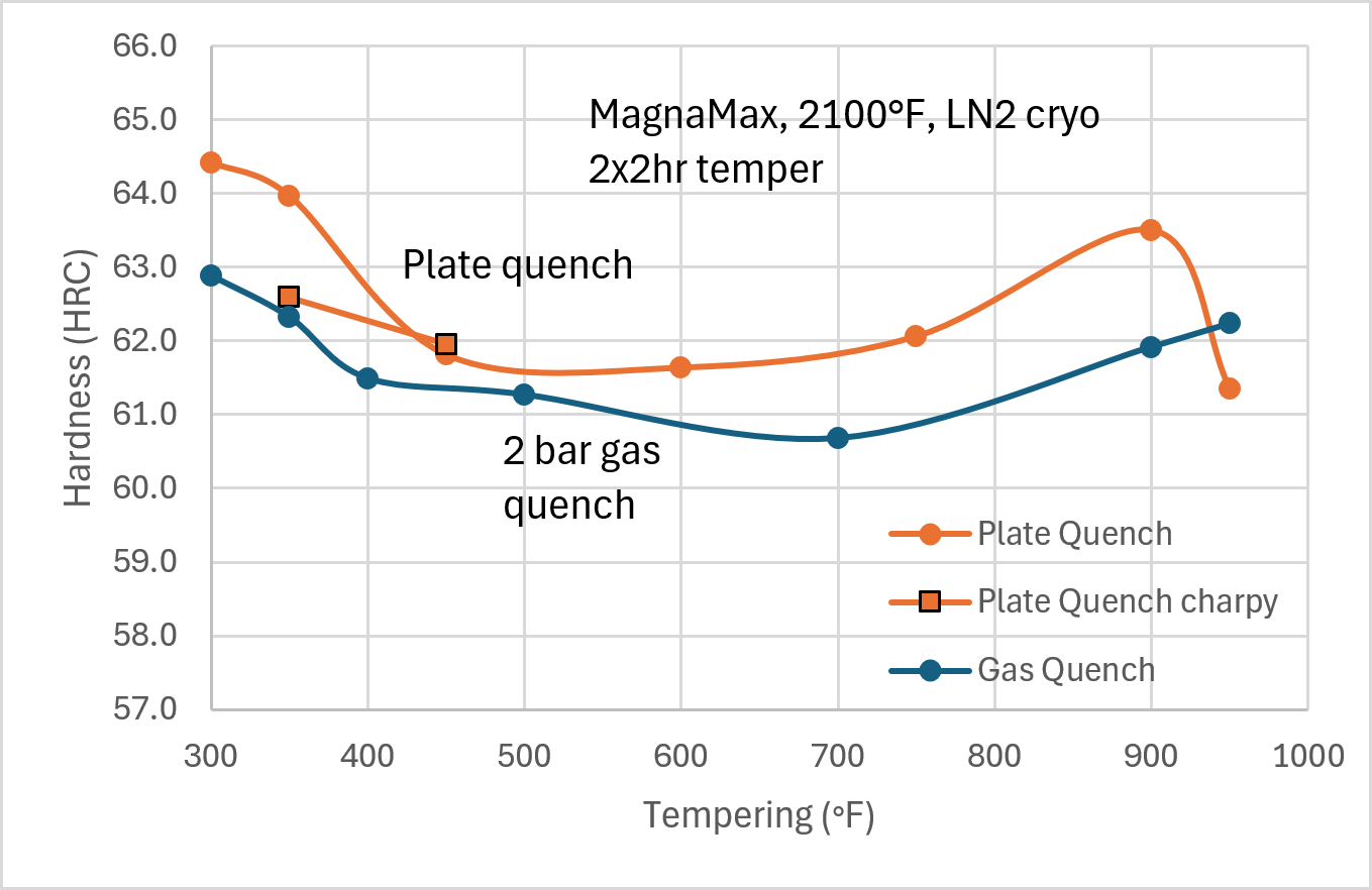

I worked with Peters’ Heat Treating to test the large scale heat treating of MagnaMax. Fortunately we had the previous data already from the plate quench heat treatments which narrows down the range of things we needed to test. Typically the “optimal” temperatures do not change with the slower cooling rate, just the resulting hardness and toughness. We used 1 x 3 inch coupons for each heat treatment to measure the hardness. 2050°F was used with and without cryo, and 2100°F and 2150°F austenitizing temperatures were used with cryo only. For each of those austenitizing temperatures they were tempered at 300, 350, 400, 500, 700, 900, and 950°F. They were quenched with a “2 bar” pressurized gas quench, which means roughly twice the pressure of the atmosphere. I measured the hardness for each of these which generated the following chart:
I also measured the hardness of the charpy coupon specimens which used 2050-350°F (with and without cryo) and 2150-350°F. These came up a bit higher in hardness then the hardness coupons, perhaps because they were smaller (0.4 x 2.17 inches). With the plate quench heat treatments the situation was reversed where the charpy coupons tested a bit lower than the hardness coupons. The hardness coupons for plate quenching were 1 x 1.5 inches and the charpy coupons were heat treated in groups of three so the overall dimensions were 1.5 x 2.17 inches. So I plotted the hardness for all of those conditions to compare the plate quench to the gas quench:
So you can see that the gas quench generally led to somewhat lower hardness than the plate quench, as expected from the slower cooling rate. This is one of the reasons why knife companies can have a harder time reaching the same hardness values of a custom knifemaker. There are other factors as well, such as the knife company heat treating many more knives, which means that there can be more variation in temperature within the large furnaces, and variation in steel composition by using steel from multiple batches over multiple years. So this explains why knife companies typically advertise hardness with a range, such as 61-63 HRC, from the factors I just mentioned plus also statistical variability in the hardness testing itself.

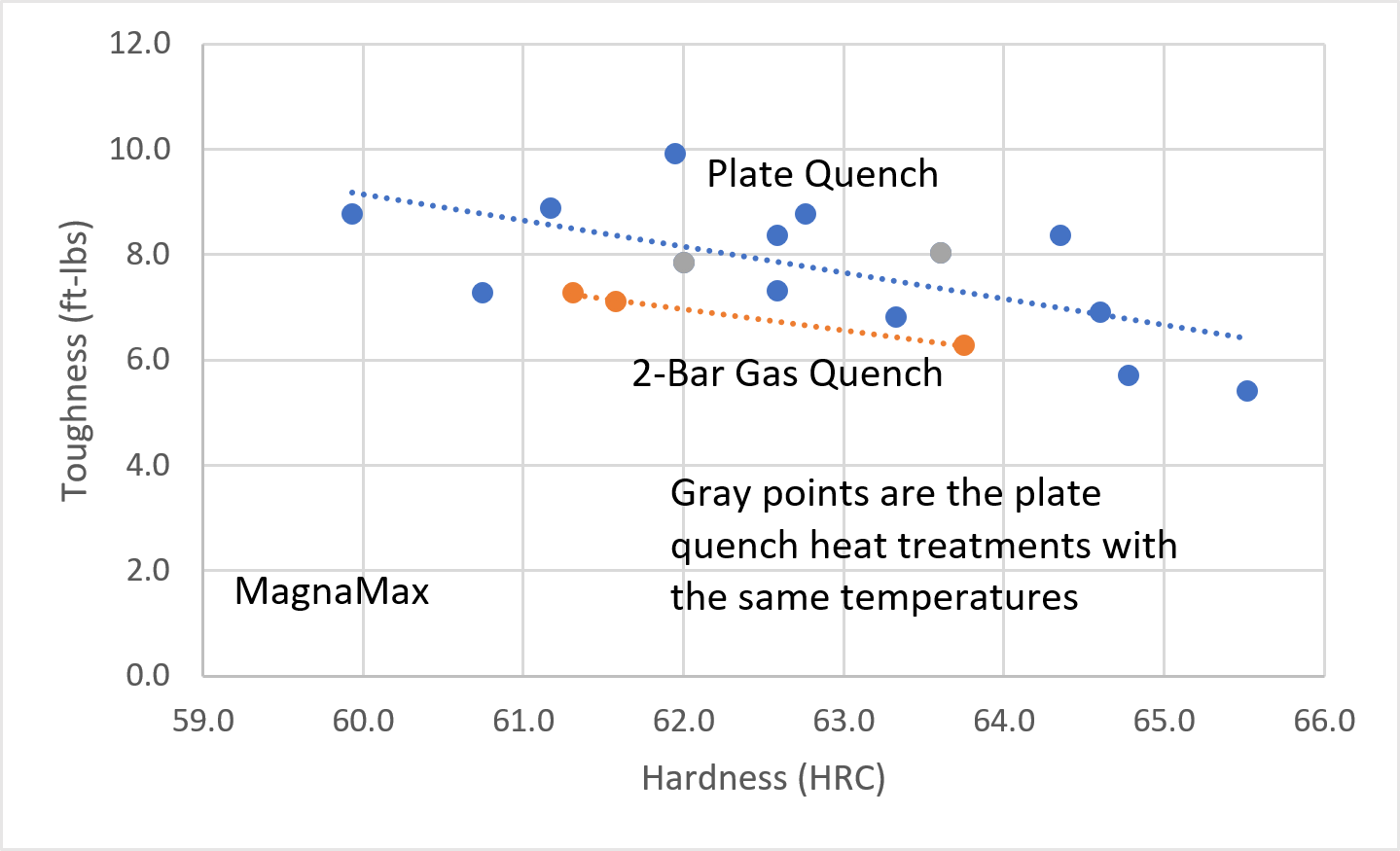

The 2050-350°F coupons tested relatively similarly with and without cryo, despite the two conditions being about 1 HRC different with the hardness coupons. The non-cryo condition measured 61.3 HRC and the cryo condition measured 61.6 HRC. The 2150-350°F coupon measured 63.8 HRC. The toughness decreased linearly with higher hardness. When comparing to the plate quench, the toughness is slightly lower as expected:
