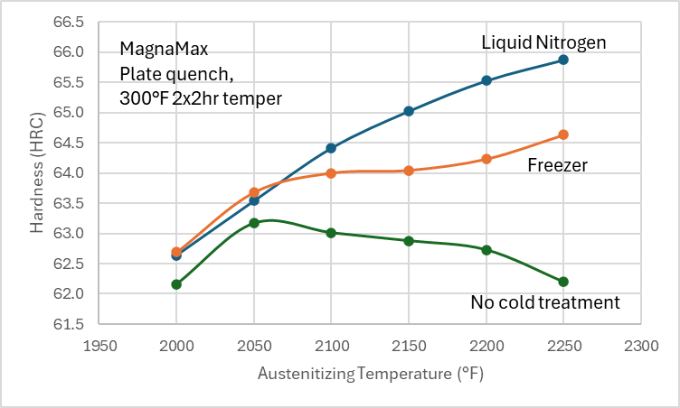

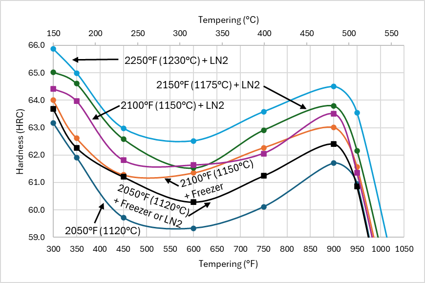

Hardness and Cryo
I first made a series of coupons to test the hardening response, including with the addition of a freezer or liquid nitrogen treatment after quenching. I used the soak times in the section above.
You can see that with no cold treatment the peak hardness was 2050°F (1120°C) after tempering at 300°F (150°C). Hardness drops with higher temperatures from excess retained austenite. Hardness rose when using liquid nitrogen all the way to 2250°F (1230°C). It would be unlikely to keep rising much beyond this temperature and the possibility of melting grain boundaries starts to become more of a danger. The freezer also rose all the way up to 2250°F but to a lesser extent. Because the increase was small beyond 2100°F (1150°C) this is why I limited my recommendation for the freezer to that temperature. That makes me think both the retained austenite and hardness of the martensite were increasing beyond that temperature, leading to relatively flat behavior. Excess retained austenite can lead to worse sharpening behavior when deburring. Overall this hardening response is not radically different than MagnaCut.
Nothing too crazy showed up in the tempering. You can see that a cold treatment leads to less hardness loss in tempering. Compare 2050°F with and without a cold treatment, or 2100°F with liquid nitrogen vs the freezer. Note that I have a single curve for both freezer or liquid nitrogen from 2050°F, and this was because the two were sufficiently similar to have a single line. Plus don’t want to make the chart too busy.
You will also notice that the hardness reaches an initial minimum at 600°F (315°C) and then rose to a secondary peak around 900°F (480°C). This is known as “secondary hardening.” I don’t recommend tempering in that range, especially with stainless steels, because it reduces corrosion resistance. For example see two Vanax coupons below, both sprayed with 1% saltwater. The one of the left was tempered at 400°F (200°C) and the one on the right was tempered at 1000°F (540°C).

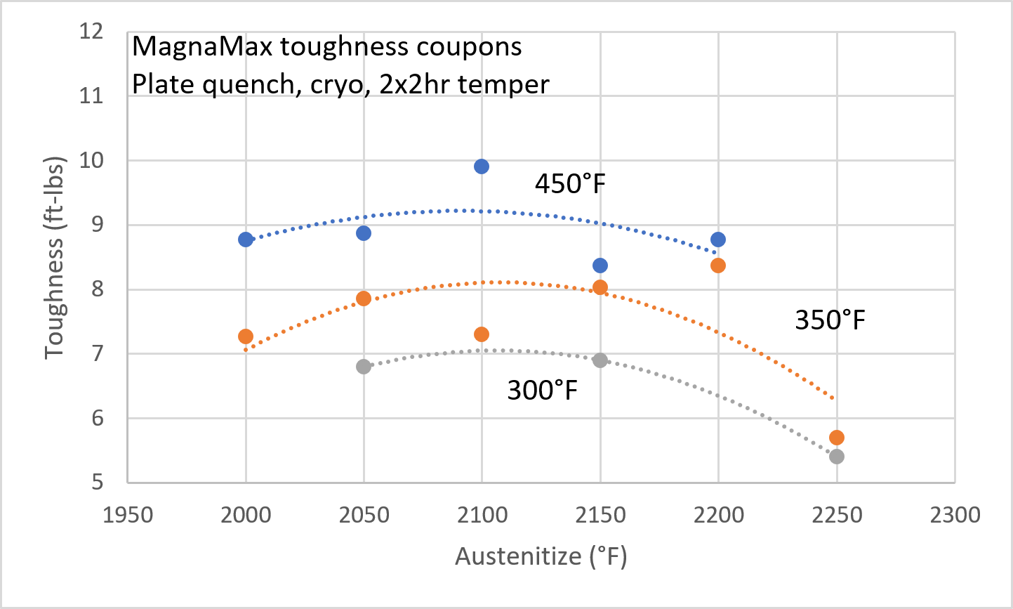

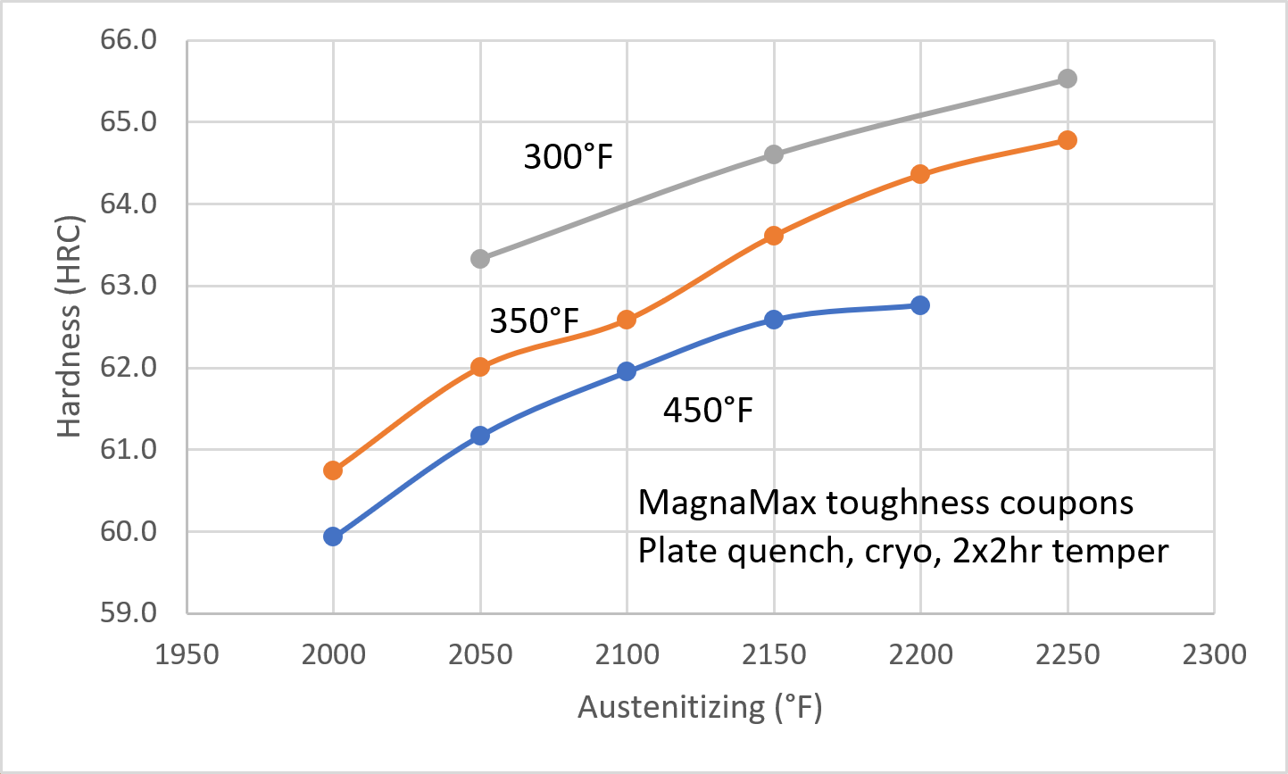

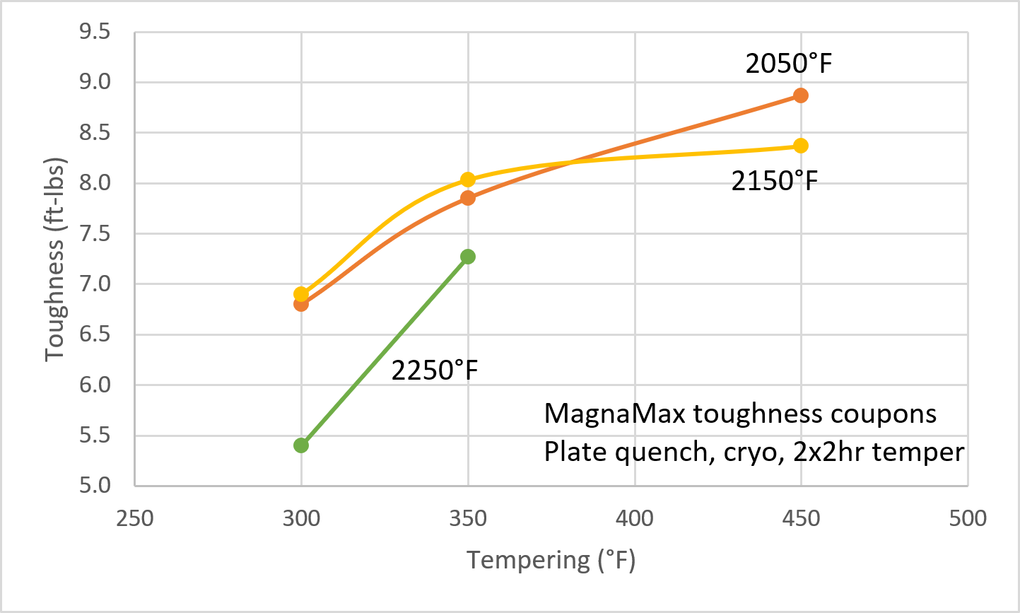

We also tested a series of charpy toughness coupons for this heat of MagnaMax. I used my standard coupon which is quarter size (2.5 x 10 mm) and unnotched. Three coupons were tested for each condition. We used liquid nitrogen in the heat treatment of all of these coupons directly after the quench. We used austenitizing temperatures of 2000-2250°F (1095-1230°C) and tempering temperatures of 300, 350, and 450°F (150, 175, 230°C).
The hardness was slightly lower than the small hardness coupons I showed results from before:
Looking at the resulting toughness, it rose from 2000 to 2050°F (1095 to 1120°C), was relatively flat up to 2200°F (1205°C), and then dropped somewhat up to 2250°F (1230°C). This is why I recommended a baseline austenitizing temperature of 2150°F (1175°C) as this appears to be roughly the peak hardness-toughness, though an argument could also be made for 2200°F (1205°C), in part due to a couple of the 2150°F results being on the low end and a couple of the 2200°F being on the high end. This is likely due to statistical variability of testing.
You can also see that toughness increases with tempering temperature as we would expect, which also corresponds to a hardness decrease. Lower hardness generally correlates with higher toughness.
There was a greater increase in toughness between 300 and 350°F (150-175°C) than between 350 and 450°F (175-230°C), which is why I recommended 350°F (175°C) as the baseline tempering temperature.

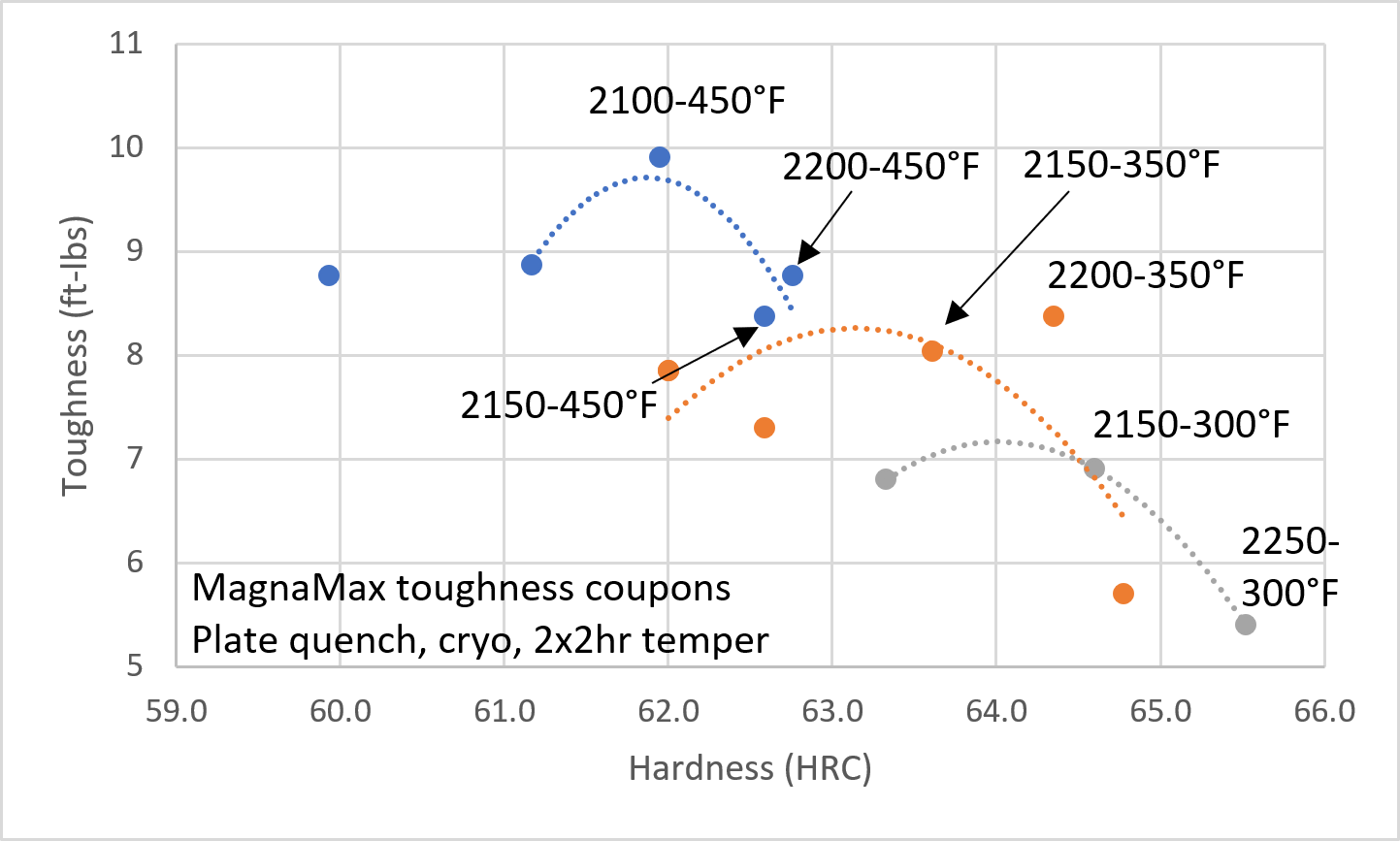

Hardness-Toughness Balance

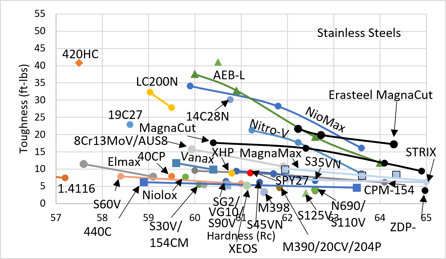

But what we would like to maximize is the highest toughness for a given hardness. So I plotted hardness vs toughness below.
You will notice that the maximum hardness-toughness combinations were generally 2150-2200°F (1175-1230°C) and tempering at 350-450°F (175-230°C). The exceptions include: 1) 2100°F (1150°C) with 450°F (230°C) because that combination gave the best properties for lower hardness. And 2) For maximum hardness you need 2150-2250°F (1175-1230°C) in combination with the minimum tempering temperature of 300°F (150°C). I next overlaid those best heat treatment conditions on top of the similar non-stainless steels K390, Vanadis 8, and CPM-10V:

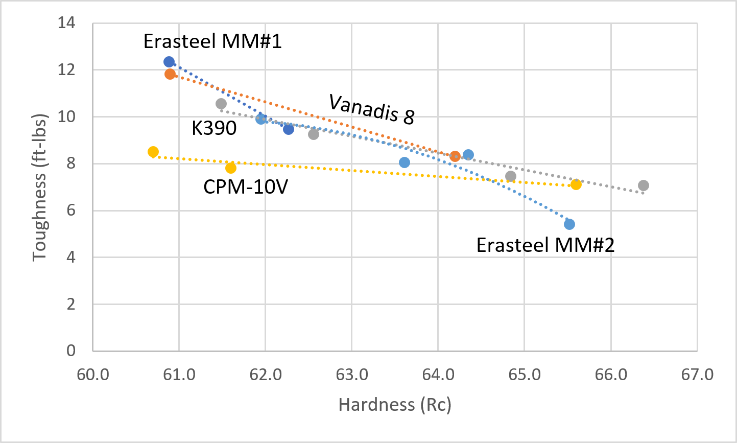

Erasteel MM#1 is the first heat that was shown in the prior article about MagnaMax properties, and Erasteel MM#2 is the final tested material above. You can see that both have a similar hardness-toughness balance, though the new one is skewed to somewhat higher hardness, as expected from more carbon. You will also see that the toughness is very similar to K390 and Vanadis 8, an excellent result given that MagnaMax is a stainless steel with similar wear resistance. So we greatly improved corrosion resistance over those steels while maintaining their other properties. I next plotted those hardness-toughness values vs other stainless powder metallurgy steels:

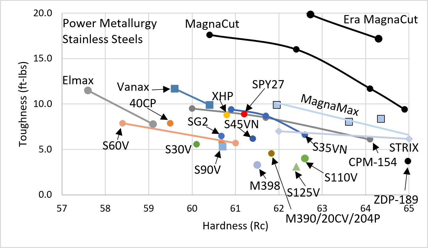

You can see that MagnaMax has superior hardness-toughness than virtually all of the powder metallurgy stainless steels apart from MagnaCut. This includes steels with a good reputation for toughness including Vanax, XHP, S35VN, and CPM-154. And below I have the more complete graph of stainless steels which is a bit busy:
