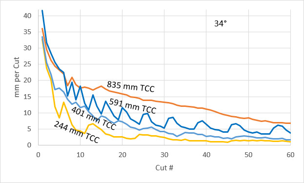

Below I have another Youtube video of CATRA testing so that you can see how the curves are generated during testing.
You can get a feel for how differently these steels cut by plotting a few of them together with the same edge angle. The top curve is a high wear resistance steel which cut 835 mm of cardstock after 60 cuts, which is the TCC value (Total Cardstock Cut). The 244 mm is a medium-low wear resistance steel which shows much more sharpness loss than the higher wear resistance steels.

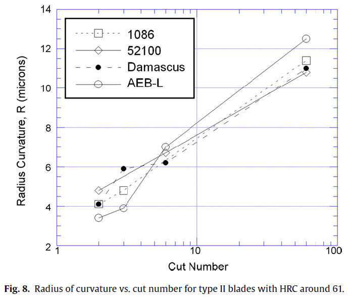

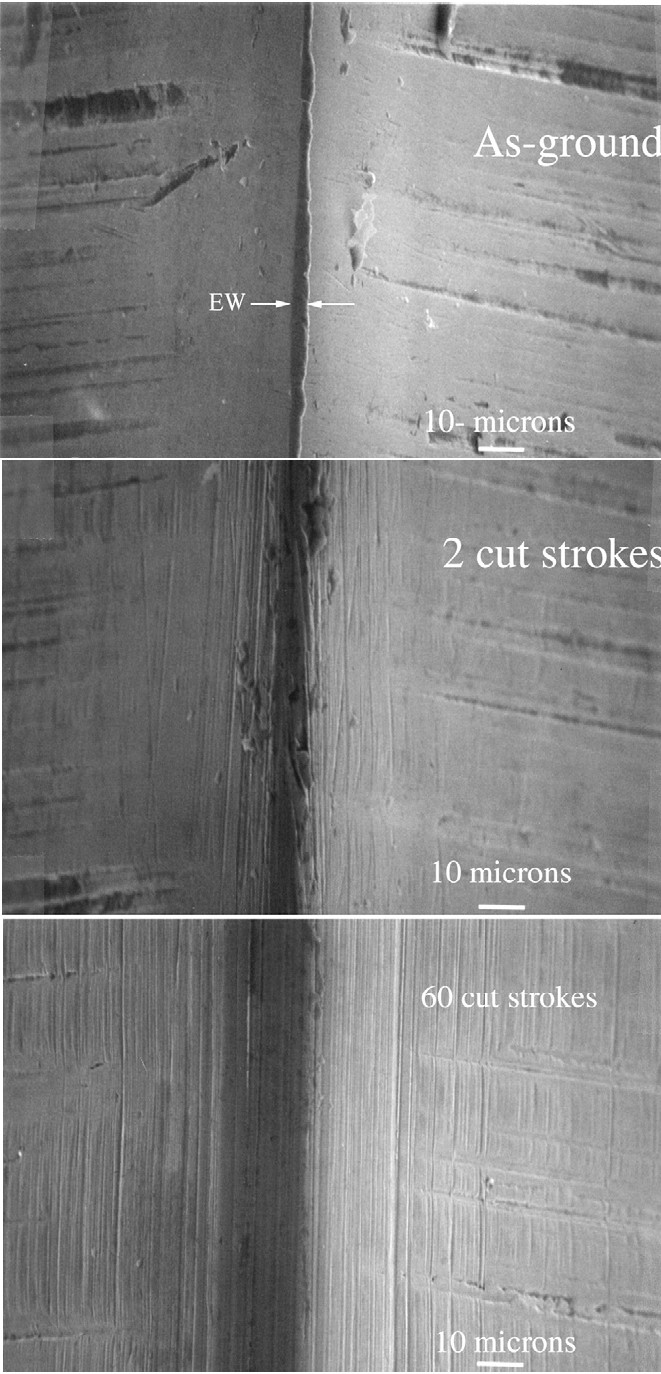

Edge Radius During the CATRA Test
I’m not sure where in the test the average person would decide that the knife needs to be resharpened, but I would guess that it is before cut 60 because the CATRA test wears the edge pretty significantly. In CATRA tests performed by Verhoeven [1] the edge radius was reduced from ~0.5 micron all the way to 3-5 microns after only the second cycle (note he calls the cycles strokes):
The tests performed by Verhoeven were with low wear resistance steels (AEB-L, 52100, 1086, and Wootz) but it still shows the relatively significant wear that occurs with the CATRA test. In the CATRA article on 154CM, it was found that the edge width (rather than radius measured by Verhoeven) was increased to 23 microns with a 20° edge angle and the 50° edge to 17 microns, which is quite dull. A ten micron edge width has been reported previously as a dull edge that needs sharpening [2].

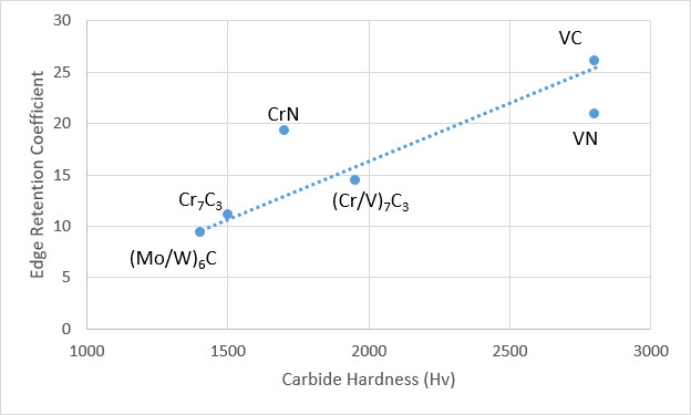

Carbide Hardness
Taking an average value of the hardness of each carbide type we can compare between carbide hardness [3][4] and the calculated coefficient. Below I have plotted the carbide hardness in vickers (Hv) on the x-axis vs our calculated coefficient in the equation above for the relative contribution to edge retention for each carbide type. We get a very good correlation, demonstrating that carbide hardness strongly controls the effect of a carbide on slicing edge retention:
The coefficient for VC (listed as MC in the equation) is somewhat higher than the nitrogen version (VN or MN) despite their reported similar hardness [4]. Either the VN is actually somewhat softer or this is due to the VN coefficient being based on only two CATRA tests on one steel (Vanax 35). Either way it appears to be qualitatively accurate. Another possibility is that there may be some formation of V2N or chromium carbide/nitride which is lower in hardness than VN. The value for CrN also falls off the trend line of the others but that value comes from only one steel, Cronidur 30, and would likely change if further tests were performed. The M6C value is based on only two steels, CPM-M4 and M2, which both get wear resistance from VC so the accuracy of the M6C coefficient could definitely be improved with other high speed steels. No simple carbon steels with Fe3C cementite were tested which would be nice to add to the regression. Due to the low hardness of cementite it would be expected to have a relatively low value. This is confirmed by the Verhoeven study comparing 52100, 1086, and AEB-L where AEB-L with chromium carbides had superior edge retention to 52100 and 1086 with cementite [1]. If we extend the trendline in the plot above to the hardness of cementite we would estimate a coefficient of 5, or about half of chromium carbide. Experiments would be necessary to confirm that. Another interesting set of tests would be on the low-alloy tungsten steels such as the Blue series, V-Toku series, F2, O7, etc. The tungsten carbides in those steels are reported to be the very hard WC so it would be nice to know if that carbide improves edge retention to the same extent as VC. They are relatively niche steels so they have not received as much study as many tool steels and stainless steels. I wrote about these low-alloy tungsten steels

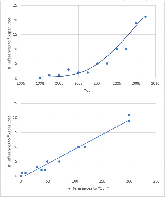

Super Steel
I see frequent references to “super steel” online, and I was curious about how long that terminology has been around. I did searches on bladeforums as it is one of the oldest knife forums. The number of references to “super steel” has increased over time, but so have the number of posts on bladeforums. I saw how many references to “super steel” there were in each year, and then as a proxy to how many posts there were on bladeforums I did a search for “154” and saw how many references there were each year. Google tops out at 200 results but at that point the dataset was big enough to get an idea:
So referring to steels as “super steel” or the category of “super steels” is at least as old as still-existent knife forums on the internet. Reading through the descriptions of “super steel” now and for as long as bladeforums has existed, they are typically defined as one or more of the following [1][2][3][4]:

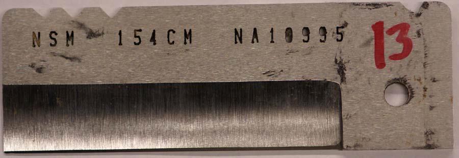

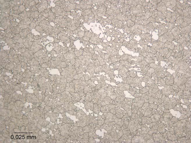

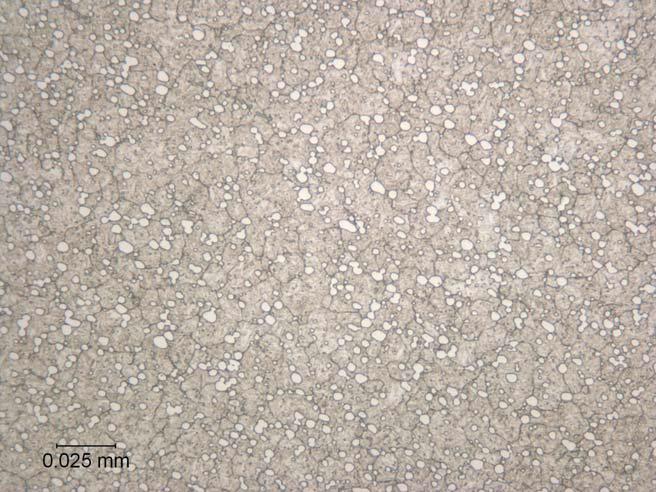

In 2012 a set of edge retention tests were performed by Wister Hill who commissioned the manufacture of a set of knives in 154CM and CPM-154. Though the tests were completed in 2012 the results have never been published. You can read an article about 154CM here: 154CM – Development, Properties, Use in Knives, and Legacy. These steels have the same composition but 154CM is produced by conventional ingot metallurgy and CPM-154 is produced by the powder metallurgy process. The use of powder metallurgy leads to a very different carbide structure, as the powder metallurgy version has much smaller and more evenly distributed carbides. The carbides are very hard particles that greatly contribute to wear resistance of steel. Based on their smaller size and better distribution we might expect the powder metallurgy version to do better in a thin edge. Here are micrographs taken from the steel used in the CATRA study:
Conventional 154CM
Powder Metallurgy CPM-154
Niagara Specialty Metals donated the steel, the blanks were then cut out and rough hollow ground, then heat treated by Peter’s Heat Treating. Knifemaker Butch Harner then did the final grinding of the blades. The blades were sharpened by Jason Bosman using DMT diamond plates of 325, 600, 1200, or 8000 grit with a DMT angle guide. The knives were given different edge angles of 56, 50, 34, 27, and 20° total (half of that per side). The final angle of the edges was then tested with a CATRA geniometer. The knives used a flat profile designed to work easily with the CATRA tester:

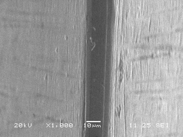

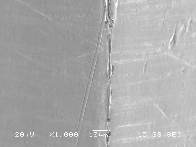

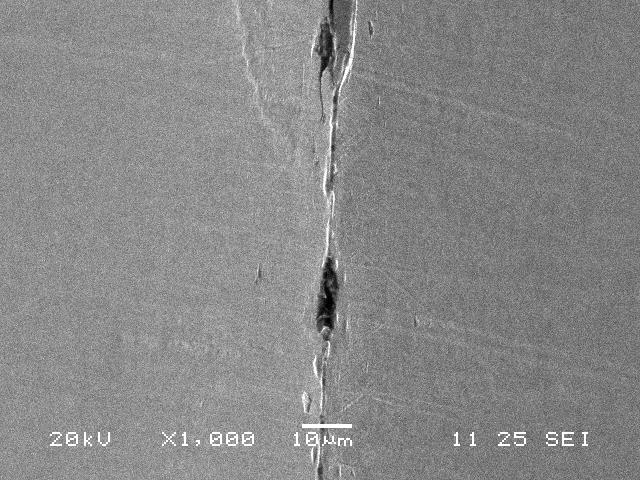

Sharpened Edges

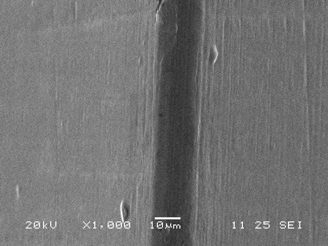

Here are two edge-on micrographs of the CPM-154 and 154CM knives. I believe these were sharpened to 8000 grit as the scratches are all under 3 micron. If I get confirmation of what the edges were resharpened to prior to the micrographs I will update this article. The edges are approximately 1.5 microns at the apex. however, there are “holes” in the 154CM edge which are about 4 microns wide which may be evidence of “carbide pullout” where a large carbide or string of carbides is lost during sharpening.
Ingot 154CM

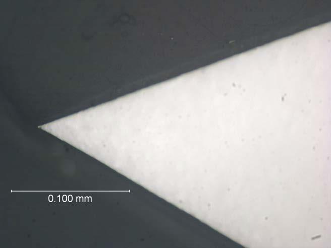

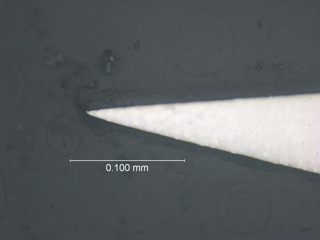

Effect of Edge Angle

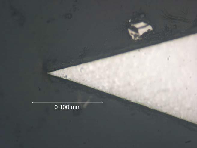

With a fixed edge thickness the height of the final edge increases with lower angles:
Micrographs taken of the profile of the edges show that the target angles were achieved:
50°
34°
20°

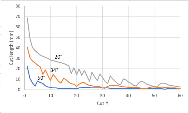

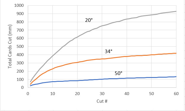

Edge angle had by far the strongest effect on edge retention, much stronger than other effects such as PM vs ingot and the finish it was sharpened to. Here are graphs showing the performance of 20, 34, and 50° vs cut length for an individual cut and also for total card cut in mm:
You can see that the initial cut length with a smaller angle is considerably higher and that the difference holds basically to the end of the test. This finding is significant because some have speculated that lower angle edges start out sharper but a more obtuse edge lasts longer [2]. And with the high wear that occurs in the CATRA test it isn’t likely that the situation would reverse with even further cutting. The initial blunting rate is relatively rapid regardless of angle and it then begins to level out. The highest TCC measured was over 1000 mm with an angle of 20°, and this decreased all the way to under 100 mm with 56°. In a CATRA study by Bohler-Uddeholm [3] with a range of steels, but unspecified edge geometry or sharpening, 154CM was measured at 547 mm, and M390 was measured at 959 mm. The 547 mm value would be with an edge angle around 30° in this study if other parameters are similar. So if the edge angle of a 154CM knife is reduced from 30° to 20° then it can match or exceed a steel with 75% greater wear resistance.
There was a difference in final thickness of the apex of the edge after the knives were run through the CATRA test. The 20° edge was about 23 microns after the test, 34 degrees led to about 19-20 microns, and the 50° were around 16-17 microns. All of these images are of the ingot 154CM steel. So it appears that with a lower angle edge it can wear down to a larger apex and still maintain better cutting ability than a higher angle edge.
20° worn edge (23 microns)
34° worn edge (19 microns)
50° worn edge (17 microns)
