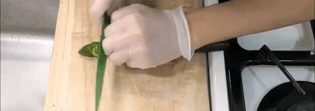

Acidic Food
Carbon steel knives are frequently used in kitchens, probably the majority of them made by Japanese bladesmiths and knife companies. Kitchen knives cut a variety of foods, and some of them are corrosive. There has been some debate about whether any of these potentially-corrosive foods can actually affect sharpness or edge retention of kitchen knives. Sharpness is controlled by the radius/width of the edge. You can read more in the article on sharpness vs cutting ability.

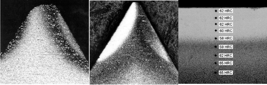

CATRA, Sharpness, and Cutting Ability
I got several good comments on the article about CATRA edge retention testing regarding sharpness and cutting ability. The edges tested with more acute angles (20° edge is more acute than 50°) started out cutting better and remained that way through the standard 60 cuts. However, the measured width of the edge with the worn 20° edges was larger than with the 50°. So this leads to a question: which was sharper? And if the 50° was indeed sharper due to its narrower edge then why was it not cutting as well?
