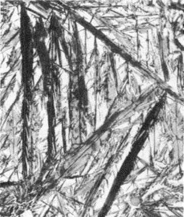

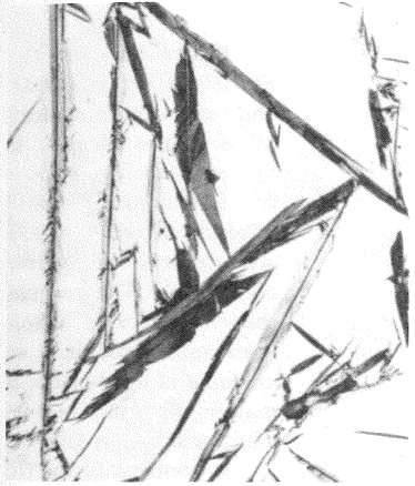

Martensite Formation
Martensite formation is largely not based on time for transformation because the transformation is diffusionless and rapid; it occurs through a small shift in the atoms. Martensite forms based on the temperature that the steel reaches; the transformation starts at the martensite start temperature (Ms) and finishes at the martensite finish temperature (Mf). Martensite laths form within the prior austenite and any austenite that does not transform is retained austenite:

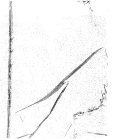

Here is another view with static images, where the surrounding white phase is austenite and you can see the martensite laths/plates forming within. There is a significant amount of retained austenite even in the final image as can be see by all the white space [2]:

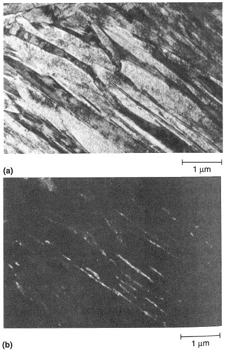

And here is an image of heat treated H13 tool steel, first a high magnification image of the martensite laths, and then an alternate view with only the fine “interlath” austenite films visible. Thin, elongated austenite films are more stable due to their shape and size, so these thin films are often what is left over after heat treating [3]:

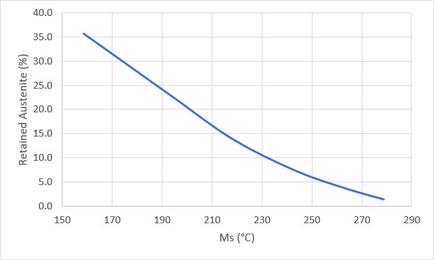

Martensite Start and Finish

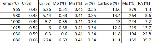

The Ms temperature is controlled by the amount of carbon and alloy that is in the austenite prior to quenching. Carbon is the strongest element for reducing the Ms temperature, but other elements also reduce Ms [4][5]:
Ms (°C) = 539 – 423*C(%) – 30.4*Mn(%) – 12.1*Cr(%) – 7.5*Mo(%) – 7.5*Si(%)
You can see that as the martensite start temperature (Ms) is reduced that the martensite finish temperature (Mf) is also reduced. In fact the Mf temperature can be below room temperature. This is the reason why austenite is retained after quenching, because the martensite finish is below room temperature and therefore the transformation to martensite is never totally complete. So if we return to the D2 steel above, we can use Thermodynamic software to calculate how much carbide is dissolved, how much of each element is in solution with increasing austenitizing temperature and how much that reduces our Ms temperature and correlate that with retained austenite content:

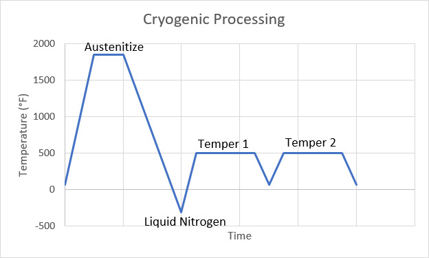

Cryogenic Processing

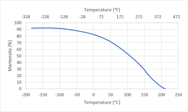

When martensite finish is below room temperature, we can use cold temperature treatments to transform more of the austenite to martensite. Here is the transformation of austenite to martensite vs temperature for T1 steel austenitized at 2350°F [6]:
Cold Treatments
The colder you go the more austenite will be transformed. If transforming austenite is the goal then colder is better. Commonly available methods for achieving colder-than-room-temperature include the household freezer (0°F/-18°C or lower, down to -20°F or so), dry ice and alcohol (-110°F/78°C), and liquid nitrogen (-310°F/-195°C). Here are those approximate temperatures overlaid on the martensite formation figure:
Not all of the austenite was transformed, even at liquid nitrogen temperatures, leaving about 8% retained austenite no matter how cold the steel is. I don’t know if more could be transformed through more rapid quenching or if the austenite is stable due to size or morphology and not affected by temperature. The austenite that did transform was sufficiently “unstable” for the conversion to martensite at low temperature. The transformation was complete around -100°C, therefore even with dry ice nearly all of the unstable retained austenite was transformed. Even with household freezer temperatures about half of the unstable retained austenite was transformed, Therefore even a freezer can transform some the retained austenite when heat treating tool steels.

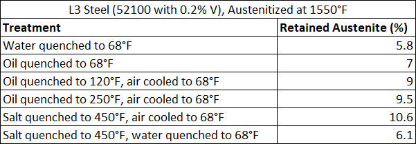

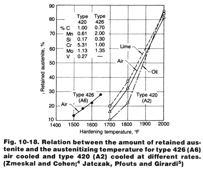

Quenching Rate
There is a similar effect of quenching rate, here is the retained austenite for A2 with different quenchants [7][8]:
Lime insulates the steel so that the cooling rate is even slower than air, and quenching in oil is faster than air. The effect is similar to the delay between quenching and cold temperature treatments above, only in this case the austenite is stabilized during the slow quenching.
Interrupted Quenching
The same effect is seen with interrupted quenching [9]. If the steel is quenched to a higher temperature and air cooled the time required for austenite stabilization is less due to the higher temperature where diffusion is faster.

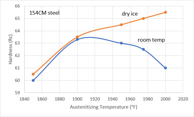

Because of the extreme changes in temperature that occur in the steel during subzero or cryogenic temperature treatments, there is a chance of cracking during these cold treatments. This is particularly possible with thick sections or complex shapes, similar to the situations that exacerbate quench cracking. The cracking can occur due to uneven transformation throughout the steel. During cooling the surface reaches a lower temperature first while the “core” is somewhat warmer, depending on the cross-section. Therefore, the surface will transform to martensite first which expands the surface relative to the core. These uneven temperature distributions and size changes can lead to cracking. Untempered martensite is also inherently brittle which can lead to cracking if the steel is not tempered in a timely fashion. This issue can be exacerbated by cooling the steel to even lower temperatures, because steel is more brittle at lower temperatures. Because of the uneven temperature distribution and the brittleness of untempered martensite it is sometimes recommended to temper the steel prior to a cold treatment. However, the tempering treatment also partially stabilizes austenite for the reasons described above. There is a tension between the goals of transforming the maximum amount of retained austenite while also avoiding cracking. There are reports from some knifemakers that they have never had a crack with liquid nitrogen treatments, but your mileage may vary. One intermediate choice is the “snap temper” where the steel is tempered at 200-300°F for 30-60 minutes prior to a cold treatment.

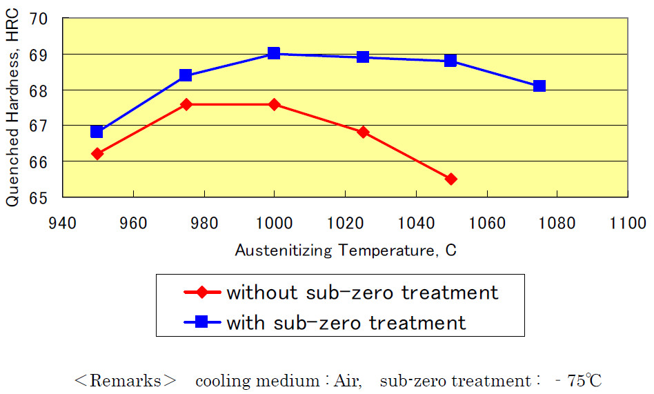

When retained austenite is transformed to martensite then the same drop in hardness is no longer seen with increasing austenitizing temperature. Here is an example with 154CM steel [11]:
The difference in hardness between the room temperature quenched and the dry ice steel increases with higher austenitizing temperature because there is more retained austenite to transform. With sufficiently low Ms there is a point reached where dry ice is no longer sufficient for transforming the retained austenite and there is a drop in hardness even with a subzero process, such as here with ZDP-189 [12]:

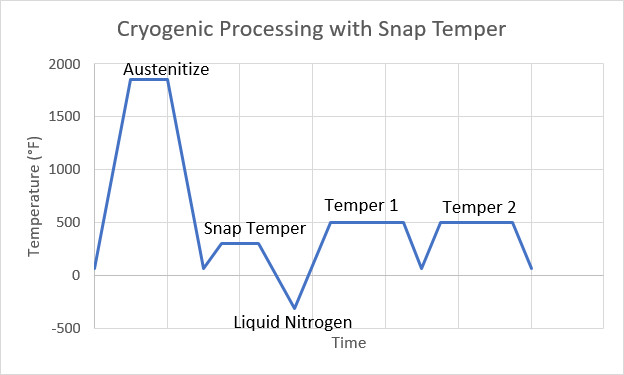

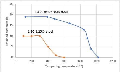

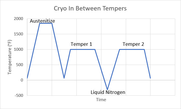

Cryo In Between Tempering
Sometimes performing a cryo step is recommended between the first and second temper in part so that cracking is avoided. However, cryogenic processing is not done between tempering steps only because the initial temper is performed to avoid cracking. During tempering the following things can happen to retained austenite:
- Stabilization of retained austenite
- Decomposition of austenite to bainite or ferrite+carbides
- Destabilization of austenite so that it transforms to martensite upon cooling
You can read more about those second two mechanisms in this article on tempering. The second mechanism primarily happens with simple, low alloy steels like forging steels. High alloy steels have alloy additions like chromium and molybdenum that prevent the decomposition of austenite and the destabilization occurs at higher tempering temperatures. You can see an example of a low alloy steel (1.1C-1.25Cr) and high alloy steel (0.7C-5.0Cr-2.3Mo) below [13][14]:
These high alloy steels that see their austenite “destabilized” during high temperature tempering see the austenite transform to martensite during cooling to room temperature. This happens in a similar way to quenching steel from the austenitizing temperature, with a new Ms and Mf for the martensite formation that occurs. And the Mf temperature can be below room temperature. Therefore, some have recommended using cryo between tempering steps with high alloy steels so that the austenite transformation is more complete after destabilization. This is also the reason why multiple tempers are recommended rather than simply tempering for a longer amount of time. The destabilized austenite must be allowed to transform to martensite after cooling and the newly formed, brittle, untempered martensite must be tempered.
