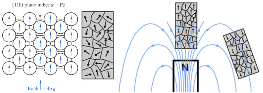

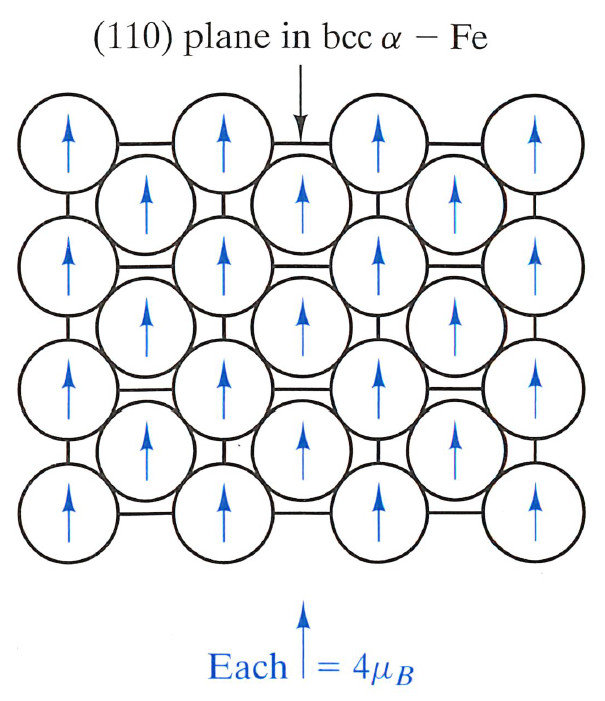

Pure iron is magnetic at room temperature. This may not be a surprise to you, as you have probably tested a magnet on some iron or steel yourself. Iron and steel is “ferromagnetic” which means that the “magnetic moments” of the iron atoms become aligned and are attracted to a magnet:
This image from [1]

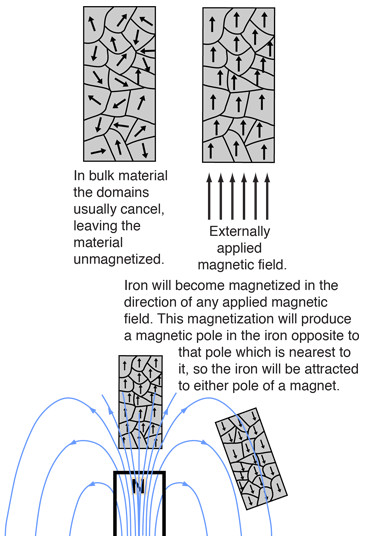

A bulk material is made up of many magnetic “domains” with their own “moment” which all have to be aligned to be attracted to a magnet:
This image from [2]

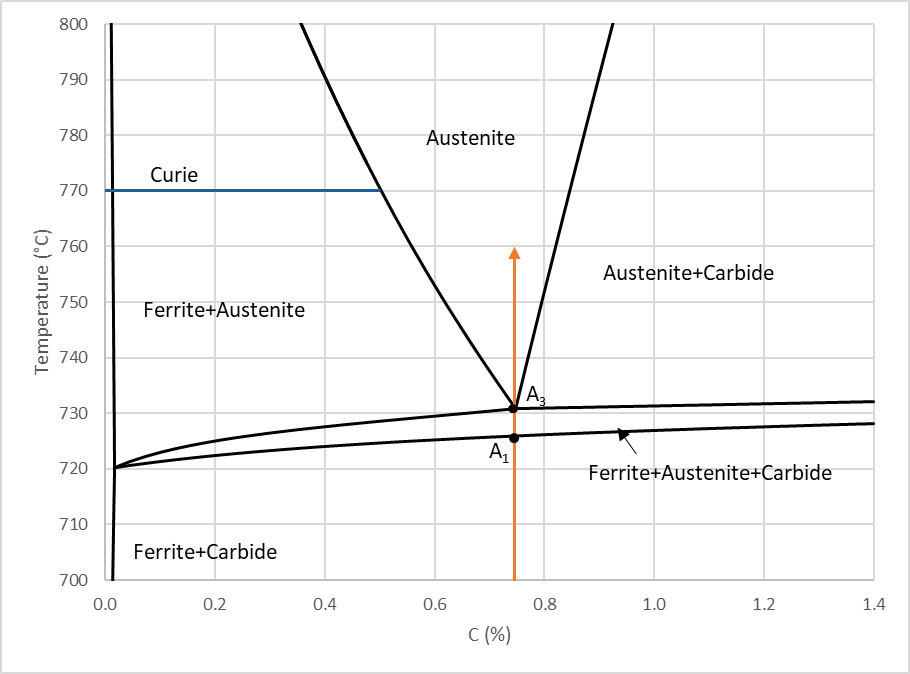

Austenite

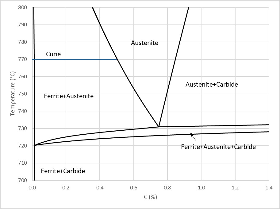

The Curie point is not the only way that steel can lose its magnetic properties, however. The above discussion is related to “body centered cubic” ferrite which refers to the way the iron atoms are arranged in the steel. Steel can also have another arrangement of atoms called “face centered cubic” austenite which is a nonmagnetic phase of steel. There are steels which are designed to be austenitic at room temperature such as “austenitic stainless steels” and therefore those steels are nonmagnetic even at room temperature. You may very well have a stainless steel sink or refrigerator which a magnet won’t stick to. Austenite is also relevant to knife steel, however, as some steels transform to austenite before they reach the Curie temperature. An easy example would be a “eutectoid” steel such as 1075/1080 where it transforms to austenite around 727°C (1340°F):

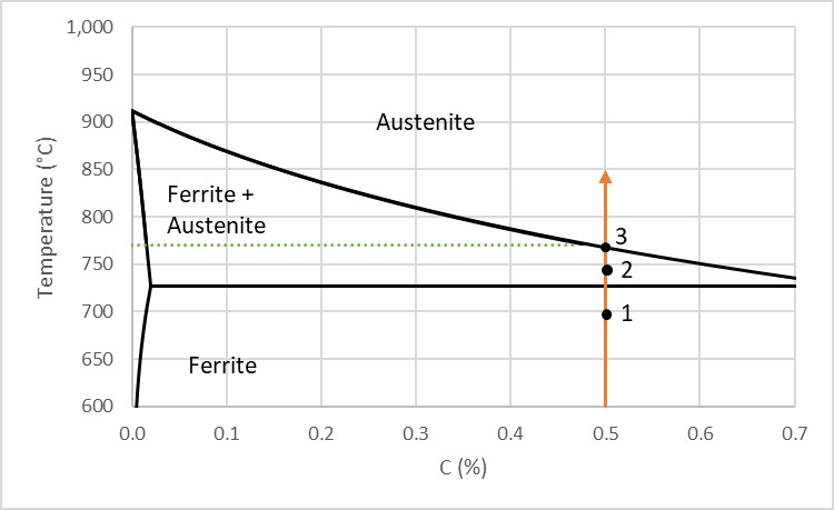

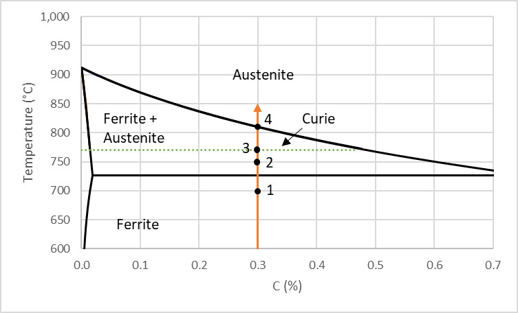

Lower carbon steels do not transform immediately from ferrite to austenite, but enter a “two phase region” where different fractions of ferrite and austenite are present at the same time. This means that the steel can be partially magnetic. However, when the steel crosses the Curie temperature then the remaining ferrite will also be nonmagnetic. I will illustrate this further with the following diagram:
At point one the steel is at 700°C in the ferrite+carbide region where the steel is still magnetic. At point 2 the carbide has been replaced with austenite, and the steel is now somewhat less magnetic because it is a combination of magnetic ferrite and nonmagnetic austenite. The steel continues to partially replace the ferrite with austenite as the temperature increases. At point three the steel reaches the Curie point and so the remaining ferrite is no longer magnetic and the bulk metal as a whole is no longer attracted to a magnet. At point four all of the ferrite has been replaced with nonmagnetic austenite.

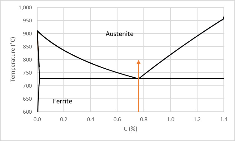

The Curie point does not come into play at higher carbon contents, on the diagram about 0.45% carbon and above:
For the 0.5% carbon steel above, the behavior is initially similar to the low carbon steel. At point number one the steel is magnetic, once it crosses the two phase boundary then some austenite forms and the steel becomes less magnetic. And at point 3 where it has fully transformed to austenite it is no longer magnetic. Because the steel transforms to nonmagnetic austenite before reaching the Curie temperature, the transition of ferrite from magnetic to nonmagnetic is not a factor.

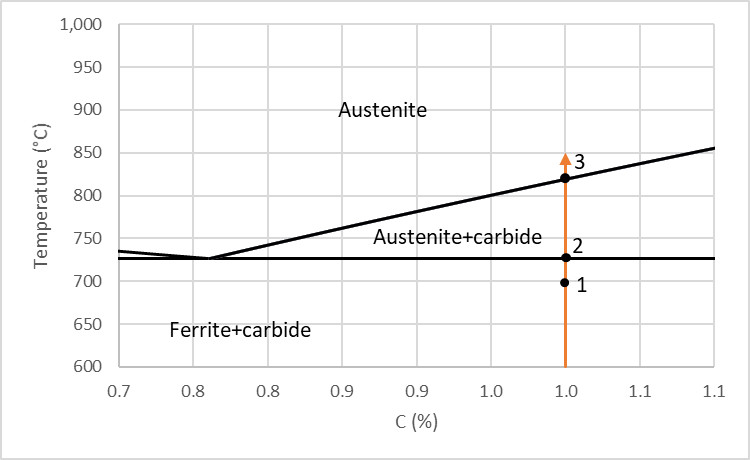

High carbon steel also crosses into a two phase region but instead of ferrite+austenite it is austenite+carbide. The carbide does not greatly affect how magnetic the steel is, as is known because the room temperature steel contained ferrite+carbide and was still magnetic. So the steel transformation to nonmagnetic austenite is not as gradual as low carbon steel, and occurs when the steel reaches the austenite+carbide field. This is similar to the eutectoid steel described above where it transformed straight from magnetic ferrite to nonmagnetic austenite.
So the high carbon steel above is magnetic at point one where the microstructure is ferrite, then nonmagnetic austenite at point two, and remains nonmagnetic at point three where all of the carbide has dissolved.

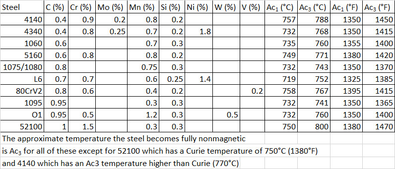

Below I have a table of low alloy steels which may be used by knifemakers to heat treat it in a forge along with a magnet to check the approximate temperature. The Ac1 is the temperature where the steel begins to form austenite and therefore becomes increasingly nonmagnetic as the temperature increases beyond that point. At Ac3 the steel is fully austenite and therefore nonmagnetic. The Curie point does not apply to the magnetic transition for any of them except for 52100 which will be explained more fully further on in this article. The Ac1 and Ac3 temperatures are measured using slow heating.

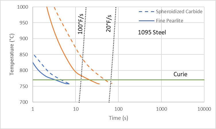

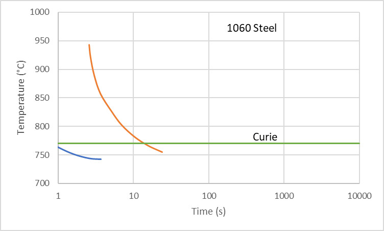

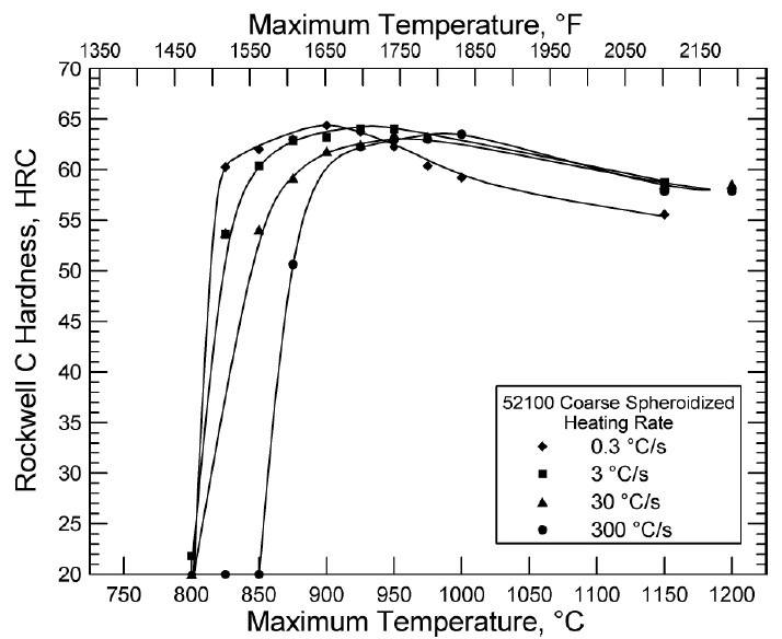

Time-Temperature-Austenitization

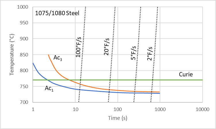

If we focus on a eutectoid steel (1075/1080) then we can look at the effect of heating rate on the steel transformation. Heating rate can be a little difficult to estimate when we are talking about putting a piece of steel into a hot forge or furnace. And if the steel is slowly heated as a furnace ramps up then the heating rate is obviously slower. However, the heating rates on the right side are much more realistic for heating in a forge or furnace:
Adapted from [5]
This diagram is called a Time-Temperature-Austenitization (TTA) diagram. Rather than a cooling transformation diagram like a CCT or TTT, this diagram is for heating into austenite from room temperature. At a rapid heating rate the Ac1 and Ac3 temperatures are higher, while with slow heating those transformations are close to the equilibrium phase diagram. The Curie temperature, however, is essentially not affected by heating rate and it remains the same. With typical slow heating with a 1080-type steel the transformation to austenite is complete well before the Curie temperature has been reached. I have heard some say that when the steel is nonmagnetic that means the Curie point has been reached and so you know the steel is at 770°C (1420°F) or higher. However, the diagram above shows that this is not usually the case. The same is true for the majority of simple steels that are typically used in heat treatment where temperatures are checked with a magnet, including 5160, 1060, 1084, 1095, and O1. This may not always have a big effect on how the steels need to be heat treated, but it is better to understand that when the magnet is no longer attracted to the steel it is an indication that the steel has transformed to austenite, not because of the Curie transition.

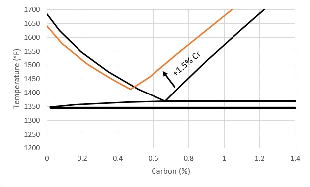

There are steels where the Curie point is still a factor, however, and not just low carbon steels which are not typically used in knives. Chromium additions, for example, raise the austenite transformation temperature so that it is higher than the Curie transition. This affects air hardening tool steels and high speed steels which typically have 3% chromium or more, and martensitic stainless steels which typically have at least 12% chromium.
Image from [6], chromium additions raise the austenite transformation temperatures
There are steels which have smaller amounts of chromium which are still heat treated in a forge along with a magnet to indicate temperature by some knifemakers. One common one is 52100, with 1.5% Cr. I previously showed the effect of the chromium addition on the austenite transformation temperatures:

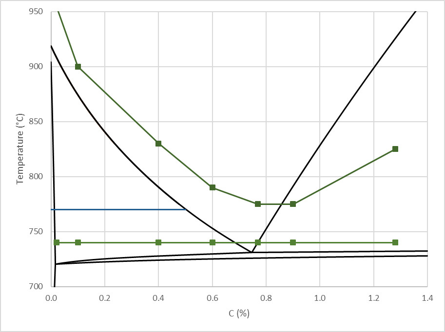

The Curie temperature can also change with composition, though not to the extremes of the austenite transformation temperatures. These changes are relative to the base Curie temperature of 770°C as in pure iron. Chromium increases the Curie temperature up to about 780°C with 3%, then decreases it down to 660°C with 19% chromium [7]. Below is a table summarizing the change in Curie with different alloying additions, each is the change for 1 wt% of the element [8]:

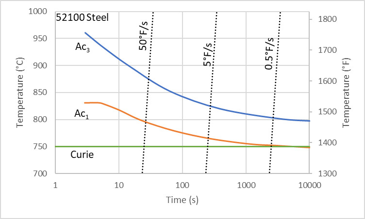

Back to 52100
The Curie temperature of 52100 has been reported to be lower than the typical 770°C [9]. This seems unlikely due to the alloying effects described above where chromium in small amounts tends to raise the Curie temperature rather than lower it. I have a feeling they extrapolated the Curie temperature based on Ac1 rather than the actual Curie temperature. However, even if the actual Curie temperature is closer to 770°C, the Ac3 temperature is still significantly higher than the Curie temperature. This means that the steel must be further heated beyond nonmagnetic to a greater degree than many other low alloy steels:
Adapted from [9]
5160 is closer to eutectoid than 52100 but also has a chromium addition so Ac3 can be relatively close to the Curie transition. Ac3 is about 765°C (1410°F) for 5160 [10]. The Ac3 of chromium-containing 80CrV2 is reported to be 780°C (1436°F) but that is likely too high when considering it has higher carbon than 5160 [11]. So I estimated the true value in the earlier table for 80CrV2.

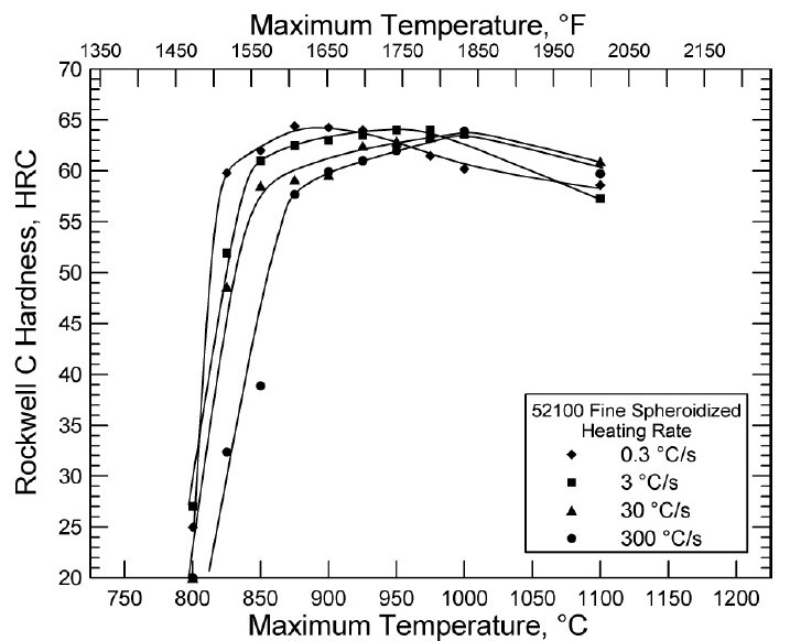

Even 52100, however, can be heat treated without a long hold time if it is heated to a sufficient temperature. Below is 52100 in either a “fine spheroidized” or “coarse spheroidized” annealed structure. The steel was heated at different rates (fast to slow) to the indicated temperature without a hold time (0 seconds at temperature), quenched, and the hardness measured. The difficulty in heat treating it without a temperature controlled furnace is that achieving full hardness requires temperatures significantly higher than when the steel is nonmagnetic.
Images above from [14]
Hypoeutectoid steels (<0.75% carbon) dissolve carbide more readily because the carbide is replaced by austenite at lower temperatures, and less overall carbide is present. This means that less hold time at temperature is required for achieving good hardness after quenching. So 1060 is relatively well suited to being heat treated when checking temperatures with a magnet.

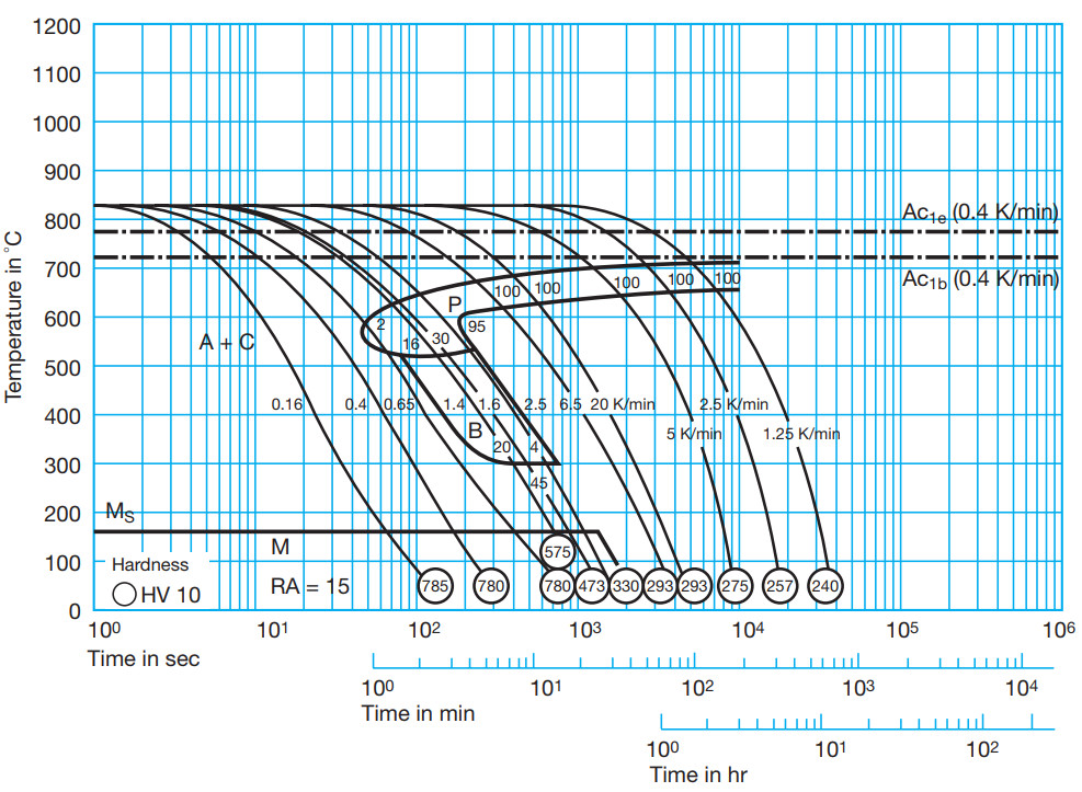

When Steel Becomes Magnetic Again

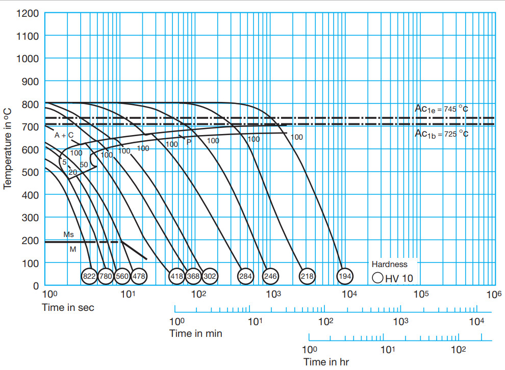

As discussed above, the steel becomes nonmagnetic when it transforms to austenite. And it becomes magnetic again when it transforms to ferrite, pearlite, bainite, or martensite, which are all magnetic phases of steel. The temperature at which it transforms to one of these phases is controlled by the cooling rate and the hardenability of the steel. You can read about hardenability and how to read CCT curves in this article. The temperature where the steel has transformed back to a ferritic phase is almost always significantly lower than the Curie point so just like with heating to austenite the Curie point is not really a factor here. Below is a CCT curive for W2 which is a very low hardenability steel (it transforms easily to pearlite on cooling). The pearlite transformation start temperature is the top line that is about 700°C with slow cooling and about 680°C for the pearlite transformation finish. Those lines decrease in temperature with faster cooling rates.
Image from [11]
You can see above that the pearlite transformation completion drops to as low as 590°C or so with the fourth fastest cooling rate. With faster cooling rates the transformation to pearlite is incomplete and some martensite is formed. With the fastest two cooling rates the steel does not transform at all until it begins to form martensite at just under 200°C. Therefore, the steel remains nonmagnetic until it nearly reaches room temperature. The low hardenability of W2, however, means that it can be air cooled relatively rapidly and still transform to pearlite; according to the CCT diagram it can reach 590°C within only a few seconds and fully transform, becoming magnetic. This means that cycling of the steel can also be performed pretty quickly. On the other side is high hardenability steels where they need to be cooled more slowly to ensure the transformation to pearlite, like the oil hardening O2 steel for example:
Image from [11]
Even with very slow cooling rates (1.25°C/min), pearlite formation is complete around 660°C, a little bit lower temperature than W2. The minimum required cooling rate for achieving full pearlite formation is significantly slower than for W2. The steel needs at least 200-300 seconds of slow cooling to fully transform to pearlite at around 600°C. Sometimes oil hardening steels form some martensite even in air and need slower cooling such as in vermiculite. An air hardening steel like D2 needs even slower cooling rates to transform to pearlite and is likely not possible without furnace cooling.
Steel can become nonmagnetic in two ways: 1) transformation to austenite or 2) reaching the Curie point. Transformation to austenite is the more common reason for becoming nonmagnetic with low alloy tool steels that are often heat treated with a forge or torch without good temperature control. Heating rate can also affect this transition as heating rapidly will lead to delayed austenite transformation so that the steel reaches the Curie point prior to the austenite transformation. Some alloy additions, like chromium, raises the austenite transformation temperatures so that the Curie point is reached first and therefore the steel becomes nonmagnetic significantly below its optimum austenitizing temperature. A pearlitic starting microstructure transforms to austenite more rapidly than an annealed microstructure and is therefore easier to heat treat without good temperature control. Steel becomes magnetic again when it transforms to pearlite, bainite, ferrite, or martensite. The temperature at which it transforms to one of those magnetic phases depends on the cooling rate and hardenability of the steel. Personally, I greatly prefer heat treating with a furnace, as you can be much more sure about the consistency in your heat treatment. That allows you to dial in the temperature and time required for the best properties to a greater degree than by eye or with the help of a magnet. I understand that heat treating furnaces are not free, and that some prefer more “traditional” methods for heat treatment. However, I still recommend a heat treating furnace instead.
