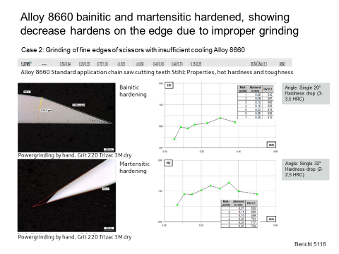

Update 2: Roman Landes gave me some microhardness measurements of an edge after being ground with 220 grit belts. I added them to the “Effect on Knife Edges” section.

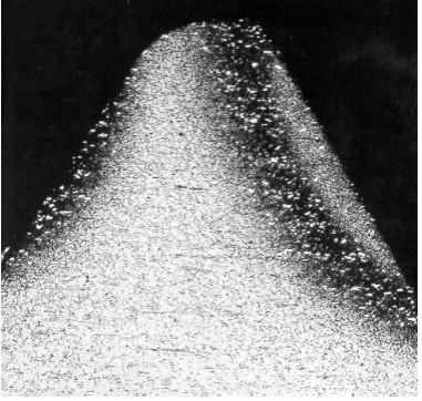

Abrasion of Steel
When grinding with a belt or a wheel hard media abrades away steel as fine particles:
This image from [1]

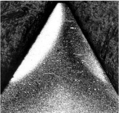

If the edge is greatly overheated the steel can become so hot that it can actually reach temperatures sufficient to reharden the steel, usually 1400°F or above, depending on the steel in question. In this case the steel will be untempered and brittle. Below is the same high speed steel tap which was overheated to the degree that it was rehardened at the surface, which can be seen by the bright color at the edge:
[3]

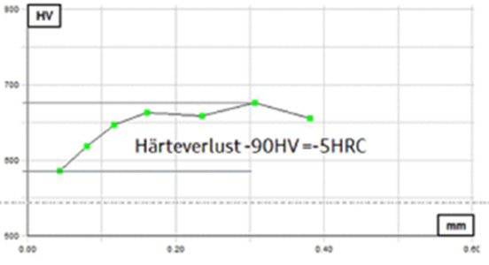

Microhardness measurements of that tap edge showed the effect of overheating:
[3]
Away from the overheating in the dark region the hardness is at the original value of 65 Rc, it then transitions to the 58-50 Rc region where it was overtempered. Then at the surface where it was rehardened it is 62 Rc, this value is lower than the original 65 Rc because it was improperly hardened.

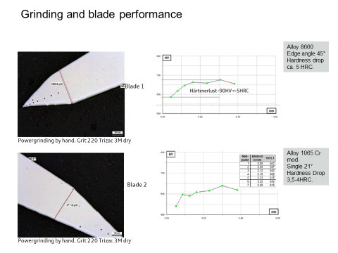

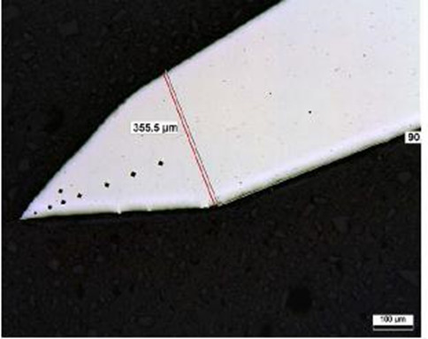

Roman Landes gave me some very interesting measurements of 8660 steel (German 1.2795) which is a 0.6% carbon steel with about 0.8Mn-0.5Cr-0.2Mo-0.6Ni. There is also a result from “1065 Cr mod” which has 0.65% carbon along with 0.7Mn-0.25Cr. The knives or scissors were sharpened by hand on a grinder with 3M 220 grit Trizact belts. Interestingly, there is also a comparison between bainite and martensite microstructures. Typically bainite is less affected by tempering than martensite. However, in both cases a hardness drop was measured at the edge. Up to a 5 Rc difference was measured, and of course even microhardness can only get so close to the apex of the edge.

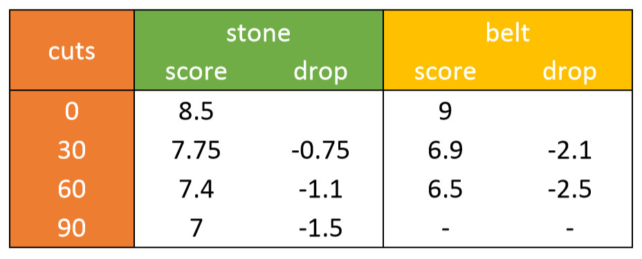

Edge Retention of Belt Sharpened Knives
A study was conducted in 2016 [5] where they compared a knife sharpened on the Work Sharp belt sharpener with traditional sharpening on stones. To test the edges they used an Anago sharpness tester which I have not previously discussed. In that test, the entire knife is drawn through a grid-like material so that sharpness values are found over the entire length of the edge:
The Anago measures sharpness on a 10 point scale where 10 would be an infinitely sharp edge (unattainable). They wore the edges of the knives by making cuts into bamboo and measured the sharpness after 30, 60, and 90 cuts. The Work Sharp led to better sharpness (9) than the stone sharpening that they performed (8.5), but dulled much more rapidly:
The belt sharpened knife was only 6.9 after only 30 cuts on the bamboo; the stone sharpened knife was still a 7 even after 90 cuts. After 60 cuts the belt sharpened knife was only a 6.5 as measured with the Anago while the stone sharpened knife was still a 7.4.

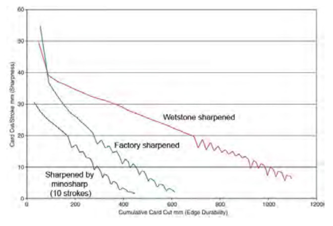

The knife company GLOBAL compared their factory sharpened knives to “whetstone” sharpened knives and found a big difference [6], the information has since been removed from the website but I have hosted it here: GLOBAL CATRA testing
Image from [6]
