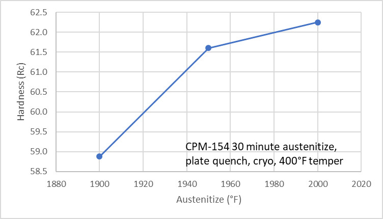

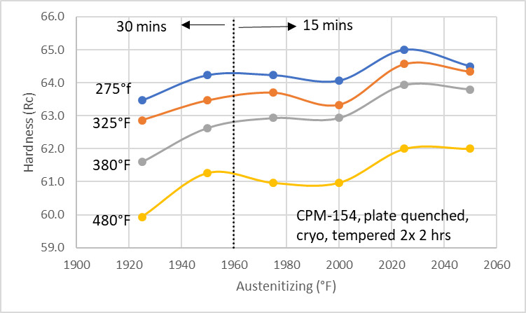

I recently did a range of experiments heat treating CPM-154 to learn more about its optimal heat treatment. I wrapped coupons of CPM-154 in stainless foil and austenitized at a range of temperatures followed by a plate quench between aluminum plates, then into liquid nitrogen for a cryo treatment, followed by tempering twice for two hours each time. I used a 30 minute austenitizing time for temperatures up to 1950°F, and 15 minutes above. This is half of the time recommended by the Crucible datasheet, as it recommends 1 hour up to 1950°F, and 30 minutes above. This change in austenitizing time led to a levelling off of hardness above 1950°F until it increased at 2025°F. The hardness then dropped slightly when using 2050°F, presumably due to excess retained austenite.

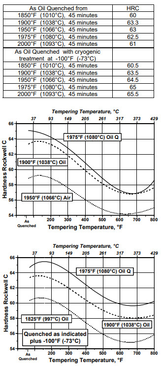

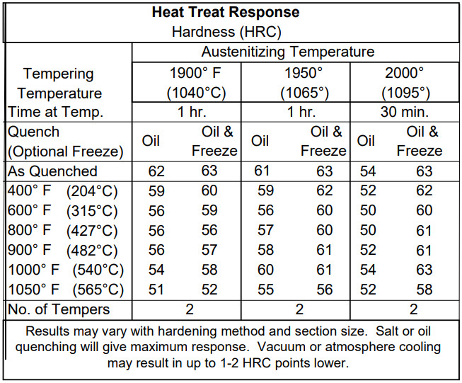

These measurements were somewhat higher than those reported in the Crucible CPM-154 datasheet:

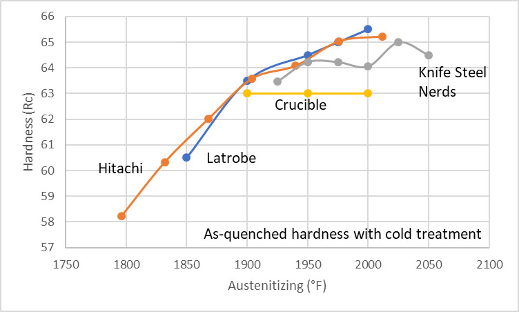

My values show some significant differences from the Crucible data, including some odd reported values for as-quenched hardness by Crucible, where they found hardness was 63 Rc with a cold treatment regardless of the austenitizing temperature. So I compared my hardness values against those from Crucible, Hitachi ATS-34, and Latrobe 14-4CrMo:
The Hitachi and Latrobe numbers are very close to each other, and largely agree with my measurements. Both Hitachi and Latrobe used a longer austenitizing time than I did which probably explains the small deviation. So I would recommend using the Latrobe datasheet rather than Crucible’s for heat treating 154CM and CPM-154. You can see the Latrobe datasheet here: 14-4CrMo Datasheet. And here is the data for as-quenched hardness and tempering from Latrobe:

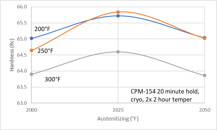

I also performed some heat treatments to specifically target maximum hardness for CPM-154. These experiments were done in my study on ZDP-189 to see if any steels could be used as an alternative to ZDP-189 because of its poor corrosion resistance. For these heat treatments I used a constant austenitizing time of 20 minutes along with the plate quench and cryo treatment. And I used low tempering temperatures to maximize hardness:
2025°F was still found to be the peak in hardness. I normally don’t recommend lower than 300°F tempering but that temperature still resulted in over 64 Rc, which is high enough for most any knife. I also did a toughness test using the 2025-300 heat treatment which will be described in the toughness section below.

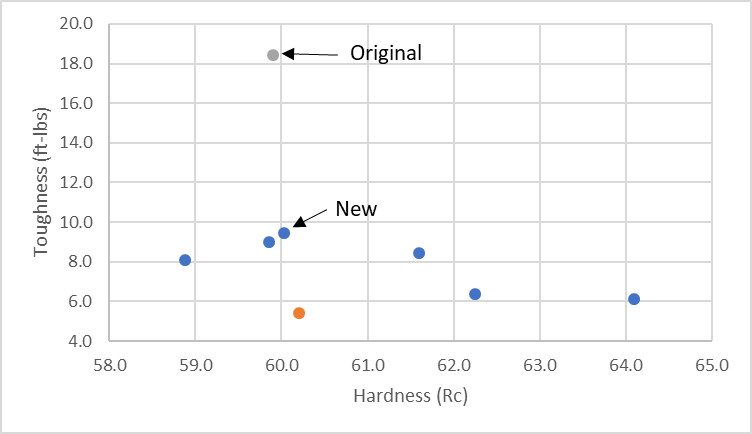

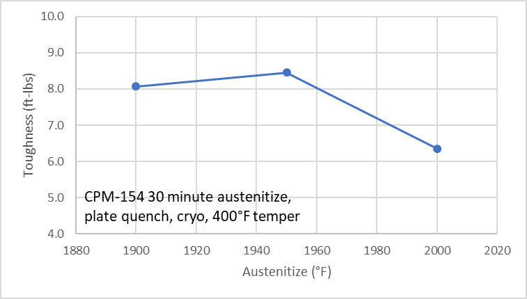

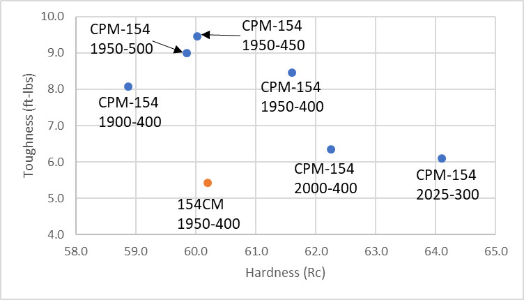

I also performed toughness measurements using a range of heat treatment parameters, including austenitizing temperatures from 1900-2025°F, and tempering from 300-500°F. I used the standard toughness test we have been performing with 2.5 x 10 x 55 mm unnotched specimens. A few of these were machined by knifemaker Mike Pierce so thanks to him for helping. First I measured the effect of austenitizing temperature with 1900, 1950, and 2000°F by austenitizing for 30 minutes, plate quenching, cryo, and tempering 2x for 2 hours each time. Each of those was tempered at 400°F. Hardness was increased with higher temperature, but there was a peak in toughness when using 1950°F. Higher austenitizing temperature can lead to a reduction in carbide content for an improvement in toughness as was seen with S35VN, but with higher temperature there can be a danger of too much carbon in solution leading to brittle plate martensite or grain growth. You can read more in this article on Austenitizing.

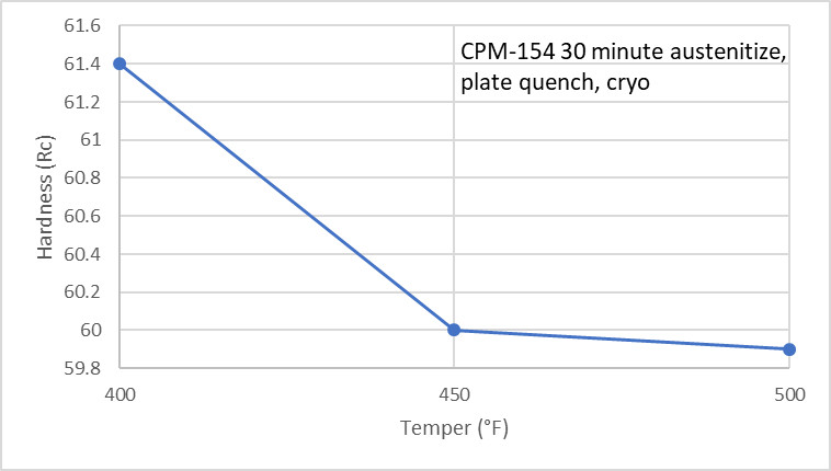

I then used the 1950°F peak toughness and tried tempering temperatures of 450°F and 500°F to see if toughness could be further increased. An improvement in toughness was seen with 450°F but a small drop when using 500°F. This is consistent with many other steels we have looked at, likely due to “tempered martensite embrittlement” when tempering too high. Some steels have shown a drop when tempering even at 450°F so it is an important test to conduct when finding the maximum tempering temperature. The combination of a decrease in both toughness and hardness when tempering at 500°F is unlikely to lead to horrible properties but it does mean that it has a sub-optimal hardness-toughness balance when compared with tempering at 450°F.
As mentioned previously, I also did a heat treatment using 2025°F austenitize and a 300°F temper for a maximum hardness heat treatment. Surprisingly, the toughness was only slightly less than the 2000-400 heat treatment. Perhaps the shorter austenitizing time helped with the higher temperature. Or maybe the drop in toughness by tempering at 300°F simply didn’t have that much effect at such high hardness. Regardless, the toughness ended up pretty good relative to the high hardness. I have also shown on this chart the result of 154CM which was heat treated with 1950-400. The toughness is significantly less than CPM-154 as expected by the coarser carbide structure:

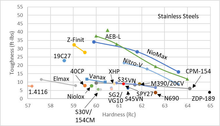

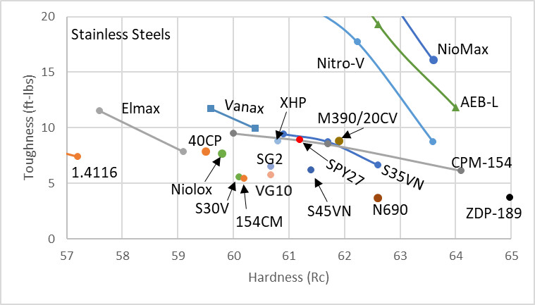

Taking the best toughness results and plotting them vs other stainless steels shows that CPM-154 compares favorably to other PM stainless steels, similar to S35VN and better than steels like Elmax, Super Gold 2, and S45VN:

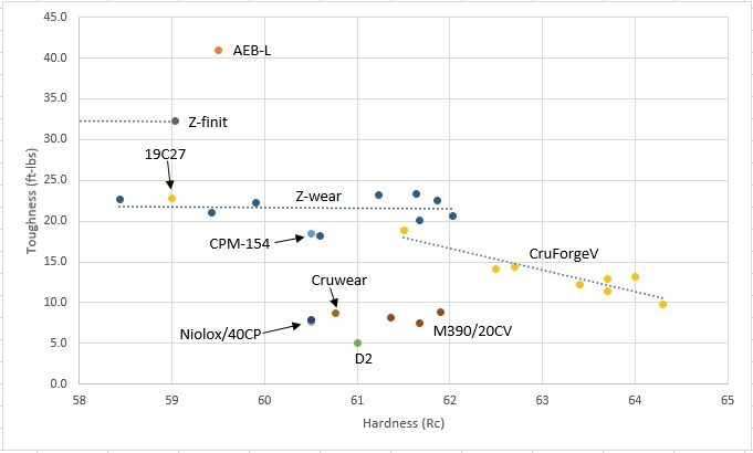

Previous CPM-154 Toughness Measurement

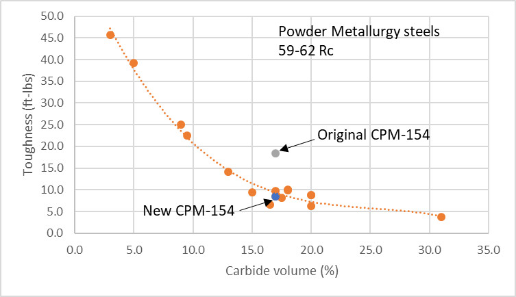

Eagle-eye Knife Steel Nerds readers will notice that these toughness values for CPM-154 are lower than one that has been on previous stainless toughness charts. That original heat treatment used 1950°F austenitize and a 450°F temper, and resulted in similar hardness to these new measurements. The originals were heat treated and machined by Devin Thomas. However, the toughness is nearly double of the newly tested specimens:
That value has been looking suspiciously high for some time now, however, which is part of what spurred on this study. When we originally measured the toughness we had fewer results, of course, and the CPM-154 seemed to be in line with expectation:
So the CPM-154 had superior toughness to conventional steels Niolox, D2, and CruWear (non-CPM). And better toughness to the much higher carbon M390. But it had lower toughness than AEB-L which has significantly less carbide. So it seemed to fit. However, as we added more and more stainless PM steels none of the others were really reaching beyond 10 ft-lbs as can be seen in the other chart. CPM-154 has as much carbide as those other PM steels so its value looked more and more questionable:
You can see that when looking at the carbide content the original CPM-154 measurement just looked too high. Every other steel with a similar carbide content was maxing out around 10 ft-lbs while the original measurement was significantly higher. And there was no clear reason why CPM-154 would manage such high toughness. It does have higher Mo content, but other high Mo grades like Super Gold 2 with its 3% did not approach CPM-154. And looking at the microstructure of CPM-154 its carbides are no smaller than other steels, such as this comparison between S35VN and CPM-154:
CPM-154
S35VN
So this is why I ran all of these CPM-154 experiments to see if I could replicate the original result and I was unable to. So I next did several tests on the original broken specimens to see if I could determine what the difference could be.
Investigation of Original Broken Specimens
My first concern was that perhaps there was a wide range of scatter in the toughness measurement of the original specimens. Maybe there was one outlier value that raised the average. However, the three values for toughness were 18.5, 16.8, and 20 ft-lbs, all within a reasonable range for the resulting average of 18.4 ft-lbs. So an outlier was not seen in any of them. I measured the specimens, the thickness was dead-on at 2.5 mm though the width was out of spec at 10.127 mm vs the target of 10 ± 0.075 mm. However, I don’t think it is far enough out of spec to explain a doubling in toughness.
I was concerned with a steel mixup so I took a micrograph of CPM-154 but it definitely looks as expected, it is the micrograph that I showed above. I was worried maybe it was another steel that just looks a lot like CPM-154 so I measured the composition of the broken specimen with x-ray florescence but the steel was measured as roughly 14% Cr and 4% Mo so it was confirmed to be CPM-154.
I was concerned maybe there was decarb that was not removed at the edges of the specimens where the crack initiates. That would lead to low hardness, perhaps improving ductility and therefore increasing the energy required for energy initiation. However, hardness measurements of the edges of the specimens resulted in an average hardness of 59.4 Rc, compared with 60.5 Rc for the new specimens. So decarb does not appear to have been an issue.
I measured the retained austenite in the specimens with magnetic saturation and found that the original specimens had about 4% less retained austenite, perhaps indicating a faster quench or getting the samples into liquid nitrogen more quickly. However, more retained austenite typically helps with impact toughness as long as it is not excessive. Therefore I do not think that is the reason for the discrepancy.
The CPM-154 used in the original specimens is relatively old, from the first few heats that were available for purchase. However, even if it was some kind of super clean heat with low impurities, excellent processing, etc. we would still expect the carbide volume and size to be the limiting factor for toughness and micrographs confirmed the carbide structure appears as would be expected.
So I am at a loss for why the original specimens tested so high. Maybe the secret to super heat treatments exists in these specimens but more likely it is some kind of outlier/fluke. I wish I knew what the issue was with the original specimens. This is why doing toughness measurements with a range of heat treatments is preferred, of course, to ensure that the trends are fitting expectations.
