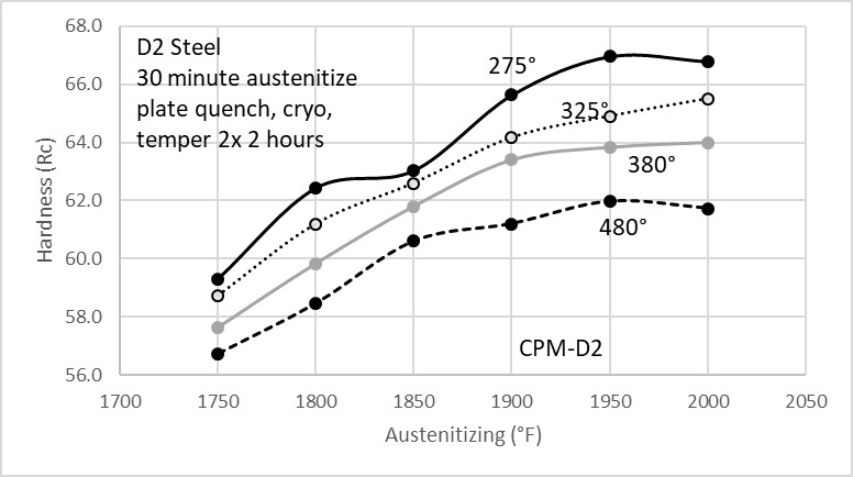

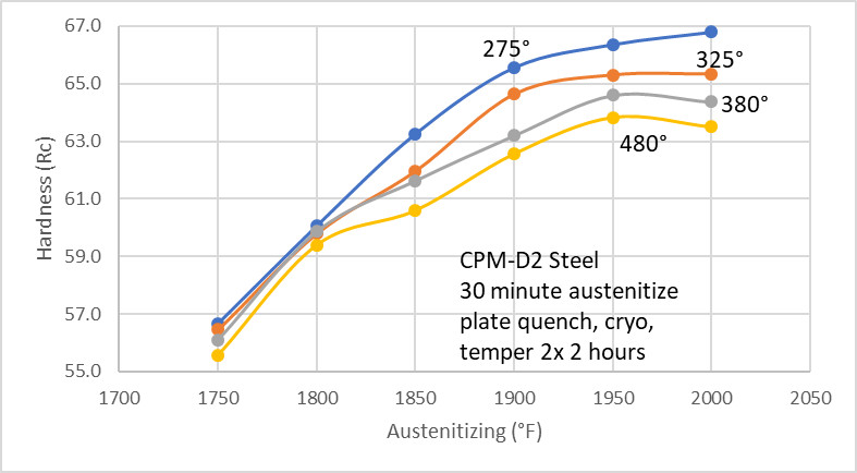

Because each of these three steels have the same composition their heat treatment is very similar. In some cases the hardness after heat treatment can be somewhat better for powder metallurgy steels because of the finer and more evenly distributed carbides. However, in my heat treatment tests I did not see a big difference in hardness between conventional D2 and CPM-D2. All of these heat treatments were performed with cryo. The hardness with cryo seems to top out around 1950-2000°F or so and rather high hardness can be achieved, around 66 Rc or so if desired. Using a standard heat treatment of 1850-1875°F along with 400-500°F tempering leads to 60-62 Rc.

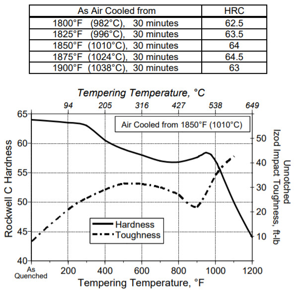

Heat treatment data without cryo is widely available from different steel manufacturers, such as from Latrobe, Carpenter, Crucible, Bohler, or Uddeholm. Without cryo peak hardness is achieved when quenching from about 1875°F resulting in 64-65 Rc. Tempering down to 400-500°F results in 1-2 Rc lower than without cryo.
D2 data from the Latrobe datasheet

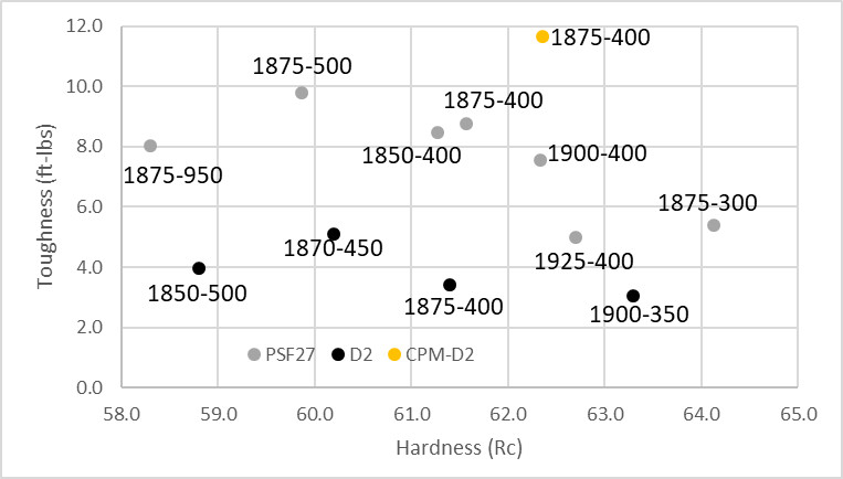

I have performed some toughness measurements of D2 using our standard subsize charpy specimen. The D2 steel was heat treated and ground by Devin Thomas. The PSF27 specimens were heat treated by Michael Drinkwine. The CPM-D2 specimens were heat treated and ground by myself. All were heat treated with a 30 minute hold time, plate quench, and cryo followed by a double temper.

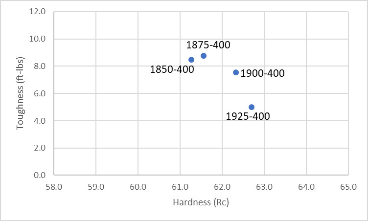

The most heat treatment conditions tested were from the PSF27 specimens so those are the ones I am focusing on here. In general the specimens had similar hardness to those of D2 and CPM-D2 tested for heat treatment response. In terms of austenitizing temperature, 1850 and 1875 led to similar hardness and toughness, 1900 led to an increase in hardness with a corresponding decrease in toughness, and 1925 led to an increase in hardness but toughness is starting to nosedive. Therefore I would recommend restricting austenitizing temperatures to no higher than 1900°F in most cases unless maximum hardness is necessary.

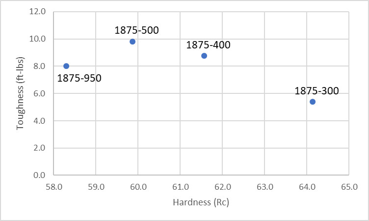

For tempering, 400°F led to a good combination of hardness and toughness, with around 8.5 ft-lbs and 61.5 Rc. Increasing the tempering temperature to 500°F led to an increase in toughness to nearly 10 ft-lbs at the cost of around 1.5 Rc. A temper at 300°F achieved rather high levels of hardness (64 Rc) with a corresponding decrease in toughness. However, the hardness-toughness trend for 300-500°F in relatively linear, meaning no steep drop in toughness for 300°F from brittleness. Therefore, a 300-350°F temper is acceptable when higher hardness is desired for strength and edge retention. A high temper of 950°F led to less hardness and toughness than a 400-500°F temper so high temperature tempering is not recommended.

And below I have the full chart of hardness-toughness values for PSF27 along with conventional D2 and CPM-D2. The conventional version had similar hardness with the same heat treatment but significantly lower toughness as expected from the larger carbide size. One interesting thing to note is that PSF27 with 64 Rc had higher toughness than conventional D2 at 60 Rc. So switching to PSF27 (from D2) in combination with higher hardness could provide an increase in edge retention and strength with no reduction in toughness. CPM-D2 was another significant bump in toughness vs the PSF27.
