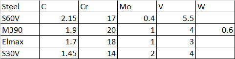

All of the early powder metallurgy stainless steels used a combination of high chromium (17+%) in combination with vanadium. These steels included the first (440V/S60V), and Bohler’s M390 and Uddeholm’s Elmax. The high chromium reduces the amount of “pure” vanadium carbide that forms, instead making a vanadium-enriched chromium carbide which is higher in hardness than typical chromium carbide but not to the level of vanadium carbide. Therefore these three grades all have around 2% vanadium carbide [6][9][10] which is lower than steels with ~14% chromium like S30V which has 4% vanadium carbide, more than S60V despite having less vanadium. Read about the changes in carbides with different compositions in this article.
M7C3 is a chromium-rich carbide and MC is vanadium carbide
The amount of vanadium carbide controls wear resistance and difficulty in polishing and sharpening. Vanadium carbide is harder than the common abrasive aluminum oxide used in many grinding belts and sharpening stones so removing steel is more difficult with high levels of vanadium carbide. Many people report having an easier time sharpening Elmax and M390 than S30V and this is likely due to lower amounts of vanadium carbide. S60V also probably has relatively good ease in sharpening and finishing for its level of wear resistance when compared to high vanadium steels like S90V or 10V.
However, S60V also has a surprisingly fine carbide structure, a bit finer than Elmax, M390, or CPM-154. Perhaps its better ratio of V:Cr helped with that as vanadium carbides are less prone to coarsening in powder metallurgy steels. Compare with more steels in this article of micrographs.

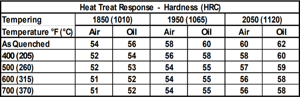

Because of some reports that S60V cannot reach high levels of hardness it is probably worthwhile to discuss heat treating. I have not done a full set of hardness coupons with S60V. Below is the hardness data provided by Crucible [11], they included air cooling and oil quenching but did not test the effect of cryogenic processing.
The datasheet recommends 1850-2050°F for austenitizing but I think this range is probably too low. For one, using 1850°F only results in 54-56 Rc which is quite low for most applications. Also, the hardness has not dropped from excessive retained austenite even by 2050°F. This also appears to be acknowledged by Crucible as their “Recommended heat treatment” uses 2050°F. A better austenitizing range might be 1950-2150°F. I have heat treated a few different coupons using the current S60V material, all with cryo after the quench. Using 1950°F and 400°F resulted in 58.5 Rc and 2050°F and 400°F resulted in 61.0 with a toughness coupon and 61.7 Rc with a CATRA knife. So I think the 2050-400°F combination is a good starting point, resulting in 61+ Rc with cryo and around 60 Rc without cryo, which has a good combination of strength and edge retention along with decent toughness. A 20-30 minute austenitize seems to work fine. To see the steel’s potential for high hardness I also tried heat treatments with 2100°F for 15 minutes and 2150°F for 10 minutes, each followed by a plate quench, cryo, and temper at 300°F. The 2100°F heat treatment led to 64.3 Rc and 2150°F resulted in 65.0 Rc. Therefore very high hardness levels are possible for those knifemakers that are interested.

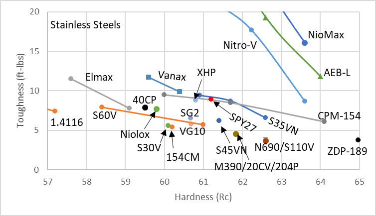

I used my standard toughness test of subsize unnotched charpy specimens with S60V. The heat treatments used were given in the previous heat treatment section. I was a bit surprised by the toughness as it was in line with many other popular stainless steels including Elmax, 154CM, VG10, 154CM, S30V, and M390. It is a step down from S35VN, Vanax, and CPM-154. However, many people report good performance of knives in VG10, S30V, and M390; and S60V matches or exceeds the toughness of those grades. I don’t know if Crucible steel production is better now than it was in the past, or if my heat treating is better than what was being done in the past, or if perceived toughness issues with S60V were related to other things like low strength (rolling rather than chipping). However, all I can say is that the toughness of S60V looks comparable to many other common steels. Its carbide structure, as pointed out before, looks at least as good as many other powder metallurgy grades as well so I think these toughness values are reasonable.
