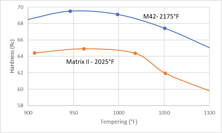

Some differences were identified between the properties of the Matrix steels and the parent originals, apart from only the elimination of carbides. Because all of the carbide would be dissolved by austenitizing at the same temperature as the original, grain growth could be extreme by using the same temperature. Instead, the steel would be austenitized about 175°F lower so that some carbide would be maintained to “pin” the grain boundaries and maintain a fine grain size. Ironically, this results in a somewhat different matrix composition than the original. This means that the matrix steels were somewhat lower in hardness after heat treatment, and also because a significant amount of carbide does contribute somewhat to the final hardness. So Matrix II would be heat treated to about 65-66 Rc rather than the 69-70 Rc of the original M42.
Data adapted from [7] and [8]

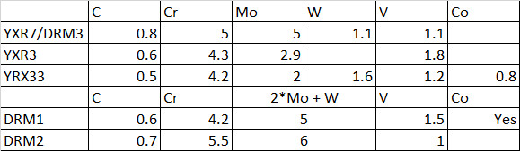

Matrix High Speed Steels in Japan
The concept of matrix high speed steels seems to have mostly been ignored in the United States. They took off a bit more in Japan, with Hitachi YRX3, YXR33, and YXR7, the first matrix high speed steels introduced in that country [10]. And Daido has DRM1, DRM2, and DRM3. And Nachi-Fujokoshi introduced a small series of matrix high speed steels. Daido also has a matrix cold work die steel (tool steel operated at room temperature) that they call DCMX, though I haven’t found a composition for that steel. These steels did not start with the measurement of the matrix composition of a pre-existing high speed steel but instead developed a high speed steel with intentionally low carbide content. This is somewhat of an expansion of a “matrix steel” concept but fits the general goal of them. YXR7, the matrix high speed steel which has probably seen the most use in knives, is in fact the same as VASCO Matrix II but with increased carbon content and no cobalt addition. Because of the increased carbon, YXR7 is not a true matrix steel because it has some carbide after heat treatment. These steels are sometimes called “semi-matrix” steels because they are designed to have a small amount of carbide. Daido DRM3 is also identical to YXR7.
Compositions from [11] and [12]
YXR3 and YXR33 are less obviously based on previous steels. YXR33 does not look too different than VASCO-MA (Matrix M2) but with somewhat reduced Mo/W, increased V and a small addition of cobalt. YXR3 has somewhat more vanadium than other matrix steels, which generally top out around 1-1.2% vanadium. The increased vanadium probably allows higher austenitizing temperatures than older matrix high speed steels by using vanadium carbides to pin grain boundaries and suppress grain growth. The increased vanadium would also somewhat increase wear resistance. DRM1 is similar but with a bit less vanadium and an unknown amount of cobalt. Cobalt does not form carbides, but increases hot hardness for a given composition by affecting the formation of secondary carbides during high temperature tempering.

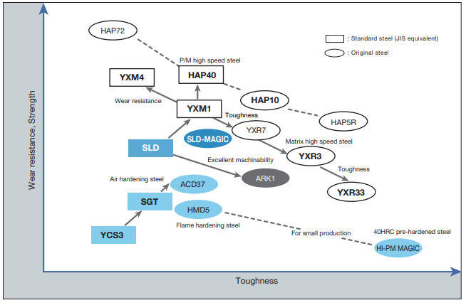

With the reduced carbide content, matrix high speed steels generally have superior toughness to conventional high speed steels. This also means reduced wear resistance, but with controlled carbide fractions a superior combination of properties can be achieved. In the chart below, conventional high speed steels YXM1 (M2) and YXM4 (M2+5Co) have relatively high wear resistance but average to poor toughness. The matrix high speed steels have better toughness according to Hitachi. However, the properties of powder metallurgy high speed steels are still generally superior, as powder metallurgy can maintain good toughness with higher carbide fractions by keeping carbides small. This means a better combination of wear resistance and toughness. See below for a simplified chart by Hitachi comparing the toughness-wear resistance balance of their high speed steels. The PM steels (HAP40, HAP10, HAP5R) have superior properties to the matrix high speed steels when it comes to the level of wear resistance for a given toughness.
Image from [11]

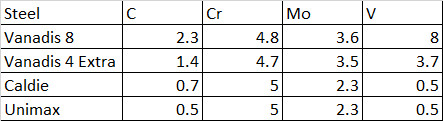

Uddeholm uses a similar matrix composition for many of their tool steels including Vanadis 4 Extra, Vanadis 8, Caldie, and Unimax. The bulk compositions of these steels can appear to be quite different:
Compositions from [13]

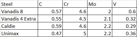

However, since a significant portion of carbon, chromium, molybdenum, and vanadium is tied up in carbides, the matrix compositions are very similar. See the calculated matrix for these four steels at the recommended austenitizing (hardening) temperature:

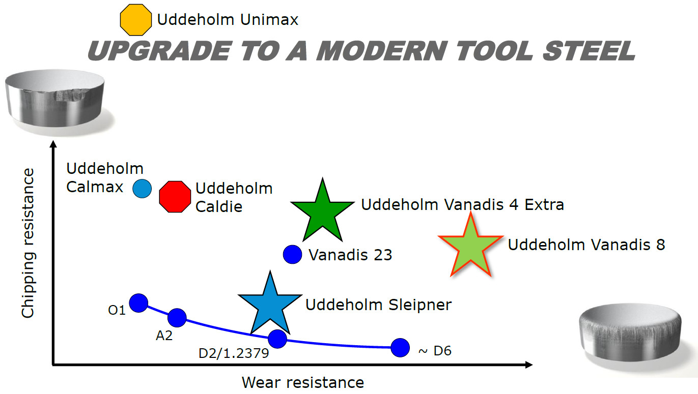

Uddeholm refers to Caldie and Unimax as “modern matrix” steels [13] and that is a bit more obvious when comparing the similar matrix compositions over the range of their cold work tool steels. Uddeholm metallurgists seem to have dialed in a matrix composition they are happy with when it comes to hardness, hardenability, tempering resistance, etc. and are sticking with it across the product line. Caldie was first patented around 2005 [14], Unimax was patented around 2010 [15] and Vanadis 8 around 2015 [16]. Vanadis 4 Extra predates all of those steels, being patented around 2002 [17], and I don’t see any earlier Uddeholm products with a similar matrix composition, so it seems to have been the basis for the others. Prior to V4E, Uddeholm was using 8Cr-1.5Mo as their base composition. Uddeholm recommends this series of products (V8, V4E, Caldie, and Unimax) based on the desired level of wear resistance and toughness.
Image from [18]

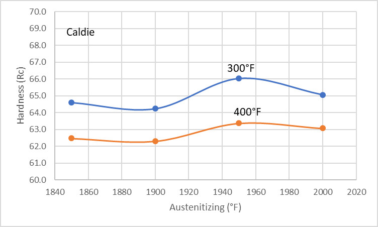

Caldie is the primary matrix steel that I have studied (at least of steels called “matrix” by their producers). Caldie has a fine microstructure despite the lack of powder metallurgy processing because of the low volume of carbide. It can achieve relatively high hardness, about 66 Rc, a bit lower than Vanadis 4 Extra and Vanadis 8 because of less carbide. It also has high toughness as expected by the low volume of carbide. Its edge retention is also much lower than Vanadis 4 Extra and Vanadis 8 as expected by the reduced vanadium. Caldie is on the lower end of edge retention compared to steels with higher alloy content, but still above many low alloy steels like O1 and 1095. AEB-L has somewhat more edge retention at the cost of a little toughness. You can read more about the design of AEB-L in this article. Caldie can achieve higher hardness than AEB-L because it doesn’t have high chromium for stain resistance, and has better tempering resistance and hot hardness due to the Mo addition, which makes it well suited for being a tool and die steel.
Caldie – 1850°F

    I don’t really understand how you estimated the matrix composition for Uddeholm steel.
    I would be glad to know !
