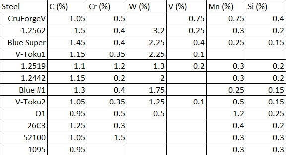

There are some steels produced in Europe and Japan that are also designed to have a low alloy content but with enhanced wear resistance, usually through tungsten additions. Tungsten carbides (WC) are similarly high in hardness to vanadium carbides so either can be used to enhance the wear resistance of forging steels. See this article on knife steel suppliers to find where to buy some of them.

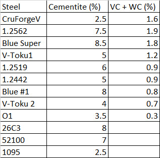

CruForgeV has a combination of cementite (iron carbide) and vanadium carbide. The amount of cementite is relatively low compared to other ~1% carbon forging steels because some of that carbon goes to forming the vanadium carbides instead. On paper, CruForgeV can appear to be less wear resistant than some of the tungsten alloyed steels like V-Toku1 and Blue #1 which have about 2% tungsten added to them. However, tungsten is a very heavy element, so 0.75 weight % vanadium is equivalent to about 3.1% tungsten when it comes to how much carbide is formed, as shown in the chart below.

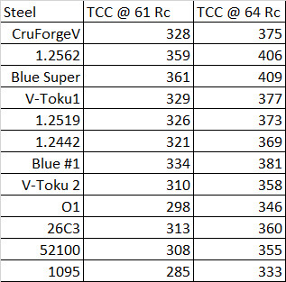

Below I have a table summarizing the approximate carbide volume of some of these higher wear resistance forging steels where I combined the content of VC and WC. More carbide, especially hard carbides like VC and WC, mean higher wear resistance. CruForgeV is roughly comparable to steels like Blue Super in terms of VC+WC content, though with lower cementite.

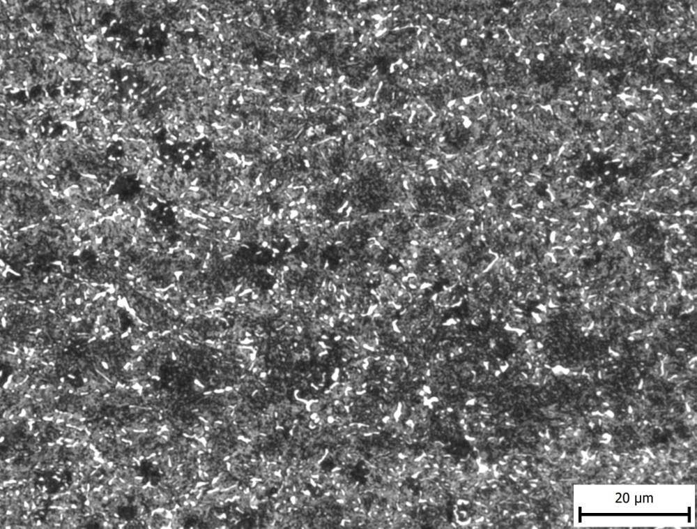

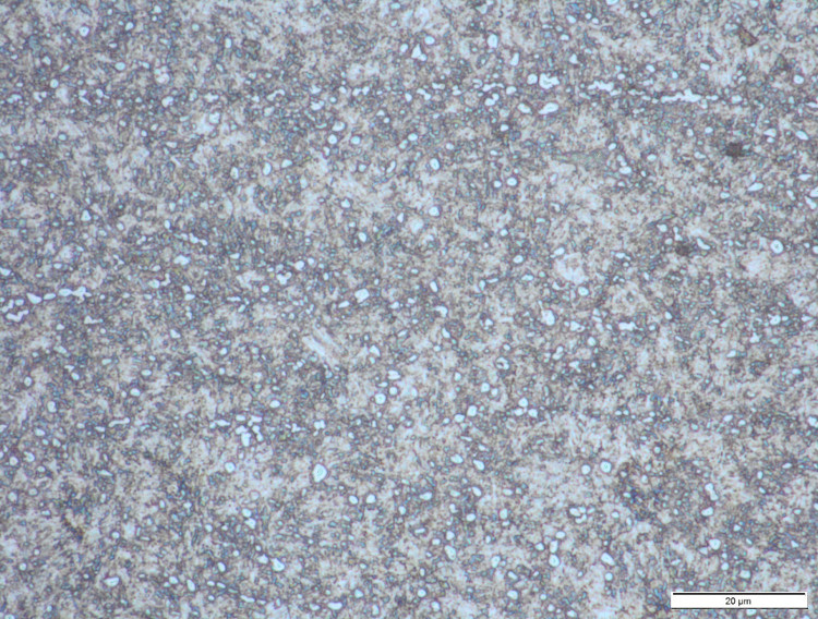

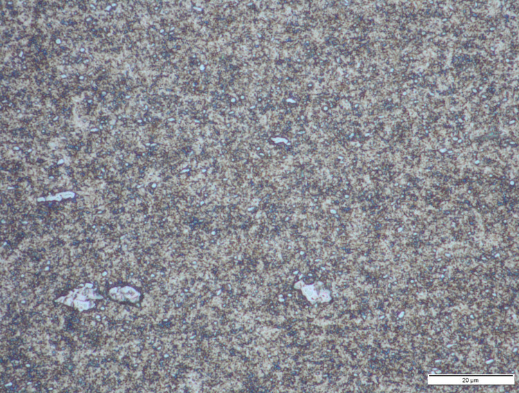

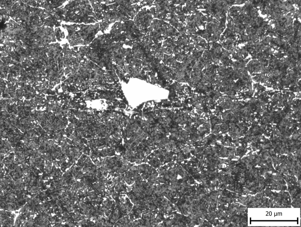

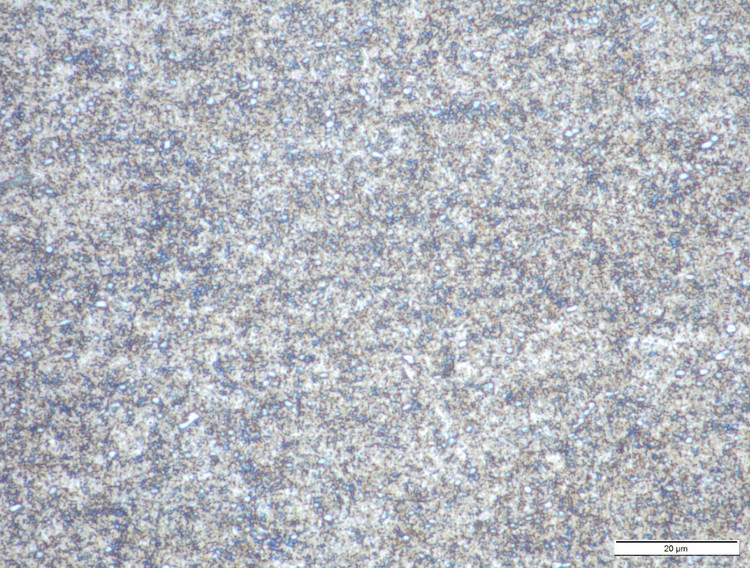

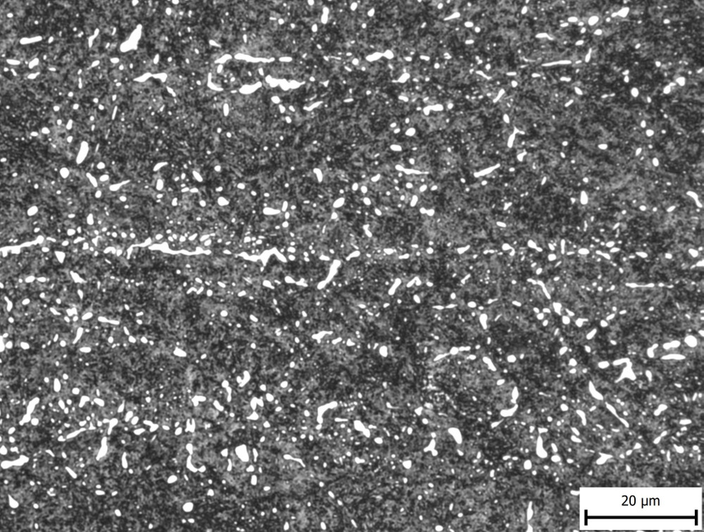

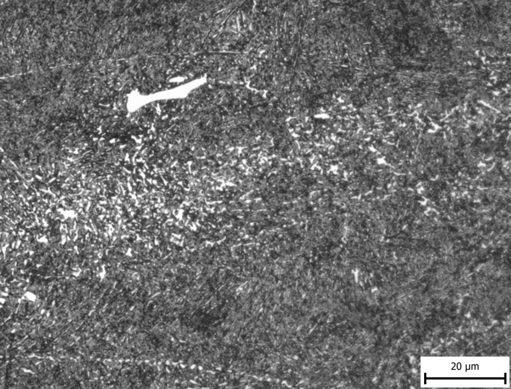

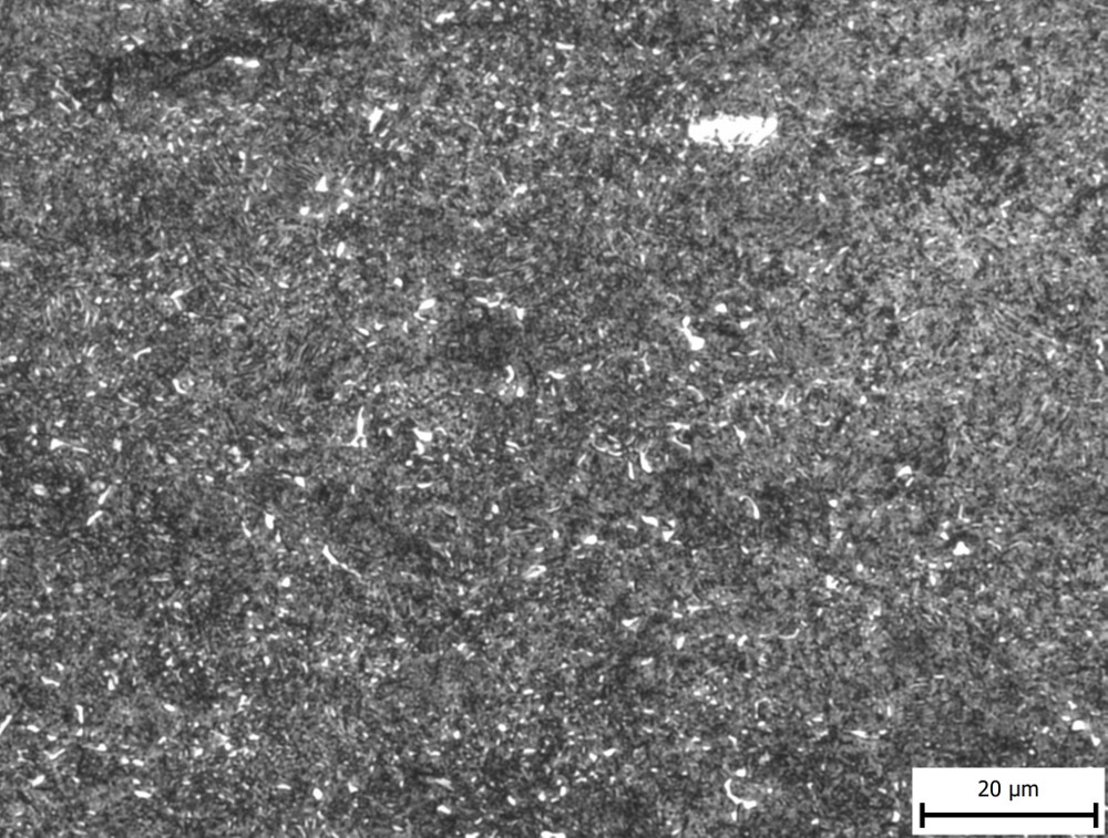

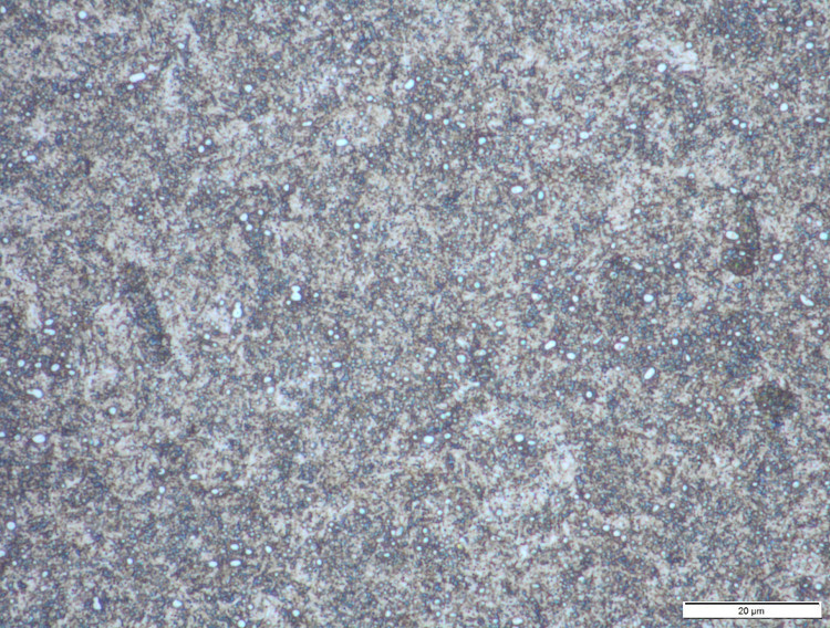

In terms of the carbide structure itself, CruForgeV is mostly made up of fine carbides, though there are occasional larger vanadium carbides. I have two micrographs which show a region both with and without the larger carbides. This is relatively similar to 1.2562 and Blue Super steels which also have some larger carbides, though in this case WC. The forging steels with somewhat reduced vanadium/tungsten carbides have a more consistently fine structure throughout like 1.2519, 1.2442, and V-Toku1.
CruForgeV area 1
CruForgeV area 2

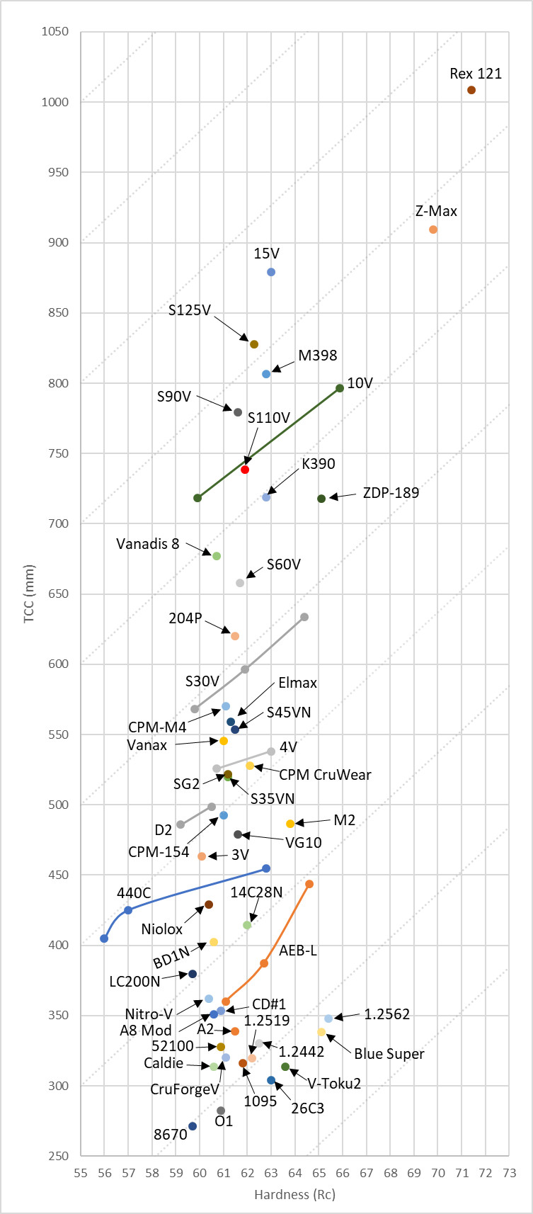

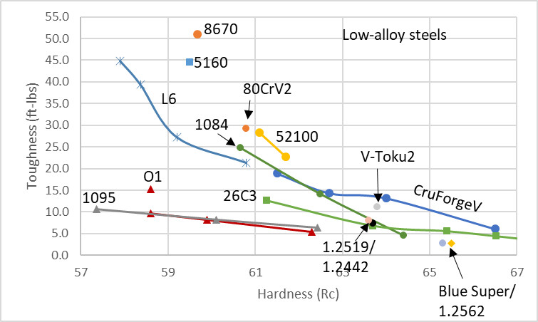

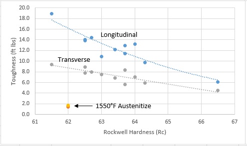

I wrote extensively about the toughness of forging knife steels in this article, where more explanation of the differences can be found. We also did a thorough exploration of CruForgeV toughness with different forging and heat treatment procedures, found here, which I will discuss a bit more in the heat treating section. CruForgeV has very good toughness according to our testing, around 20 ft-lbs at 61 Rc. And it maintains good toughness even at relatively high hardness levels, such as 10-13 ft-lbs at 64 Rc. Therefore CruForgeV has excellent toughness for a wide range of different applications.
With rope cutting tests, Jim Batson found CruForgeV to be 40-70% better than 52100 at similar hardness, so in his testing there was a clear improvement from the presence of vanadium carbide.
Edge retention of low alloy steels is relatively low when compared to high alloy and stainless steels because of the relatively soft cementite. However, in CATRA edge retention testing cementite does not seem to improve edge retention at all,making them look even worse. I have hypothesized that this is because cementite is softer than the 5% sand in the test media that abrades the edge. This is supported by the fact that 52100 did better than many of the other steels, which may be because the high chromium increases the hardness of the cementite. However, we can assume how much contribution cementite would theoretically have using an equation I developed in this article. So below I have an estimated edge retention for these low alloy steels in a table for a hardness of 61 and 64 Rc.  And below that is the chart with my experimental results. Adding in an assumed contribution of cementite doesn’t drastically change the edge retention because of how soft cementite is, but it does boost it somewhat. Whether looking at the calculated values or the experimentally measured, the edge retention of CruForgeV is competitive with grades like 1.2442, 1.2519, Blue #1, and V-Toku1. The steel is likely a notch below 1.2562 and Blue Super, even though if compensated for hardness the experimental data appears to show CruForgeV being superior, because 1.2562 and Blue Super have significantly more cementite.

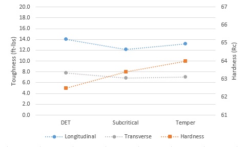

The datasheet specified an annealing temperature of 1450°F followed by a “slow cool.” In the toughness study we used three different annealing treatments:
  1. Subcritical – 1250°F for 2.5hrs after normalizing
  2. Full anneal/DET – 1460°F for 30 minutes followed by cooling at 670°F/h to 1260°F and finally cooling to room temperature in air.
  3. Temper annealing – similar to a subcritical anneal but starting from a martensitic microstructure. The steel was austenitized at 1450°F for 10 minutes followed by oil quenching, then performed again, followed by 1250°F for 2.5hrs.
The temper anneal was intended to lead to grain refinement and more rapid heat treating response during austenitizing. The temper anneal exhibited the highest hardness for a fixed austenitize/temper, next was the subcritical anneal, followed by the full anneal. The full anneal results in more carbide for lower annealed hardness which also somewhat reduces the final hardness. The annealing treatment done by the steel plant likely had much slower cooling during annealing and therefore have larger carbides. This would result in yet lower hardness, both as-annealed and after the final heat treatment. I have read a few threads on the forums where people had much higher hardness than shown in the datasheet and this difference in initial structure is a likely reason. Forging the steel, normalizing, and annealing by a bladesmith will usually result in higher annealed hardness but faster response in heat treating.
The temper anneal appears to have had slightly improved toughness-hardness balance but I am not sure if that is just a fluke of statistics. The full anneal is still my recommendation. In writing my book I calculated optimal annealing temperatures for different steels and for CruForgeV my estimate was 1405°F rather than the 1450°F given in the datasheet, because of the relatively low temperature at which cementite dissolves in the steel. So I would recommend annealing from that somewhat lower temperature. However, 1450°F works fine and is the same as the datasheet recommendation for O1 which is a steel that behaves relatively similarly in austenitizing. If annealing without a furnace, heat to non-magnetic and place in a slow cool media like vermiculite. You can read more about how annealing works in these articles: Part 1 and Part 2. Note: the chart below also shows “transverse” toughness which is somewhat lower than longitudinal. You can read about these different orientations in this article.

The datasheet recommends 1500-1550°F followed by “equalize” and quench in oil. This appears to recommend no hold time. I think they were providing a recommendation for heat treating for those that are using a forge where holding at a specific temperature can be difficult. However, when heat treating with a furnace we can use a fixed hold time at temperature to have consistent heat treating results. In our toughness study we used 1450, 1500, or 1550°F with an austenitizing time of 10 minutes. Using 1550°F led to a drastic reduction in toughness, probably because of excess carbon in solution rather than grain growth (the VC pins grain boundaries). Therefore, the recommended temperature range in the datasheet should be followed only for no hold time. When using a furnace it is better to austenitize for 10 minutes between 1450-1500°F. This is similar to what Dan Farr recommended for heat treating the steel. A “triple quench” led to no improvement in toughness, and a similar triple quench comparison with O1 steel also led to no improvement, so I wouldn’t generally recommend multiple austenitize and quench treatments.

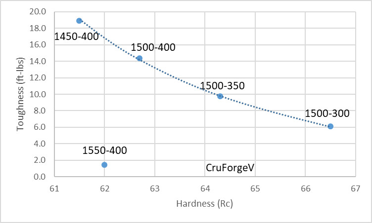

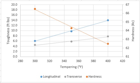

The datasheet recommends tempering between 400-500°F. We tempered between 300-400°F in our study. Our hardness was somewhat higher than the datasheet (shown below), which may be because of the different initial microstructure as I explained in the annealing section.
Tempering data from the datasheet
There was no major drop in toughness by tempering at 300°F, so it is safe to temper that low if higher hardness is desired. Some steels can show a sharp change in behavior below certain tempering temperatures, such as seen with 5160, but this was not found with CruForgeV.
Optimal Heat Treatment
Forging: Forge from 2000°F
Normalizing: 1600°F for 10 minutes and air cool
Annealing: 1405°F for 30 minutes, cool at 670°F/hr to 1260°F and air cool. If annealing without a furnace, heat to non-magnetic, and place in a slow cool media like vermiculite.
Austenitize: 1450-1500°F for 10 minutes, quench in fast or medium oil
Temper: 300-400°F twice for 2 hours
1450-400 results in excellent toughness around 61.5 Rc, while 1500-350 has good toughness while at high hardness for edge stability and edge retention.

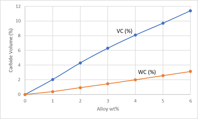

For conventional production we want to ensure that the carbide size remains relatively fine, so we would limit our additions of vanadium and tungsten to reasonable amounts. I like the combination used in Blue Super of 0.4% V and 2.25% W, those appear to be chosen at levels where most of the carbide is dissolved at forging temperatures for easier forging, but high enough where some VC/WC remains after final heat treatment for wear resistance. The issue with steels like Blue Super and 1.2562 is that they are prone to having high carbon in solution leading to brittle plate martensite and low toughness. The very high carbon content also makes the steel prone to grain boundary carbide formation during normalizing which also reduces toughness. Read this article for a process that was used to boost toughness in 1.2562.
However, it would be better if we had a steel that could avoid plate martensite and grain boundary carbide with simple processing. An example of a common steel that does this is 52100, where the 1.5% Cr decreases the carbon in solution to a point where plate martensite is avoided with typical heat treatments. The chromium also boosts the hardness of the cementite giving improved edge retention. And Cr helps keep the cementite size small. And 1.5% Cr offers a good level of hardenability in combination with 0.3Mn, what I would call a “fast oil” steel, being possible to quench with Parks 50, or Parks AAA as long as the cross section isn’t too thick.  This level of hardenability is somewhat lower than CruForgeV which makes air hardening less likely and annealing easier. The downside of the Cr is that it means a more controlled soak is required in austenitizing, making it more difficult to heat treat in a forge, which is a difficulty CruForgeV does not have. However, there are many bladesmiths that heat treat 52100 with a forge or torch, and many bladesmiths with furnaces for heat treating it as well. So I think the pros outweigh the cons. A 52100/Blue Super hybrid with 1.5% Cr, 0.4%V, and 2.25% W with appropriate carbon content would provide enhanced toughness and edge retention over Blue Super and 1.2562 and make it easier to avoid plate martensite and grain boundary carbide. However, for the reasons I laid out in the previous section, I don’t see a steel like this happening.
To get a low alloy steel more firmly competitive with stainless and high alloy steels in terms of edge retention, even higher levels of vanadium and/or tungsten would be required. For conventional production perhaps we could combine the 0.75% V in CruForgeV with the 3.2% W in 1.2562. That would give about 3.2% VC/WC for another boost in edge retention. We may be straddling the line of where bladesmiths would be willing to use the steel at that point, because of increased difficulty in forging and finishing.
With sprayform or powder metallurgy technology, we could ensure the carbide size remains small while adding in even more carbide. Something like 1.2838 which is a low alloy steel with 1.45% C and 3.25% V, almost like a low hardenability version of CPM-4V or Vanadis 4 Extra with nearly 7% VC. With conventional production the carbides in that steel would be quite large but with powder metallurgy they would be very small so that toughness would be very good along with much higher edge retention than other available forging steels. The smaller carbides would also help in hand sanding despite the very hard carbides. Many stock removal knife makers produce knives in high alloy steels or stainless steels that would be roughly equivalent in terms of how difficult grinding and finishing would be. So maybe forging bladesmiths could adapt.
