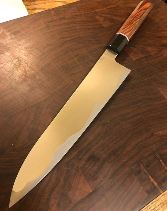

ApexUltra knife from Devin Thomas

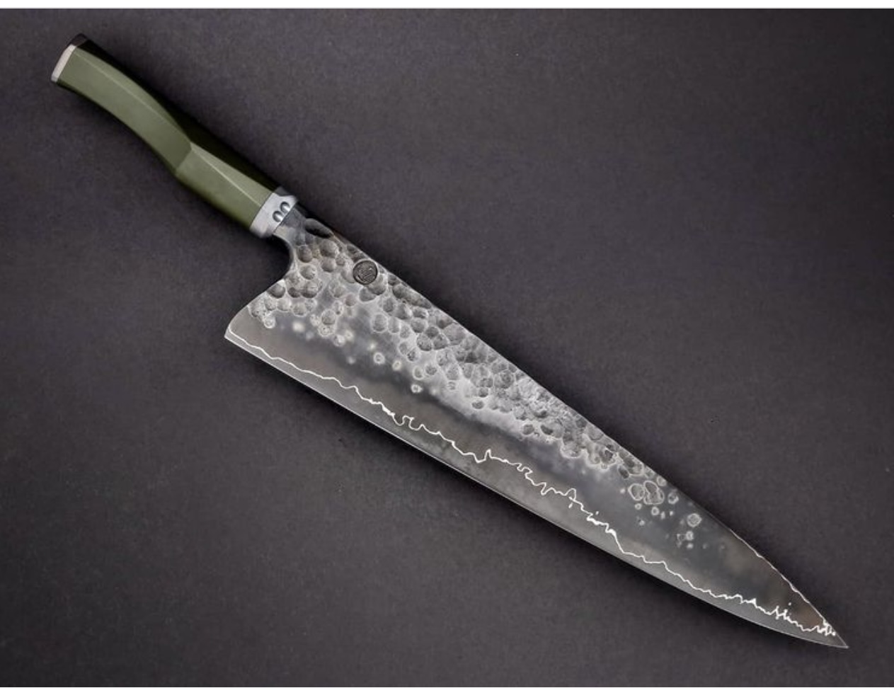

ApexUltra knife from Tobias Hangler

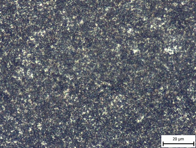

Laboratory Development

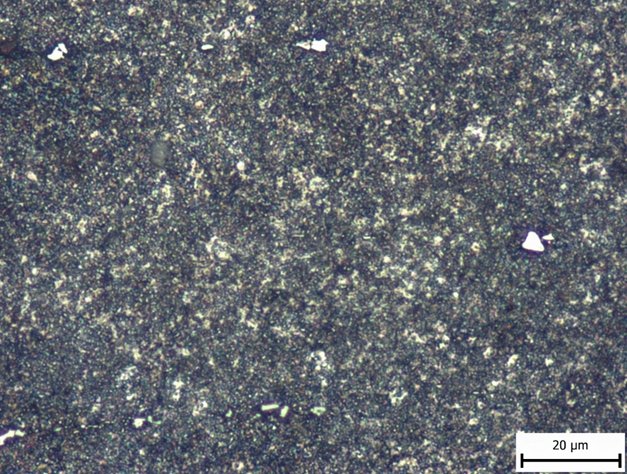

So, I proposed a final composition which was made with vacuum induction melting in a small ingot of about 20 kg. In general, the composition was very close to what was intended. The final composition will be shown closer to the final release of the steel. Tobias then forged the steel down to stock thickness and we performed experiments on this material to see if it was working as designed. At this stage it is not necessarily guaranteed that the properties of the final material will behave in exactly the same way as the steel will be made in larger ingots and then forged to a greater degree.
The microstructure of the material is quite fine with occasional “primary” carbides that were not broken up in forging. However, these carbides are less common and smaller in size than those found in 1.2562 and Blue Super. Also, both 1.2562 and Blue Super exhibited grain boundary carbides which were not found in the new steel. Below I have example micrographs from an area with primary carbides and from an area without.
ApexUltra – area without primary carbides
ApexUltra – area with primary carbides

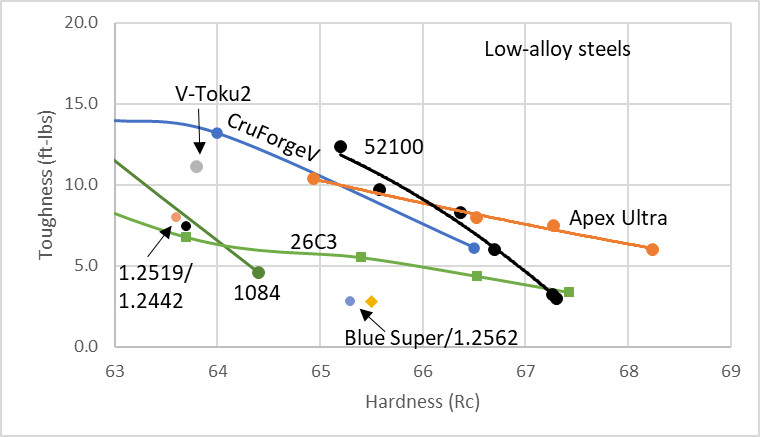

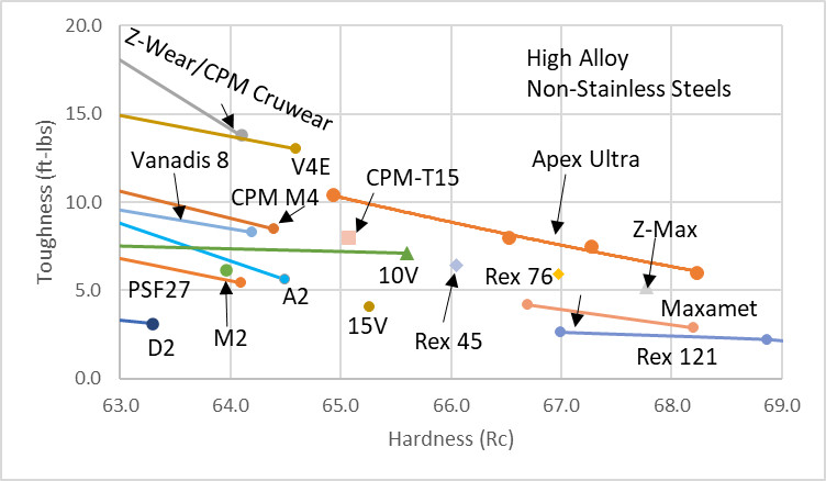

So far, we have only tested the toughness of the new steel at high hardness, 65 Rc and above. However, the toughness in this hardness range is stellar. It is significantly better than 26C3, Blue Super, and 1.2562. And above 66 Rc the toughness of 52100 drops down sharply with increasing hardness while ApexUltra maintains toughness all the way up to 68 Rc. It is likely that the tungsten and vanadium carbides are helping to maintain a fine grain size at the higher temperatures necessary for achieving the high hardness levels.
In fact, ApexUltra is the highest toughness steel I have tested in the 67-68 Rc range, exceeding even the PM high speed steels like Rex 45, Rex 76, Z-Max, and Maxamet.
More complete toughness experiments will be completed when there is final production material. I am especially interested in what it can do in the 60-63 Rc range. Because of the 1.5Cr based design we expect it to perform similarly to 52100 in that lower hardness range (yellow dots below) but this will of course have to be confirmed experimentally.

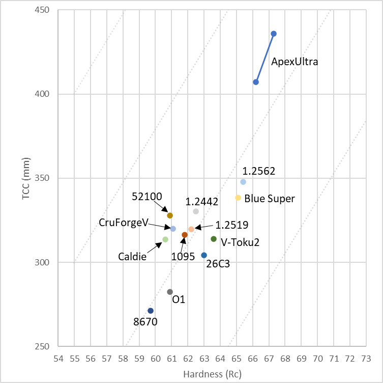

Edge Retention from Wear
In my previous CATRA testing, 52100 had unexpectedly high edge retention when compared with other low alloy steels and I proposed that this was due to the chromium-enriched iron carbides. Those enriched carbides are higher in hardness than typical iron carbide found in other low alloy steels. Apparently enough of an increase in hardness to better handle the abrasion from the silica in the cardstock used in the CATRA test. When compensated for hardness, 52100 even had higher edge retention than Blue Super and 1.2562. ApexUltra, however, with its combination of chromiuim-enriched iron carbides, tungsten carbides, and vanadium carbides, has significantly better edge retention than other low alloy steels typically used by forging bladesmiths. See this article for more information about the CATRA edge retention test and to compare with more steels.

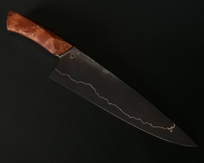

Knife in ApexUltra by Benjamin Kamon

Fantastic news. It’s great to see low alloy steel that has significantly better edge retention than the current options (adjusting for RC of course). I know the current data is somewhat limited but at this point can you comment on a possible mechanism(s) that contribute to it having such a large increase in edge retention per HRC pt?
Chromium-enriched cementite (iron carbide) is higher in hardness so contributes more to wear resistance.
So does the amount of Chromium-enriched cementite increase as hardness increases? I would have figured if anything it decreases due to increasing austenitization temperatures.
No, the amount of chromium-enrichment comes from the amount of chromium.
That’s what I thought. My question is this: why does Apex ultra have a larger increase in edge retention when it goes from 66-67 Rc than predicted by the standard 15.8mm/RC as indicated by the dotted lines on the chart?
That I can’t say for sure.

Finally I noticed that all of your beautiful pictured example knives in apex ultra seem to have a visible hamon line, do you know what hardnesses were achieved at the edge and back? (Or were they laminated?)
Those are laminated blades. While I wouldn’t say that ApexUltra is impossible to get a hamon with it is definitely not ideally suited for that, since it is designed to harden in oil.
