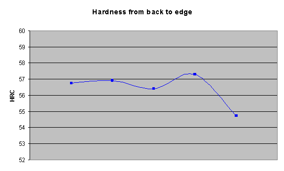

It is interesting that Spyderco reports the degree of cold reduction that H1 sees, which is 57-64% depending on the final stock thickness. The article also mentions further martensite formation during grinding of the knives, something that I have expressed skepticism about previously. When Sandvik measured microhardness of an H1 knife they found slightly lower hardness near the edge (~55 Rc) where more grinding had occurred.
A drop in hardness was found by Sandvik near the edge of an H1 knife

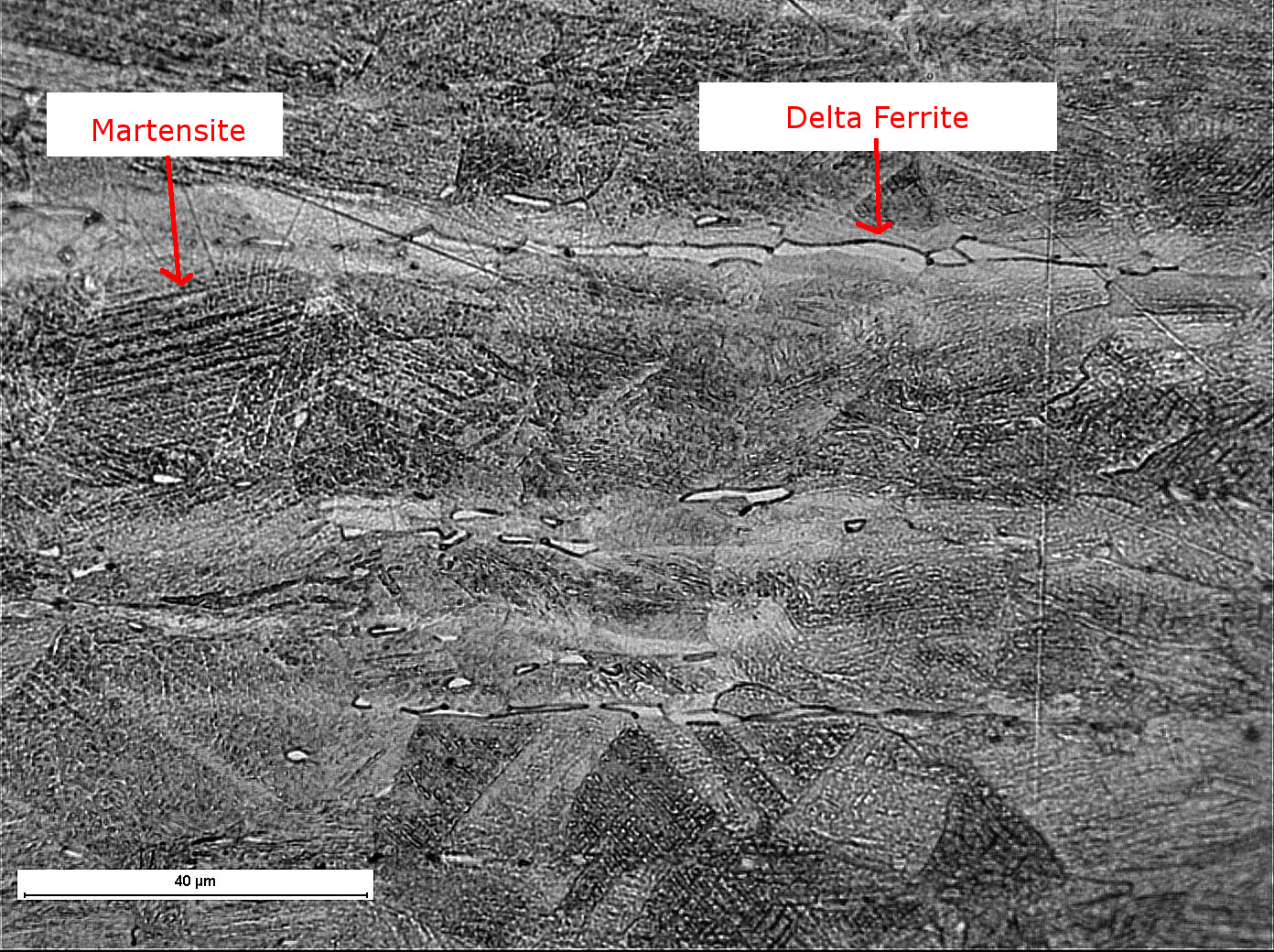

The silicon content was reduced from ~3.75% to ~2.5%. I noted in the H1 article that this is an oddly high value for silicon, and was perhaps added because silicon has a high strengthening effect. So it will be interesting to see if this reduction in silicon leads to a reduction in hardness of H2 when compared with H1. Silicon is also a strong “ferrite stabilizer” and H1 micrographs taken by Sandvik were found to have some ferrite in it. Ferrite is a soft phase in steel (room temperature iron is all ferrite) and not really desirable in H1. The reduction in Cr and Si and the increase in Ni may very well have been made to avoid ferrite.
There are light grey ferrite “streaks” in H1
