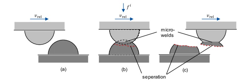

The high nitrogen of the steel is intended to improve its adhesive wear resistance. Adhesive wear is when two metals in contact with each other will rub and weld to each other which pulls out material from the mating surface. Galling is one type of adhesive wear. Vancron is reported to have very excellent adhesive wear due to having vanadium carbonitrides. Carbonitride is a combination of the terms carbide (carbon) and nitride (nitrogen) because the hard particles in Vancron are formed with both carbon and nitrogen along with the vanadium. The superior adhesive wear resistance is found even when comparing with steels that have large amounts of vanadium carbides like Vanadis 10 or Vanadis 8, which have a similar vanadium content but only carbon rather than the combination of carbon and nitrogen. One proposed mechanism is that vanadium nitride leads to the formation of vanadium oxides more easily that act as a sort of lubricant [2]. This occurs because of the low thermal conductivity of vanadium nitride which leads to more frictional heat being generated and therefore more oxide formation. Another proposed mechanism is that the protruding carbonitrides have less tendency to bond with steel than carbides [3]. And perhaps the simplest explanation is that the carbonitrides are smaller and therefore at a higher density than the vanadium carbides, which has often been shown to lead to superior adhesive wear resistance [4].
Image of adhesive wear from [1]

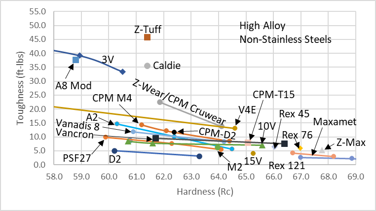

We would expect those small carbonitrides to lead to an improvement in toughness vs CPM-10V and Vanadis 8, which have a similar volume of hard particles. I heat treated my coupons with a “high temper” of 1000°F after austenitizing at 1900°F, and a “low temper” of 350°F after austenitizing at 1800°F. This resulted in 61.7 Rc for the high temper and 66.4 Rc for the low temper. Vancron can go to even lower or higher hardness but these heat treatments should lead to good comparisons with other steels. Vancron toughness is shown with black squares below. The toughness change with hardness was quite flat despite the ~5 Rc difference in hardness. Perhaps this was related to lower toughness with the high temper regime as was also found with CPM-CruWear and some other grades. The toughness was good, somewhat better than 10V, and similar to Vanadis 8. The toughness was similar to Vanadis 8 despite the difference in carbonitride size. There is a significant difference in toughness between D2, PSF27, and CPM-D2, for example, which have the same composition but different carbide size. Perhaps once we are down to a certain carbide size the impact toughness doesn’t improve much by going even smaller.

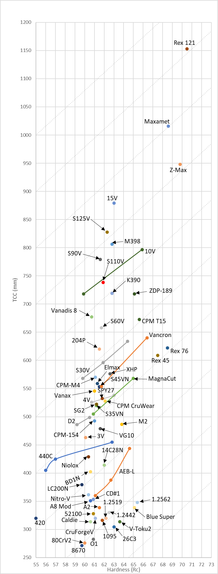

CATRA Edge Wear

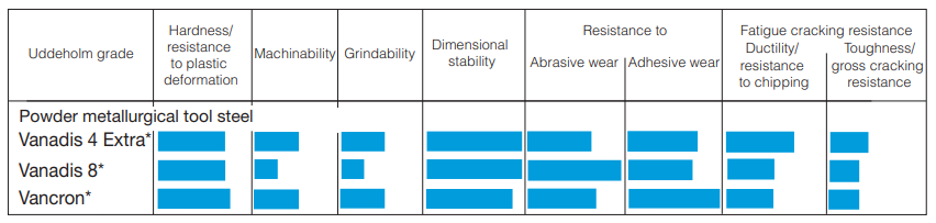

The big surprise for me, however, was that the edge retention of Vancron was significantly lower than Vanadis 8 and CPM-10V. I thought that the high vanadium content would lead to good edge wear resistance despite the change to carbonitrides. In retrospect this is perhaps expected, as the Vancron datasheet shows its abrasive wear resistance as being only marginally better than Vanadis 4 Extra and significantly worse than Vanadis 8, which was also seen in the CATRA test (compare with CPM-4V, an equivalent grade to V4E).
The Vancron datasheet shows it having much less abrasive wear resistance than Vanadis 8 [6]
I assumed this low abrasive wear resistance was due to whatever test Uddeholm uses, as certain types of abrasive wear tests use a large abrasive size that leads to an advantage for steels with large carbides. For example, in tests by Crucible [7] they found D2 to slightly outperform S90V in abrasive wear though in the CATRA test S90V was much better than D2. So I thought that a similar effect would be seen with Vancron. I also had some hope that vanadium carbonitrides would be similar to vanadium carbides because of the performance of LC200N and Vanax in the test. LC200N has a similar amount of chromium carbonitride as AEB-L has chromium carbide, but the LC200N slightly outperformed the AEB-L at similar hardness, indicating that chromium carbonitride may be higher in hardness than chromium carbides. And Vanax had only slightly less edge wear resistance than S30V and Elmax despite its carbonitrides being signficantly richer in nitrogen with its 0.35% C and 1.55% N. The edge wear resistance for Vancron was in fact similar to Vanax if controlled for steel hardness. And Vancron and Vanax have a similar carbonitride size and volume so if the carbonitrides in Vancron were higher in hardness we would expect a significant improvement in edge wear resistance. So the best conclusion I can see from this is that the vanadium carbonitrides in Vancron are significantly softer than plain vanadium carbides found in CPM-10V and Vanadis 8.

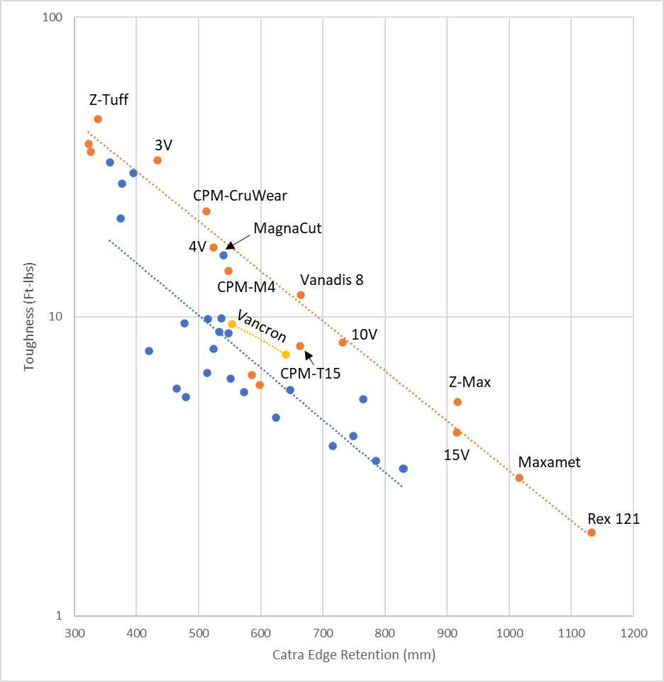

With lower hardness of vanadium carbonitrides than vanadium carbides this is limiting in terms of how high these nitrogen-vanadium steels can be. The toughness is largely controlled by the volume of the carbides/nitrides, and so if the carbonitrides are contributing less to wear resistance then the toughness-edge retention balance is reduced. That makes the carbon-vanadium grades like Vanadis 8, K390, and CPM-10V a better choice in terms of toughness-edge retention balance. This is somewhat disappointing because I had heard that Vancron was significantly easier to grind and sharpen than other 10% vanadium grades like CPM-10V and I thought Vancron might offer similar edge wear resistance to those grades but while being easier to work with; certainly that would be an attractive combination of properties.
Nitrogen can help with corrosion resistance by improving the pitting resistance. However, the nitrogen works by strengthening the “chromium oxide film” created by chromium, not in replacing it. The chromium is insufficient in Vancron to be stainless despite the high nitrogen. Shawn Houston found it to easily rust if he wasn’t careful during water-cooled grinding of the CATRA blades.
None of this is to say that Vancron is a bad steel, necessarily, I was just surprised at how low its edge wear resistance was when compared to the other 10% vanadium steels. And of course the steel does very well for its intended application – metal forming applications which typically fail by adhesive wear. The steel does offer high potential hardness and a toughness-edge retention balance in the same ballpark as powder metallurgy high speed steels and stainless steels. But it remains expensive and difficult to obtain, and at this point I am not seeing advantages in using it vs other less expensive grades.

  2. Interesting article. I would have thought that it would hold an edge as well as S110V for instance and I’m surprised at even RC 66 hardness it barely beat out S30V at 64.5. When you said it was easier to work and sharpen it reminded me of the old axiom. “Easy to sharpen, easy to dull.” I guess it applies to Vancron to a small degree.

  4. Vanadis 8 according to your chart is 6 toughness and 7.5 edge retention. On the same chart k390 is almost the same. K390 with 5.5 toughness. I have several blades from Spyderco in k390 and they do great. I only have one in Vanadis 8. It’s a Kunwu fixed blade but I haven’t used it really. So do you think it’s as good of blade steel as the famous k390? Why don’t we see more knives in it?
    1. Vanadis 8 and K390 are about the same. There aren’t more knives in it because of poor availability and recognition.
