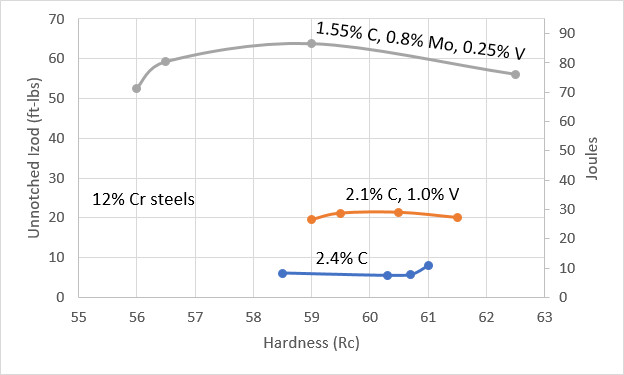

By 1934 a composition consistent with D2 was discussed with 1.55% C, 12% Cr, 0.25% V, and 0.8% Mo [6]. It wasn’t yet named D2, of course. The molybdenum was added to make it a true “air hardening” steel which allows the steel to fully harden in thick sections or without oil. Without Mo, the high Cr did make the steel quite hardenable but not enough to make it truly air hardening. The vanadium addition was made to improve toughness which it does by refining both the grain size and also the carbide structure. This new D2-type steel was gaining in popularity because of its “air hardening property, low distortion and better machining quality than the other [high carbon, high chromium steels]” [6]. It was also reported to be, “the most universally adaptable of the…high carbon high chromium steels” [6]. And as mentioned previously the lower carbon meant much greater toughness than the earlier D3-like steel which you can see in the figure below. Vanadium and nickel additions had been experimented with the D3-type, 2.2% carbon steel, but while that improved toughness, the lower carbon D2 was much tougher. From that point D2 became one of the most popular tool steels, particularly in dies. New “better” steels made for dies continue to be compared to D2 because of its ubiquity.

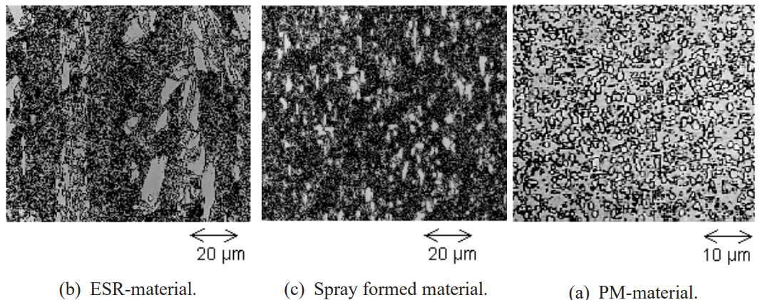

The large carbides in D2 limits its toughness and also its edge stability. A powder metallurgy version, CPM-D2, was released around 2007 [9] to reduce the carbide size, which is reported to improve the toughness, corrosion resistance, and heat treatment response. You can read more about why D2 has large carbides and the powder metallurgy process in this article. Sprayform is a somewhat similar technology that leads to a somewhat larger carbide size than powder metallurgy. There is a sprayform version of D2 called PSF27 produced by Dan Spray in Denmark, made at least since 2002 [10]. You can see the decreasing carbide size in conventional (well, ESR anyway), spray form, and PM D2 in the images below [10]. Note the PM is at a higher magnification.
Those are pretty low resolution micrographs. I took micrographs of D2, PSF27, and CPM-D2 which are shown below:

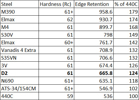

Bohler Uddeholm measured the edge retention of D2 along with other steels with CATRA testing and found it to be somewhat better than N690, ATS-34/154CM, and 440C, on par with 3V, but worse than S35VN, Vanadis 4 Extra, Elmax, S30V, M4, and M390 [11]. I also calculated the edge retention relative to 440C which is a value that Crucible has reported in the past.

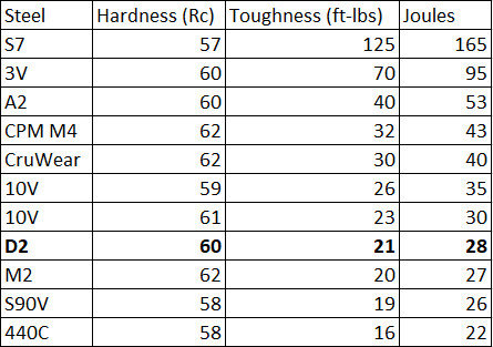

Crucible reports that D2 has toughness roughly equivalent to 10V, better than 440C and S90V, but worse than 3V, CruWear, and A2 [12][13][14].
In our toughness testing D2 was not very impressive though we have only tested one heat treatment and have not compared to many other low toughness steels like 10V, 440C, and S90V:

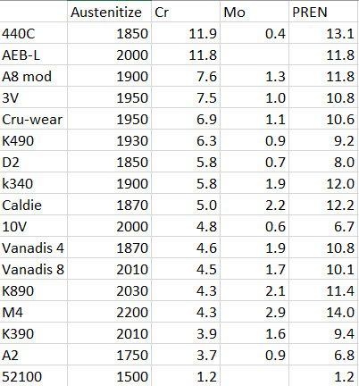

I previously wrote about the potential corrosion resistance of D2 in this article. Its corrosion resistance has been somewhat over-promoted in some cases because of its high chromium content. Approximately half of that chromium is tied up in carbides where it doesn’t contribute to corrosion resistance. Therefore, it has good corrosion resistance for a tool steel, though there are some non-stainless steels that potentially have better corrosion resistance, particularly many of the 8% Cr steels like 3V or CruWear. Here is the chart from that article with the steels ranked by “chromium in solution” which is approximately equal to the corrosion resistance of each steel:

About the CATRA test results I’m confused about the difference between S30V and S35VN. I though there was essentially no difference in edge retention between these 2 steels and the only difference was an little increased toughness in S35VN.
Hi Patrick,
Perhaps you are referring to the S35VN datasheet where both S30V and S35VN are listed as having CATRA performance of 145% of 440C. However, there is an asterisk next to the S35VN value and if you follow that down it says, “Estimate based upon market feedback.” In other words, they didn’t actually measure it. According to their own datasheet the MC carbide volume was reduced from 4% to 3.5% with the modification of S30V to S35VN which we would expect to lead to a small reduction in CATRA edge retention.
You’re right. I haven’t seen this funny “Estimate based upon market feedback” comment.
I think Crucible is borderline dishonest to display this 145% value in the official datasheet.
Was the D2 that was tested cryogenically treated? And if so was it a deep cryo?
In your toughness testing of D2, from which manufacturer did the material and heat treat come from, respectively? Do you expect this to be representative of most D2 samples, and if not, where on the scale would you place it? (i.e.- most D2 being better than the test sample, most being worse, etc.)
The D2 came from Crucible steel. I would expect the toughness to be similar to other D2 assuming the heat treatment is done correctly.
