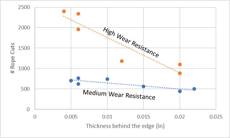

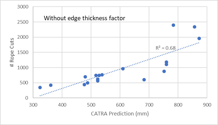

I will start with the Ankerson dataset because it is smaller and includes hardness and thickness behind the edge. There is a good range of steel tested from the relatively low wear resistance AEB-L to the high wear resistance 10V and S125V. My equation does not include a factor for thickness behind the edge, as that information was not available in the CATRA dataset. When comparing the CATRA prediction with Jim’s results, the correlation is good. The CATRA numbers are not the same as the number of cuts, of course, as one is a prediction of a CATRA result in mm and the other is number of cuts made in a rope. The R2 value is 0.68, where 1.0 is perfect and 0 is no correlation. The trend looks convincing, as shown below. One discrepancy is the difference between the lowest and highest edge retention knives. The CATRA prediction shows the best edge retention knife as being 2.7x better than the worst, while Jim’s data shows it is 7.1x. I don’t know if this is simply a difference in the “slope” between the two tests or if it is some kind of real effect where the two tests are measuring somewhat different things.

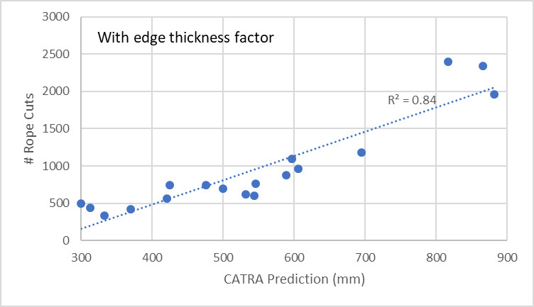

We know that thickness behind the edge has a significant effect on cutting ability, and there is a pretty significant range of edge thickness in the data, from 0.004-0.022″. The edge thickness had a particularly large effect with high wear resistance steels 10V and S125. The difference in edge retention between medium and high wear resistance steels increased with thinner geometry:
This effect is similar to that seen with edge angle in the CATRA data, where the difference between low and high wear resistance steels was greatest with very acute edges:

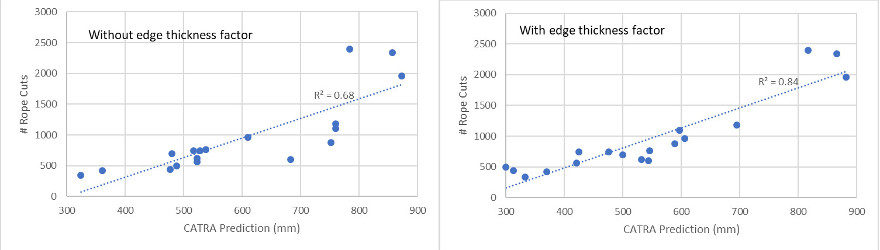

When adding an edge thickness component to the CATRA equation, -12300*thickness(in), the correlation between CATRA and the rope cutting data is significantly better, increasing to 0.84:
This is probably about as good a correlation as we could expect, in my opinion, given the inherent scatter in testing.

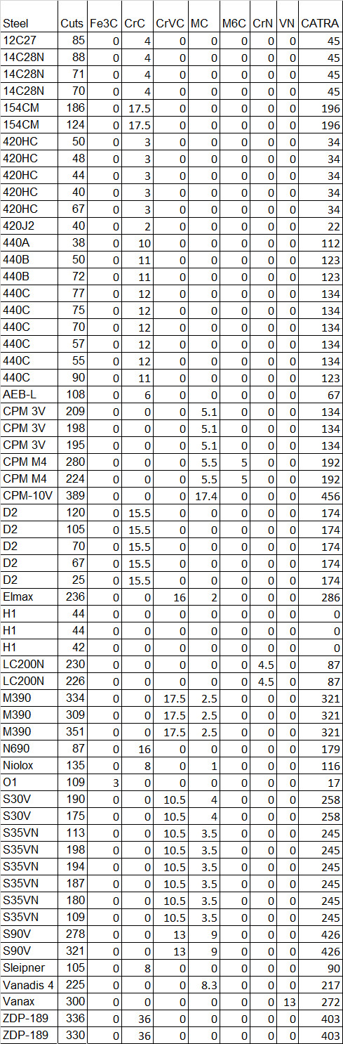

Cedric and Ada

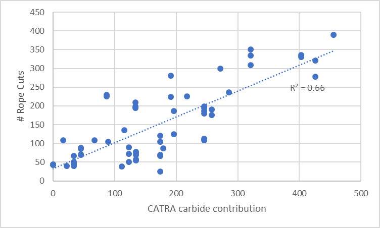

As previously mentioned, thickness behind the edge and knife hardness is not available from Pete’s dataset. That inherently reduces the prediction power of the CATRA equation. Plus there are many more knives included. There is some significant scatter that cannot be accounted for with the CATRA equation; for example, D2 knives range from 25 cuts to 120 cuts. That large range may be due to heat treatment, thickness behind the edge, or even misinformation on steel type. On the plot I have “CATRA carbide contribution” as only the carbide part of the CATRA prediction equation was used. Regardless, let’s see how well the prediction does:
It turns out the prediction does quite well, with an R2 value of 0.66, very close to the value for the Ankerson dataset without an edge thickness term. The range of values are more similar here than in the Ankerson dataset; the difference between the best and worst knife is close to the same. This is very impressive given the important variables that are missing. There is some scatter, of course, with some knives doing better or worse than expected, such as the 25 cut D2 result.
Steels that did better than expected based on the CATRA prediction include LC200N and CPM-M4. I don’t have a good explanation for the good performance of LC200N, which made about 230 cuts vs its predicted position at about 100 cuts. The steel does not have a high volume of carbides or nitrides, and even if it was assumed that all of the hard particles were the very hard vanadium carbide the steel wouldn’t perform as well as tested. The identical Cronidur 30 was in the CATRA dataset and it did well but not to the same level as found in Pete’s testing. Perhaps the edges were thin relative to the other knives. CPM-M4 is often heat treated to relatively high hardness, greater than 62 Rc, which may explain one knife reached 280 cuts vs the predicted of about 180.

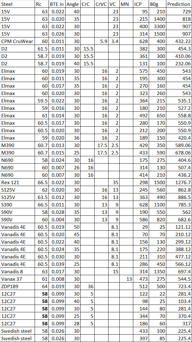

Pavol Šandor

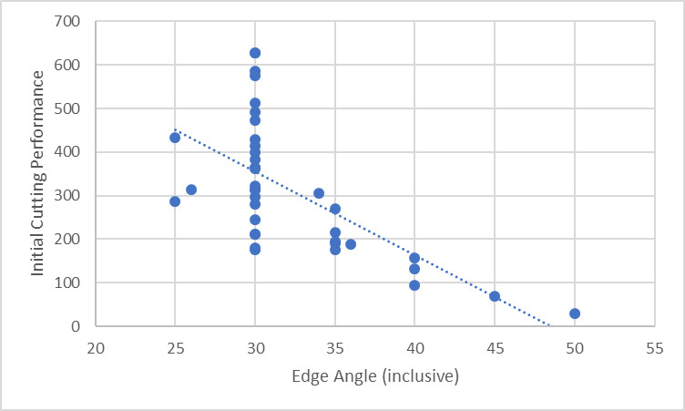

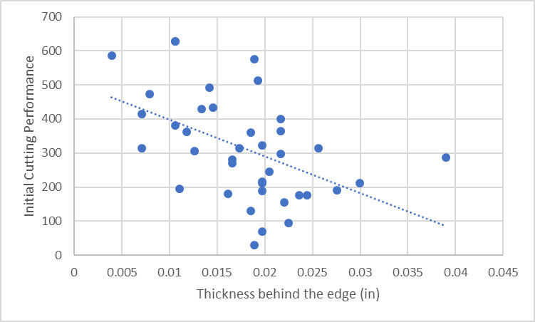

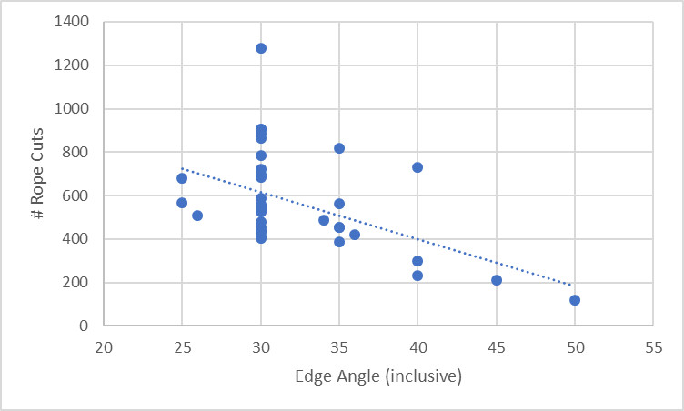

Pavol recorded a lot of information with each of his tests, including hardness, thickness behind the edge, and edge angle. Pavol also measured “initial cutting performance” which is the amount of rope that was cut in the first stroke, and that correlated well with both thickness behind the edge and edge angle:

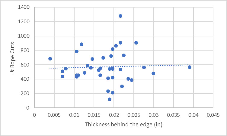

However, when edge angle and thickness behind the edge is plotted against total edge retention, only edge angle affected edge retention:
It is surprising that there was no correlation between edge retention and thickness behind the edge. I don’t have any good explanation for why this behavior was so different than that recorded by Jim Ankerson. But it is an interesting difference to point out. Perhaps Pavol or Jim have ideas based on being closer to the testing than me.

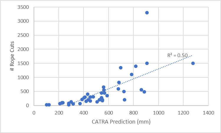

When the CATRA prediction is plotted vs the measured rope cutting edge retention there is a decent correlation with R2 of 0.5:

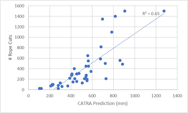

There is one potentially outlier value of 3300 cuts with a 15V knives. That number of cuts is much higher than everything else, even another test with a 15V knife of similar geometry from the same maker with the same hardness. If that value is removed the R2 improves to 0.65, similar to the other two datasets:
Overall I am very pleased with the correlation between CATRA and rope cutting. This despite missing variables, and the use of a “slicing pushcut” by Pete which is somewhat different than the cutting motion of CATRA. And in all cases these are knives produced by many different factories and knifemakers which introduce other factors into the test I am likely not accounting for. Better would be to use knives that are all produced in the same way to compare the effects of steel, hardness, and heat treatment. However, even with these limitations CATRA results look very similar to rope cutting by people. Therefore, CATRA looks to be a good test for slicing edge retention. The rope cutting dataset from Jim Ankerson showed that thickness behind the edge is important to cutting ability and edge retention, in a similar way to edge angle. In other words, edge geometry is extremely important to cutting ability and edge retention. Pavol’s dataset also showed a significant effect of edge thickness on cutting ability but not on edge retention. His testing also confirmed that reducing the edge angle greatly improves edge retention, as was shown in CATRA testing. I hope in the future to do a more controlled comparison between CATRA and rope cutting tests where we may learn more about the differences.

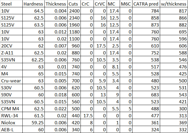

Jim Ankerson Table
Cedric and Ada Table
Pavol Šandor

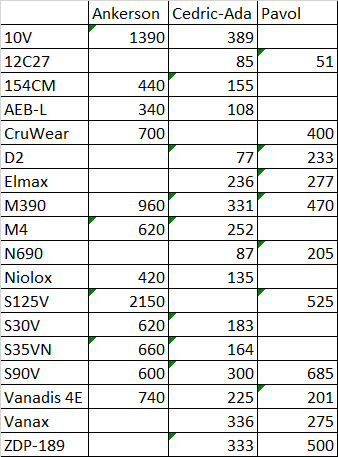

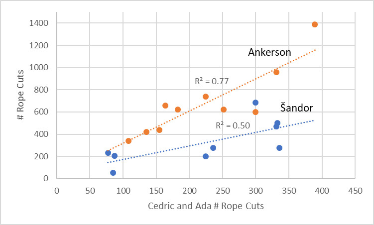

Correlation Between Different Rope Cutting Tests
I was asked if the different rope cutting tests correlate well with each other. I made a table lining up the steels that are the same between the three different datasets. I grouped some steels together, for example, Vanadis 4E and 4V were considered the same, 20CV and M390 were the same, RWL-34 and 154CM, etc.
Even without compensating for sharpening method, edge angle, hardness, or edge thickness, the correlation between them is pretty good:

    In regards to the thickness behind the edge and the difference between Ankerson and Pete, could be the selected method for stopping the test, since cutting performance is increased with a thinner grind, on Ankerson’s 20lb on a scale method less force has to be applied at the same apex width. Meanwhile Pete’s stopping point is simply measuring the Keeness of the apex itself.
